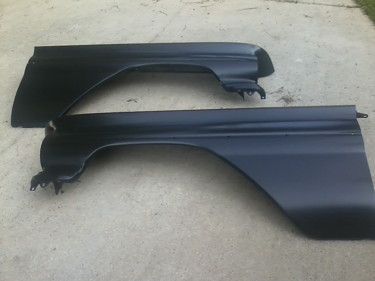

    PPG has an industrial acrylic vinyl primer-sealer coating that I (and others) have been using as a tinted base. I spray it just before topcoating, after epoxy and high-build steps. It's pretty impressive, sprays out nice. It's semi-gloss, but dulls more if rubbed down with scotchbrite (after 3 days, have to abrade before topcoating). The same scotchbrite technique could be used to "blend" I would think.
    It's called VAP-9XX and is tintable. There are also some pre-mix colors (VAP-900 Red Oxide, -902 Beige, -904 Gray) Best part, my jobber sells it for $14/quart.
    It seems pretty durable...good resistance to salt spray (500 hours) and various chemicals. Data sheet here: http://www.lopdf.net/preview/xd14K2...eries.html?query=Acrylic-Lacquer-Paint-Colors
    Below are two Pontiac Catalina fenders I did, waiting to be sprayed in final black.

  24. Slopok
    Joined: Jan 30, 2012
    Posts: 2,969
    Slopok
    Is that the gray or did you tint them black? They look like when you buy new parts and they have that black protective coating on them.

    That's tinted black. It's fairly similar to the e-coat on new parts....just a bit flatter.
