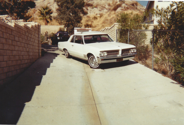

    When I first bought my 1964 Tempest it had a rebuilt original 215 six cylinder under the hood mated to the original column-shifted 2-speed auto and 2.56 rear.
    It always returned an honest 20MPG, this was an average of both city and highway driving. I never really kept it sharply tuned, so it likely had another couple of MPG left in it. I've never owned a more reliable and easy to work on old car than this little Tempest with a straight-six. Changing out the heater core takes less than 2 hours.
    The good thing about the '64 -'72 GM A-body cars is they have so many interchangeable drivetrain and suspension pieces it isn't funny. Super easy and affordable to find ch***is and brake parts. Disc brake swaps are a snap, all those years these cars used same front ball joints.
    A shot of the original 140 HP 215 straight-six that came in this car, both the LeMans and Tempest rolled off the ***embly line with one of these if you didn't ask for the 326 V8. This six-banger is exactly the same as a 230 Chevy other than bore size (3.750" vs 3.875") and having 'PONTIAC' cast into the side of the block.

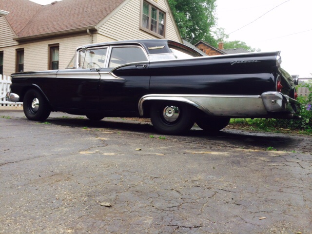

    I'm doing the '59 Ford so it can be used on a daily basis. Upgraded to front discs for more whoa power. Going with 3-point belts for the front since the dash is steel and the steering column is little more than a spear.
