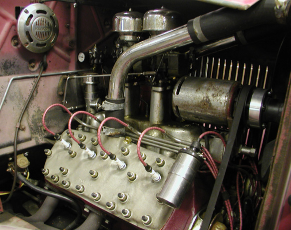

    Here is mine. ROOF. I used a 35 intake and cut it to make the Gen mount. Took a 28 Powerhouse gen and put in an Alternator from a Kabota. Have tested it and it works great! Engine is a 36. Feb 17 2017 008.JPG Feb 17 2017 009.JPG Feb 17 2017 010.JPG Feb 17 2017 011.JPG
    Jet96 likes this.
