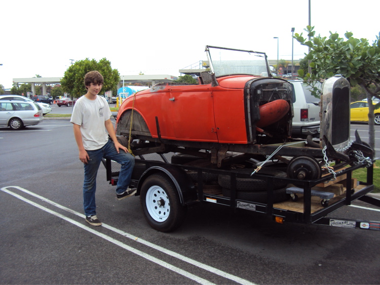

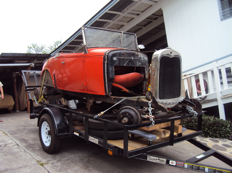

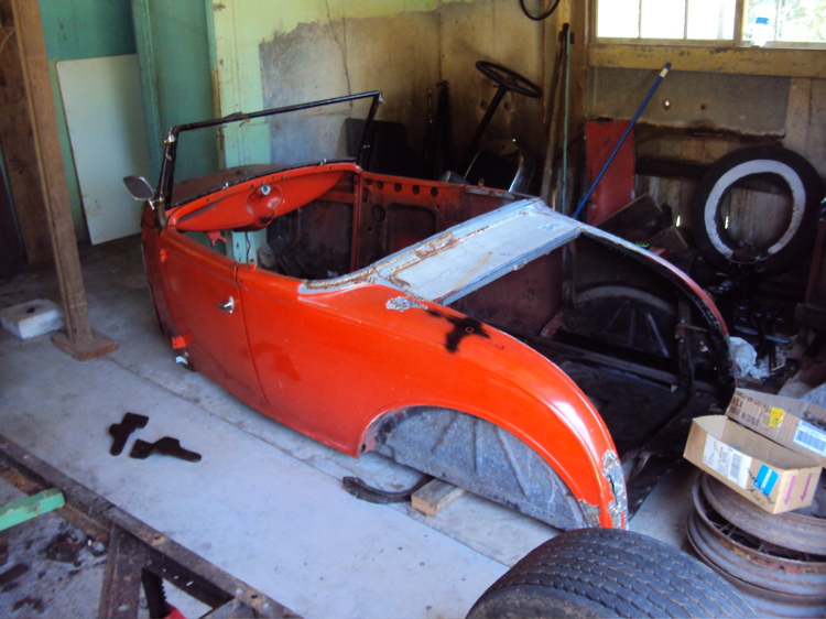

  15. I finally picked up my new roadster on monday! it was a very exiting day!
    unloaded it yesterday, got it into my shop.
    I've pretty much decided to build the roadster first, same style just a roadster body instead. I think its more correct, and now that I have one why not use it!
    here are some pics of getting it home

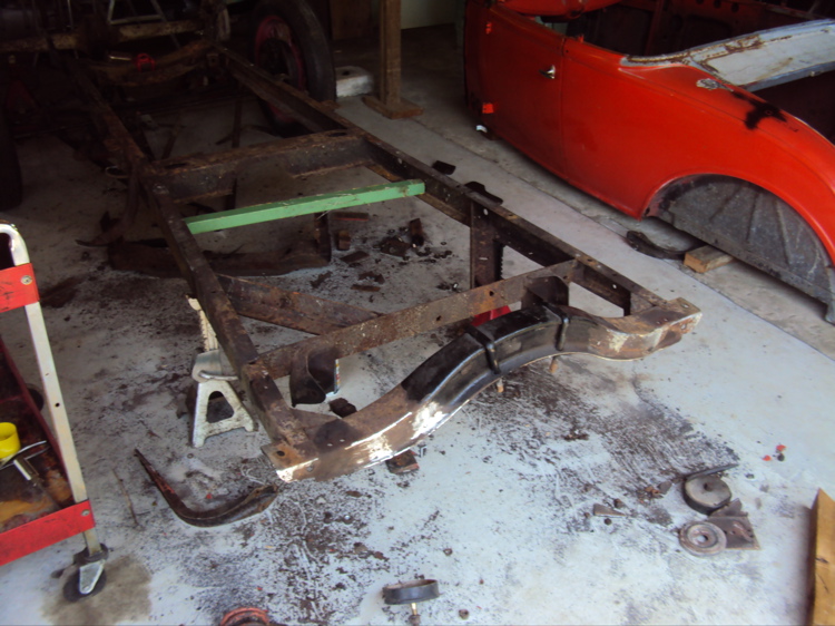

  17. update

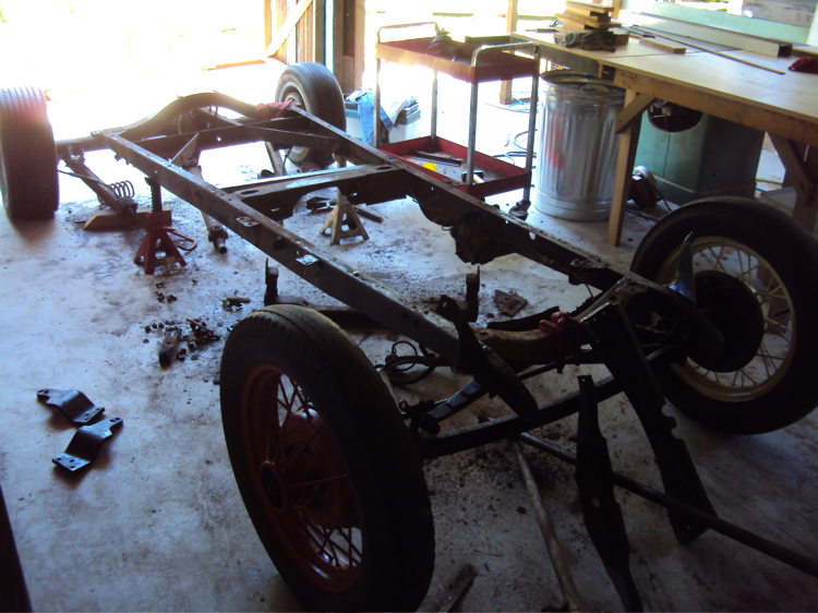

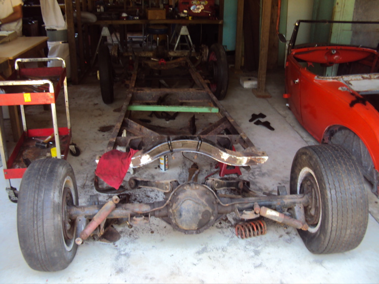

    yesterday I got the body off with help of my family. I started cleaning up the frame. The car was a 80's street rod, full fendered with 350, 12 bolt chevy rear. When it came to me it still had the rearend. I will be using a stock "a" rear.
    heres the pics

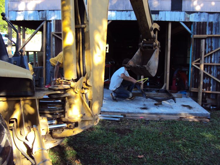

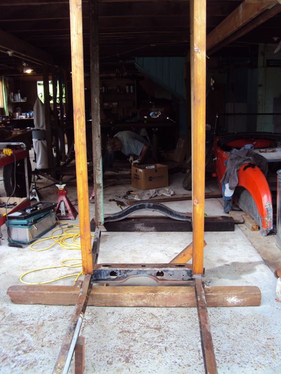

  20. update

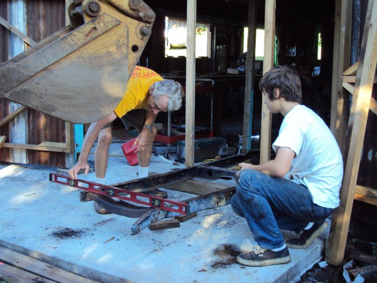

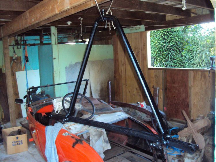

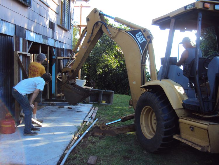

    I finally got my frame straight! A friend of ours( who has two model A's, a nice stocker coupe and a sedan project) is digging our new driveway with his backhoe, and suggested that we try straightening the the frame with it!
    The p***enger side rail was an inch higher than the other side at the front framehorn, which was pushed down easily with many tons of hydraulic force.
    We held the rearend of the frame down by putting 2x4s from the top of the rails to the low ceiling rafters.
    heres the pics

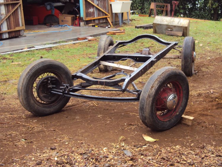

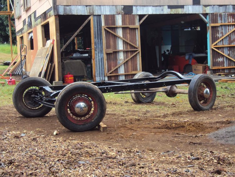

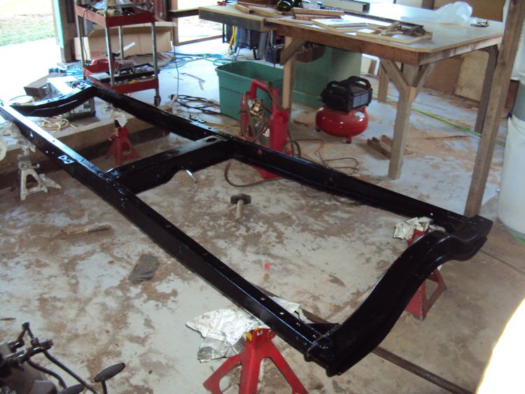

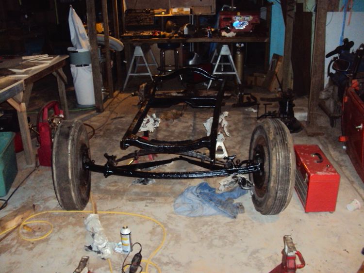

  21. update

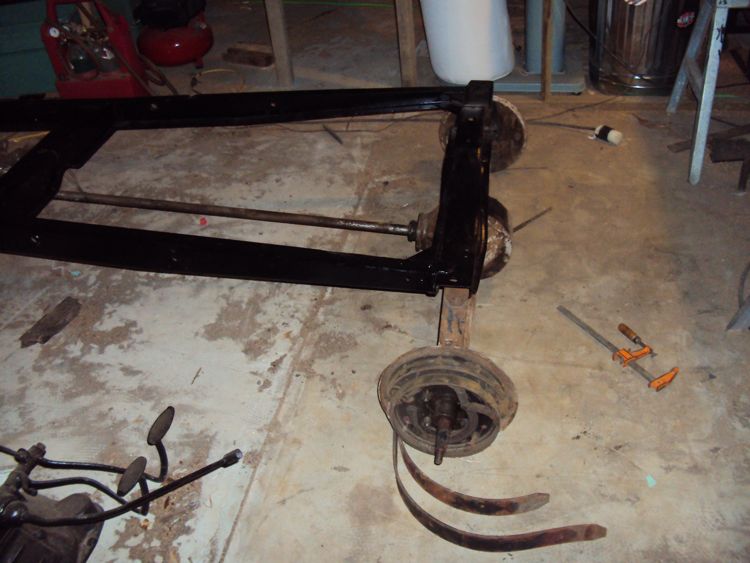

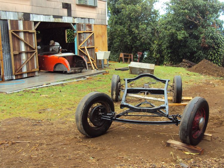

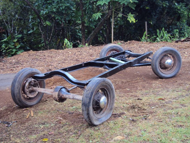

    I gave the frame and frontend a quickie paint job, and started putting pieces together.
    heres the pics
    p.s.: expect mockup pictures by the end of today:D

    if you do decide to try and use the model "A" frame , you should at least box it in the central area for 10 - 15 inches forward and back from where the rear engine/trans mounted. (after you straighten it) those "A" frames are very weak there, and most i've had back when i was restoring my `31 roadster were bent there from the weight bouncing down bumpy roads. lay a straight edge or stretch a wire on the top of the frame rail, to check for flatness. i've seen many restored model "A's" with a gap at the bottom of the hood at the firewall/cowl, because the frame was bent there. and they didn't realize it untill the car was done. then tried to close the gap, with a spacer under the rear hood hindge bracket. <!-- / message -->

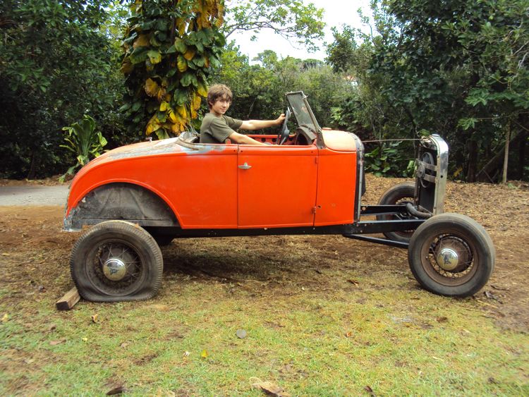

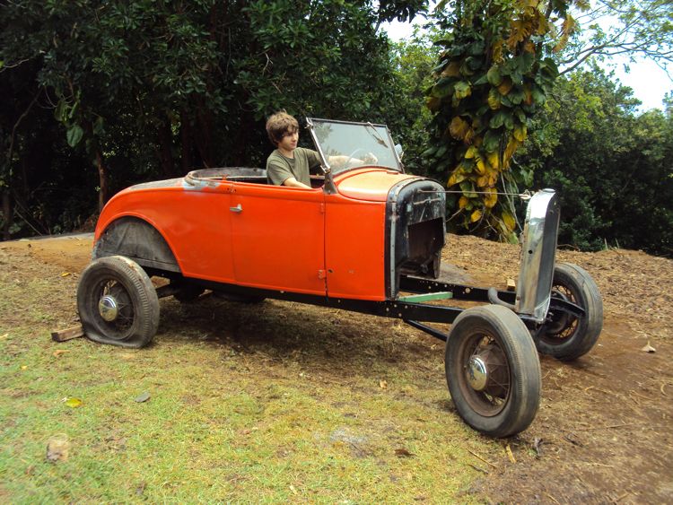

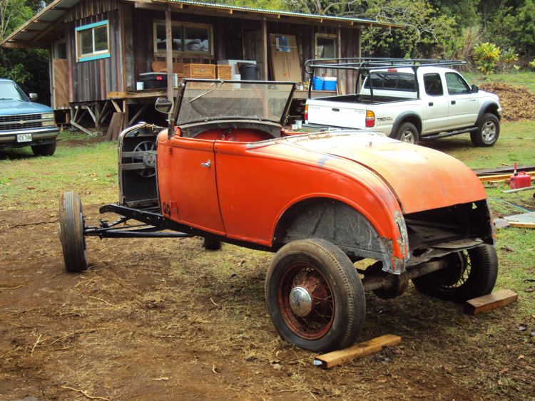

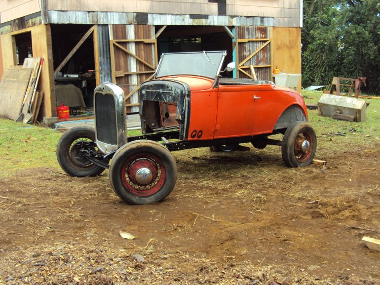

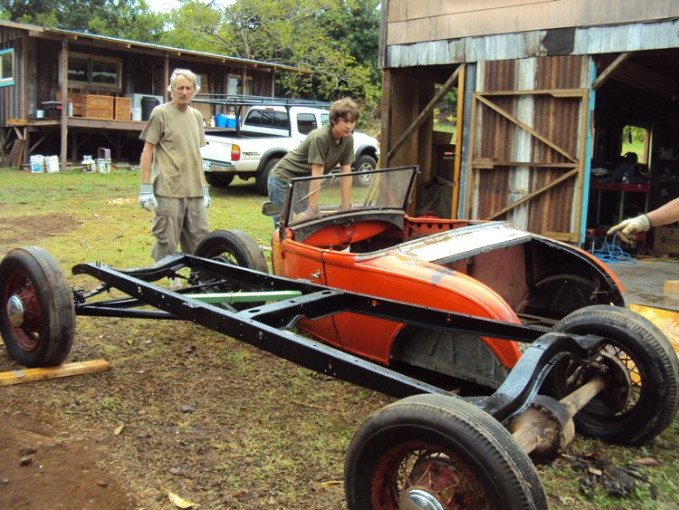

  26. okay,

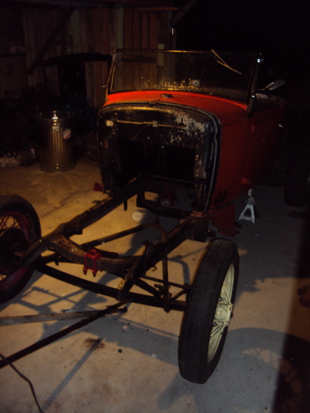

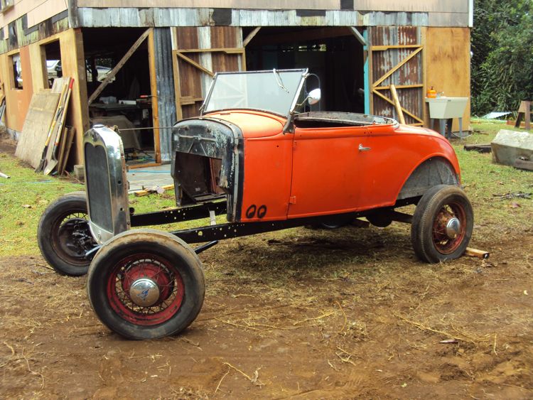

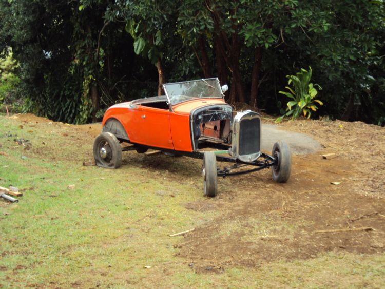

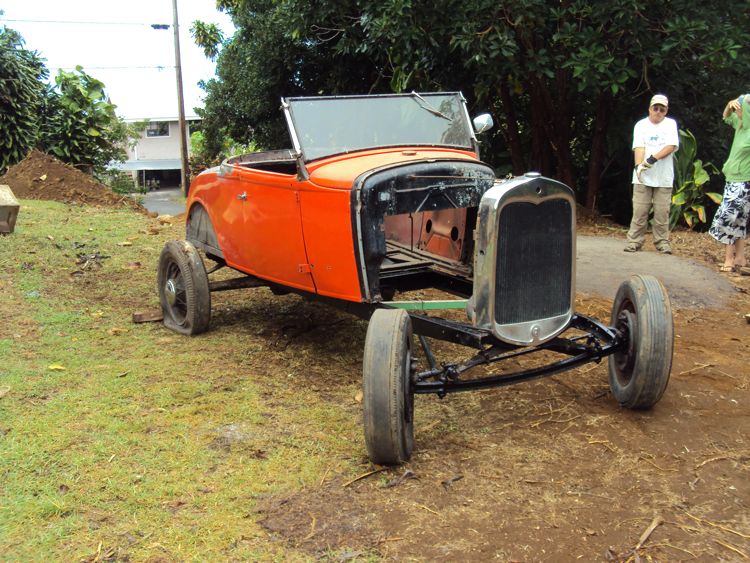

    here's the pics! I just got'r rolling, then a family friend came over and we put the body!!!
    I so stoked!!!!!!!!:eek:
