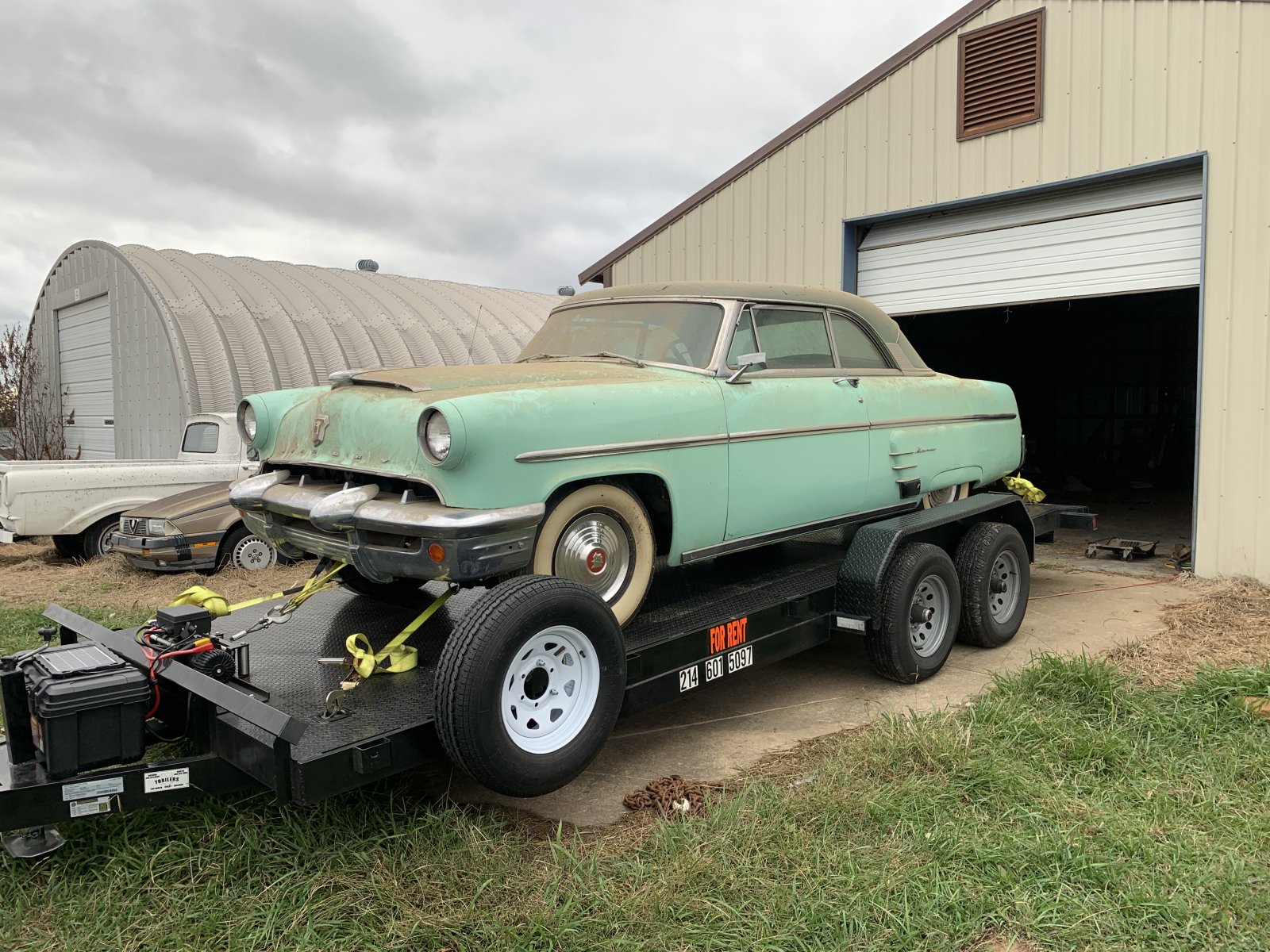

    Hey fellas, so I recently just picked up the 53 Merc and want to see if I can get it running. The previous owner unfortunately passed away and it hasn't ran for around 9 years.
    With that being said it looks as if he took great care of it as you can see all the wiring has been updated.
    My question is, I’ve read to put Marvel mystery oil in each cylinder and let it sit for a day or to before trying to start it. Is this true? If so how much? After a day or so should I turn the motor over by hand to lubricate everything? Any advice or wisdom would be greatly appreciated.
    Thanks

    Yeah I'd turn it by hand, just to make sure everything is still moving inside before you hit the starter. Congratulations on a nice car by the way.

    Nice find. It looks like it’ll fire easily. Drain the fuel system from the tank clear to the carburetors. Install a new fuel filter afterward.
    drain the gas tank and flush it. unhook the fuel lines at both the carb and tank. Apply 10 lbs of air pressure to the fuel lines. Drain the oil, clean the filter and fill with five quarts of 10-30.
    Replace your battery. 6 volt systems are hard to start with less than desirable cold start amps. Keep us updated on your progress or problems.

    Then, before attempting to drive it, flush the brake system and coolant system. Make sure those are up to snuff. Stopping is infinitely more important than going.

    drain and replace all fluids .
    you can run the carb off a jerry can snd bypass the rest of the fuel system
    check your point , wiring connections from the battery, ground etc for dirt snd corrosion
    pull your spark plugs snd put a few squirts of oil in the cylinders and crank it over by hand with the plugs out.
    Flat heads like to stick valves easy enough to unstick them, but better to find out before you try and fire the motor

    I take a bit more practical approach than some others....I do what needs to be done, and don't do what doesn't need to be done.
    First, carefully check the wiring so you won't smoke things when you connect the battery. If anything is questionable, I disconnect the main power feed wire, and use a hot wire to power the coil.
    Check the smell of the fuel. Open the gas cap, if it smells bad, don't try to use the fuel tank until you get it flushed out. Instead, put a small gas can up front, with the fuel inlet to the pump, going down into the can.
    See if there's coolant, water, or sludge in the cooling system. You don't need anything in it to just get it running, but if you run it more than a minute or two, you want some liquid in there.
    Check that there's oil in the engine and transmission.
    Get the brakes working. Really. Before you try to start it. If you're not going to do that yet, then get the rear of the car up on stands.
    Put in a battery, see if you can get the starter to turn. If it spins, the pour some gas into the carb, put the air filter back on (to prevent a backfire from turning into a disaster), connect the hot wire, see if it will fire.

    My experience from my work at a private car collection, is that any car sitting for more than 5 years needs a new master cylinder, new wheel cylinders, and the brake system flushed. And this is in a climate controlled environment.

    In addition to the above, personally Id drop the oil pan and give it a clean, particularly if you plan to run it. Who knows how well its been serviced prior to parking. Feel you on the one colour wiring too, been down that road but luckily only on a chopper.

    Put in the marvel mystery oil or ATF/acetone mix, and give it a try with a breaker bar, there's no magic number of days, or guarantee it will work.

    Put the car in neutral to try turning the motor. Clockwise will tighten the bolt / turn the engine.
