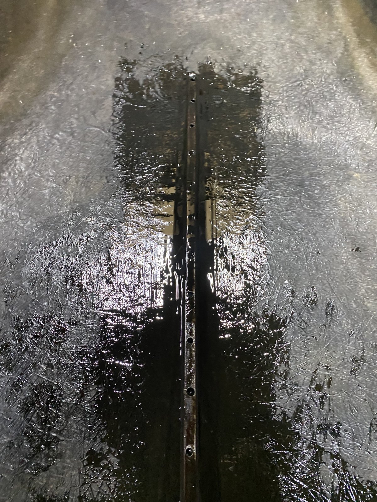

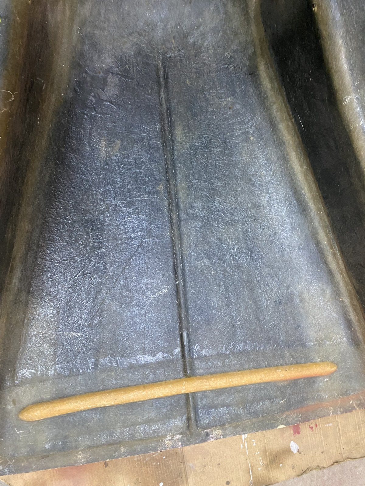

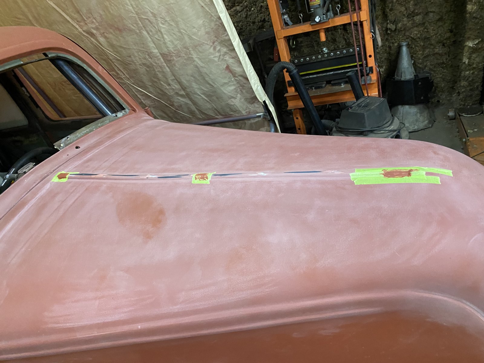

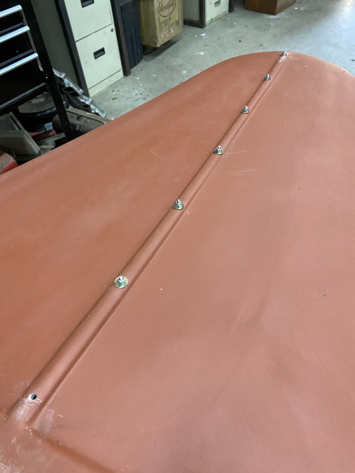

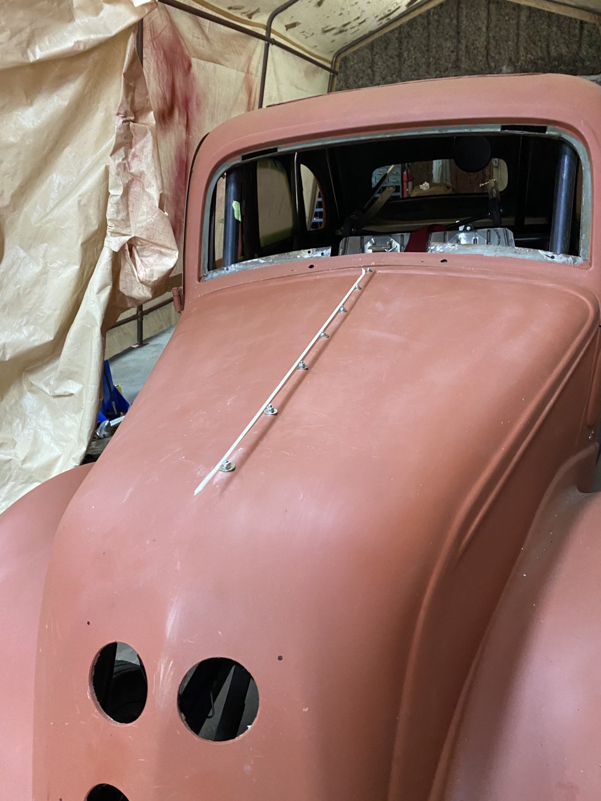

    Gonna graft a piece of square tubing or aluminum c channel from the underside /in the bottom of the channel. Bolt in to get rid of the bow. Then use body skin adhesive and epoxy to fill in and cover. Then remove the bolts and use filler etc to cover up.

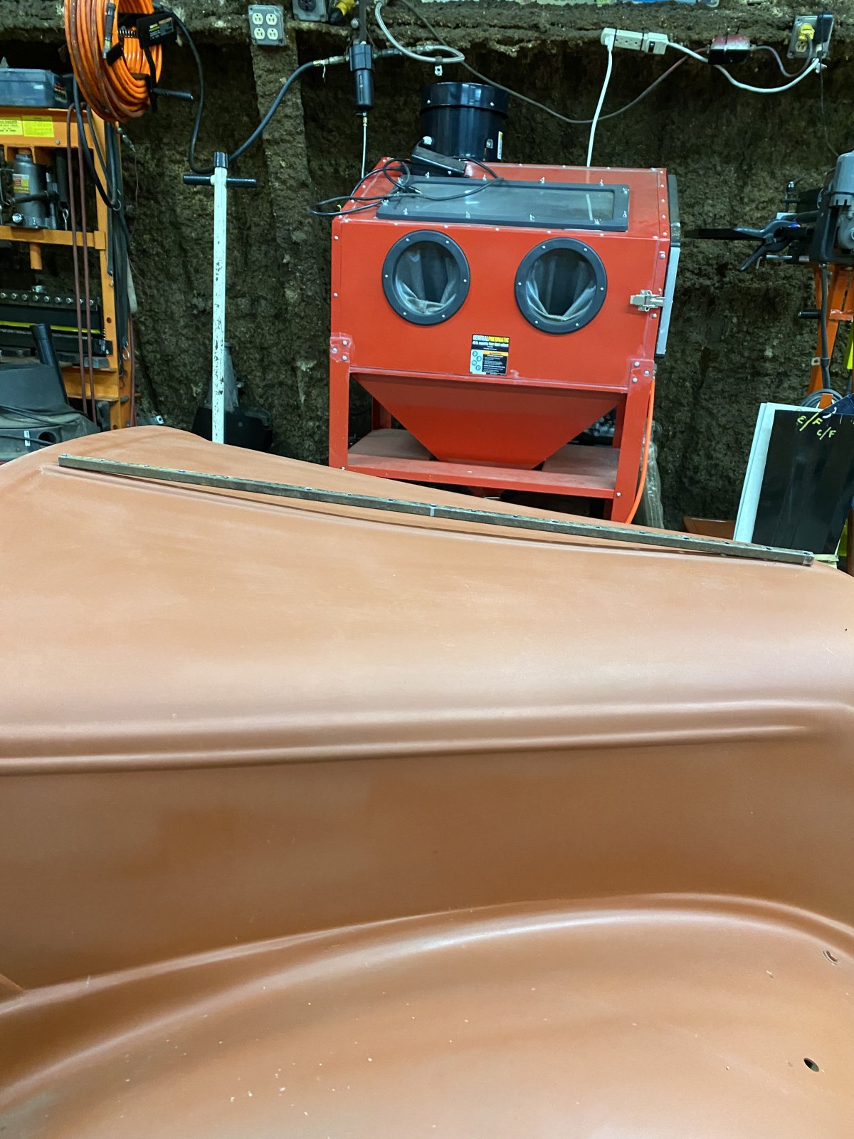

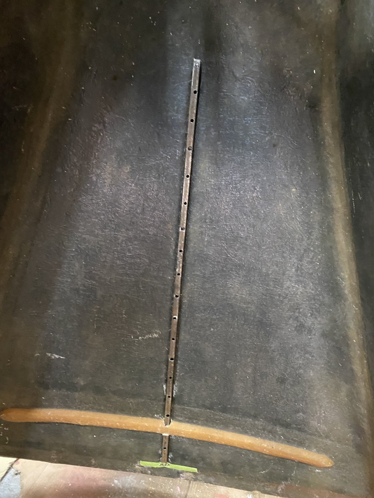

    IMG_2729.png IMG_2723.jpeg IMG_2722.jpeg IMG_2721.jpeg IMG_2720.jpeg IMG_2718.jpeg IMG_2719.jpeg IMG_2717.jpeg Built a rib brace and bolted to the bottom of the front cap. Pulled all of the bow out. It’s within an 1/8 full length. The dip was over an inch. It also didn’t affect my dutz fasteners. Or my front pivot mounts. I actually considered putting a small reverse bow in it to get it perfect. I suspect it will settle a little. Gonna use door skin adhesive /like last time. Completely cover it and let set. Then take bolts out and fill holes.
    The first shot is how bad it was bowed down as compared to my long level. The rest are as I tightened the brace down.

    IMG_2735.jpeg IMG_2734.jpeg IMG_2734.jpeg Used the door skin sema adhesive to seal and make the brace permanenet. After it sits for a few days I am going to remove the nuts and back the bolts out. Then fill in the holes with the same stuff and then some filler/sealer. I hope lol .

    IMG_2744.jpeg IMG_2745.jpeg IMG_2746.jpeg IMG_2747.jpeg Removed nuts and washers from top. Then cut the studs. I’ll need a touch of filler and go from there. It shouldn’t take much. It’s off about an 1/8. An inch and 1/4 better to be exact.

    IMG_2746.jpeg Filler added. Will sand /block and spot prime. IMG_2747.jpeg

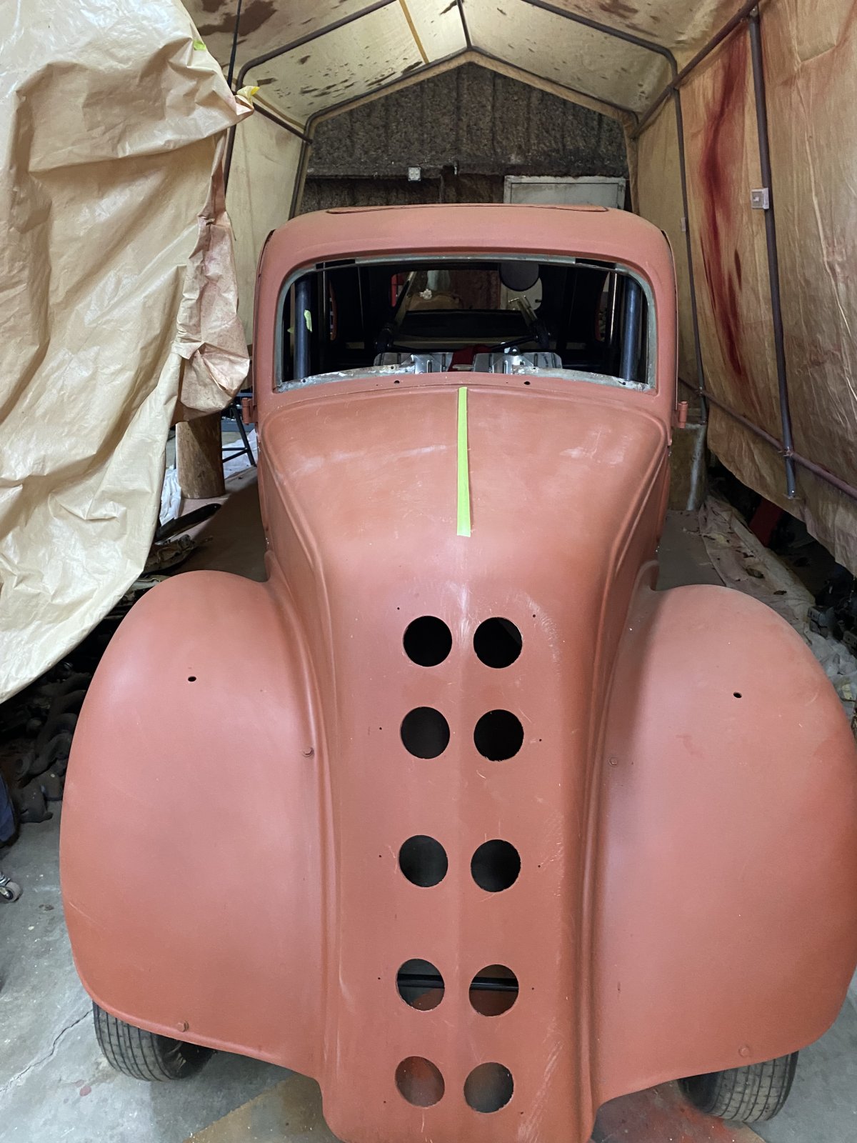

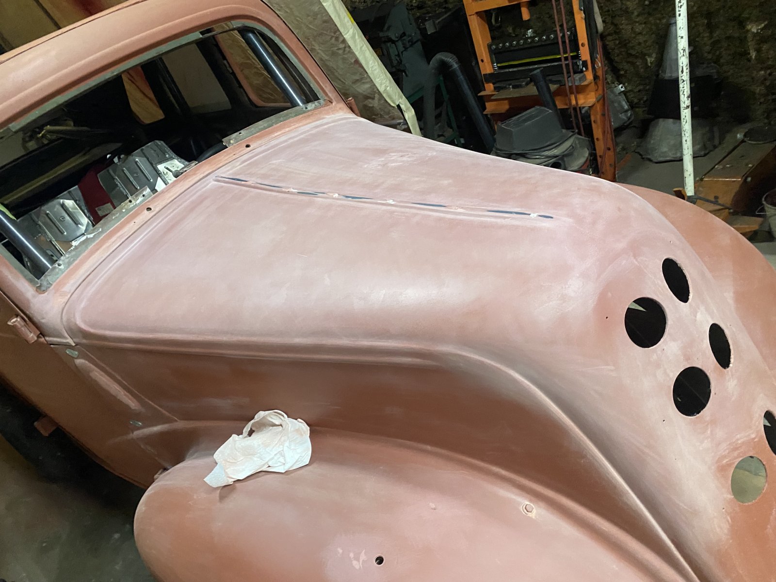

    Sanded and blocked the rib. Found a few spots/ pits. Filled them with spot puddy/primer. Gonna let it sit and cure and cut /sand once more. IMG_2771.jpeg IMG_2770.jpeg IMG_2769.jpeg

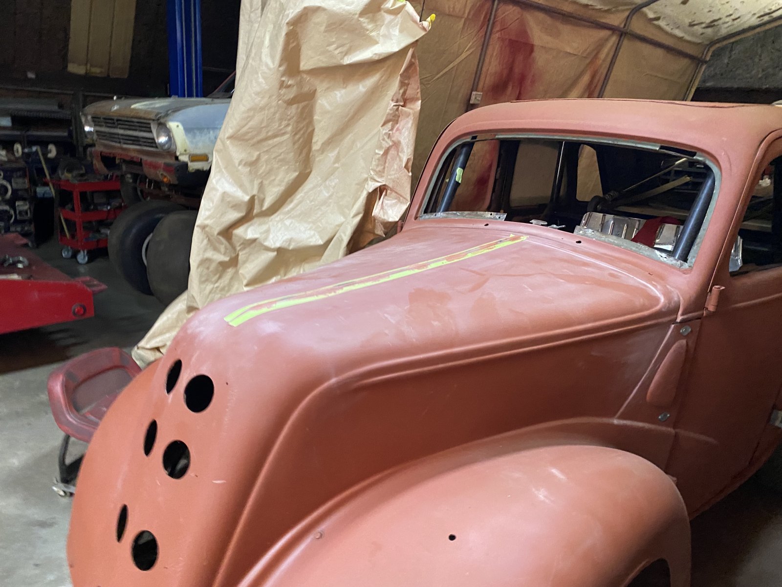

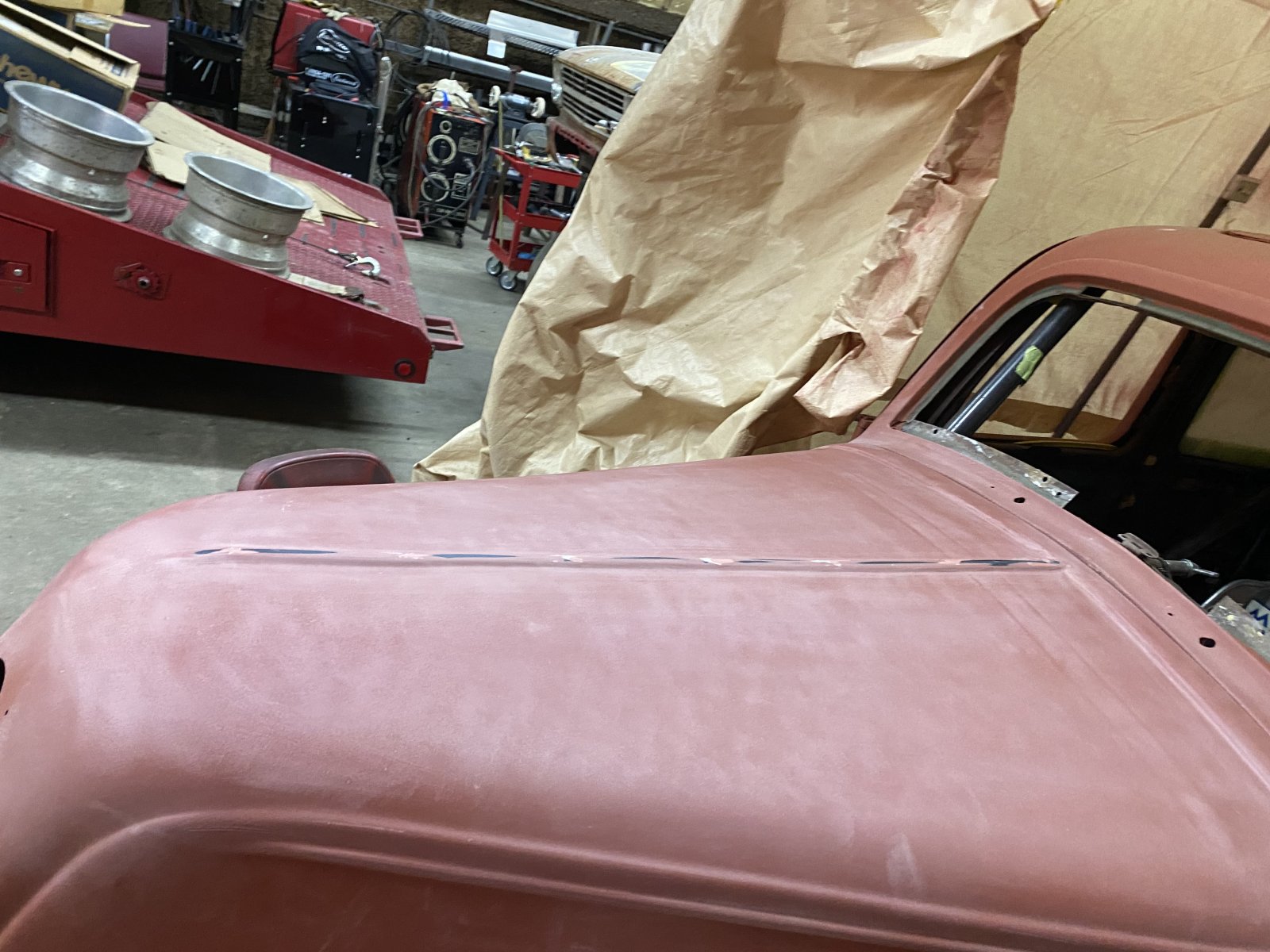

    Trying to get that top ridge /rib smooth and slick. Blocked twice and found two more spots. This high build Clause primer /base has had 4 years to cure its sanding well enough but it’s taking 400 to do it. Would like that rib to be as nice as possible since it will be more visible but in the end is a race car. It will get scratched. IMG_2812.jpeg IMG_2811.jpeg

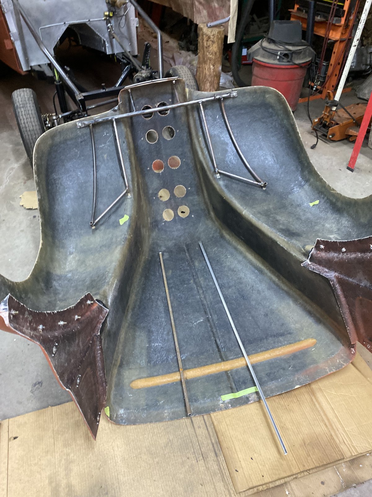

  15. Mitchell Rish
    Joined: Jun 10, 2007
    Posts: 2,375
    Mitchell Rish
    from Houston MS
    Looking better. Blocking as I go.

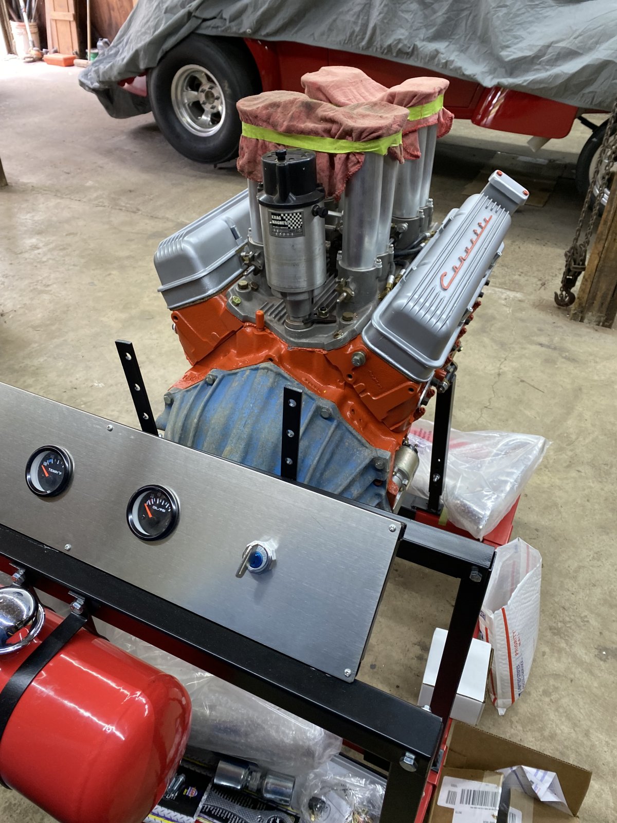

    Getting ready to run the Prefect engine in on stand. Gotta decide whether I am doing a full radiator /using the water hose set up deal /or try to build an expansion tank like I see on all the dynos. Need to get up to temp but don’t won’t an over built deal that’s a pain to store. lol

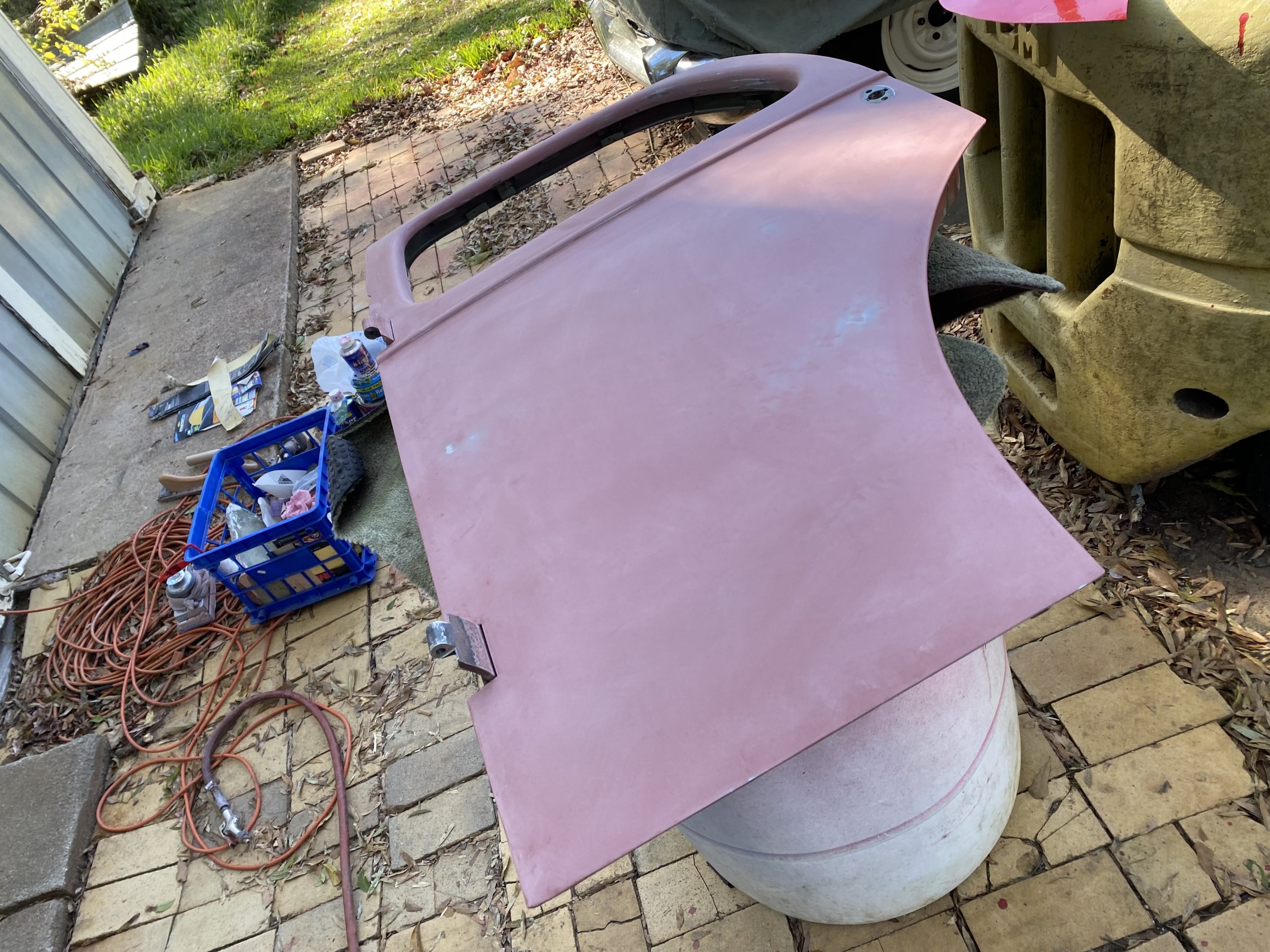

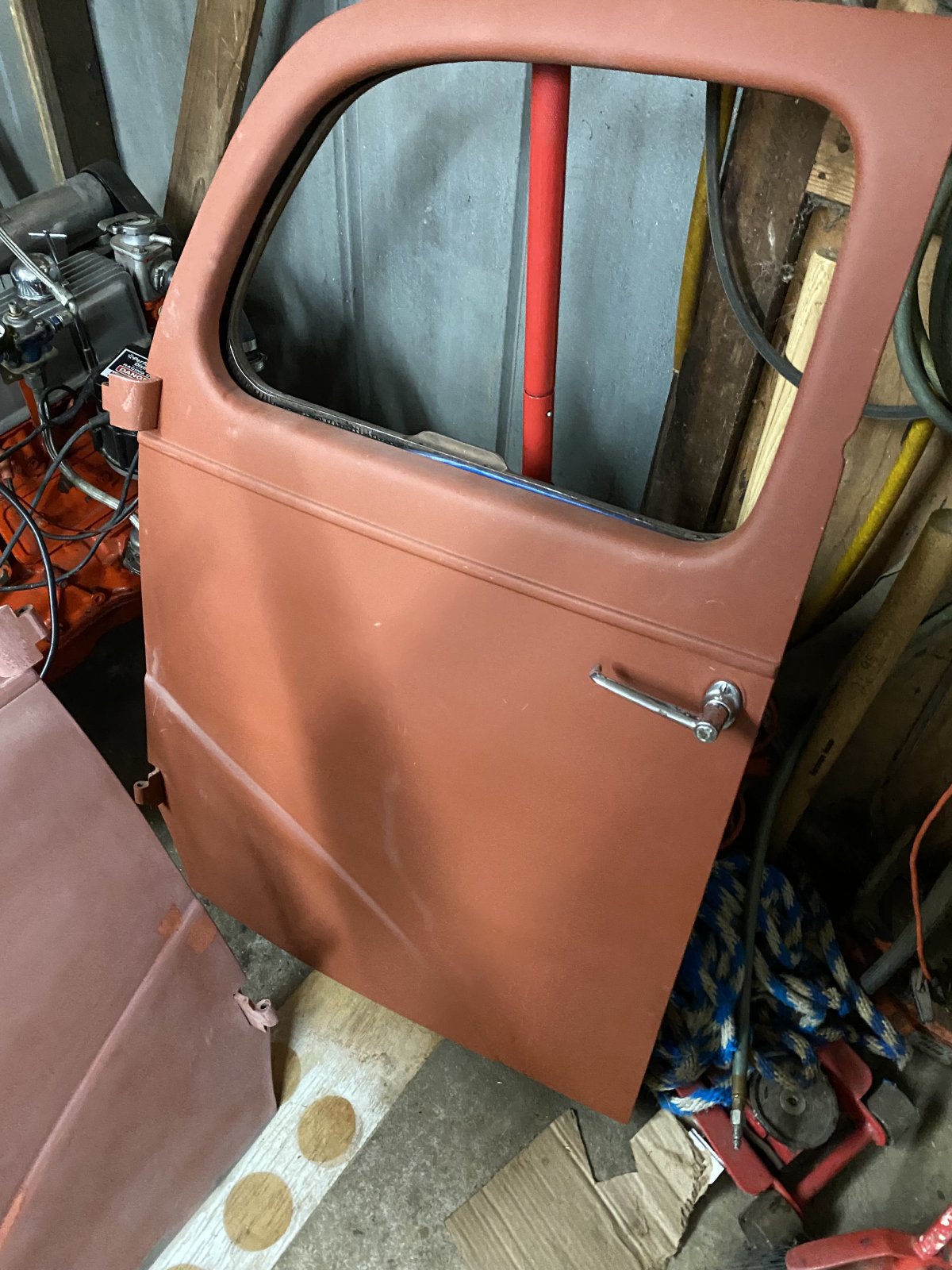

    Started blocking and sanding front doors. Found a few spots. However I think it’s going go pretty good. The plus is that this time I’ll literally be able to paint with all but the cowl and body on saw horses and horizontal if I chose. Or that’s the plan. Everything I painted on the Willy’s on saw horses turned out great. The other -well you just have to go back and look at the build thread.
    It will be enamel (acrylic ) also. And maybe this time I won’t need to clear it. IMG_2866.jpeg IMG_2867.jpeg

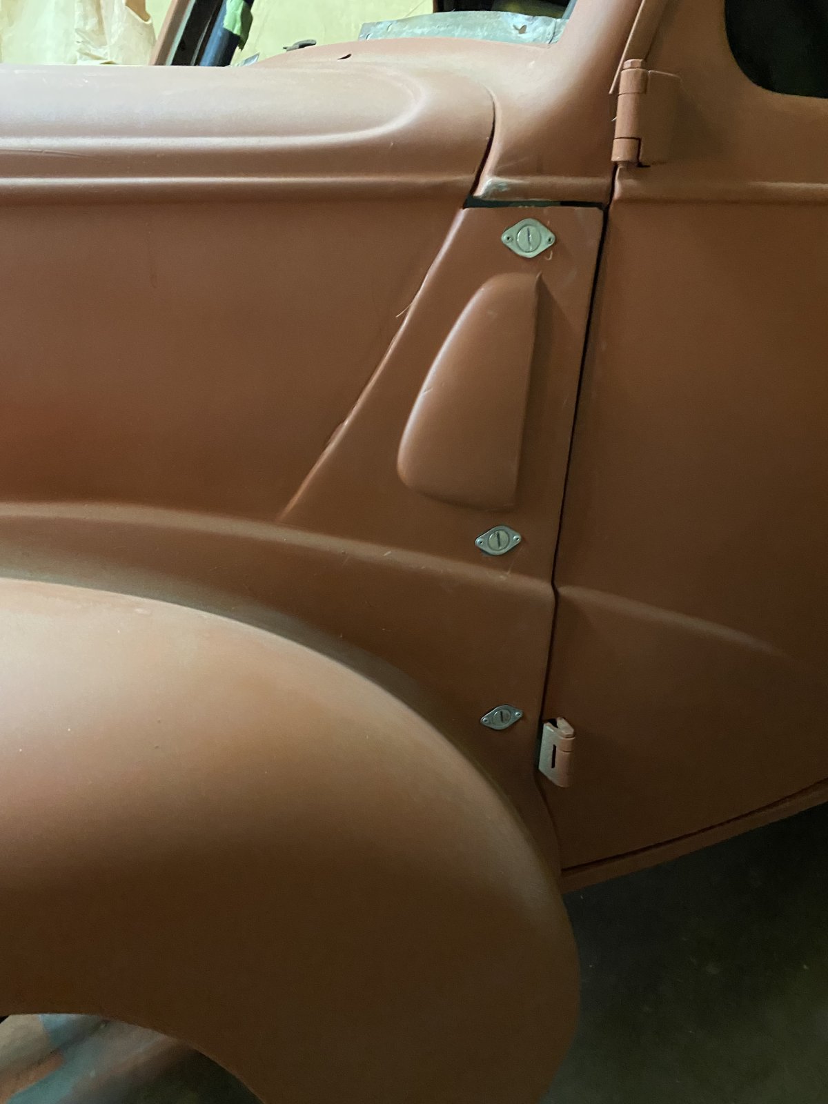

  17. Mitchell Rish
    Posts: 2,375
    Mitchell Rish
    from Houston MS

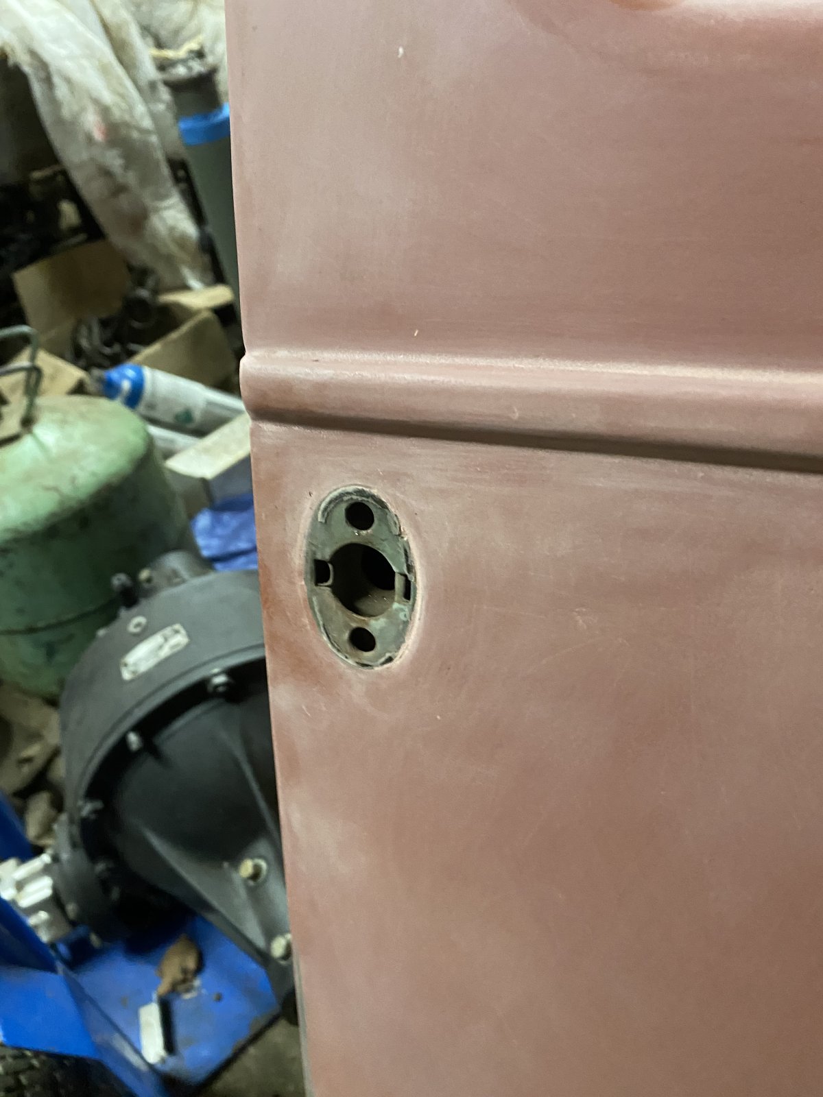

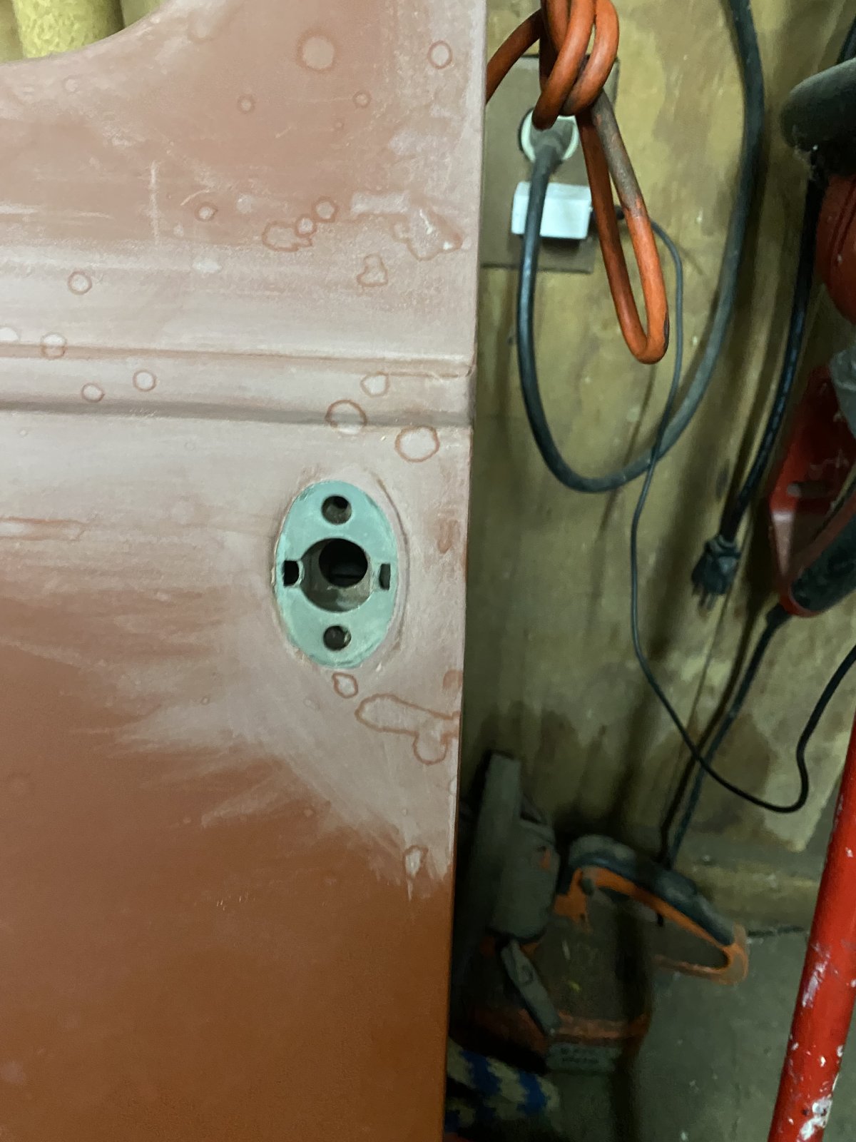

    More door work. Almost like to have never gotten the door handle screws lose. Anyone ever painted the balkalite inner door moldings. I need to know how to prep this stuff so it can be painted. If I ever figure out what color I am going to paint it. IMG_2881.jpeg IMG_2882.jpeg IMG_2883.jpeg IMG_2884.jpeg

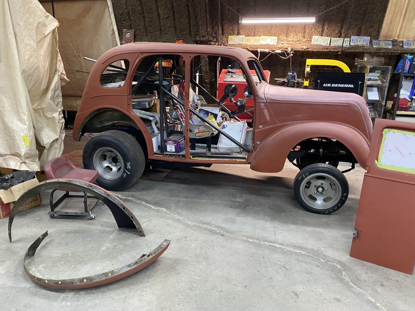

  18. Mitchell Rish
    Posts: 2,375
    Mitchell Rish
    from Houston MS

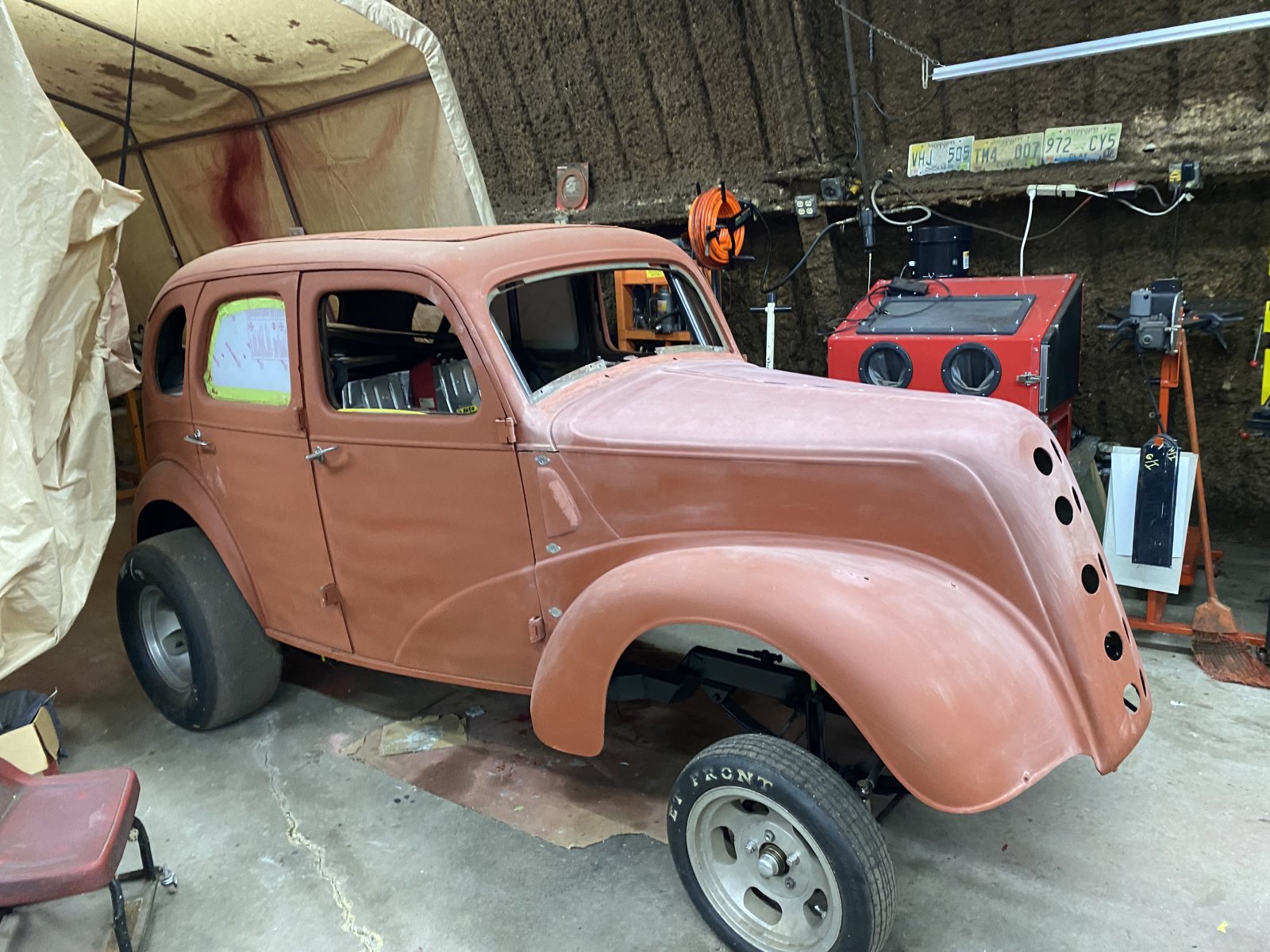

    Rear doors back off and rear fenders also. The Willy’s was never this small. Lol IMG_2900.jpeg IMG_2899.jpeg

  19. Mitchell Rish
    Posts: 2,375
    Mitchell Rish
    from Houston MS

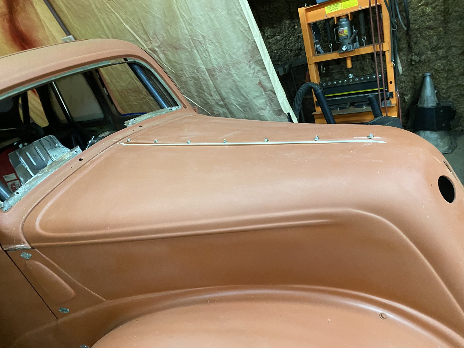

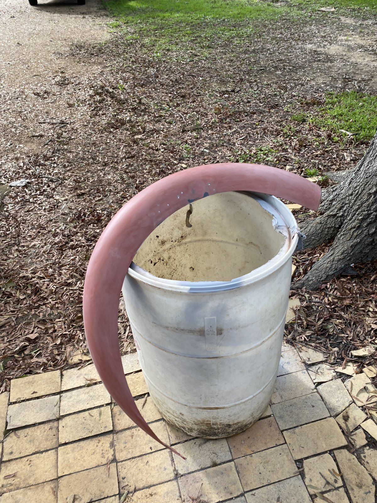

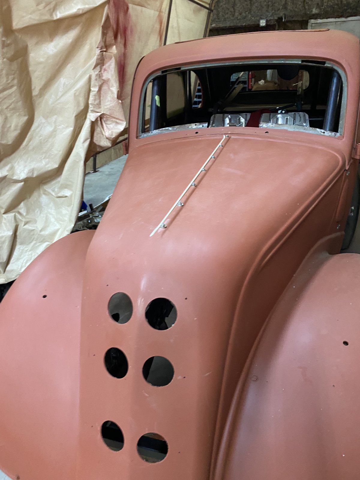

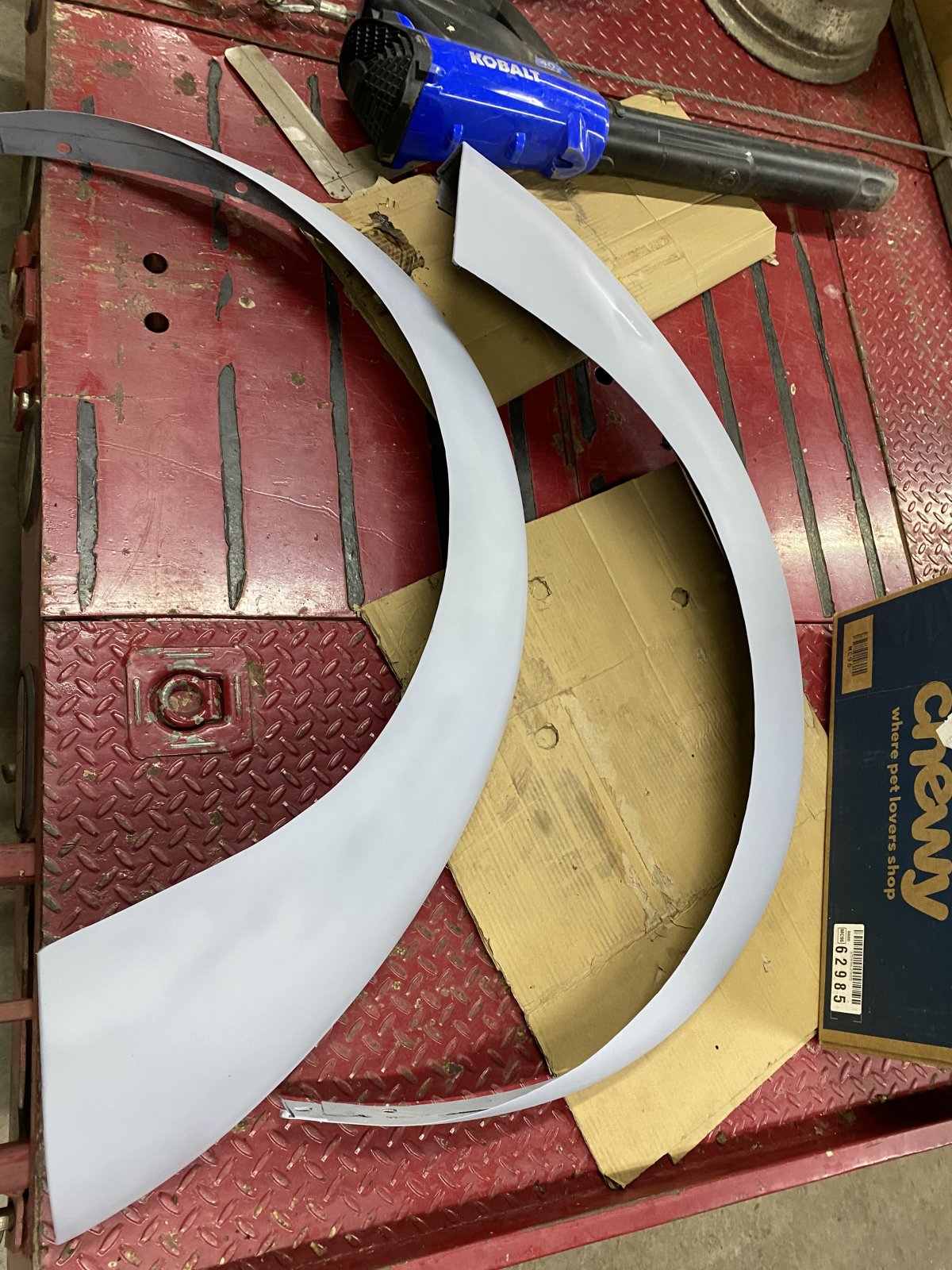

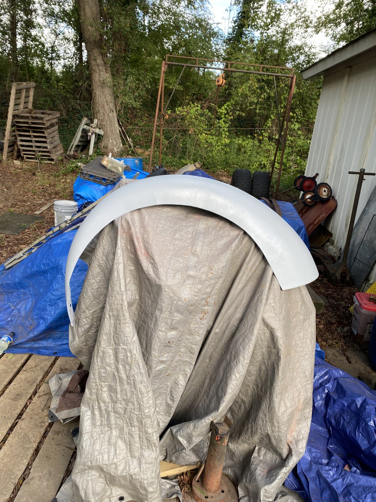

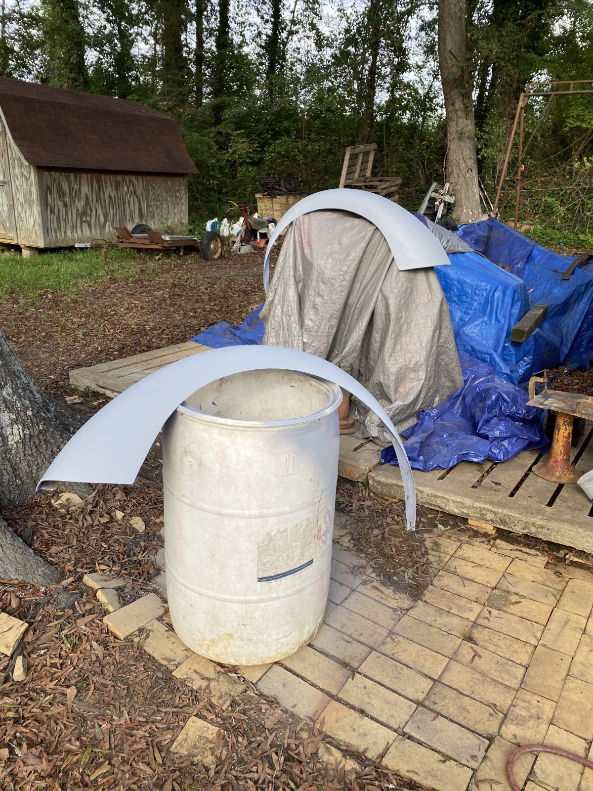

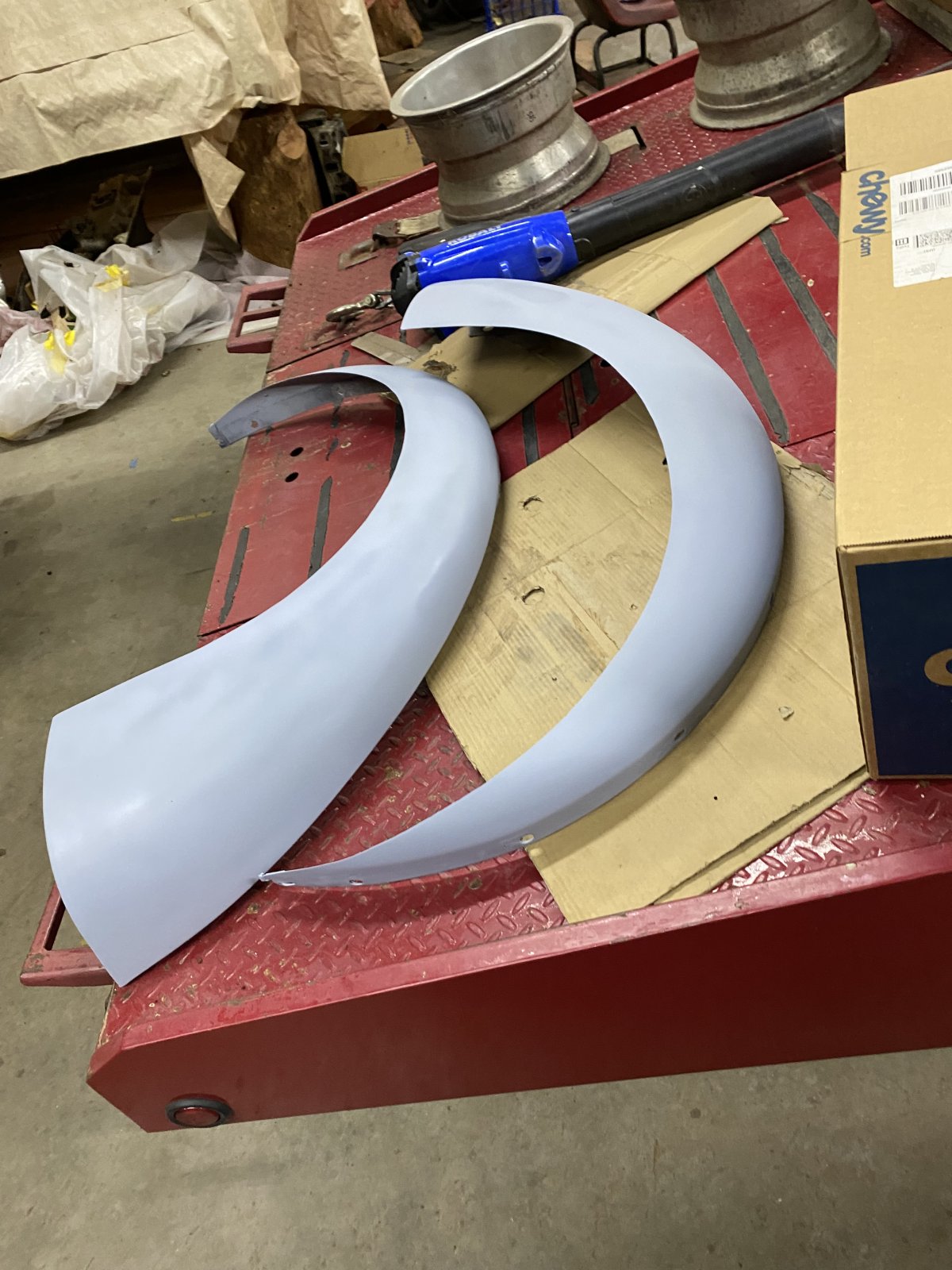

    Fenders blocked and sealed. I have come to the conclusion that they are far from straight but they are as good as they will be. I am starting to think light color might be the way to go.

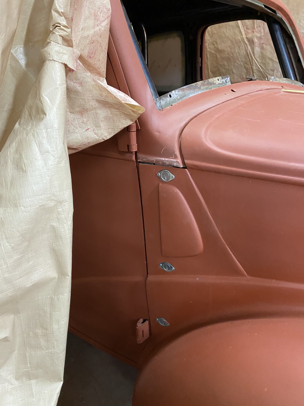

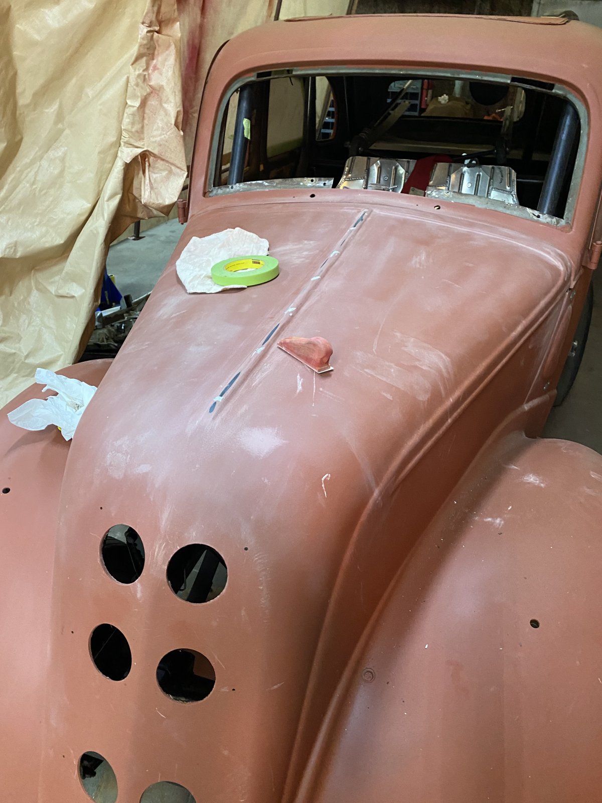

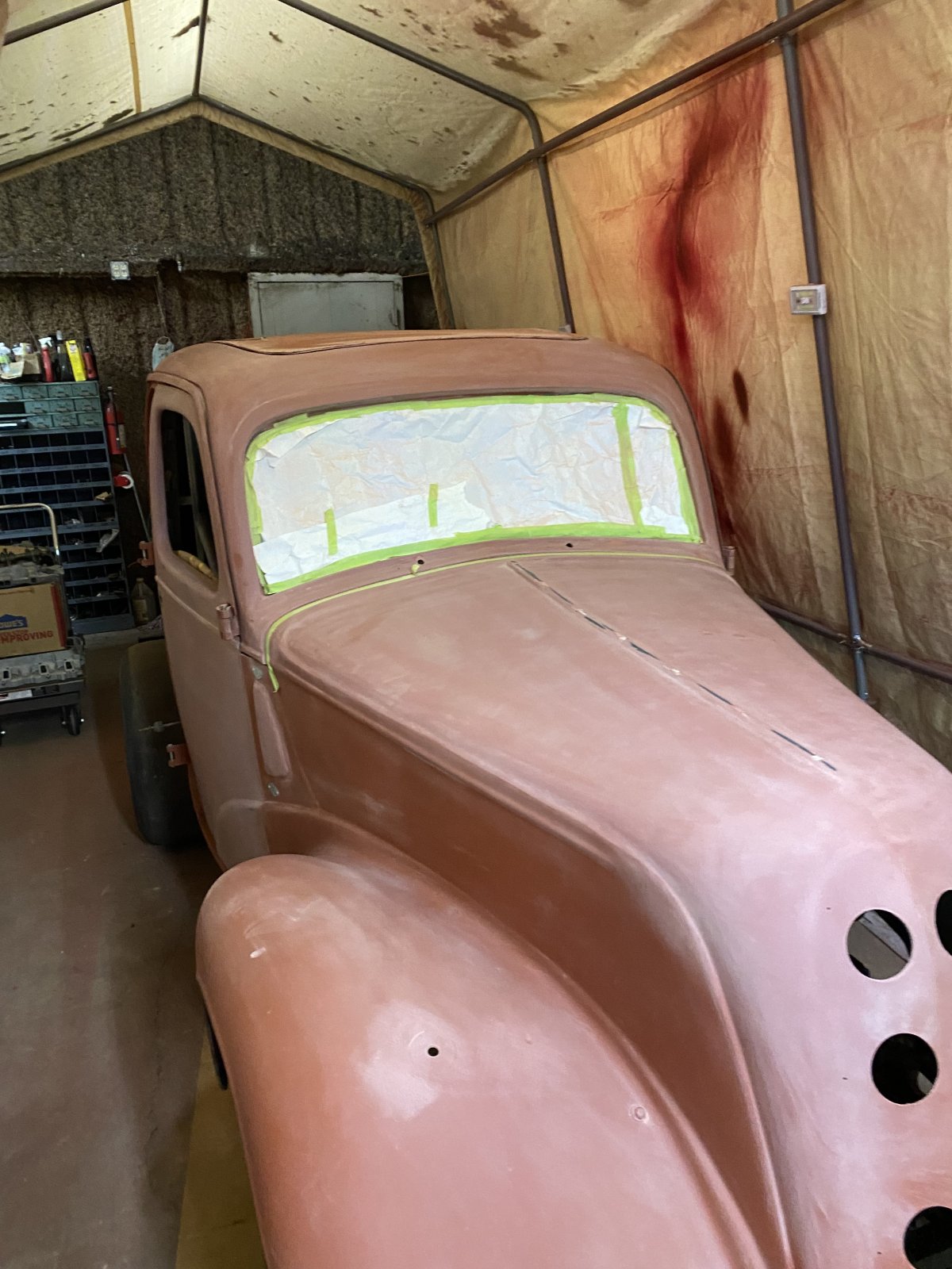

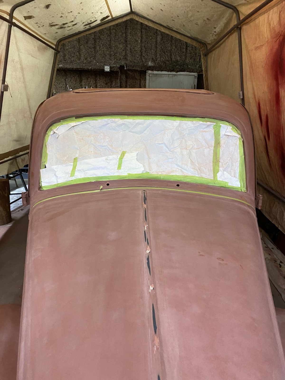

    Actually got the windshield /cowl area sanded and blocked and that clausen high fill did indeed fill almost all of those metal pits. But then again it has had four years to cure. IMG_2934.jpeg IMG_2933.jpeg

    Rear fenders sealed and ready for paint. They are as good as I think they will ever be. IMG_2965.jpeg IMG_2964.jpeg

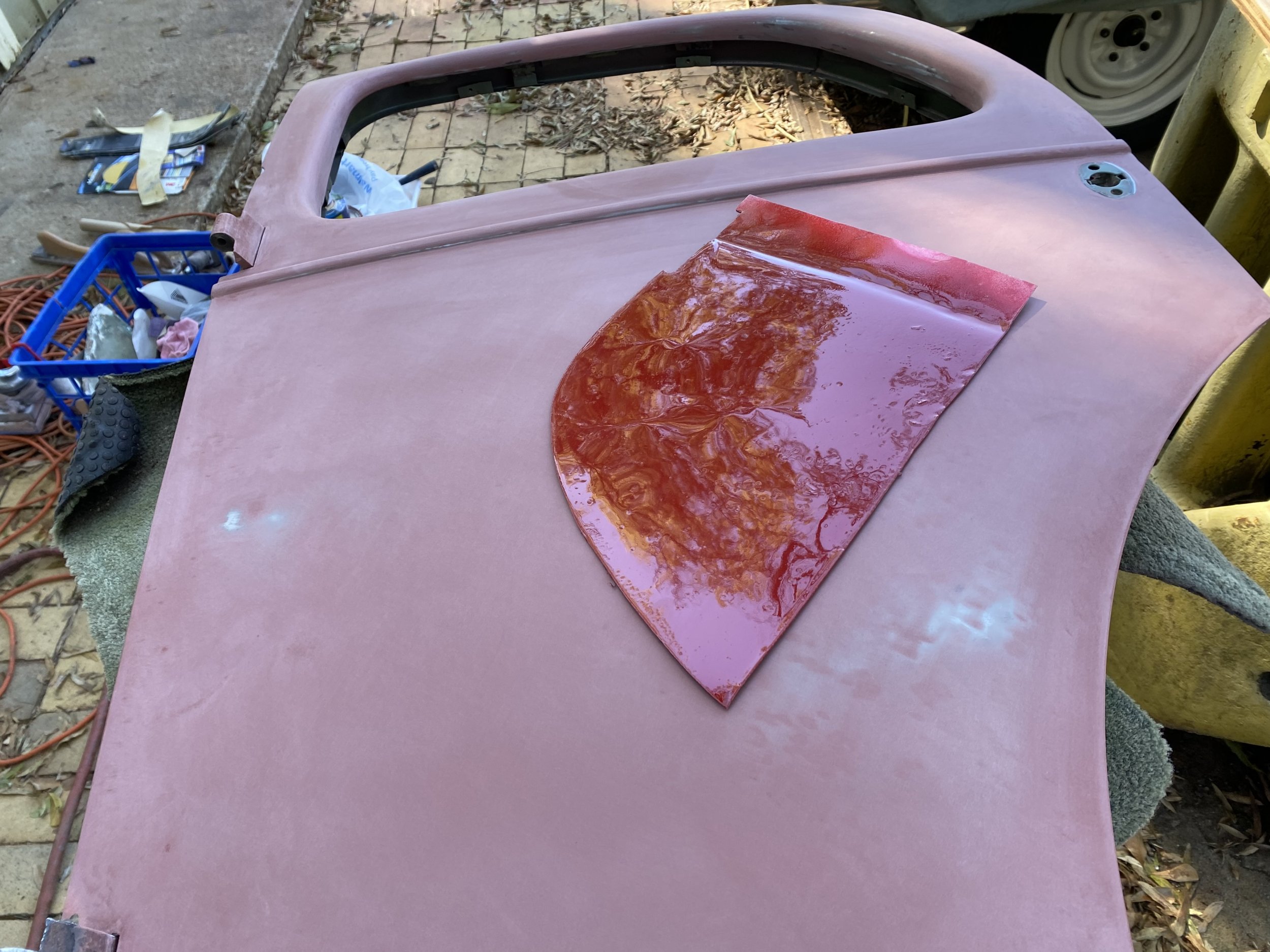

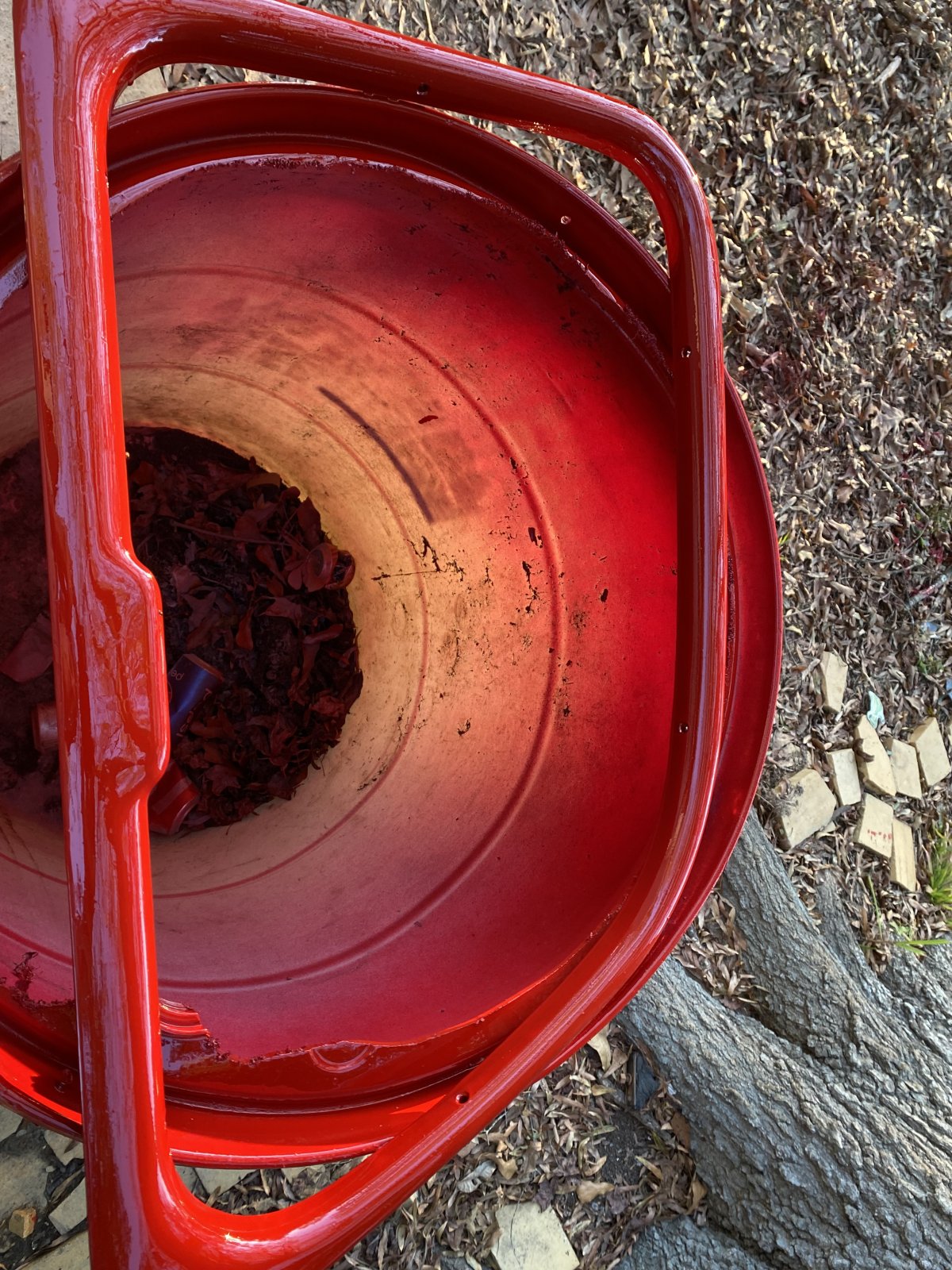

    Decided to test using the inner window moldings. scuff and shoot.
    Hard to be acrylic enamel when it’s right. There will be a funeral for one mosquito that wouldn’t bug off. Two coats later kinda sealed the deal. IMG_2978.jpeg

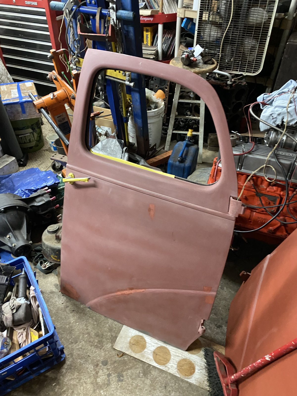

  23. Mitchell Rish
    Posts: 2,375
    Mitchell Rish
    from Houston MS

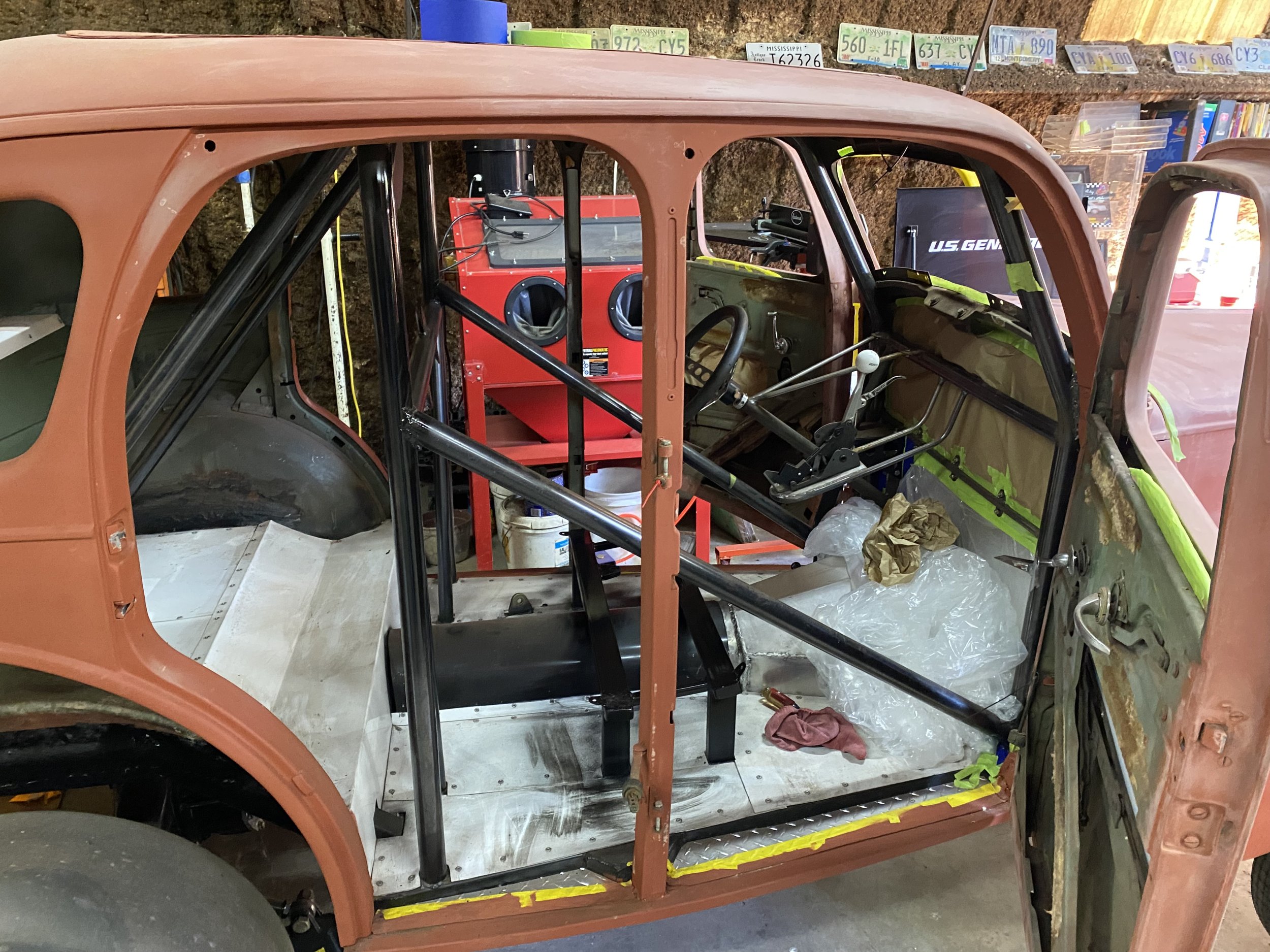

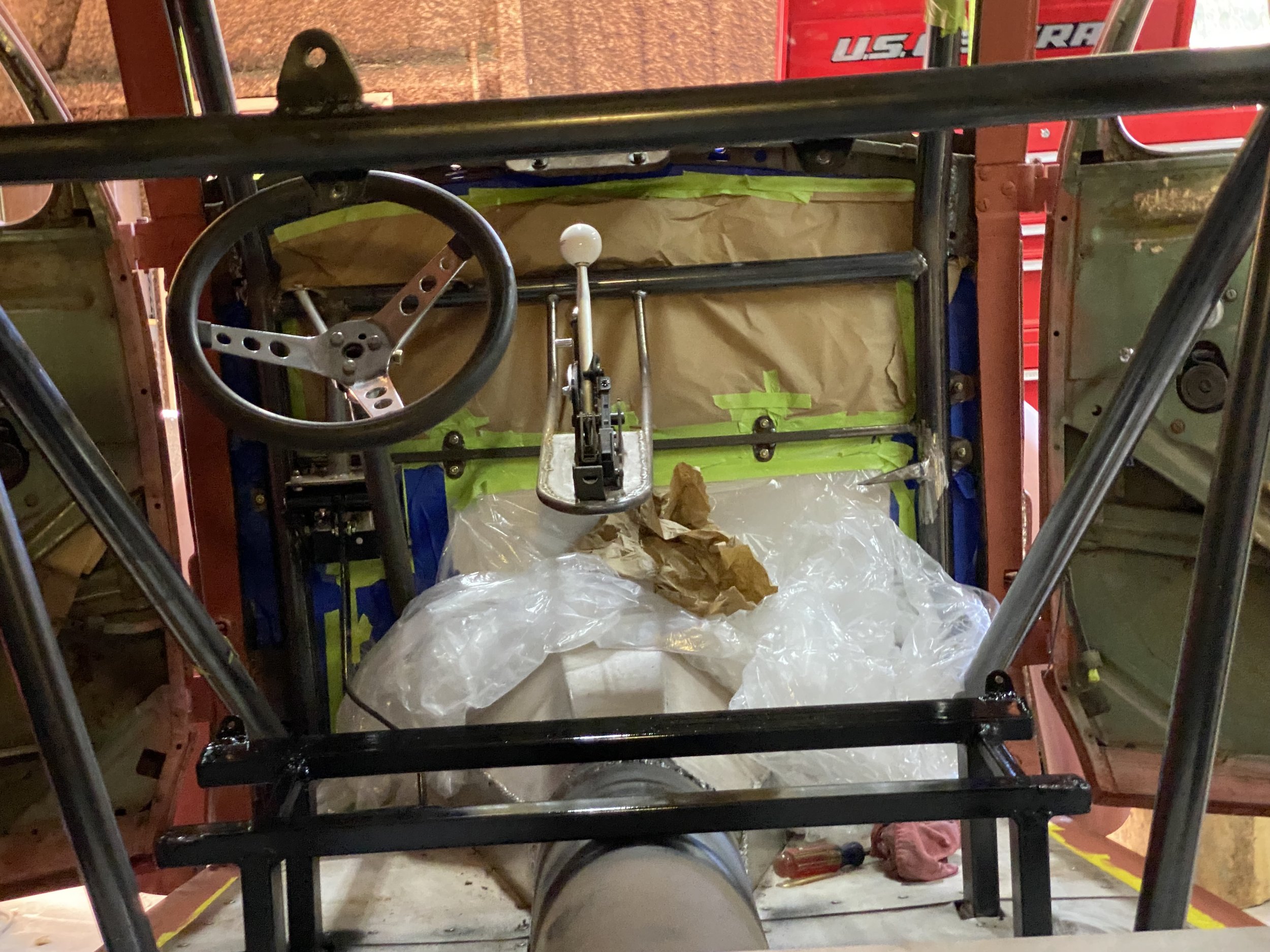

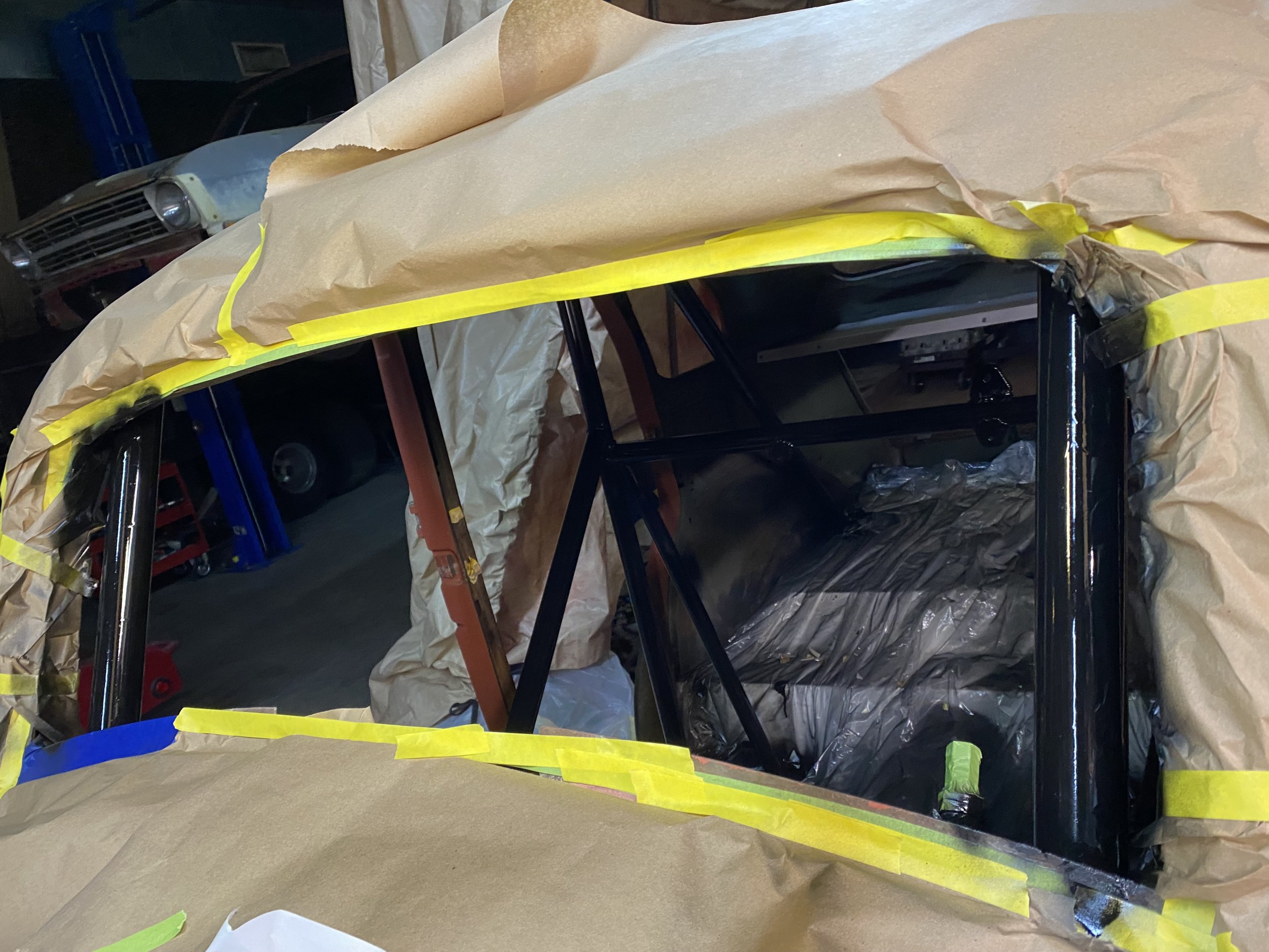

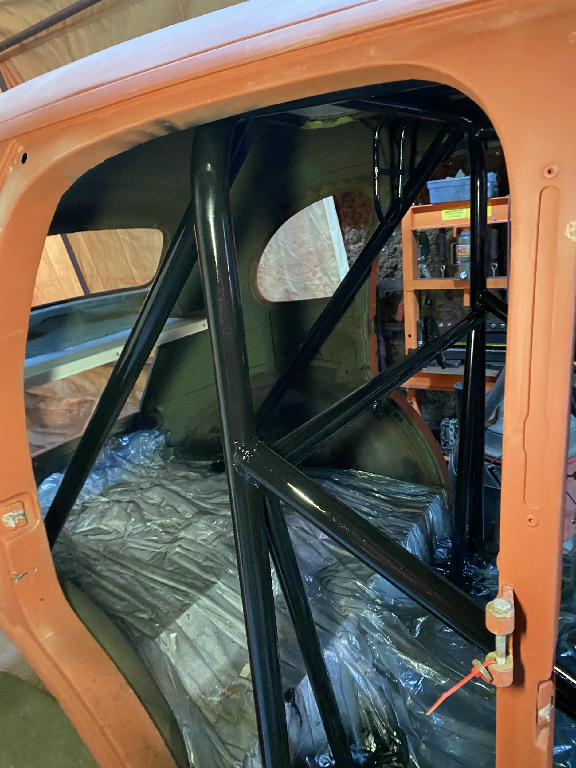

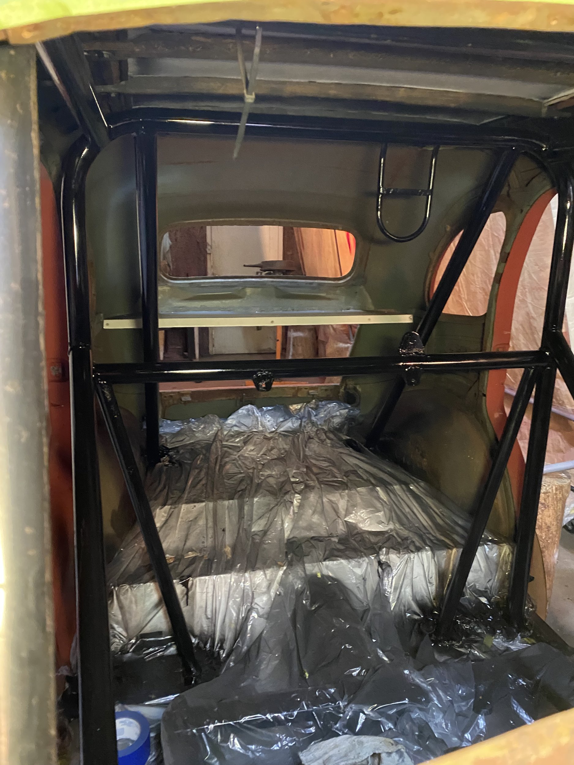

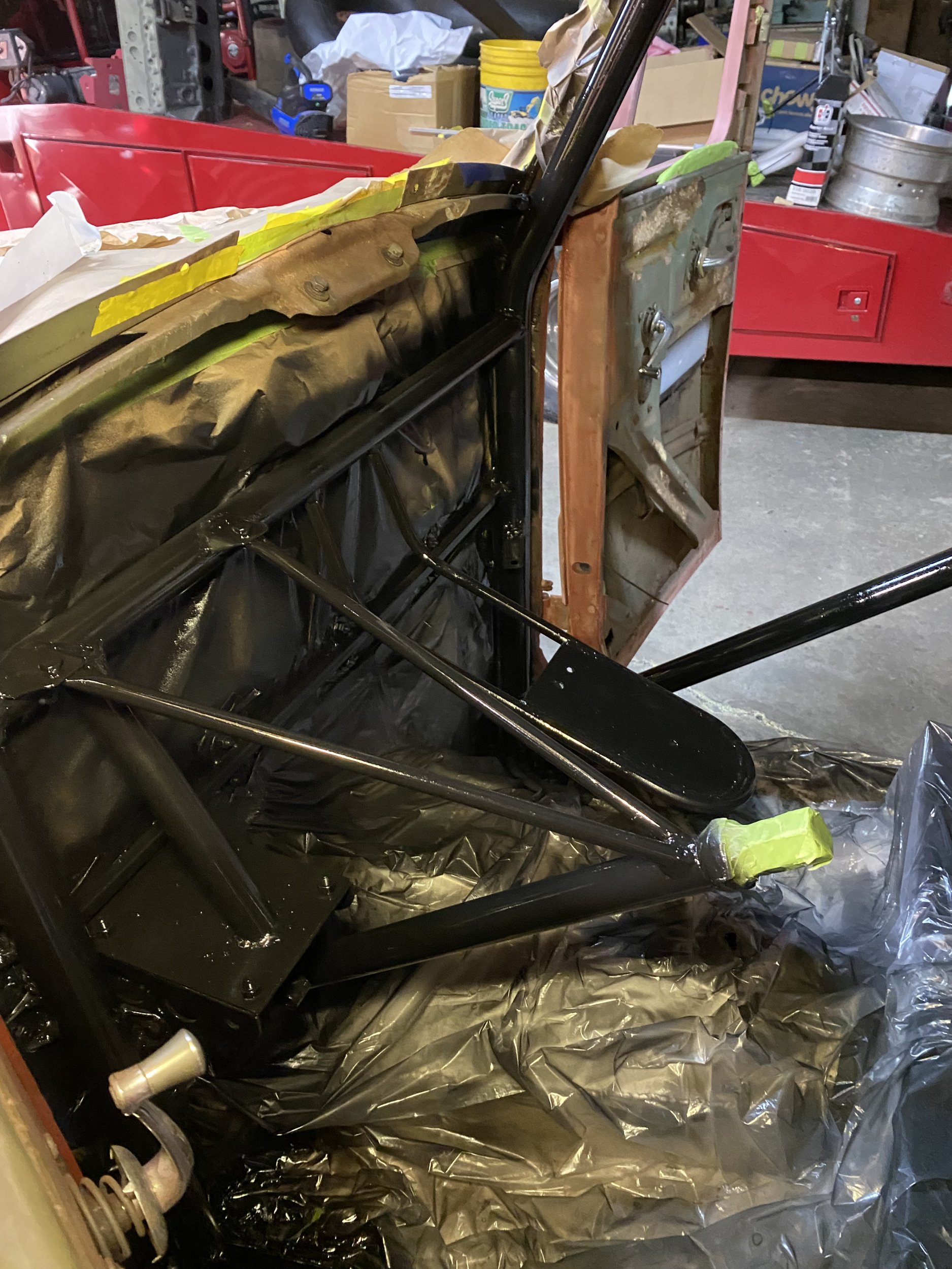

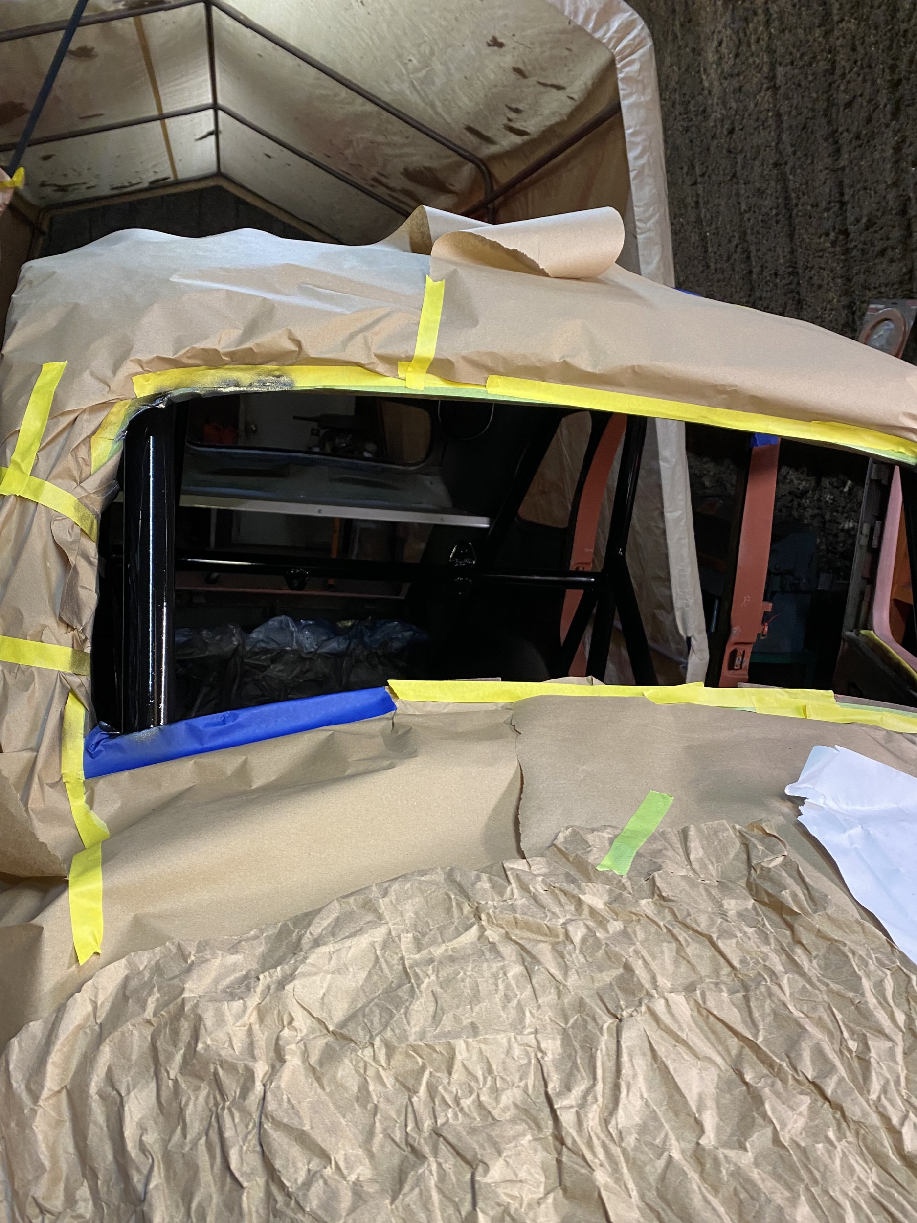

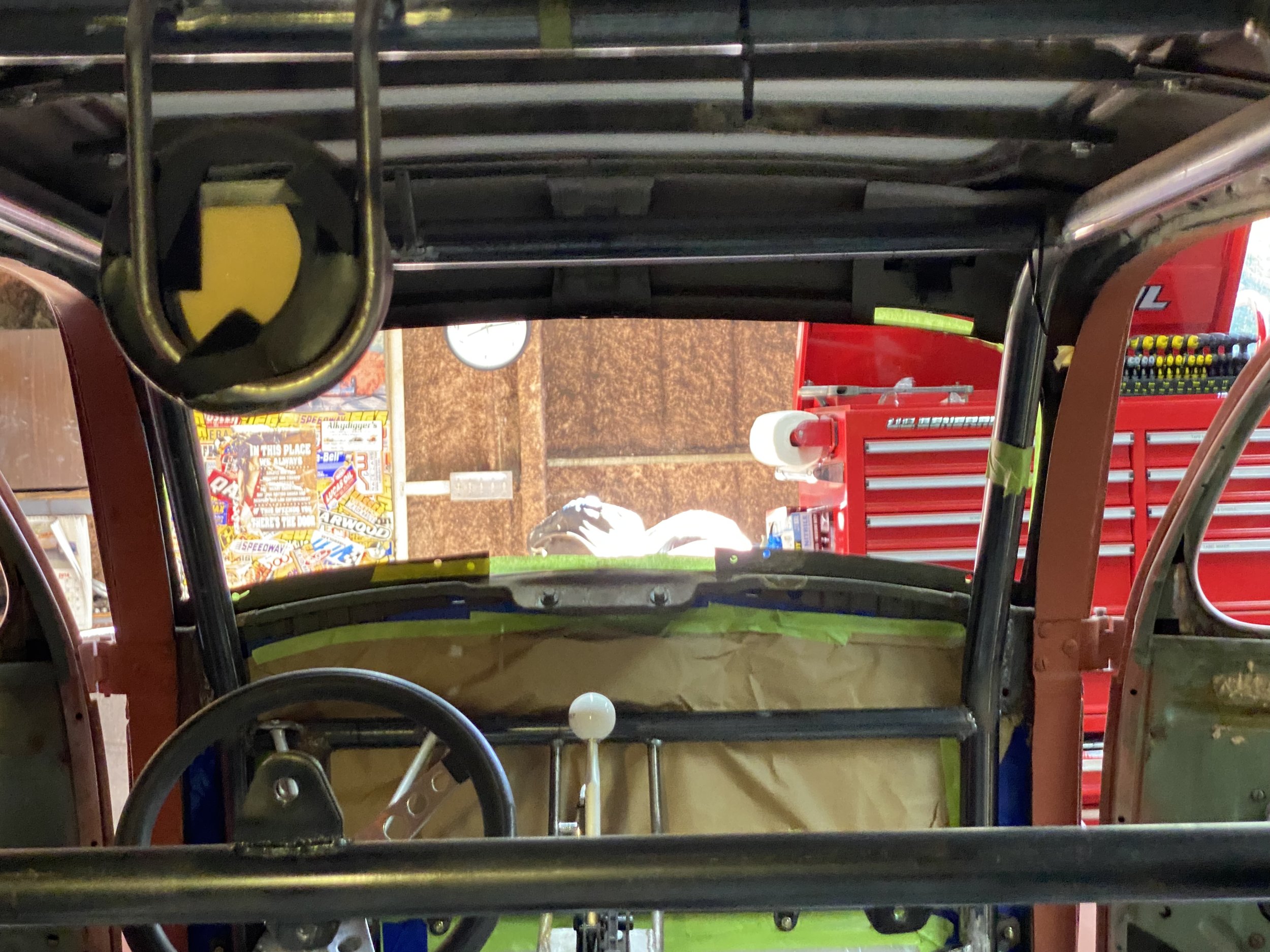

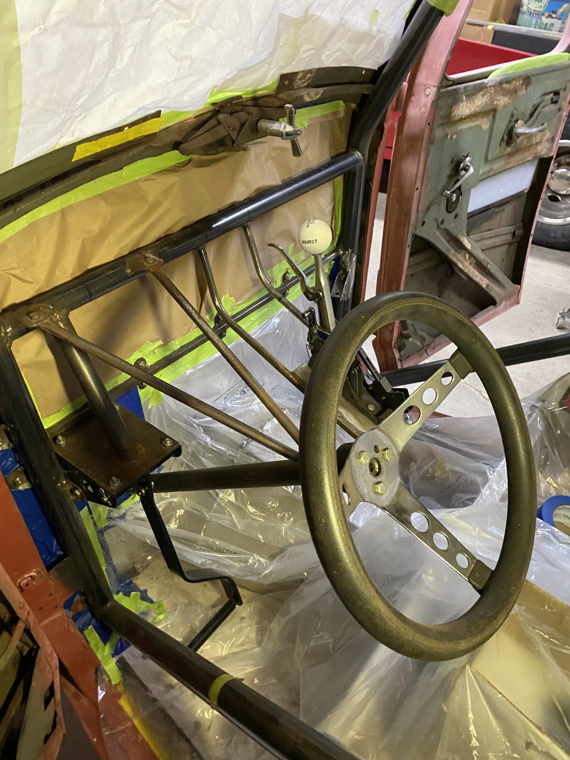

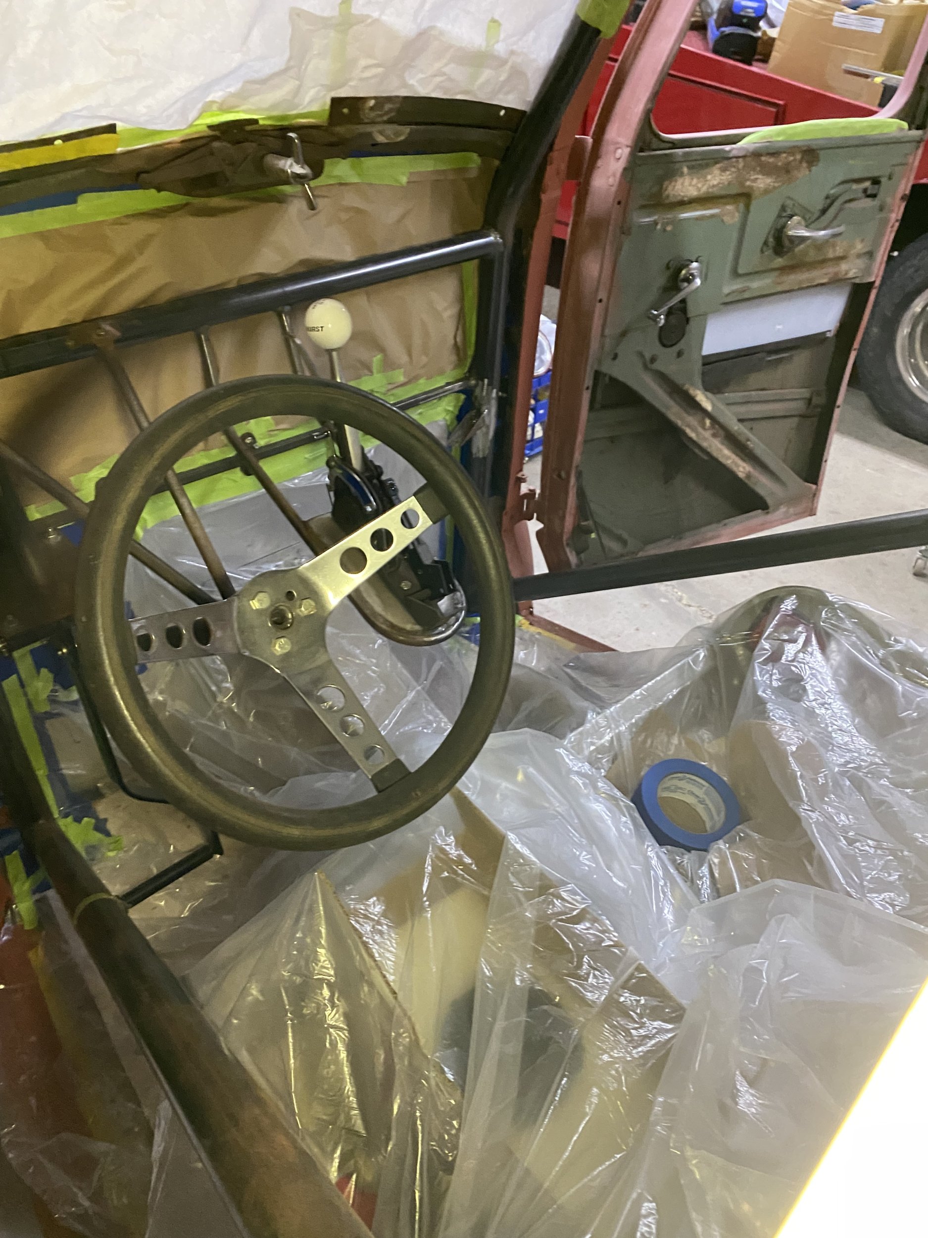

    IMG_3023.jpeg IMG_3022.jpeg IMG_3021.jpeg Started masking for painting of roll cage and the inner door jams and inner window panel edges.
    I hope those damn solid rivets I used look good under the hood because I forgot when I put them in that it means my firewall won’t come out without drilling them back out. Genius move of mine. . So now in order to paint cage etc properly I have to spend a lot of time masking. the steering hub/wheel and the shifter obviously will unlock/bolt so that’s not a problem. Still haven’t made up my mind what color for the cage.
  24. Mitchell Rish
    Posts: 2,375
    Mitchell Rish
    from Houston MS

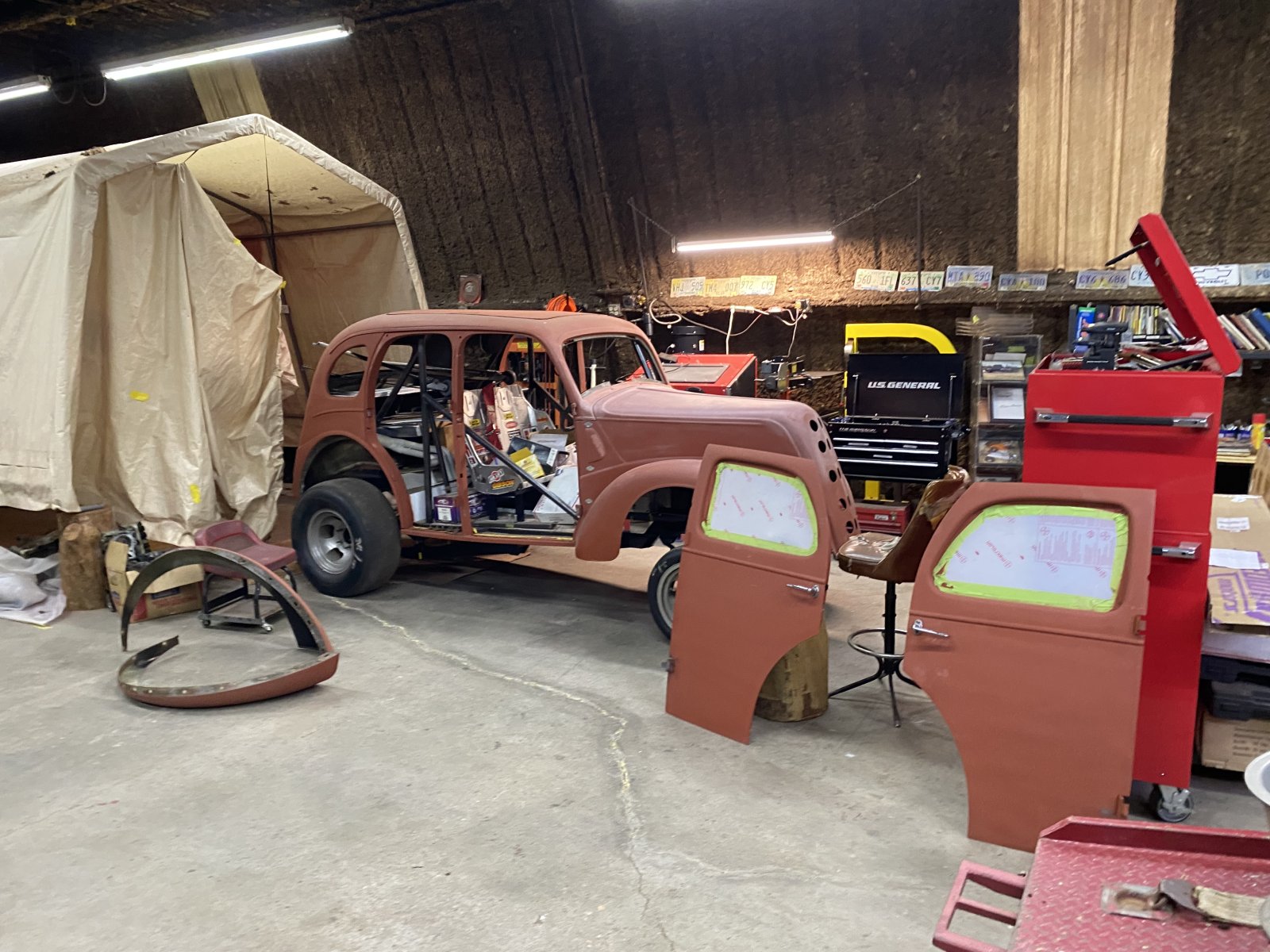

    IMG_3043.jpeg IMG_3044.jpeg IMG_3045.jpeg Last door blocked. It’s as straight as it’s gonna be. Been having flashbacks of metal flake

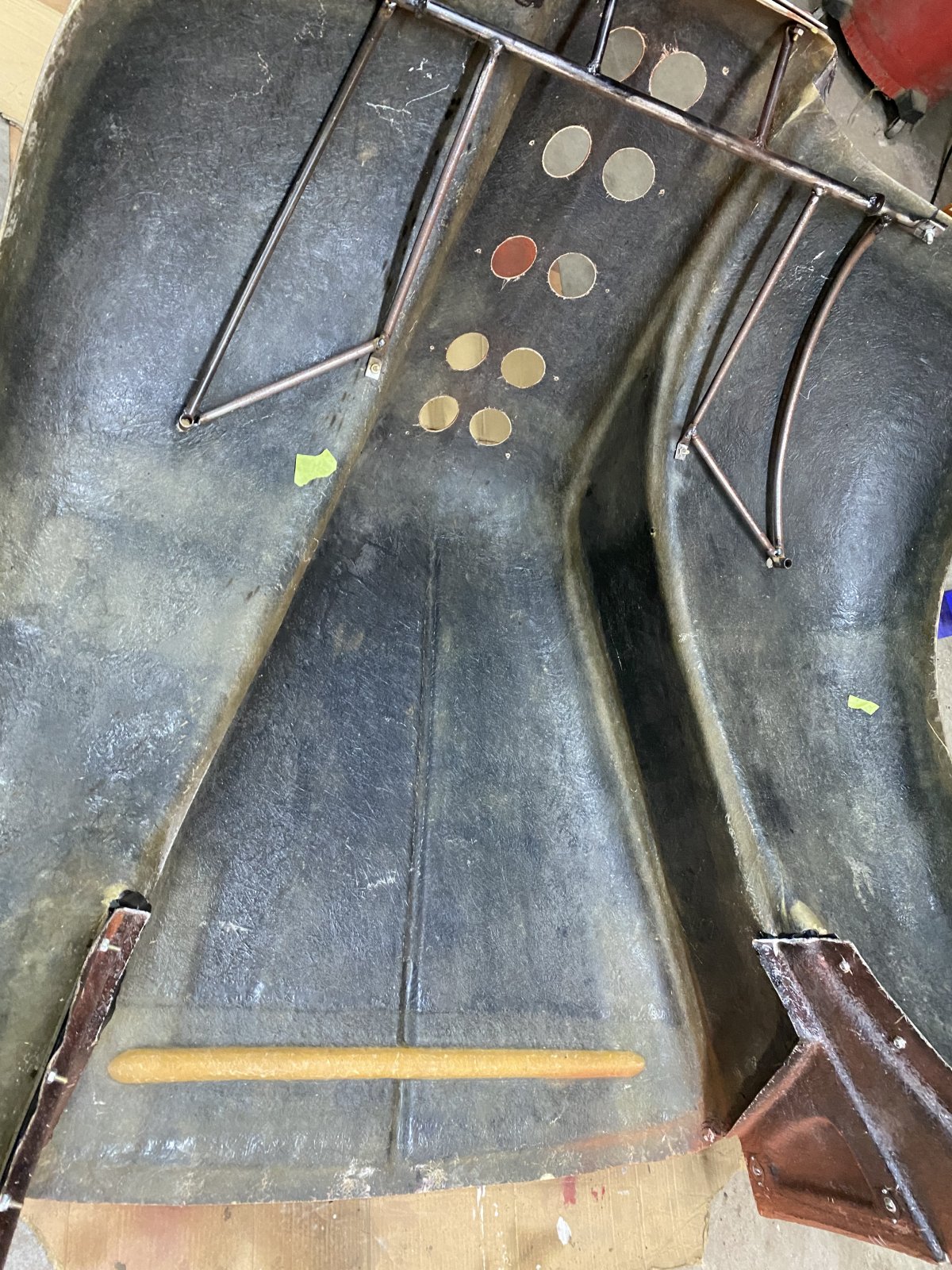

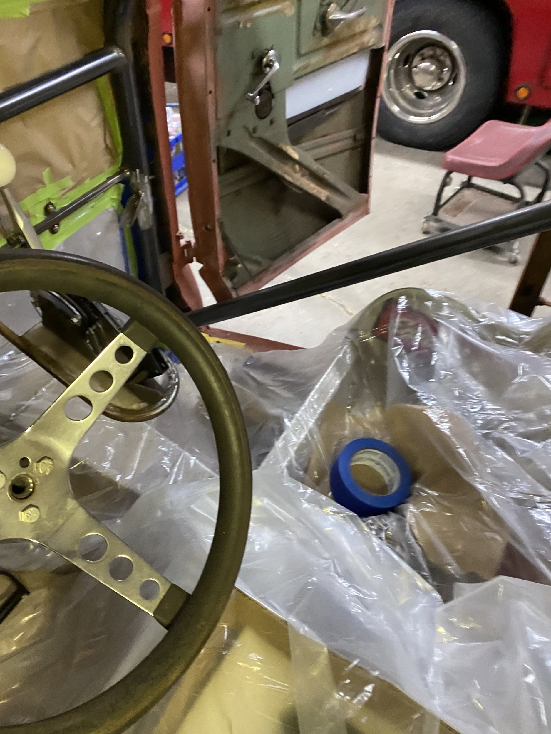

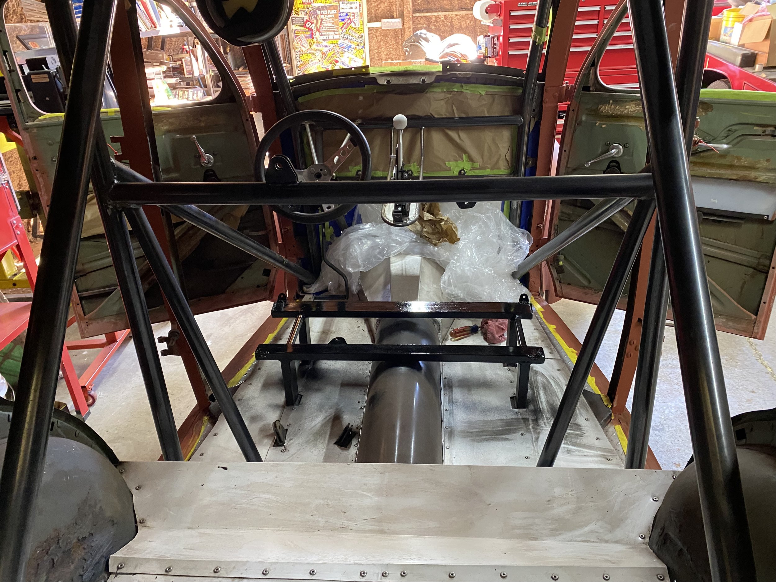

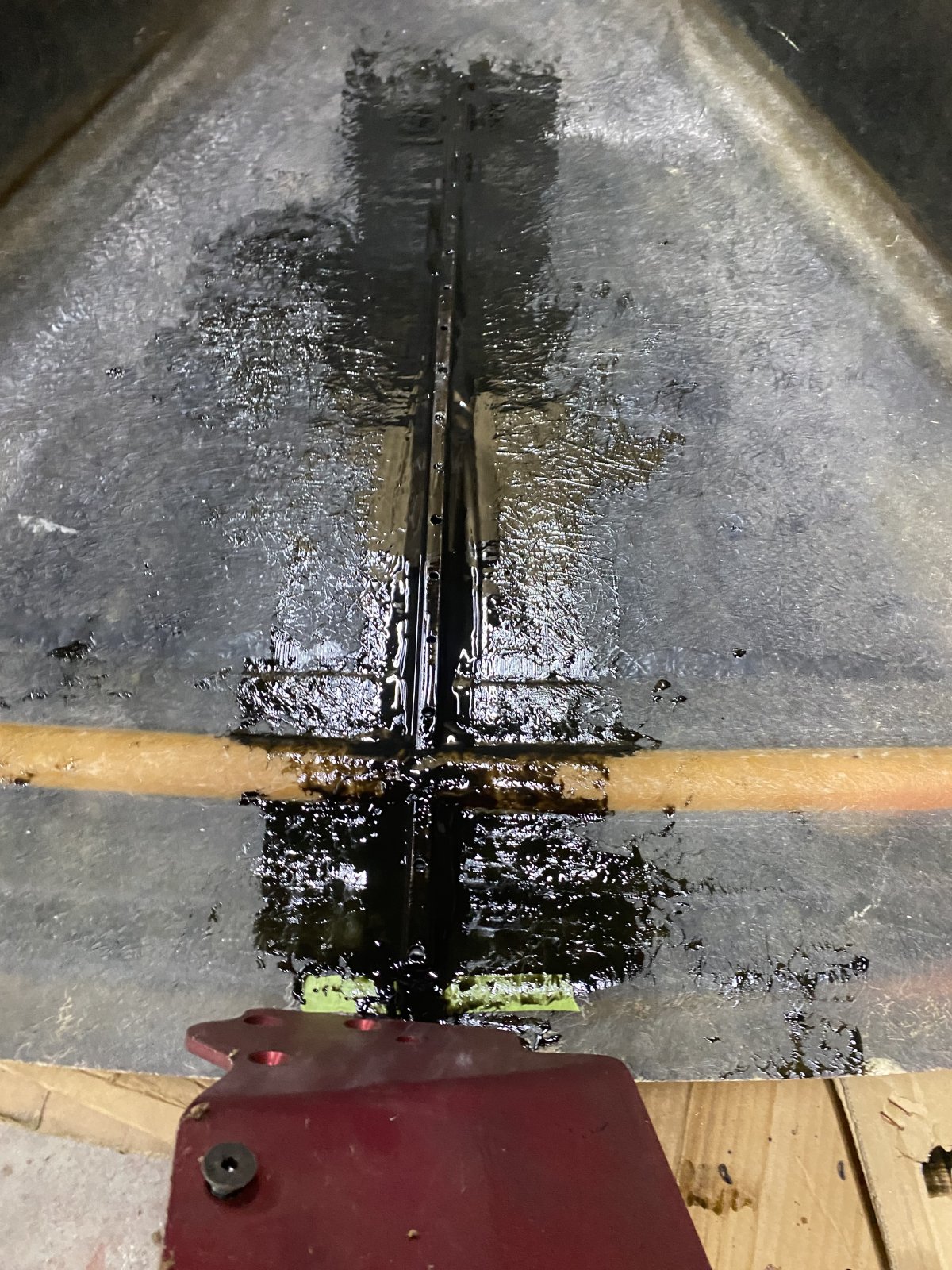

    Interior gutted. Removed everything that I couldn’t mask off or easily scuff down for paint.
    Cage first. Cure then wrap in aluminum foil. Then inner window edges and then roll the rapture coating on the floor and certain panels.
    The inner doors and the back valence package tray will get aluminum bead roll panels out of what every aluminum I have left. I’ve got half a sheet of natural aluminum left. So we will see. I think I am going Black on cage. Red on door door jams and inner window edges. And then the silver/gray on the floor to match the firewall and trans tunnel.
    I was shocked by the thickness of the dust layer -and remember it’s been indoors the whole time.
    The original wooden bows were put back in to keep vibration down. Gotta figure out what color to paint them with. IMG_3075.jpeg IMG_3076.jpeg IMG_3078.jpeg IMG_3077.jpeg IMG_3079.jpeg IMG_3080.jpeg IMG_3075.jpeg

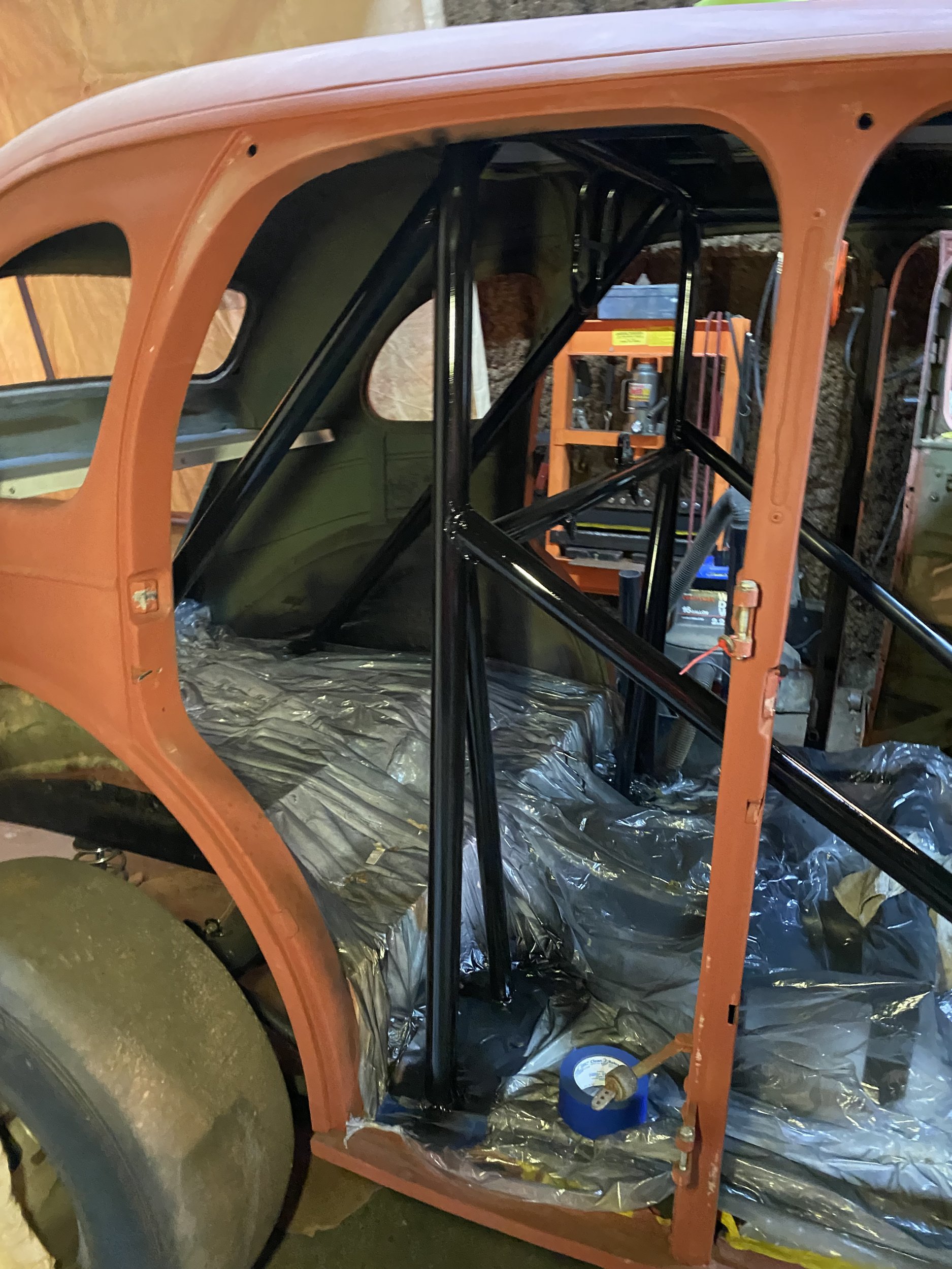

  27. Mitchell Rish
    Posts: 2,375
    Mitchell Rish
    from Houston MS
    Back half of the cage took pretty well. I’ll finish the front section in a day or so. word of caution when using ch***is/cage enamel. It must be clean of residue or it will blister in about 10 sec. I like the way it’s a smooth semi gloss but not a shiny shiny black. Still gotta figure out how I am painting the wood bows. As soon s the cage is completely painted and cured I’ll mask with tin foil. And then paint the rest with rapture liner tinted metallic aluminum. That will match the firewall and aluminum tunnel. Floor will also be done the same. I like a light color on floor so things don’t hide and you can find them when you drop them IMG_3106.jpeg IMG_3107.jpeg IMG_3108.jpeg IMG_3109.jpeg

  29. Mitchell Rish
    Posts: 2,375
    Mitchell Rish
    from Houston MS
    It’s a least laying down pretty well. I am cheating in the fact that I am doing the ch***is roll cage rattle can dance. If I had used any color than black it would have been a whole new deal. You still have to mask and prep. I sprayed the inner panels/roof and floor on the Willy’s. After I rolled the 57 floor and inner panels I’ll Probobly only spray what I can t reach or get to. I was super happy with how the 57 turned out.
    mad mikey and loudbang like this.

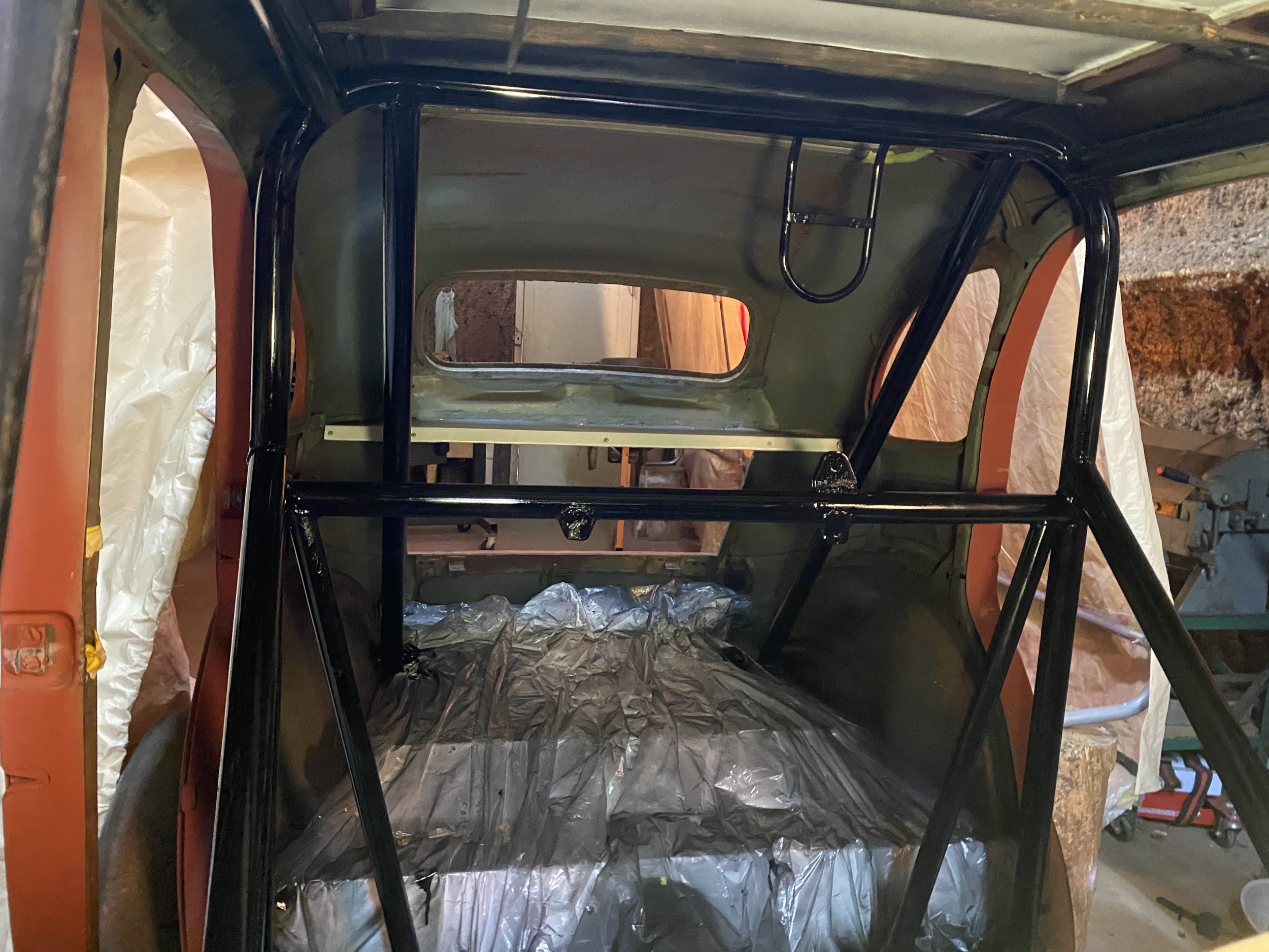

  30. Mitchell Rish
    Posts: 2,375
    Mitchell Rish
    from Houston MS
    Ok. Front section of cage painted. Luck ran out lol. For what ever reason the paint blistered on p***enger side diagonal. Let it cure and sand it down and fix that spot. Had some over spray there are a few places that I am glad they are not in the open. IMG_3110.jpeg IMG_3111.jpeg IMG_3112.jpeg IMG_3114.jpeg
