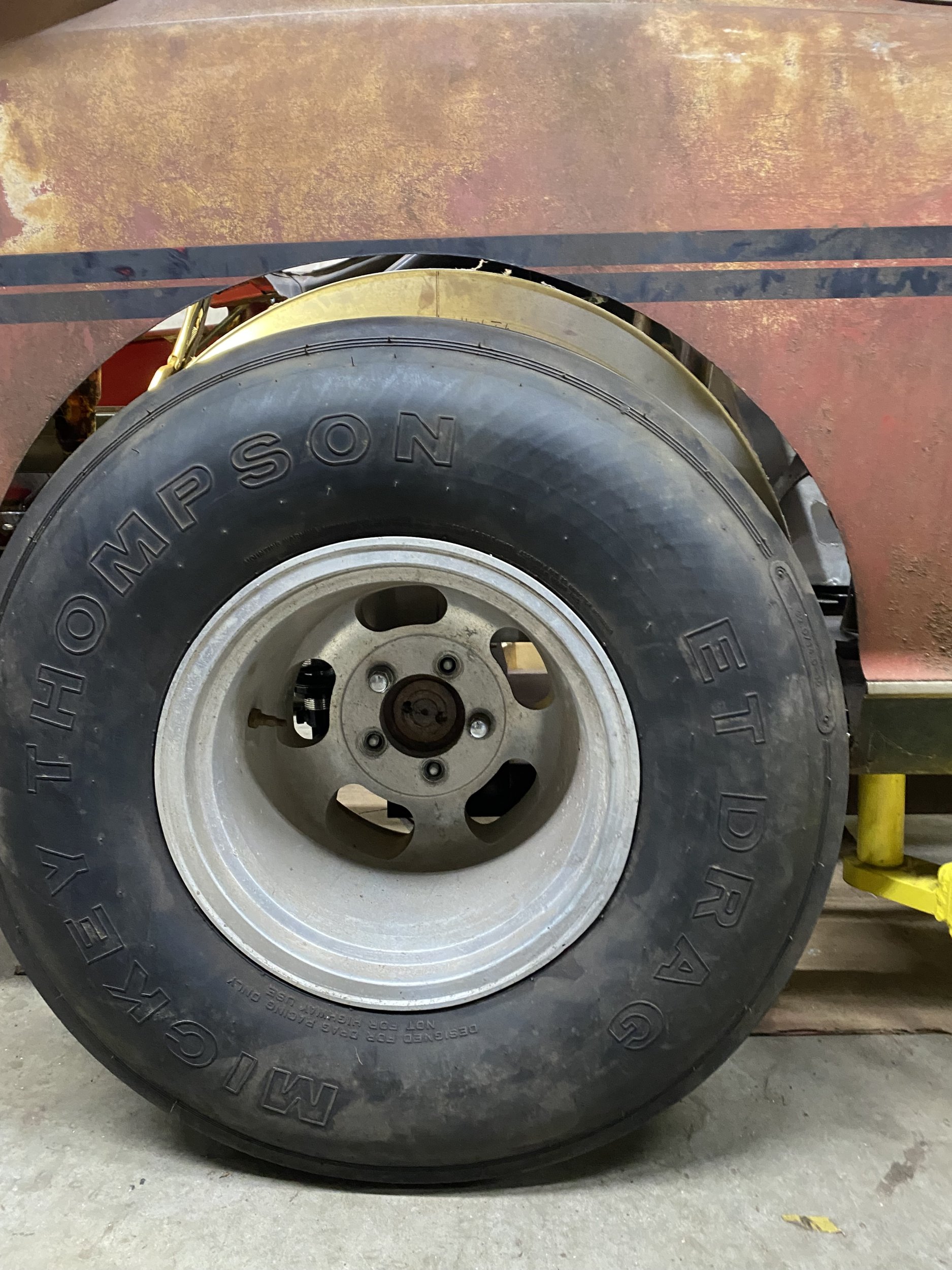

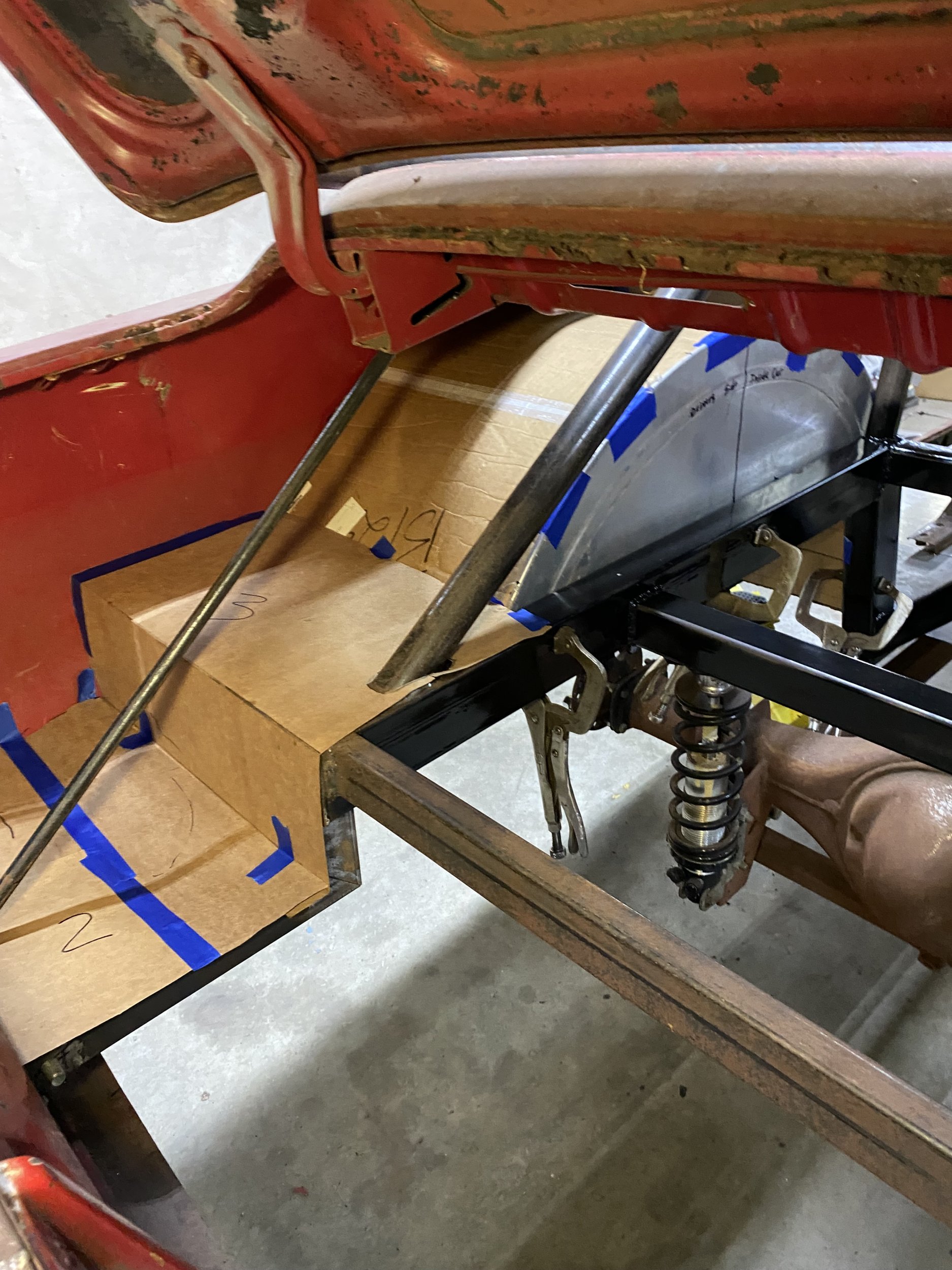

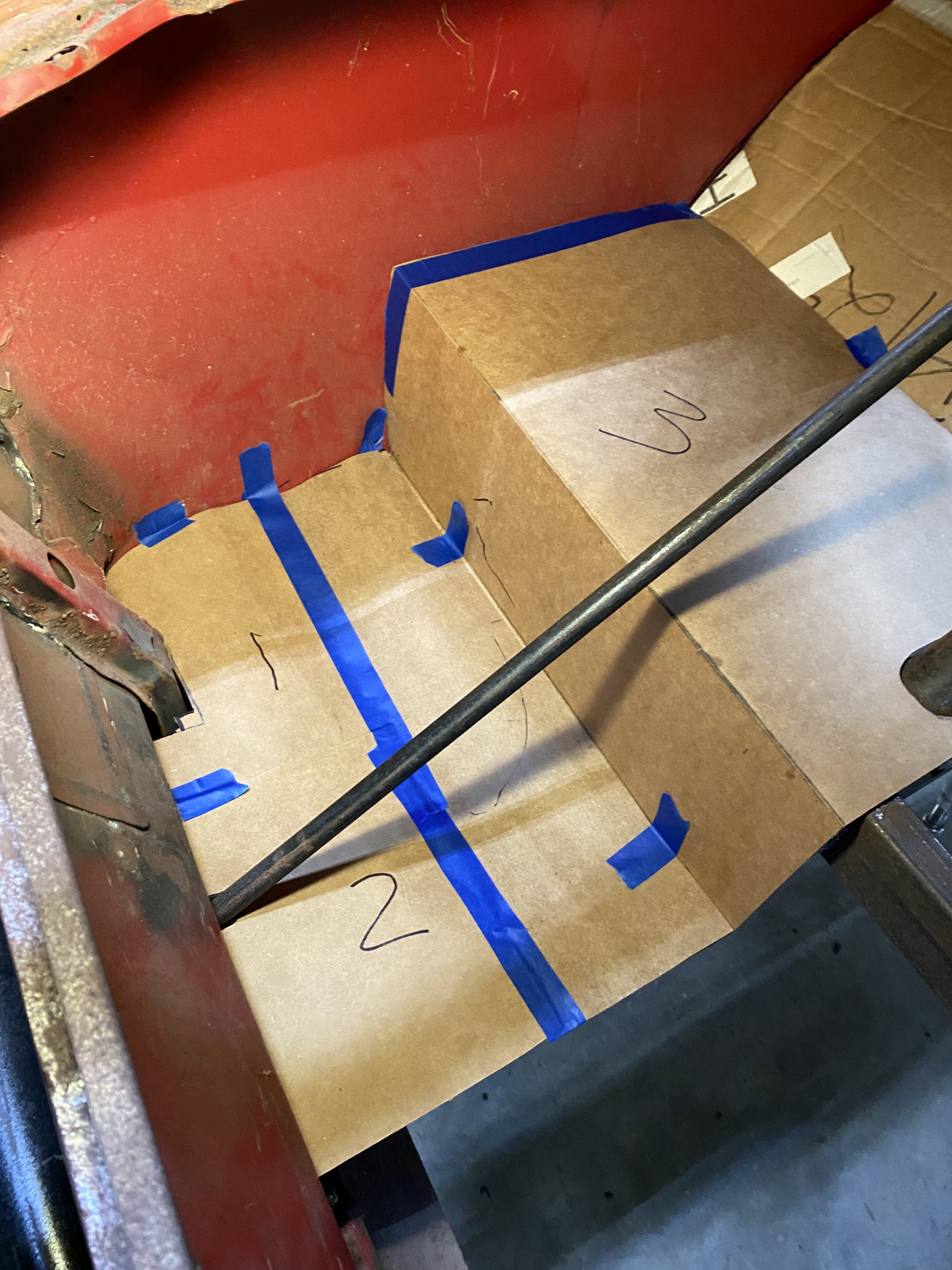

    IMG_4450.jpeg IMG_4451.jpeg IMG_4454.jpeg IMG_4457.jpeg IMG_4455.jpeg IMG_4456.jpeg IMG_4452.jpeg Worked on Kadet yesterday.
    Mocked up the wheel tubes and checked for ch***is fit. The actual clean up took as long. Looks like I will have clearance.

    Looking good. The slicks will grow on top end so make sure there is enough at the middle of the slicks, of course that does depend on how fast you intend to go.

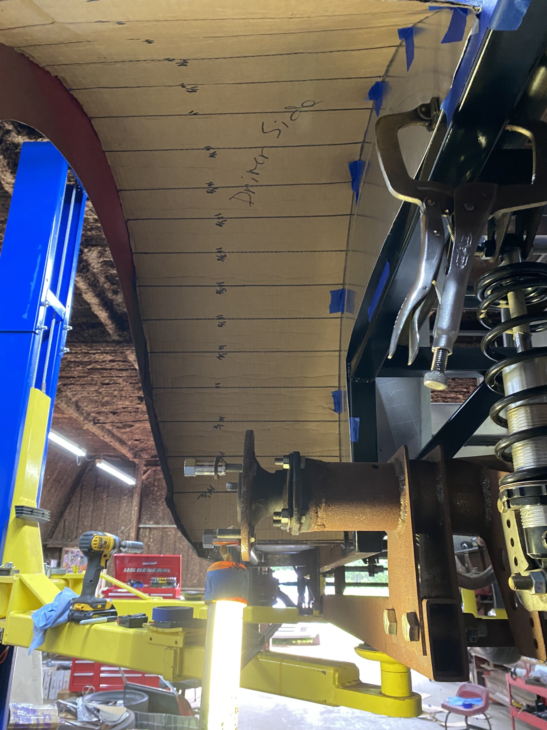

    There’s almost 7 inches in the center. Alway put the wheel tubs in as high as practically possible.
    Made under frame cut out and the base card board pattern. As per what I’ve always been told subtract an inch. I have been using body panel epoxy to glue second out board lip and let them over lap. Silicon the over lap so it doesn’t shake everything loose. And still has out board support. I have done them solid and floating and honestly either way works. IMG_4462.jpeg IMG_4463.jpeg IMG_4464.jpeg IMG_4465.jpeg
    Outback, akoutlaw, Deuces and 4 others like this.

    Will shift everything up 1 1/4 inches on the Kadette. Remeasured for cardboard template. I wanted another inch of clearance. I’ll simply use a 1 1/2 inch bulk head to make up the distance from the floorboards.

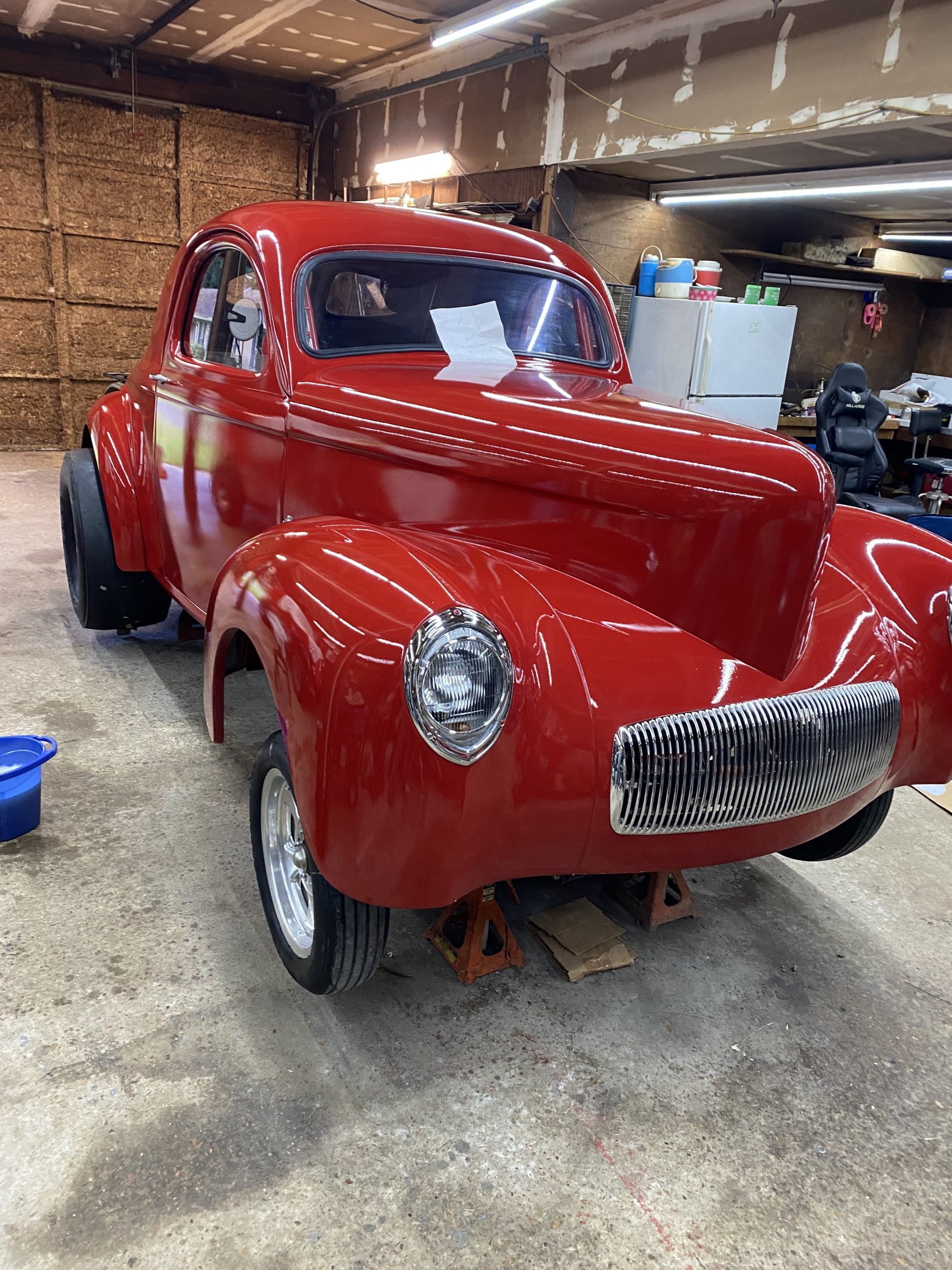

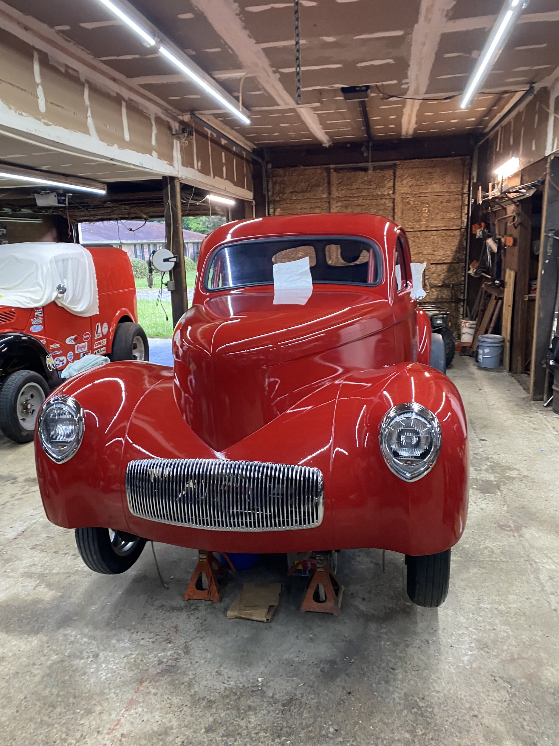

    Also pulled the cover from the Willy’s and it was both dusty and nasty if that’s possible IMG_4488.jpeg IMG_4499.jpeg IMG_4498.jpeg IMG_4497.jpeg IMG_4495.jpeg IMG_4496.jpeg with a cover on it. I washed it for the first time ever. I haven’t even cut and buffed it yet.
    Bucket washed each panel a dried with a towel. Can still see the orange peel in the clear above the belt line and behind the door. About 9 inches square. I gotta get that cut and buff done and get that outta there.

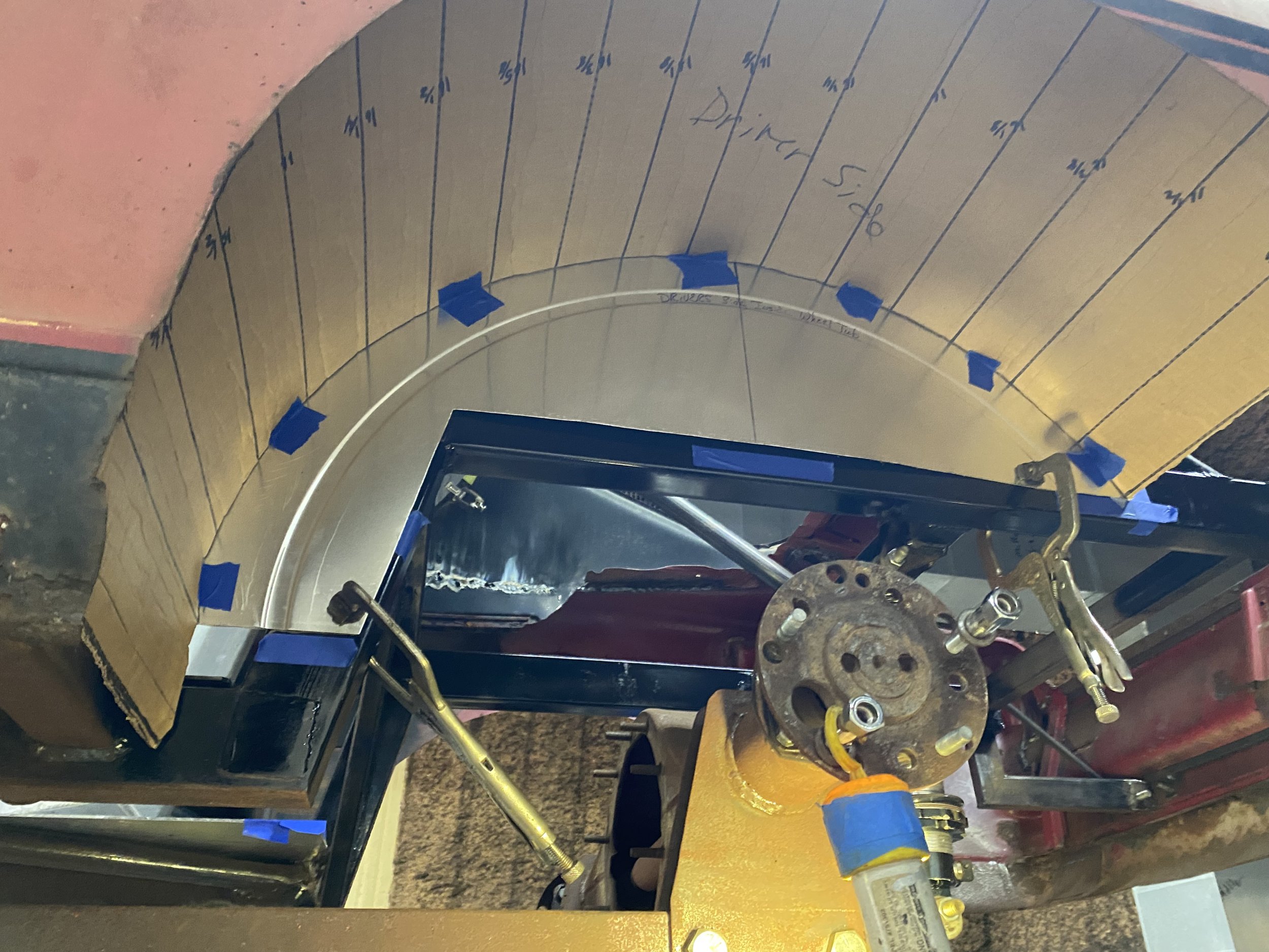

    Mitchell Rish
    from Houston MS

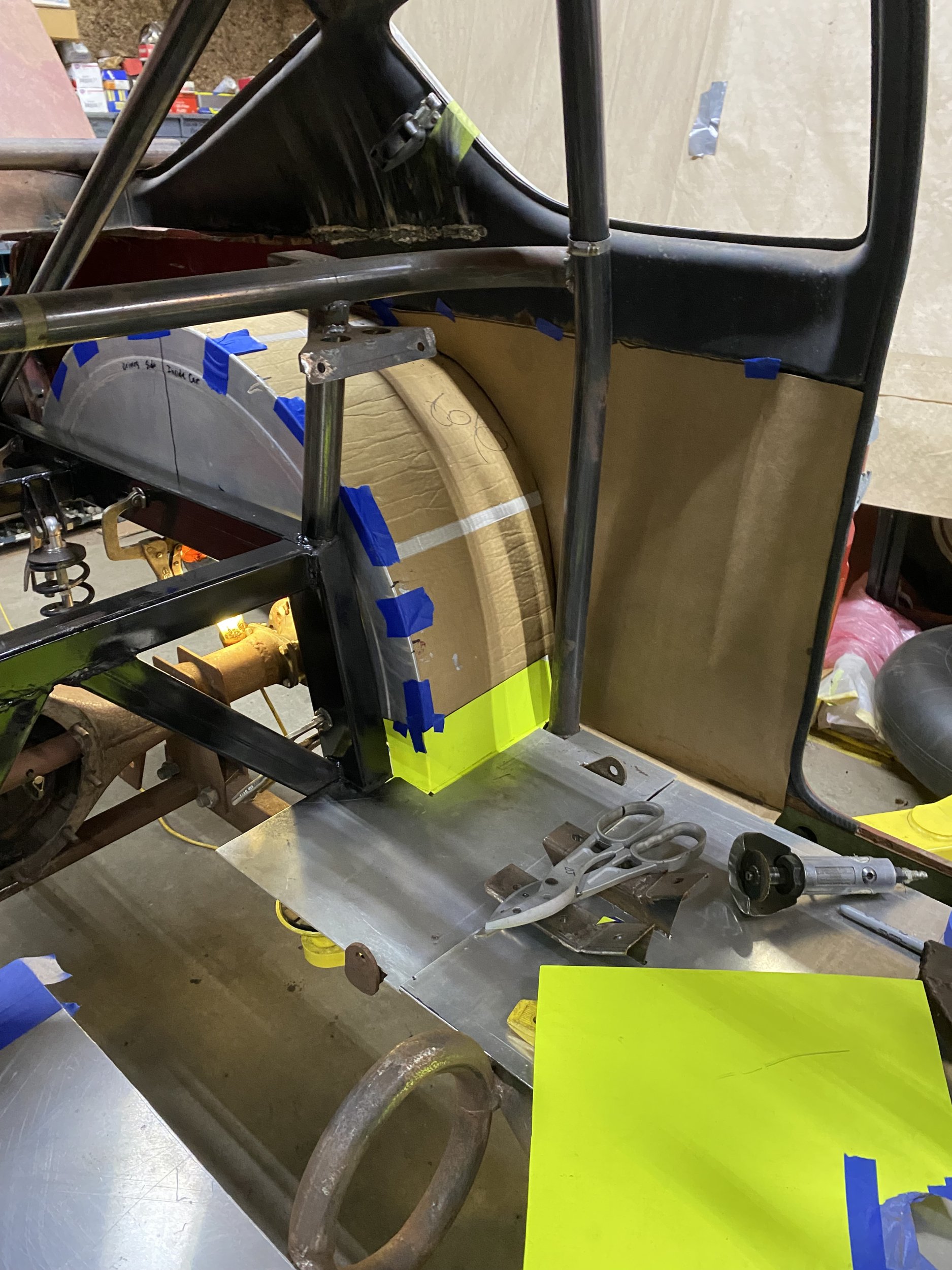

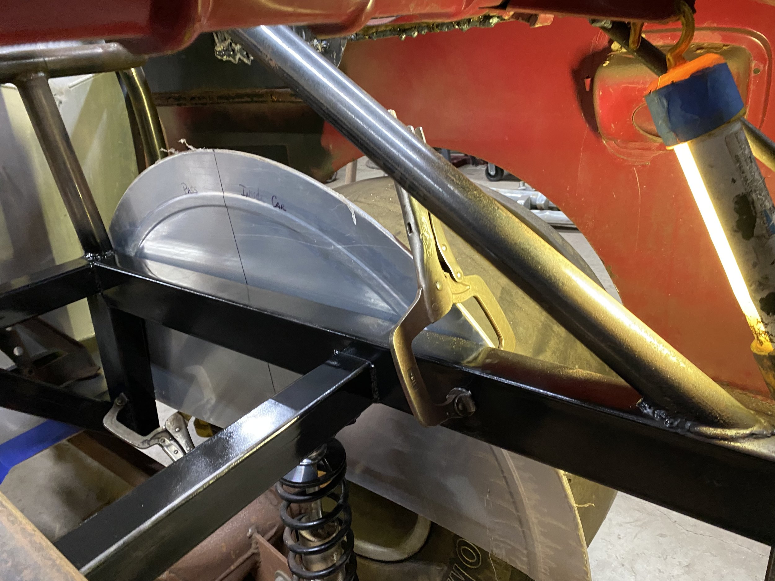

    Driver side wheel tubs /patterns complete and installed. Gonna work nicely.
    Wes was doing inspection today. He’s a slave driver. Lol IMG_4516.jpeg IMG_4519.jpeg IMG_4518.jpeg

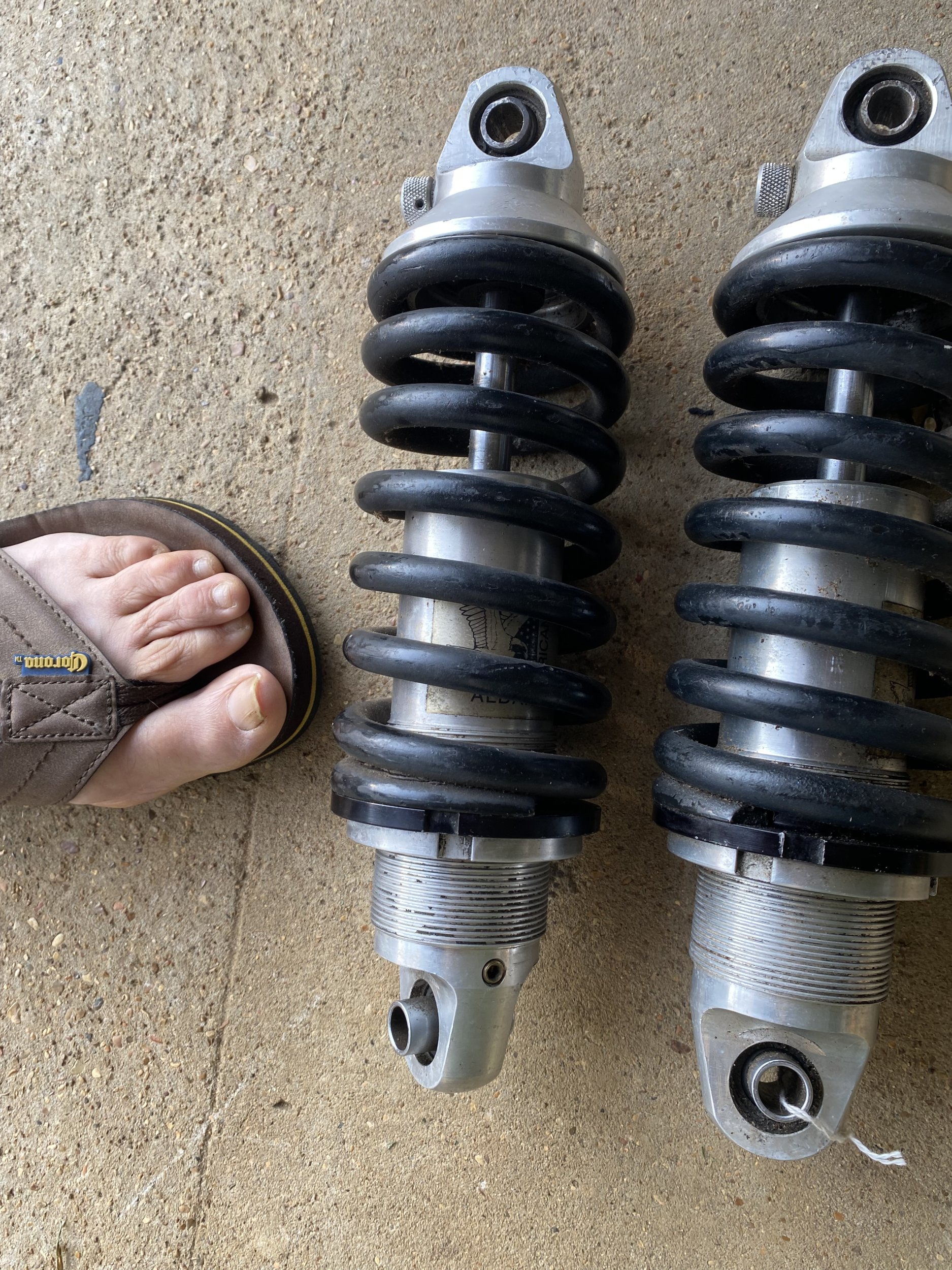

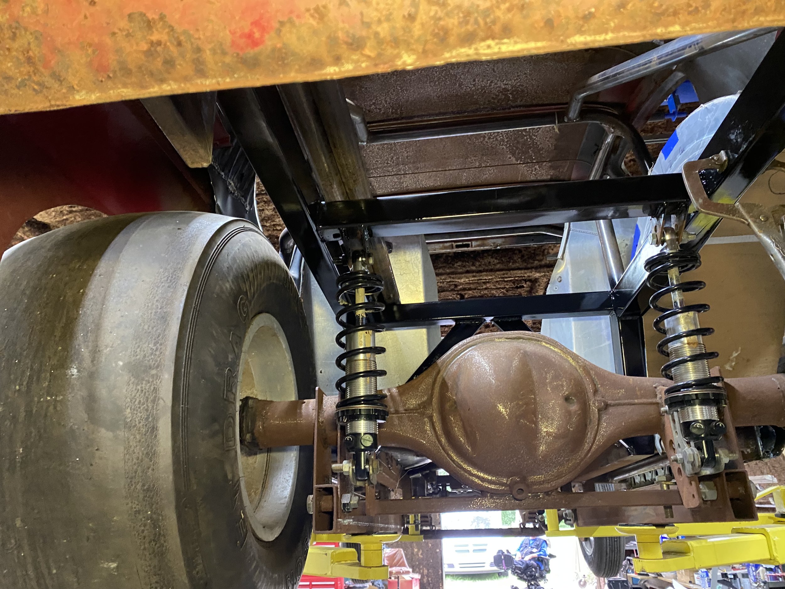

    Picked up a set of Alden American Coil Overs for the front conversion on the Thames this afternoon. I got a deal so maybe just maybe I’ll get lucky. IMG_4523.jpeg

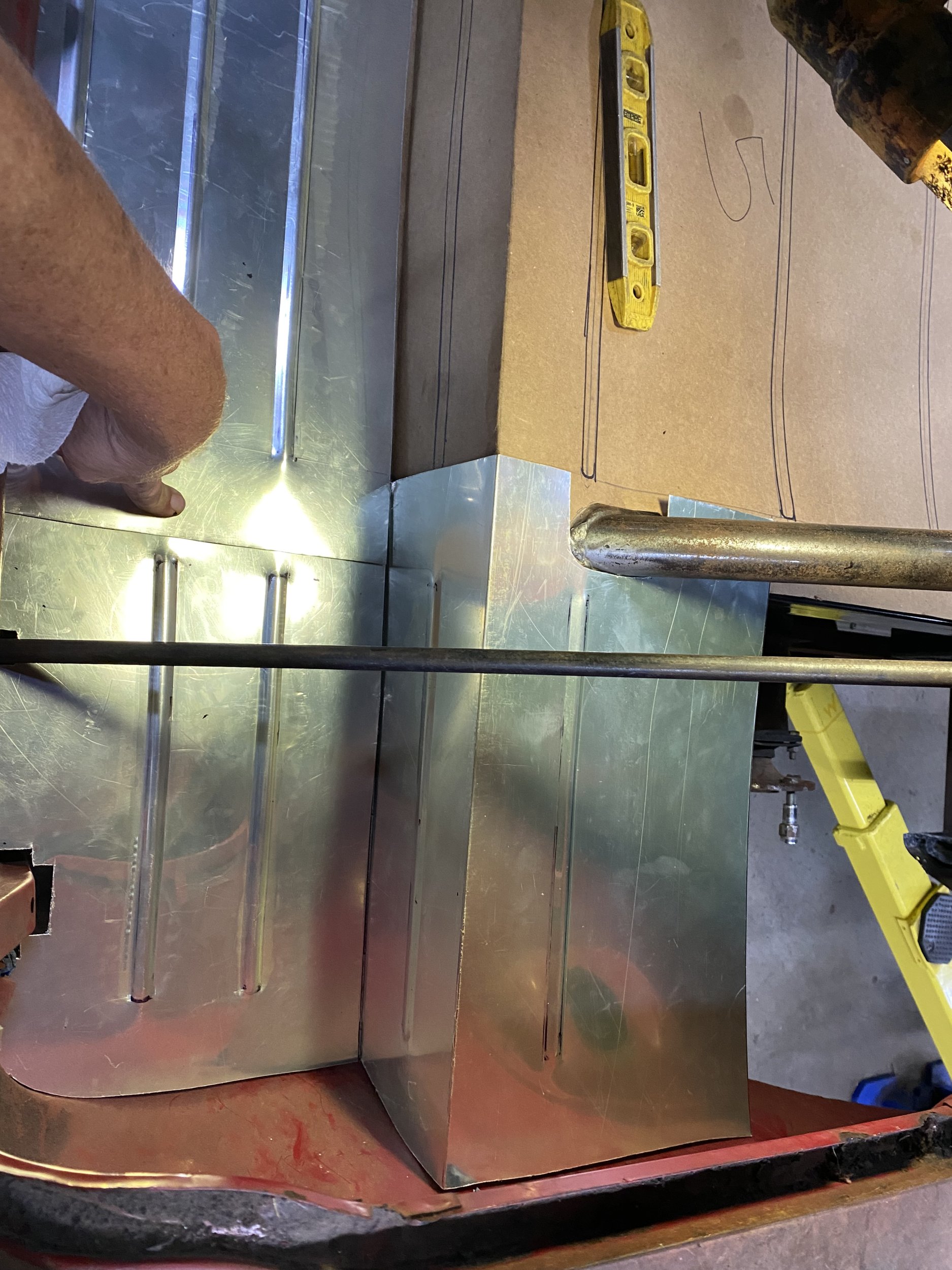

    Ok. Finished all interior (as in aluminum ) patterns. Cheaper to work with than aluminum mistakes. IMG_4558.jpeg IMG_4559.jpeg IMG_4561.jpeg IMG_4562.jpeg IMG_4563.jpeg IMG_4558.jpeg

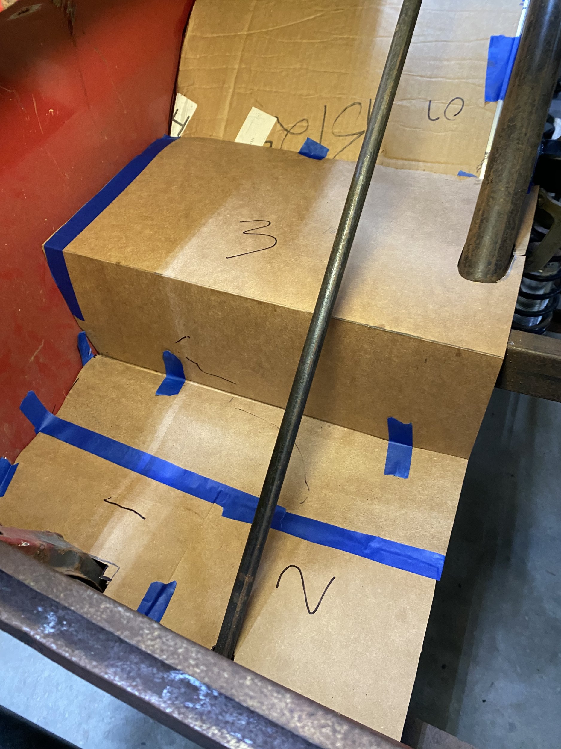

    IMG_4581.jpeg IMG_4584.jpeg IMG_4583.jpeg IMG_4582.jpeg Ok. Finished the interior patterns. Other than trans tunnel and driveshaft cover /tunnel. Which is always last.

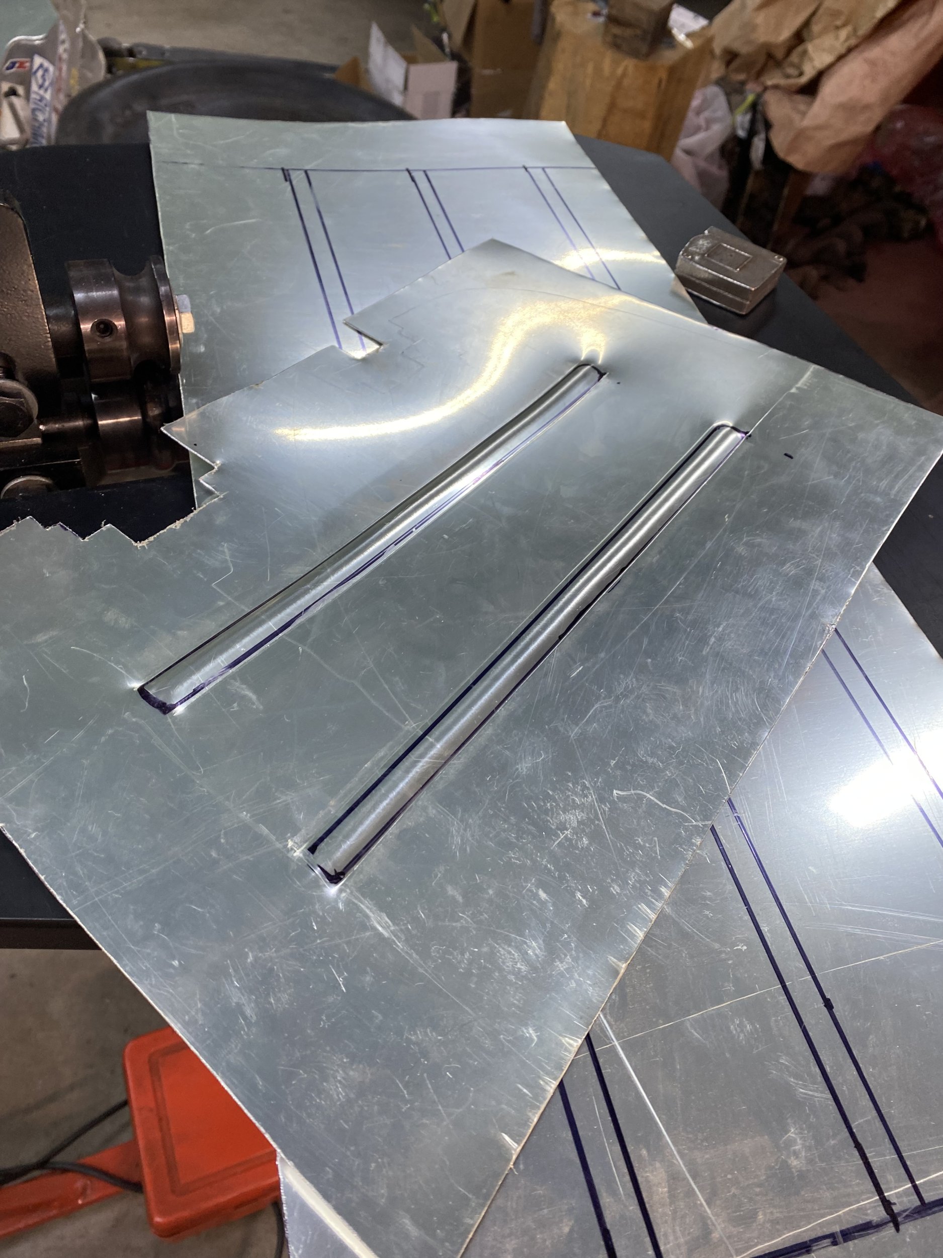

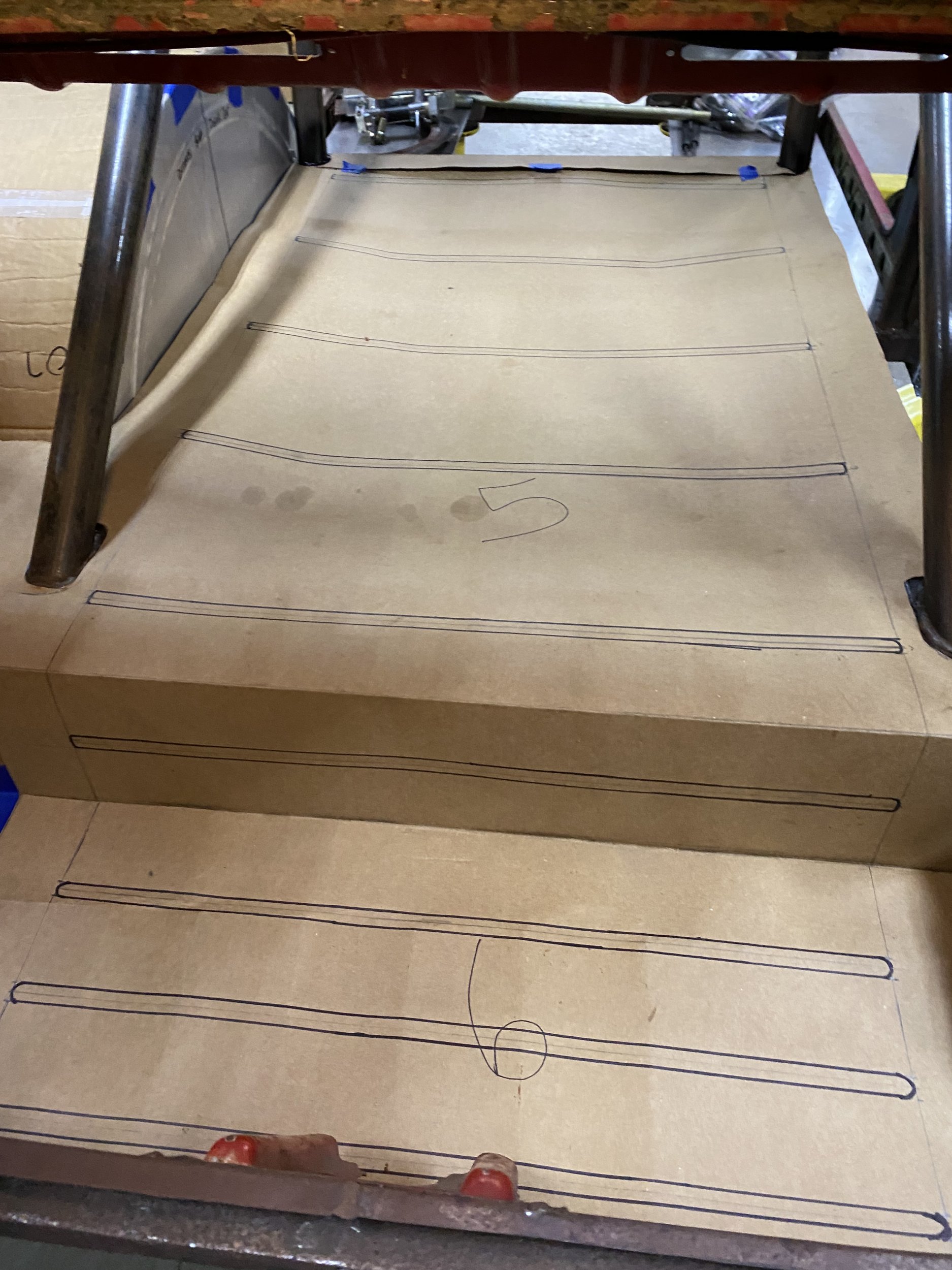

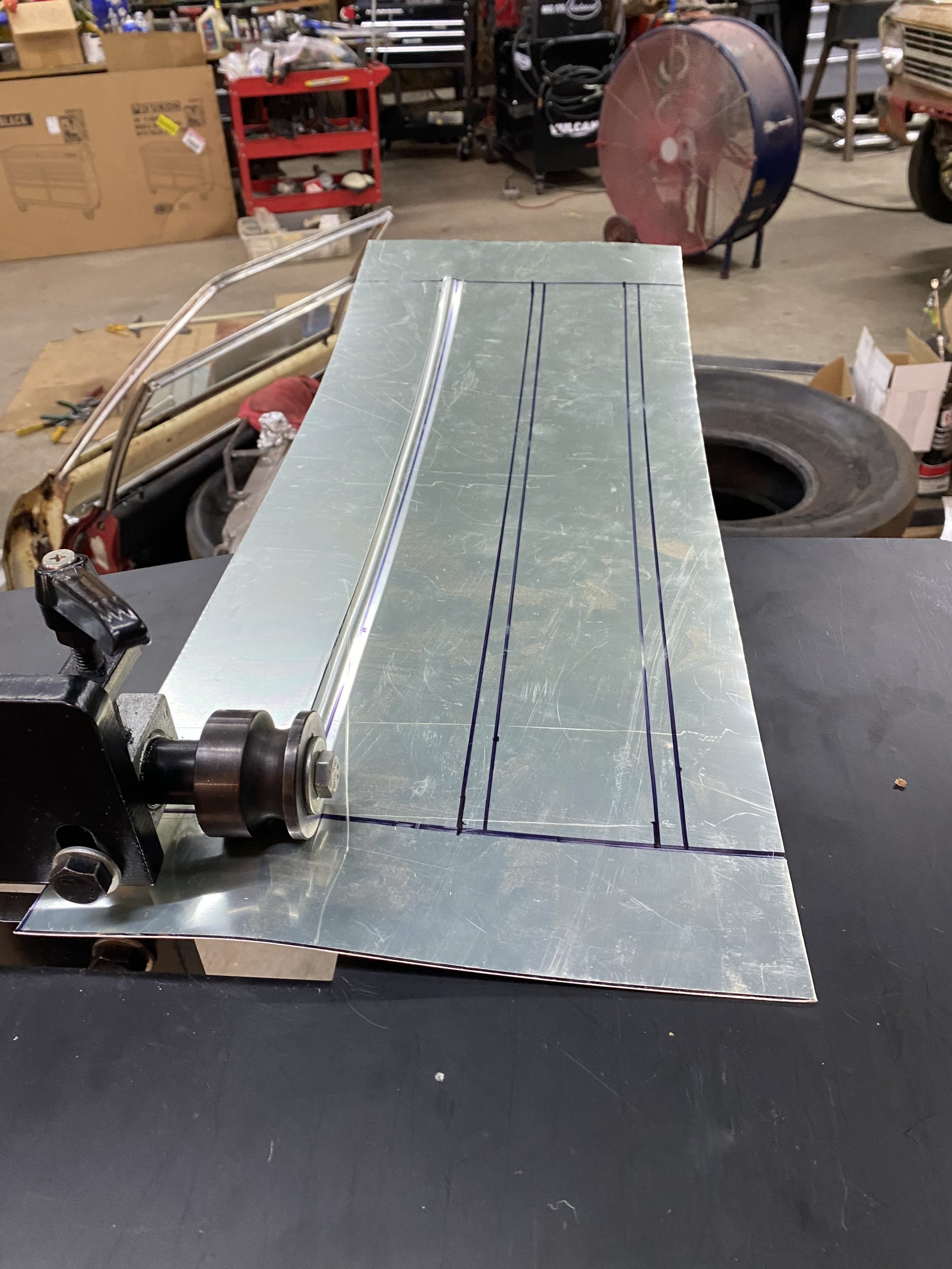

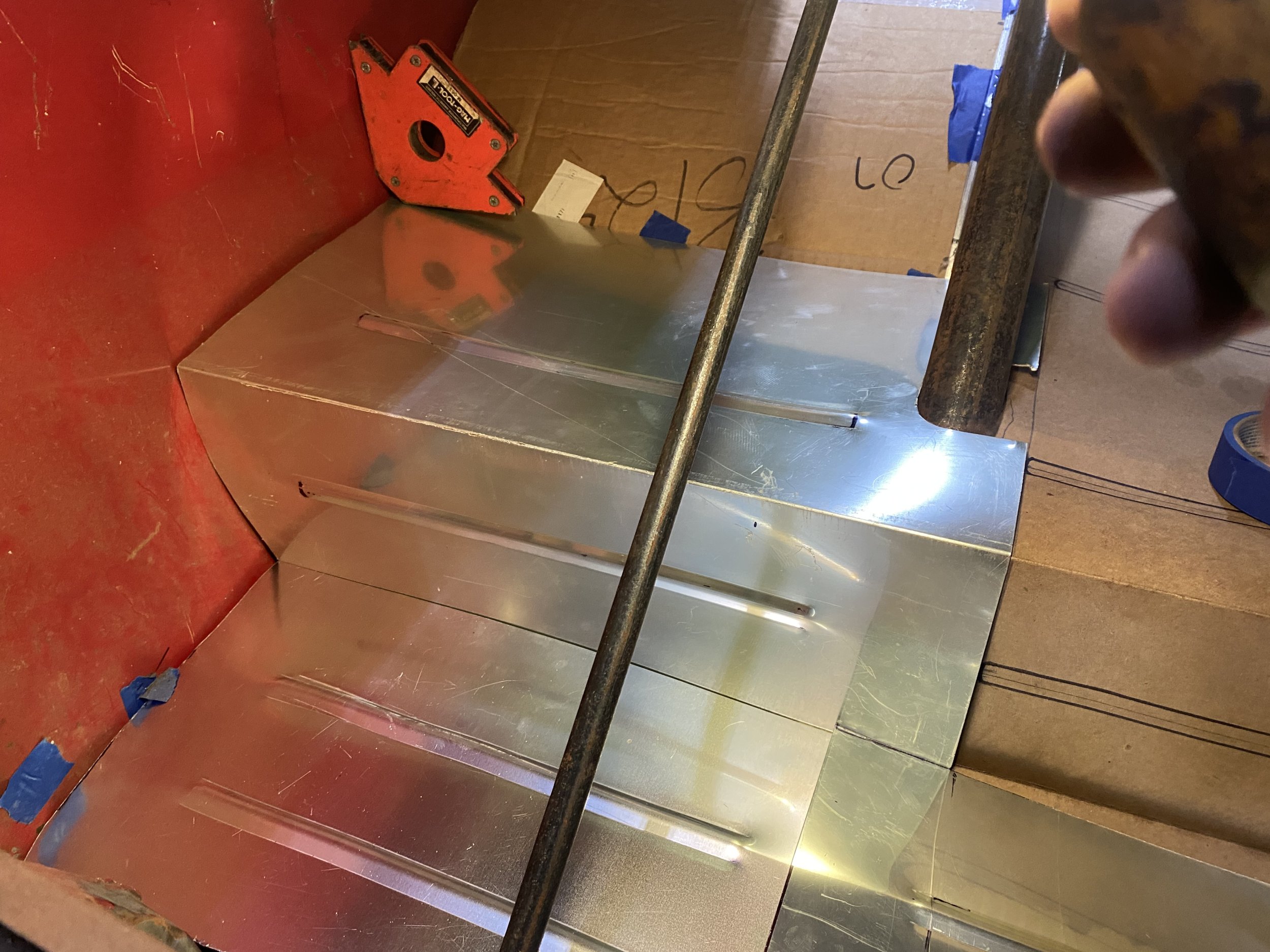

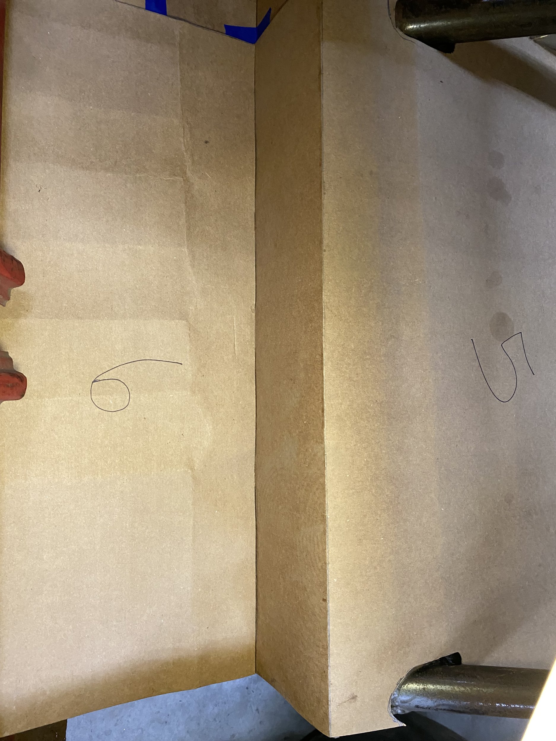

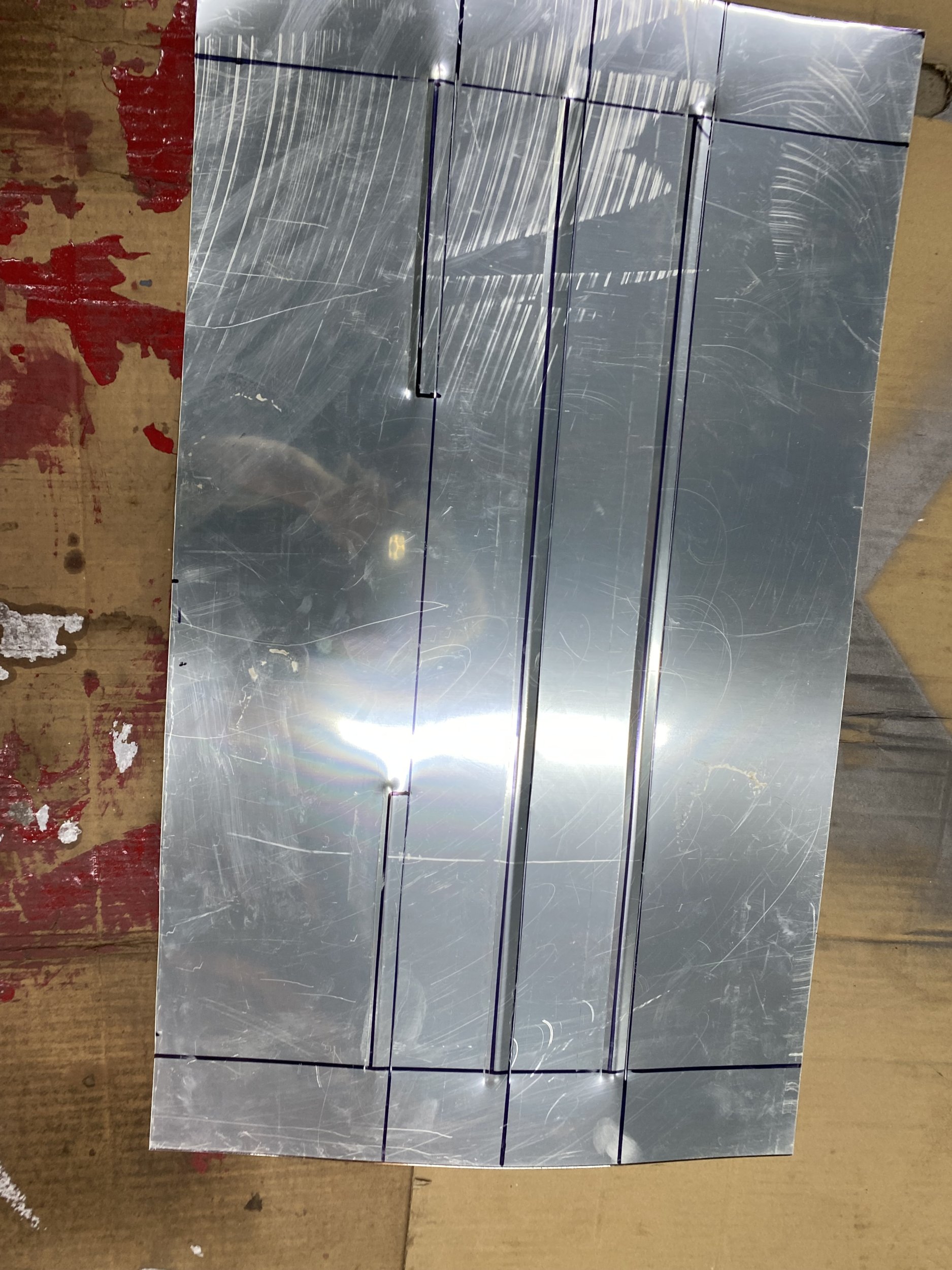

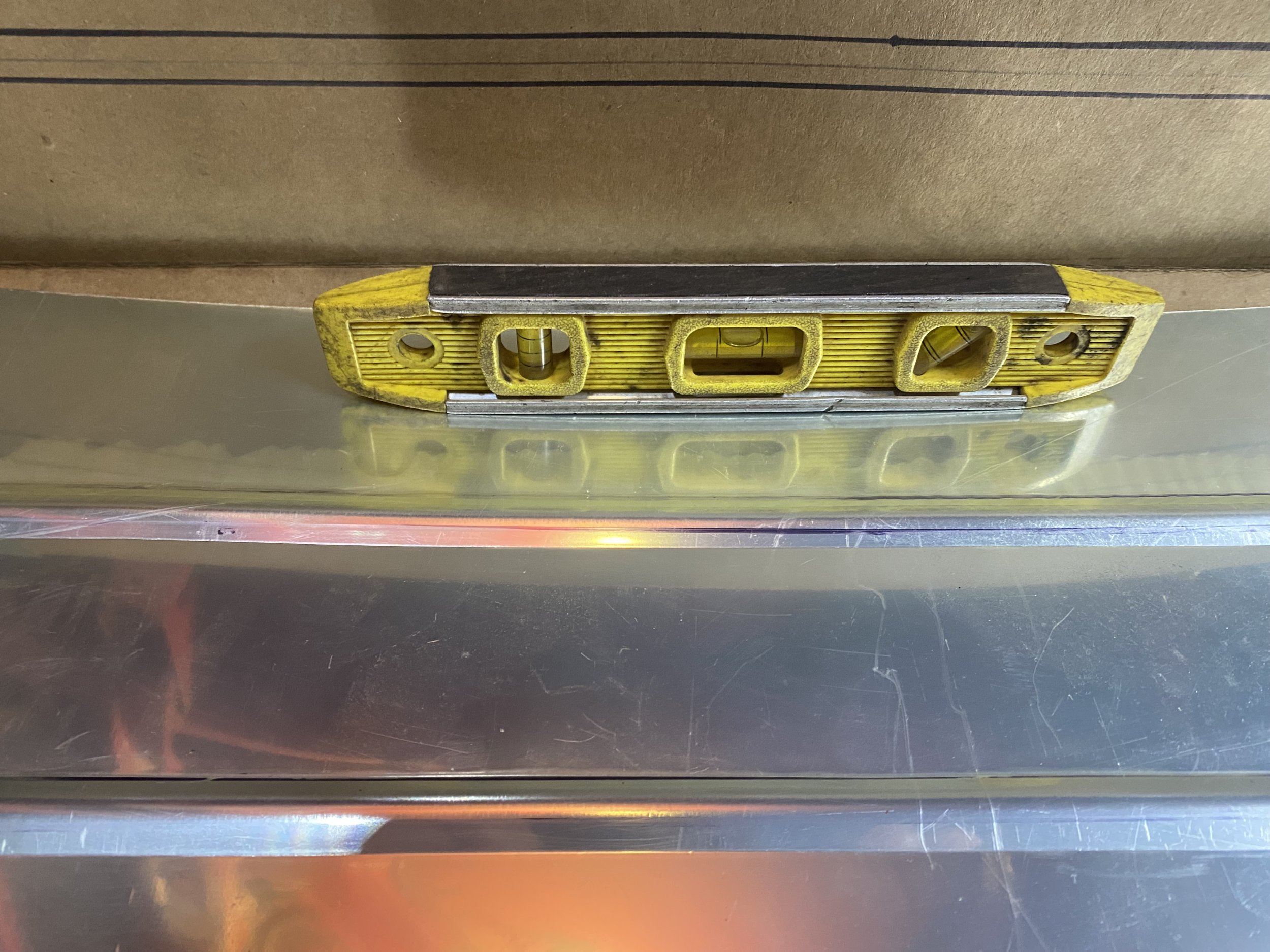

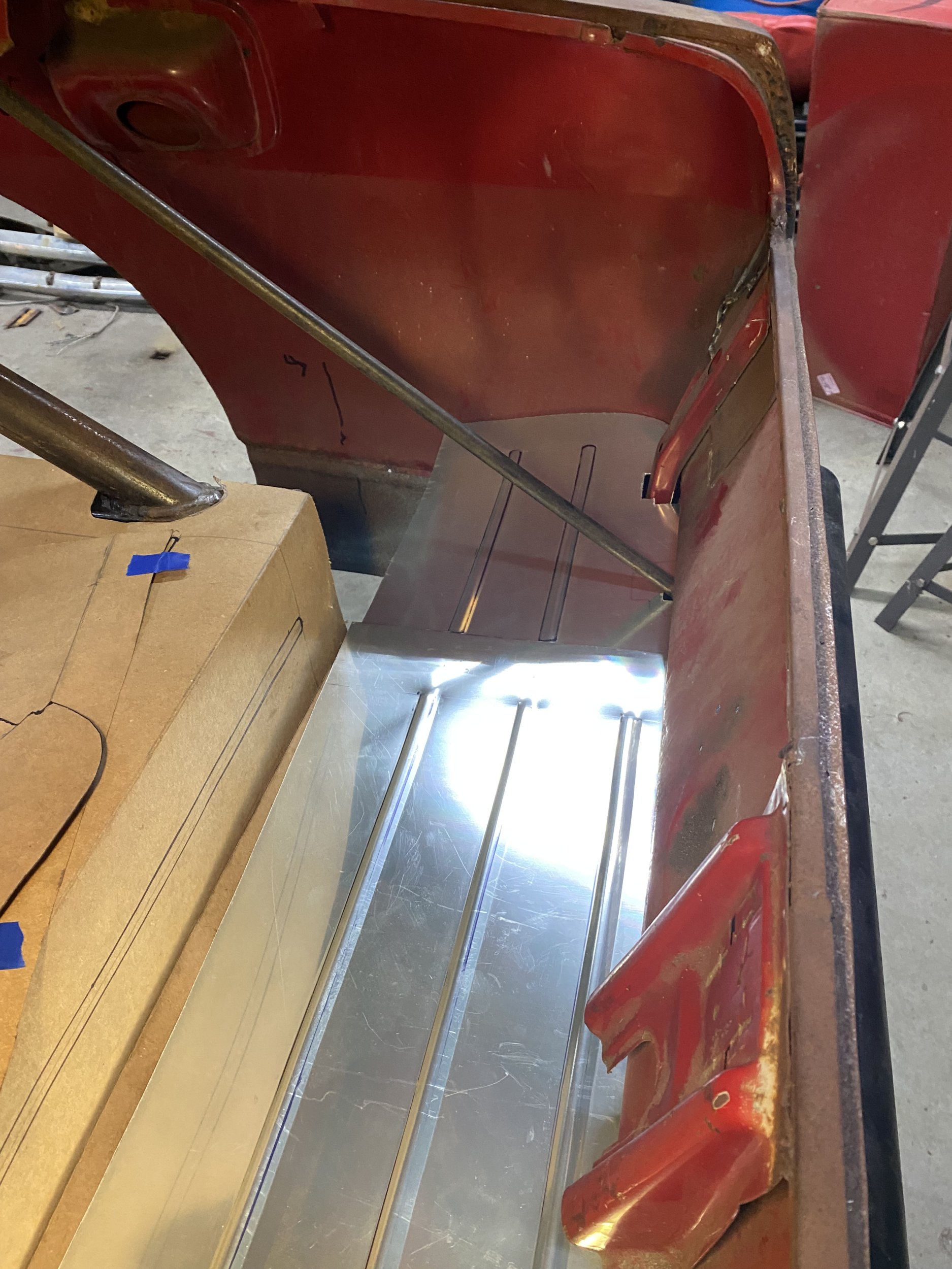

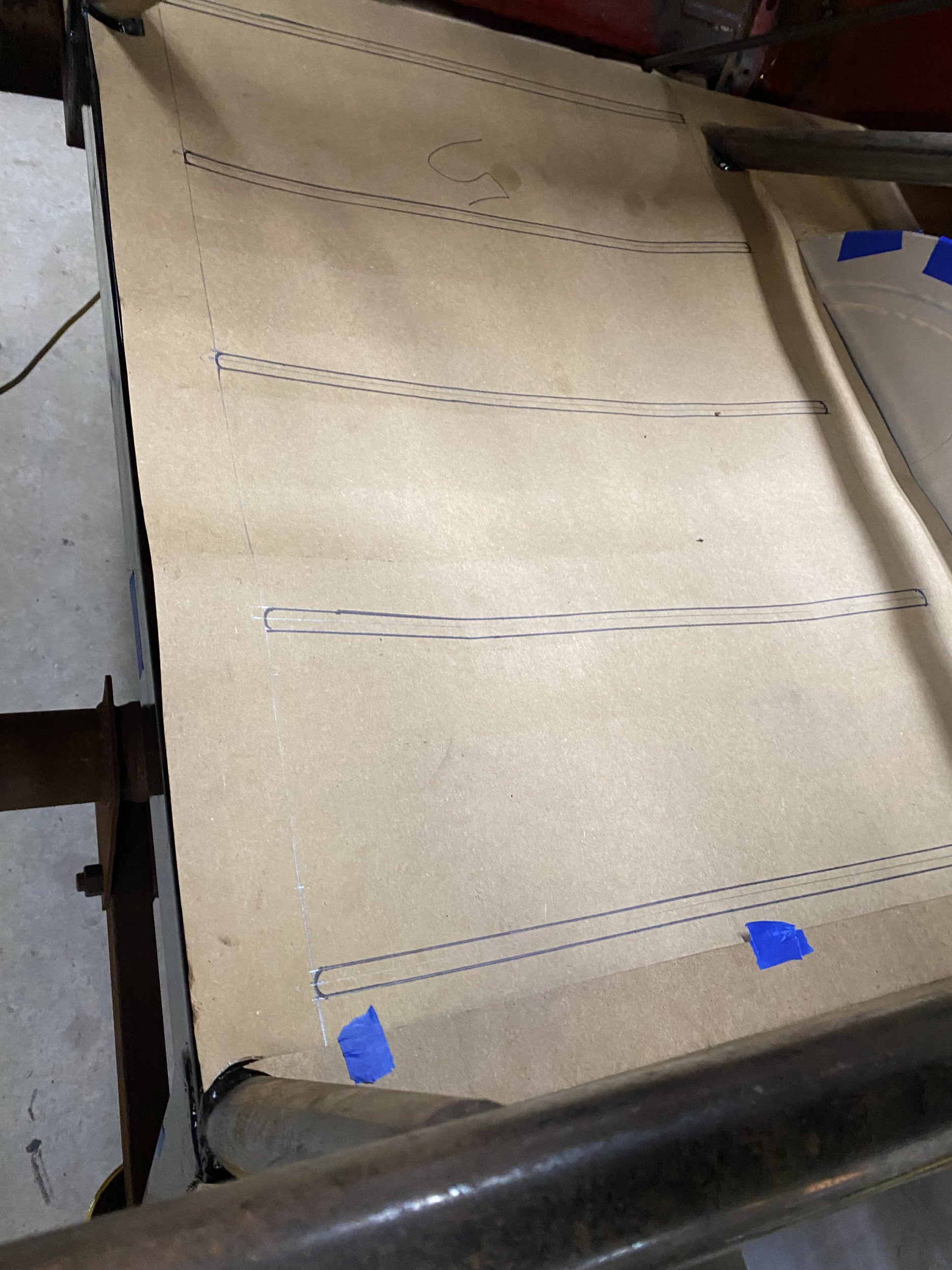

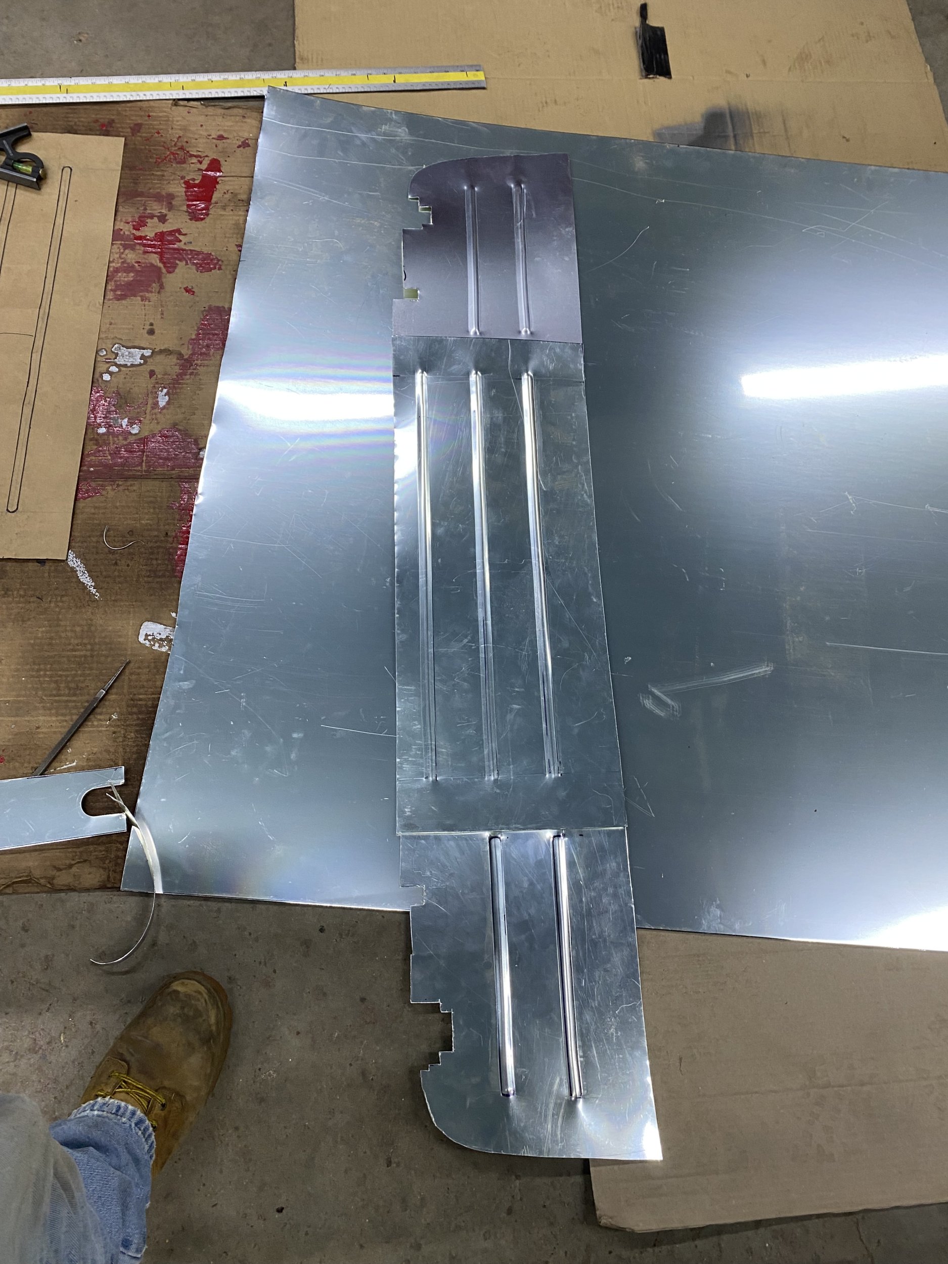

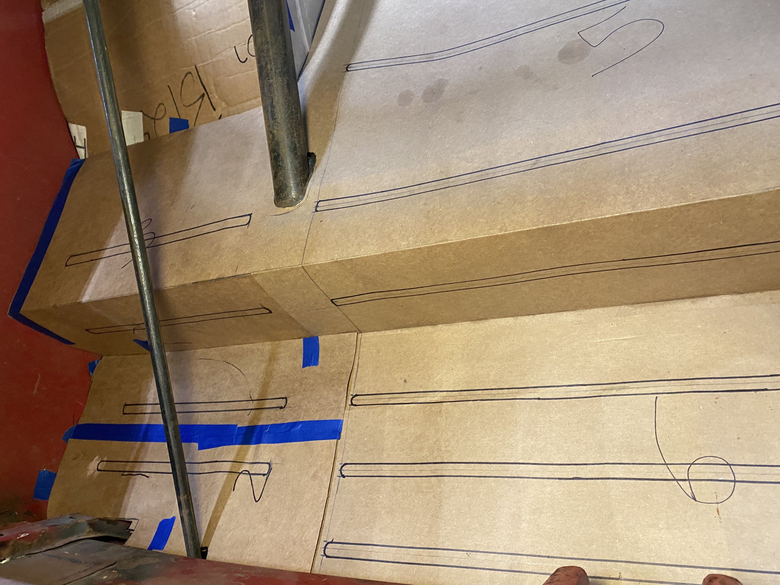

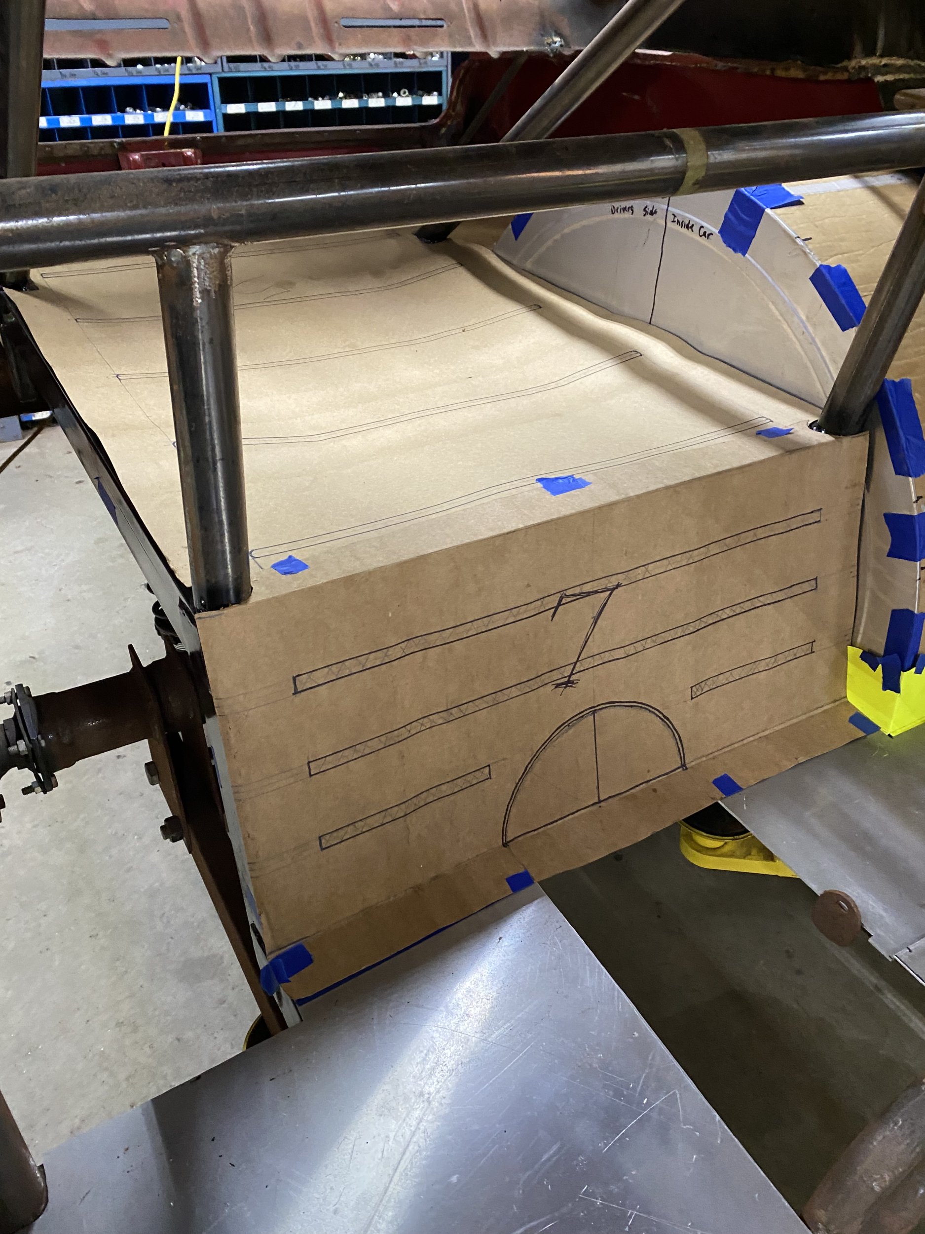

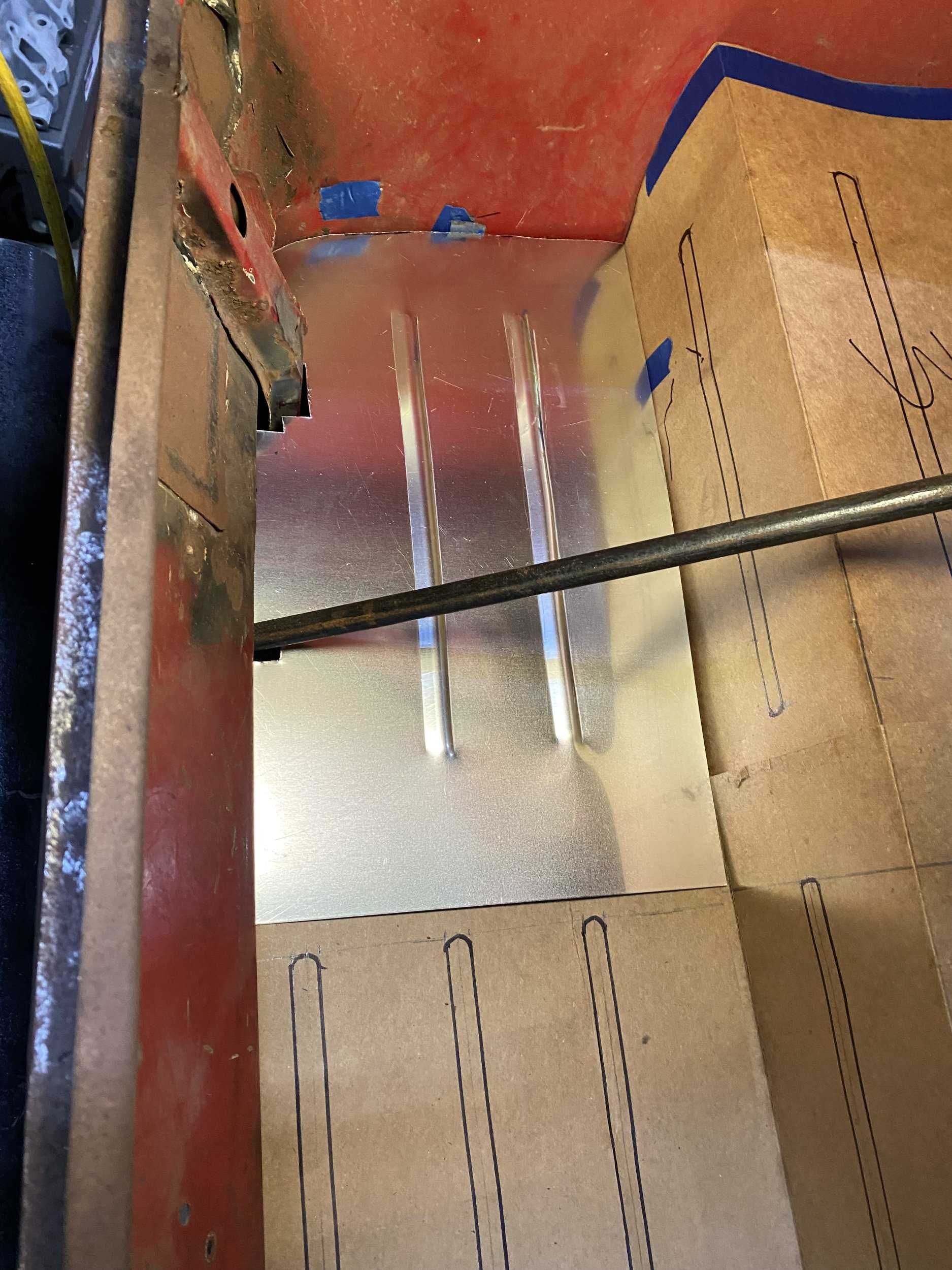

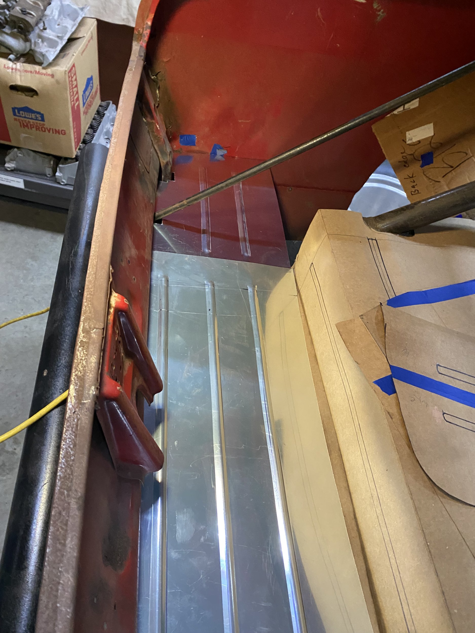

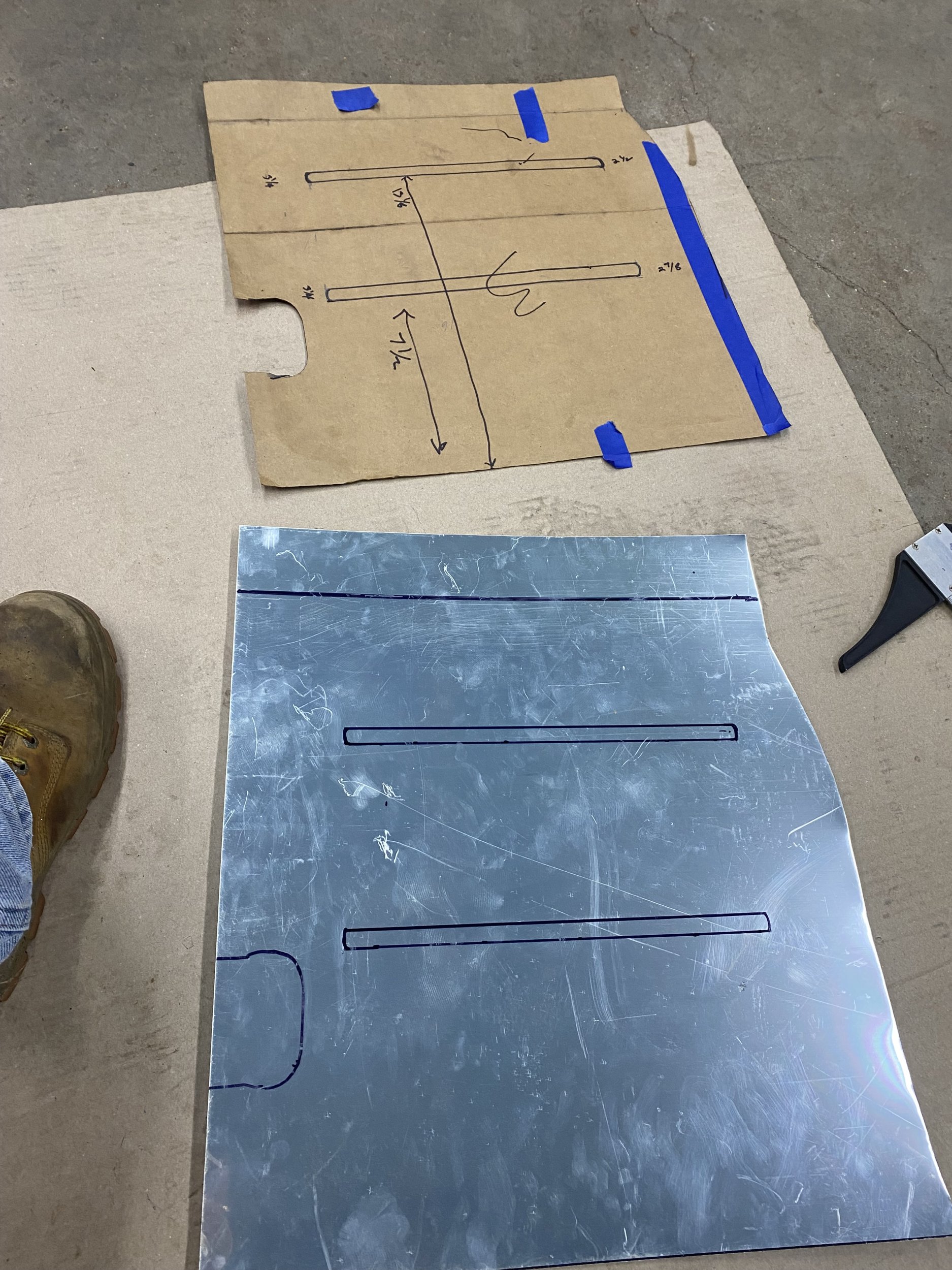

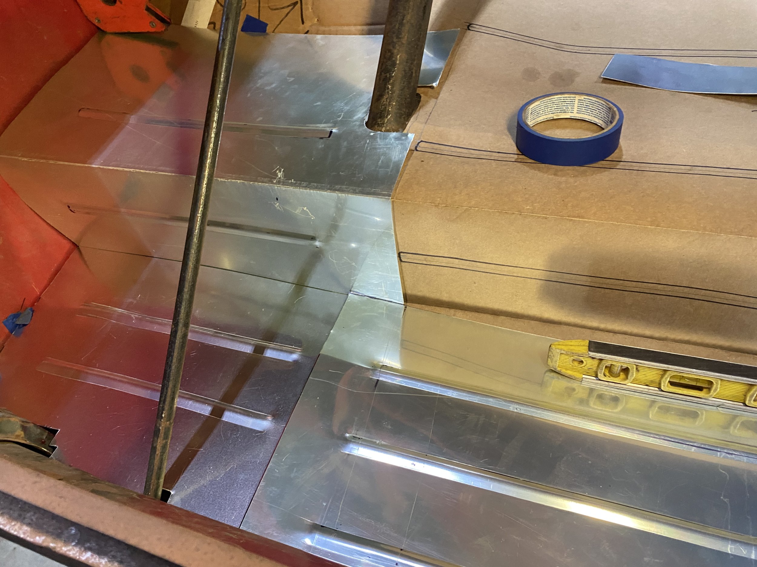

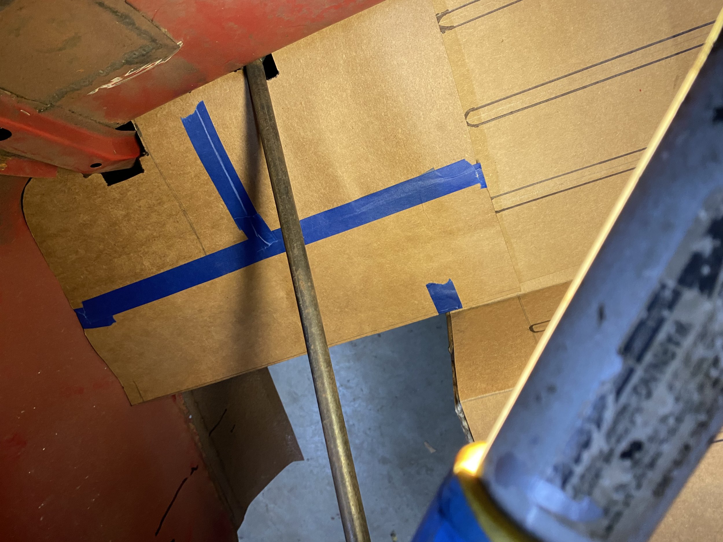

    Managed to get basic patterns /design for bead rolling on all the panels for the Kadet. Paper is cheaper than aluminum.
    IMG_4595.jpeg IMG_4596.jpeg IMG_4597.jpeg IMG_4598.jpeg IMG_4599.jpeg IMG_4600.jpeg IMG_4595.jpeg IMG_4596.jpeg IMG_4597.jpeg IMG_4598.jpeg IMG_4599.jpeg IMG_4600.jpeg
    loudbang, 427 sleeper and enloe like this.

    Mitchell Rish
    from Houston MS

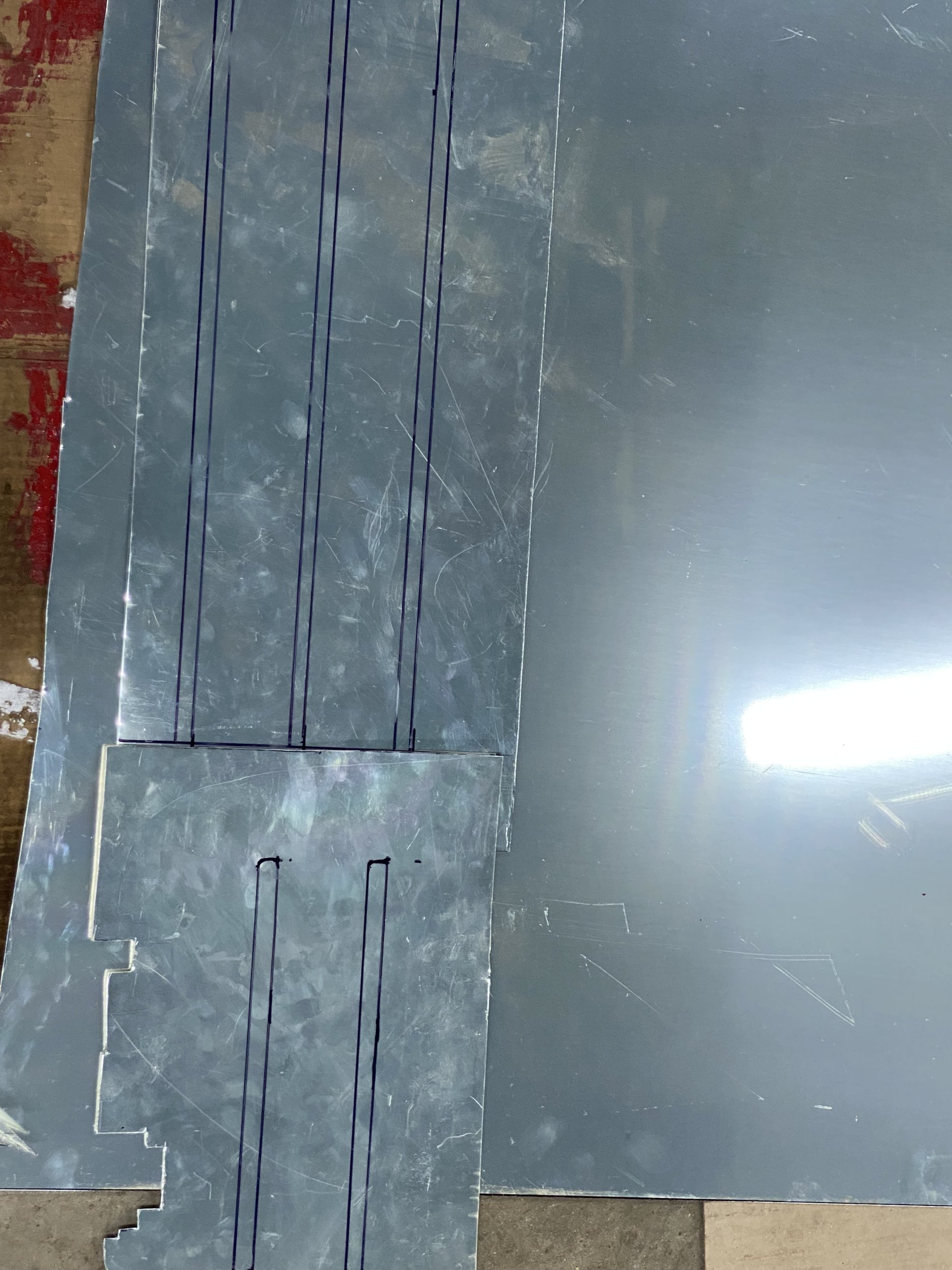

    First panel ( driver-side rear corner ). And to boot flip the pattern and it even worked for the p***engers side. IMG_4612.jpeg IMG_4611.jpeg IMG_4609.jpeg IMG_4608.jpeg IMG_4606.jpeg

  18. Mitchell Rish
    Joined: Jun 10, 2007
    Posts: 2,375
    Mitchell Rish
    from Houston MS

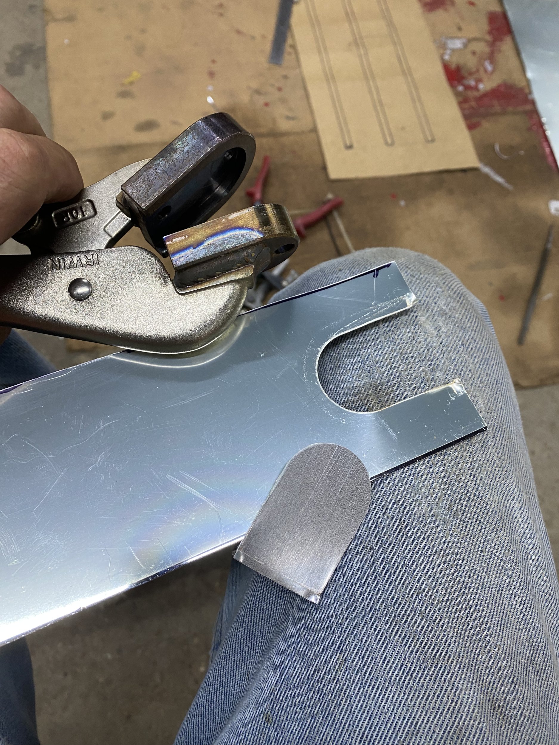

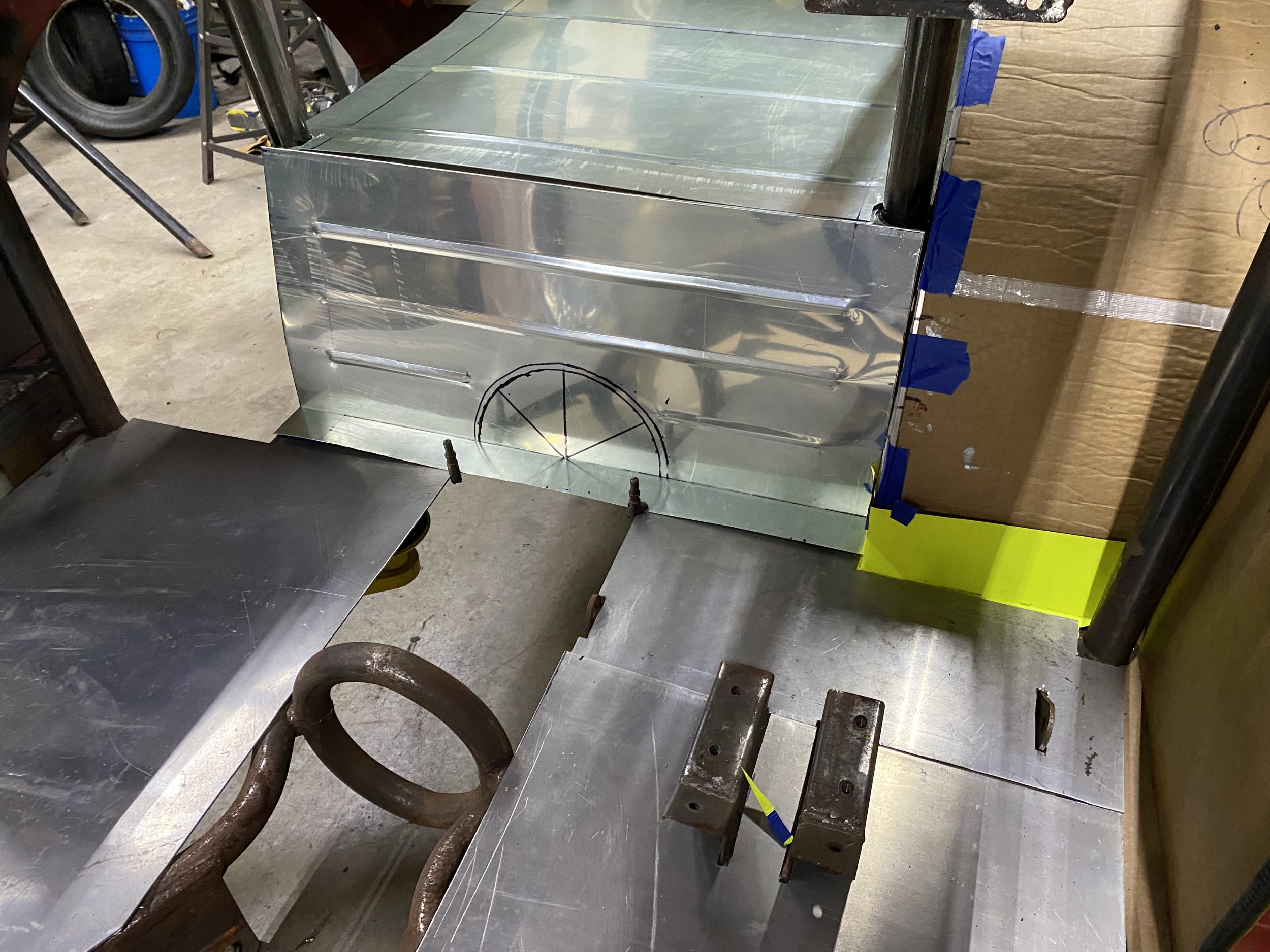

    Rearmost 3 panels finished. Not clecoed down yet. Will fit them all before. Also need to step and flare the side panels. Used my scallop pliers for clearance around cage bars. IMG_4642.jpeg IMG_4645.jpeg IMG_4646.jpeg IMG_4648.jpeg IMG_4651.jpeg IMG_4652.jpeg IMG_4653.jpeg IMG_4654.jpeg

    Mitchell Rish
    from Houston MS
    I forget the formal term. I am sure someone will chime in. If I remember right Mick found them at Eastwood/maybe Skybolt? I have them from 3/4 to 1 3/4 diameter. We got them for the smooth/ and fast radiuses around roll cages etc.

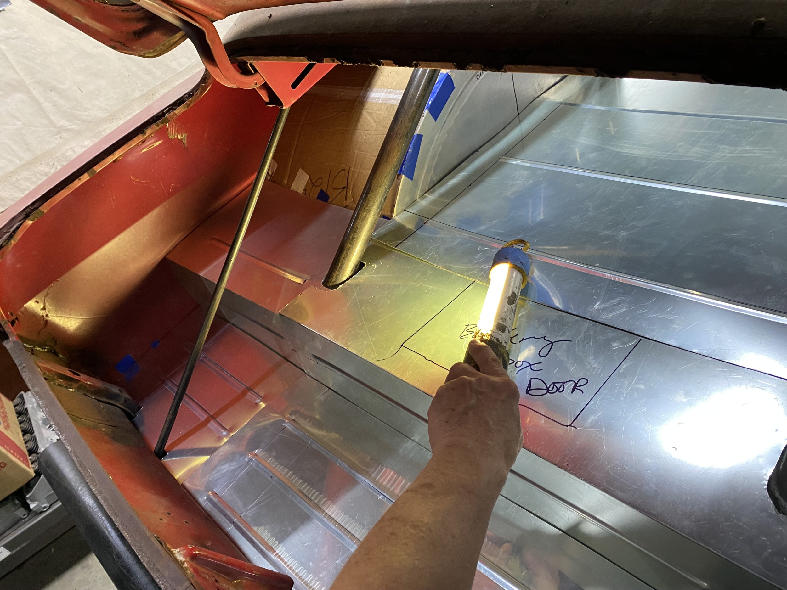

    from Houston MS

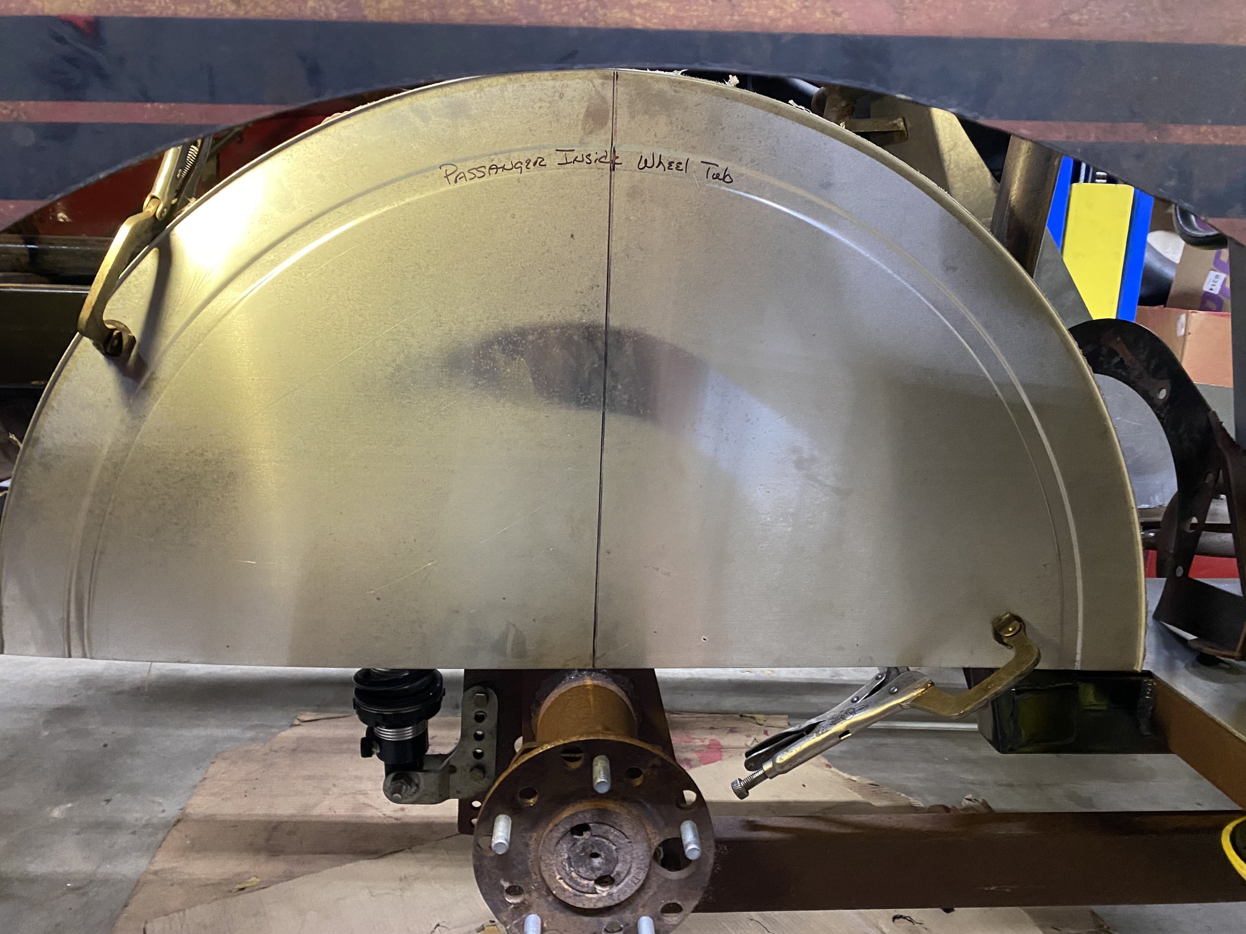

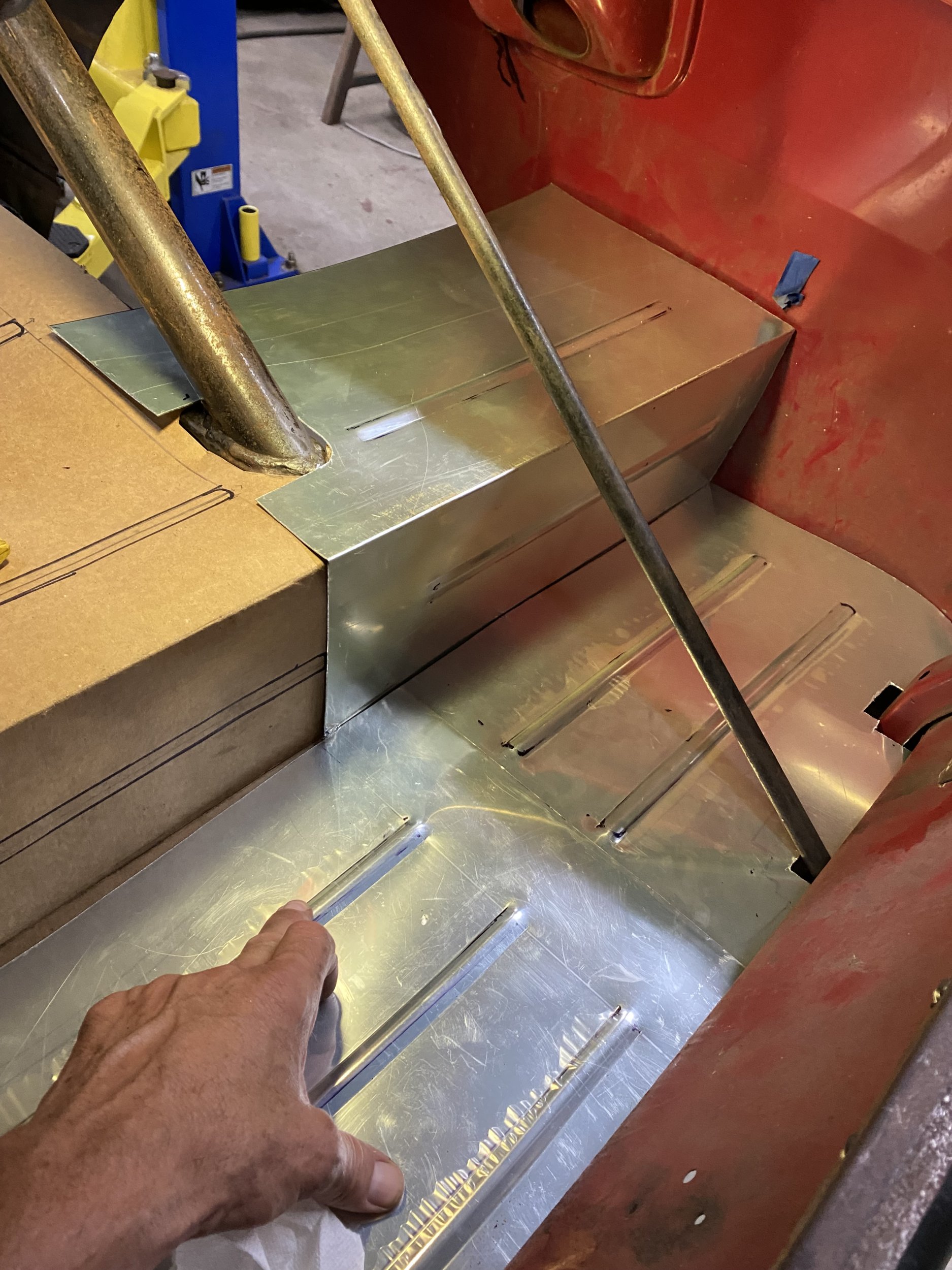

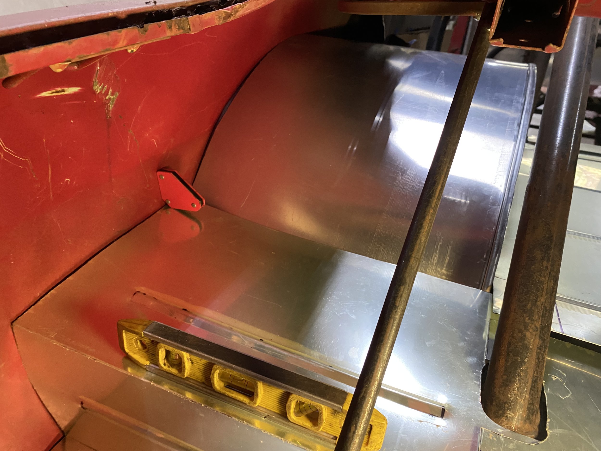

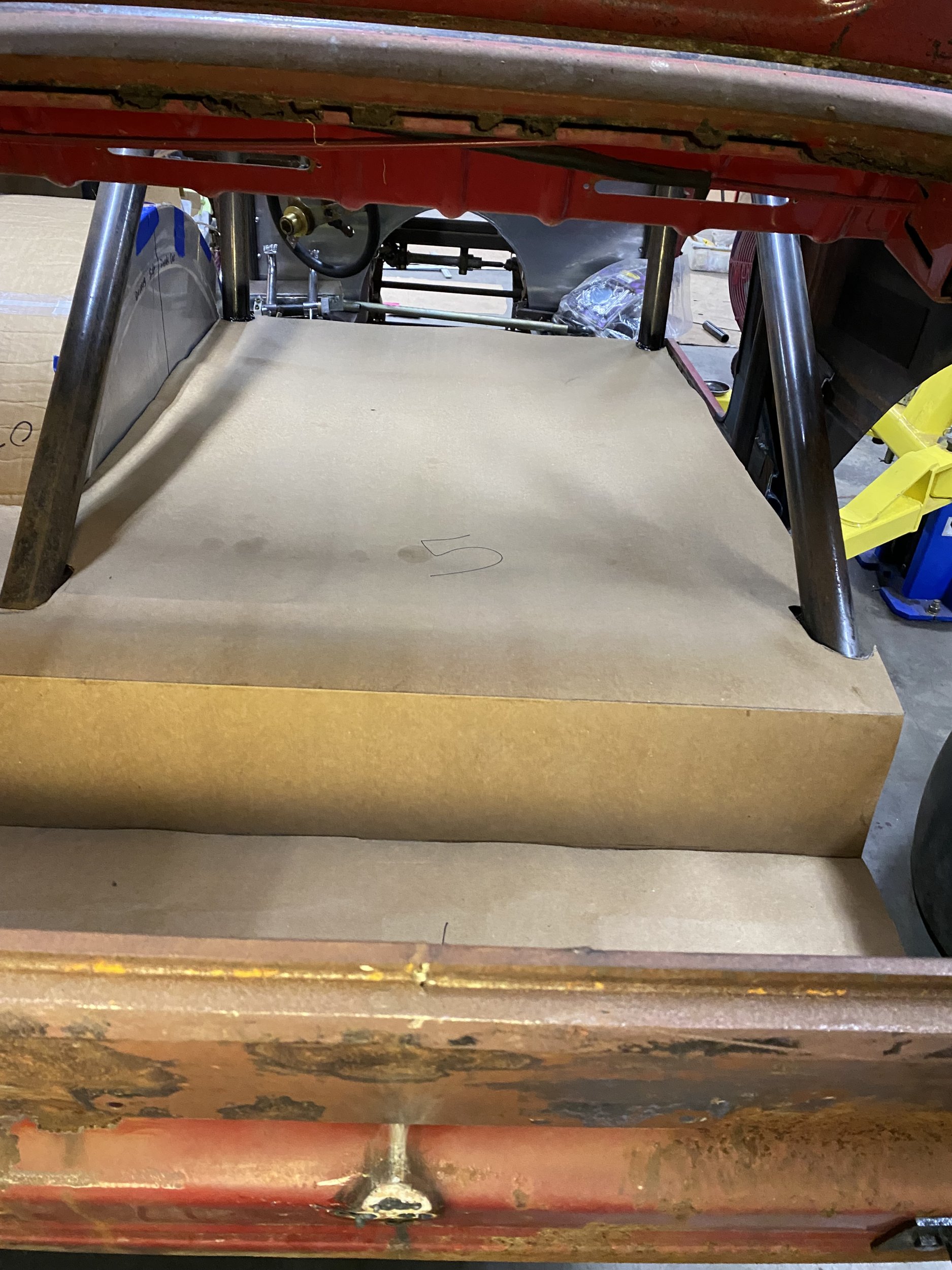

    I managed to get the hardest panel done and fitted on the Kadett today. IMG_4674.jpeg IMG_4675.jpeg IMG_4676.jpeg IMG_4677.jpeg IMG_4678.jpeg IMG_4679.jpeg IMG_4680.jpeg IMG_4686.png Remember nothing is clecoed in or permanently mounted. I used the level to make sure everything is sitting as it should.
    Flip the pattern and do it again. Then the long center pieces. And wheel tub outboard supports.
    enloe, loudbang and 427 sleeper like this.

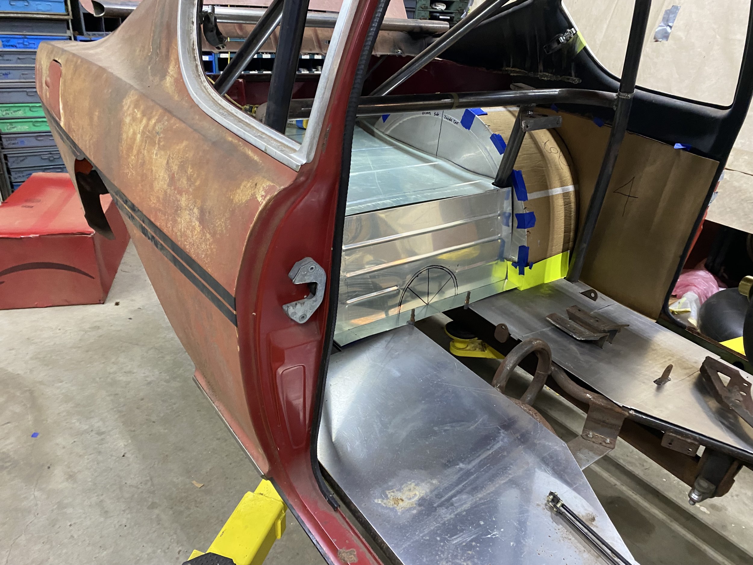

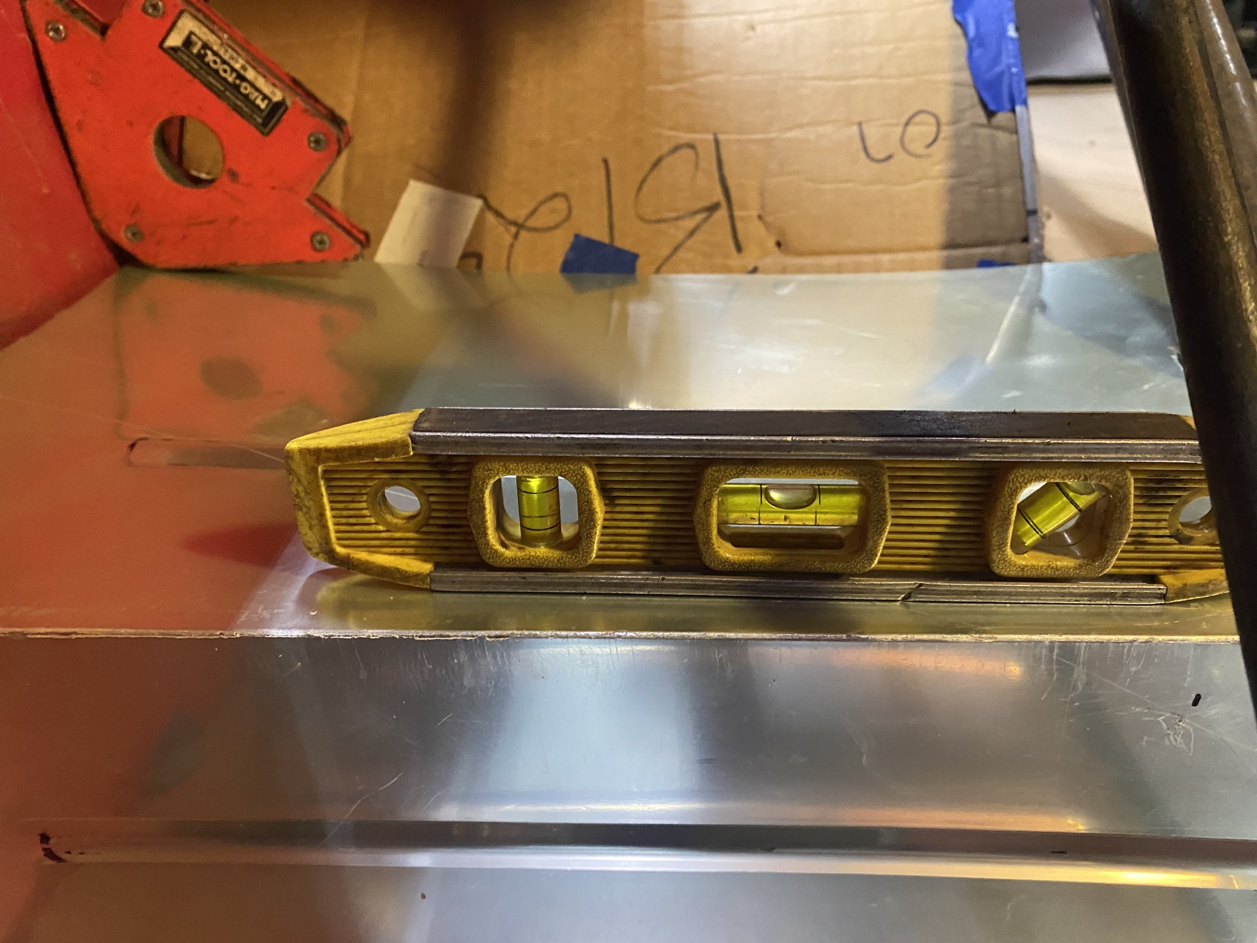

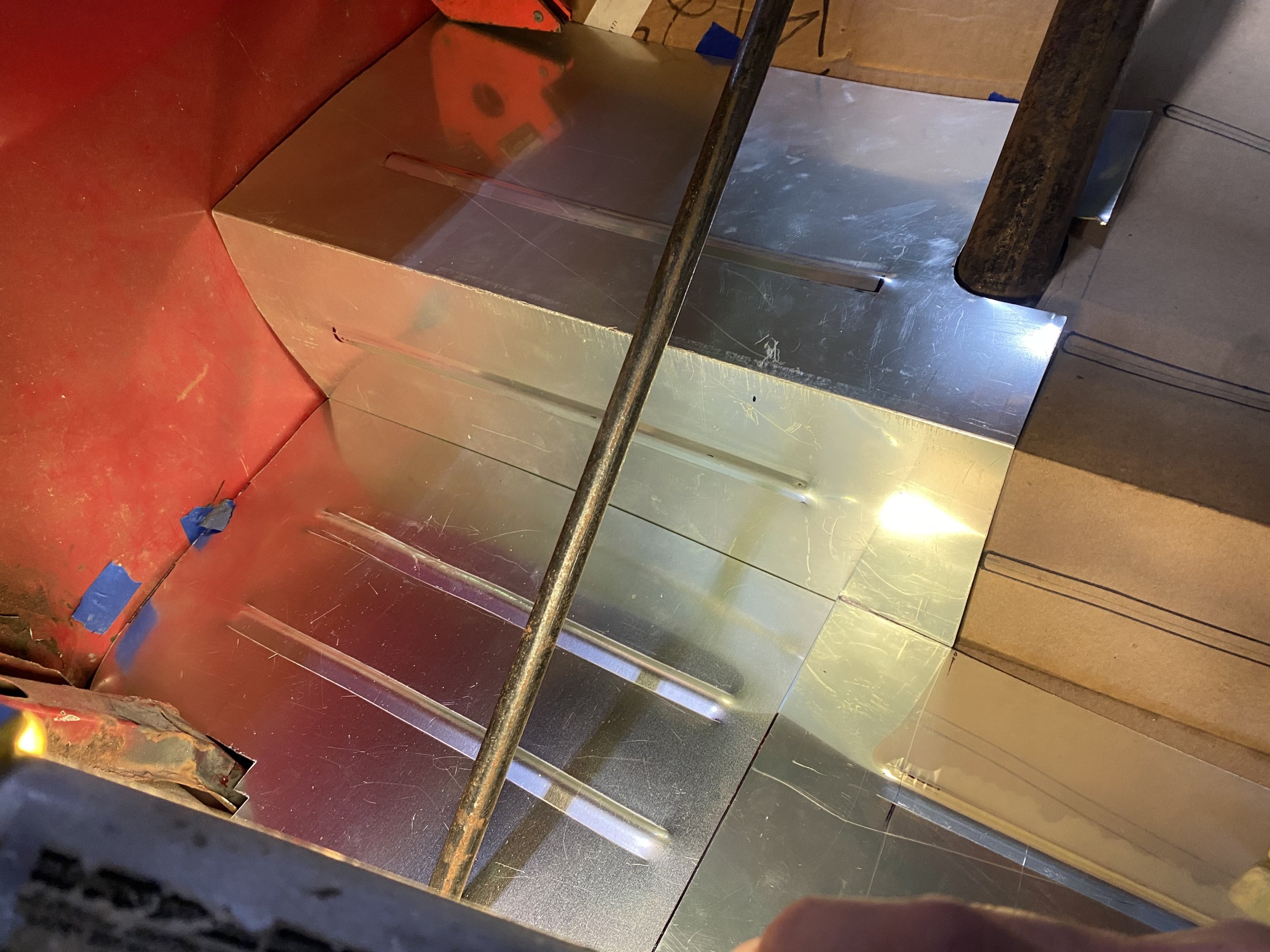

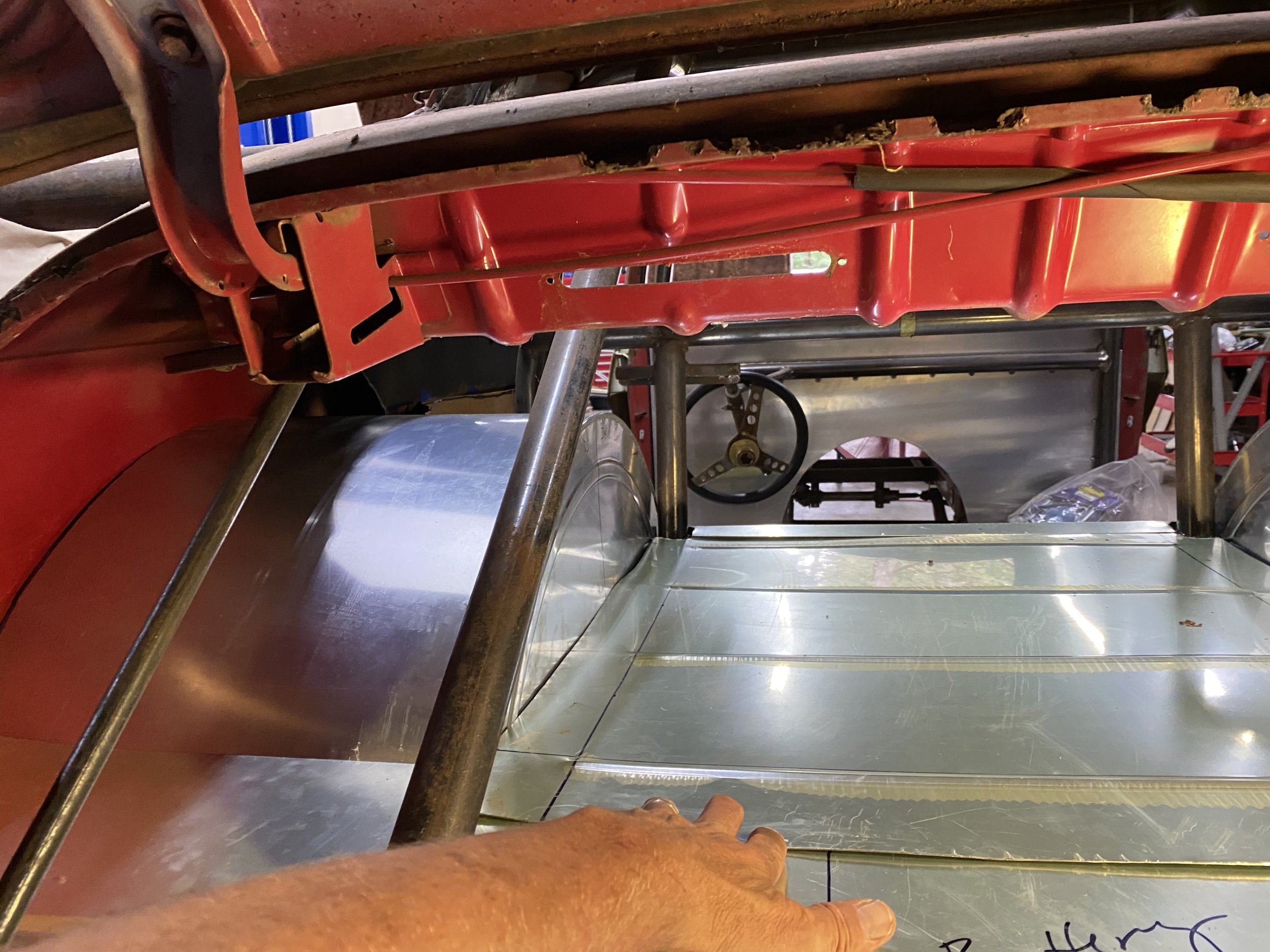

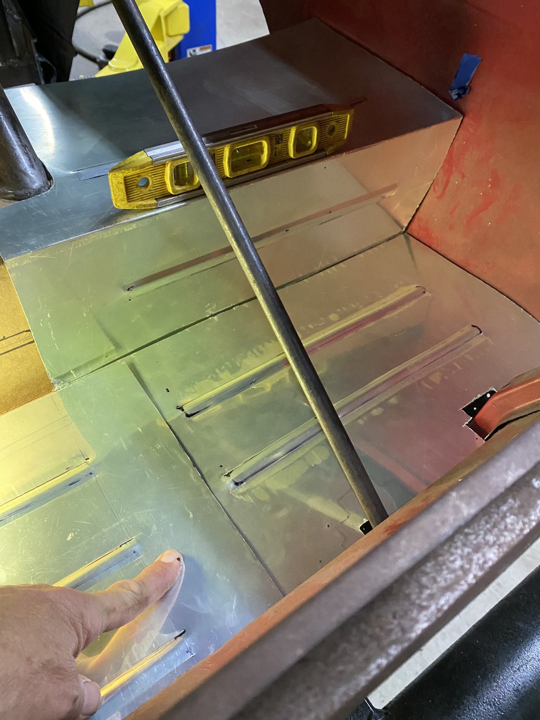

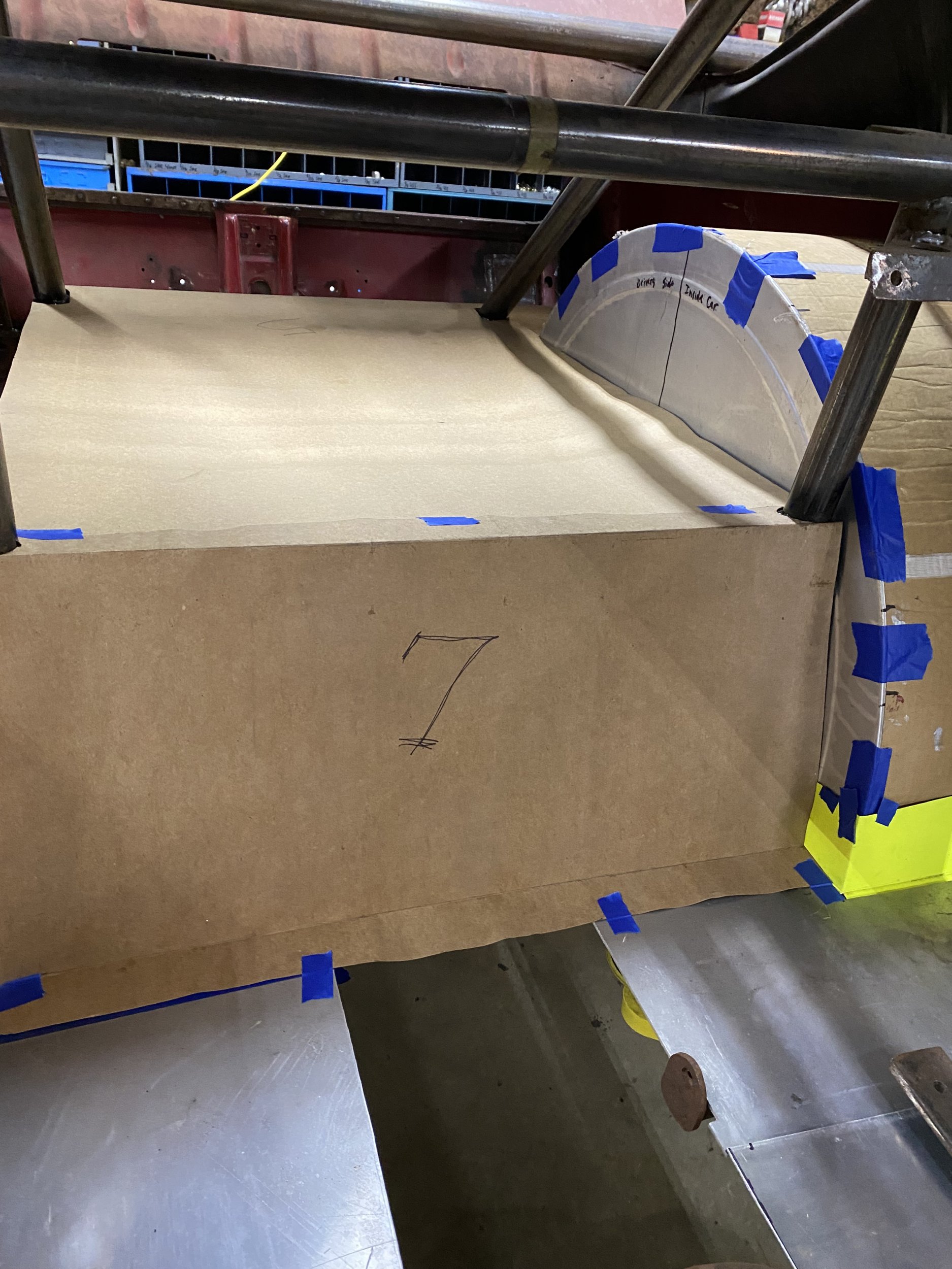

    The flip side piece in back right corners and the right rear step/bulkhead for the rear of the p*** wheel tub. That leaves the center panels. I am going to have to make it 2 possibly 3 pieces. The throat depth of my bead roller is just under 20 inches. Panel with step is 46. No way to reach the center of the panel if one piece.

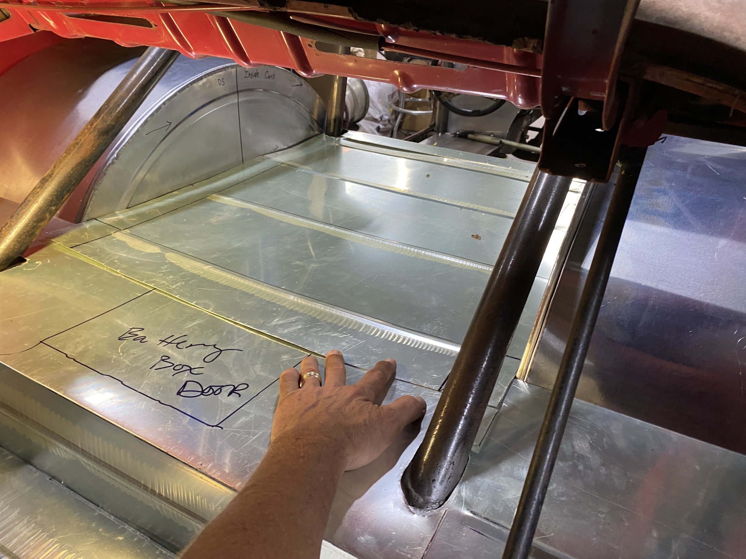

    I can step and flange or even over lap /under lap with no issues. Will depend on fit and to be honest battery location.

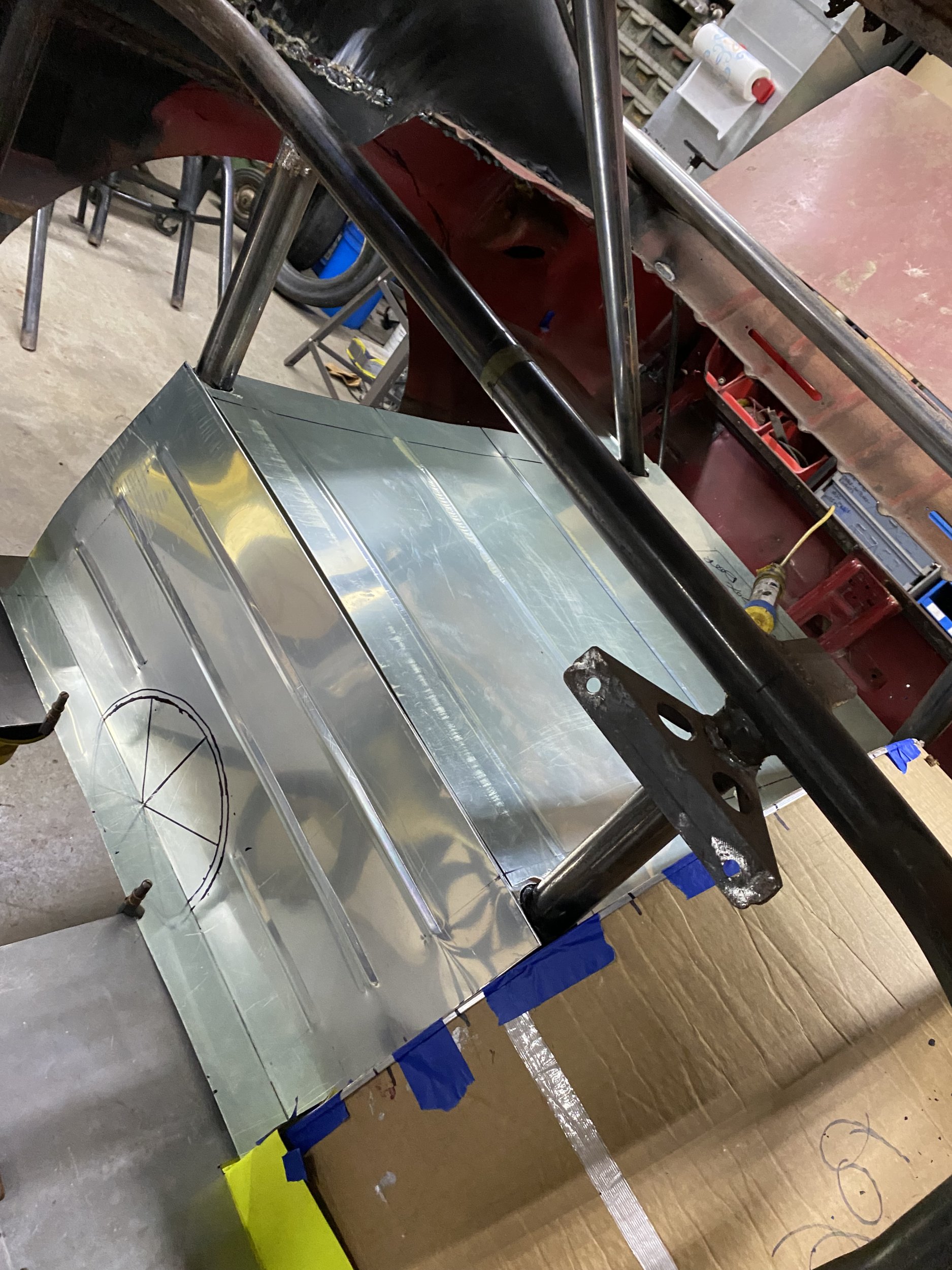

    I am one who always centers the battery. Do I may have to do a trap door for battery access. IMG_4688.jpeg IMG_4689.jpeg IMG_4690.jpeg IMG_4691.jpeg IMG_4692.jpeg IMG_4693.jpeg

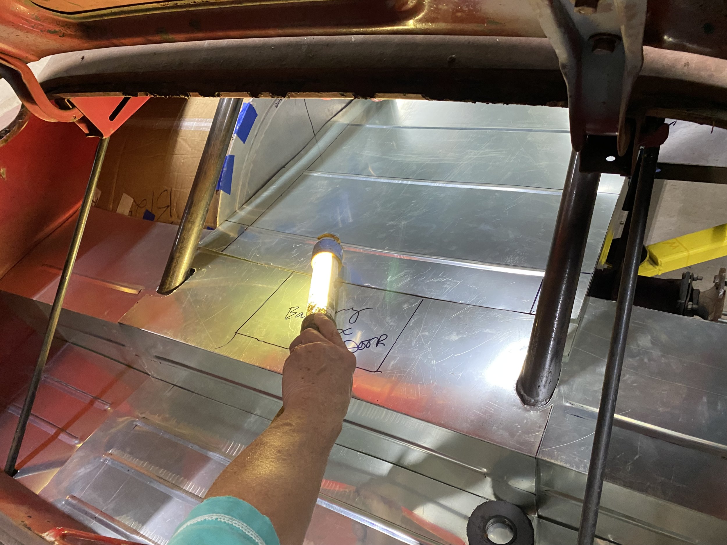

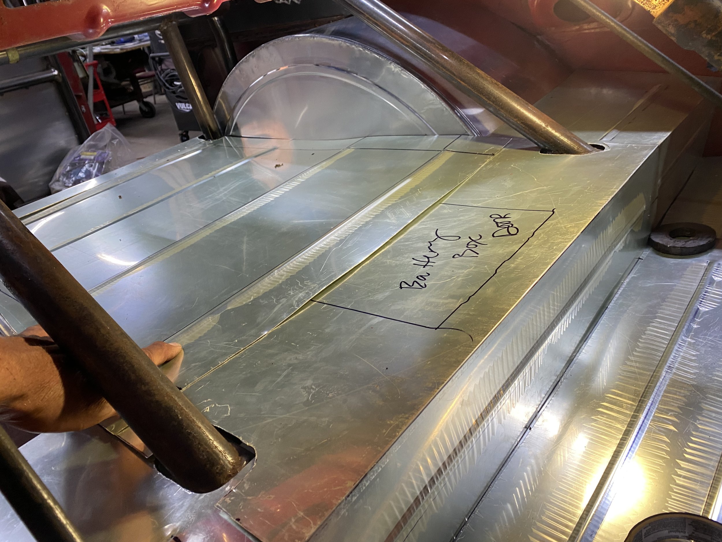

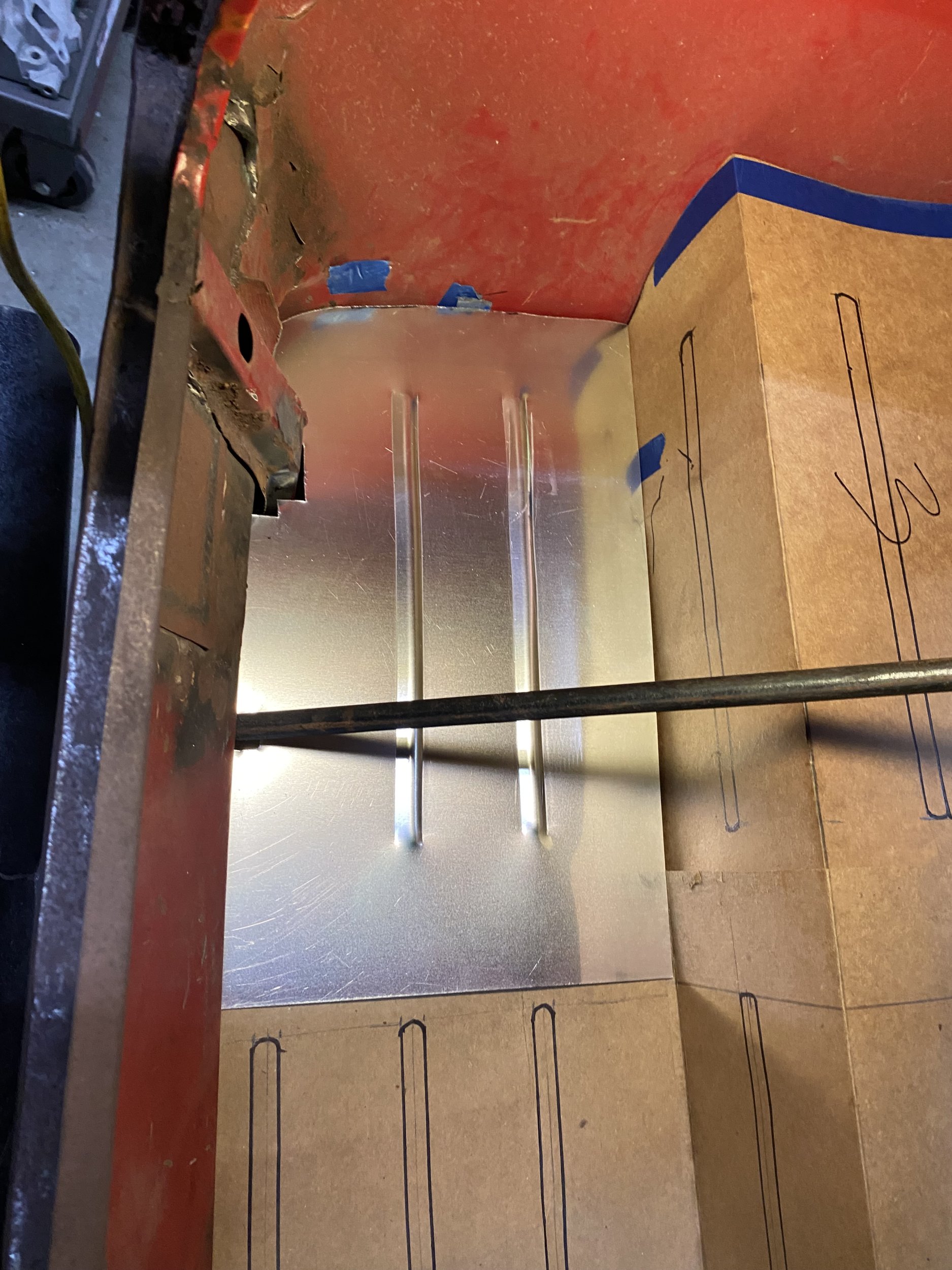

    Center panels and back bullhead complete. Also marked where battery will be. Will use a battery tray/top door. IMG_4698.jpeg IMG_4699.jpeg IMG_4700.jpeg IMG_4701.jpeg
    loudbang, enloe and 427 sleeper like this.

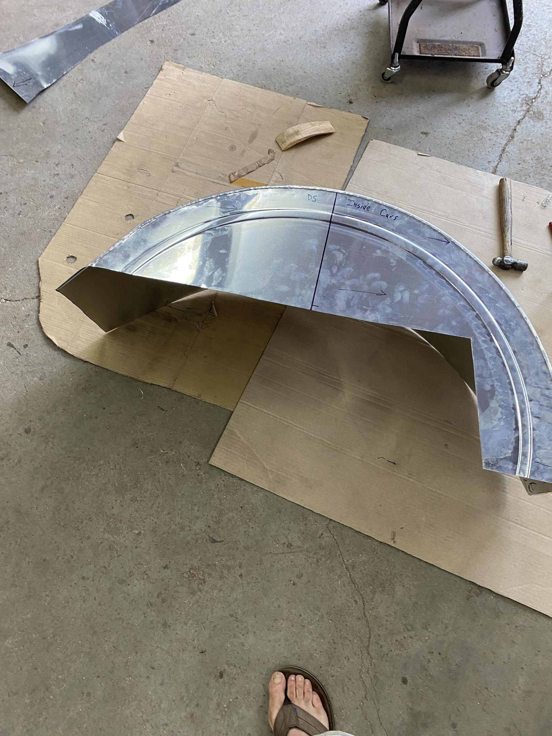

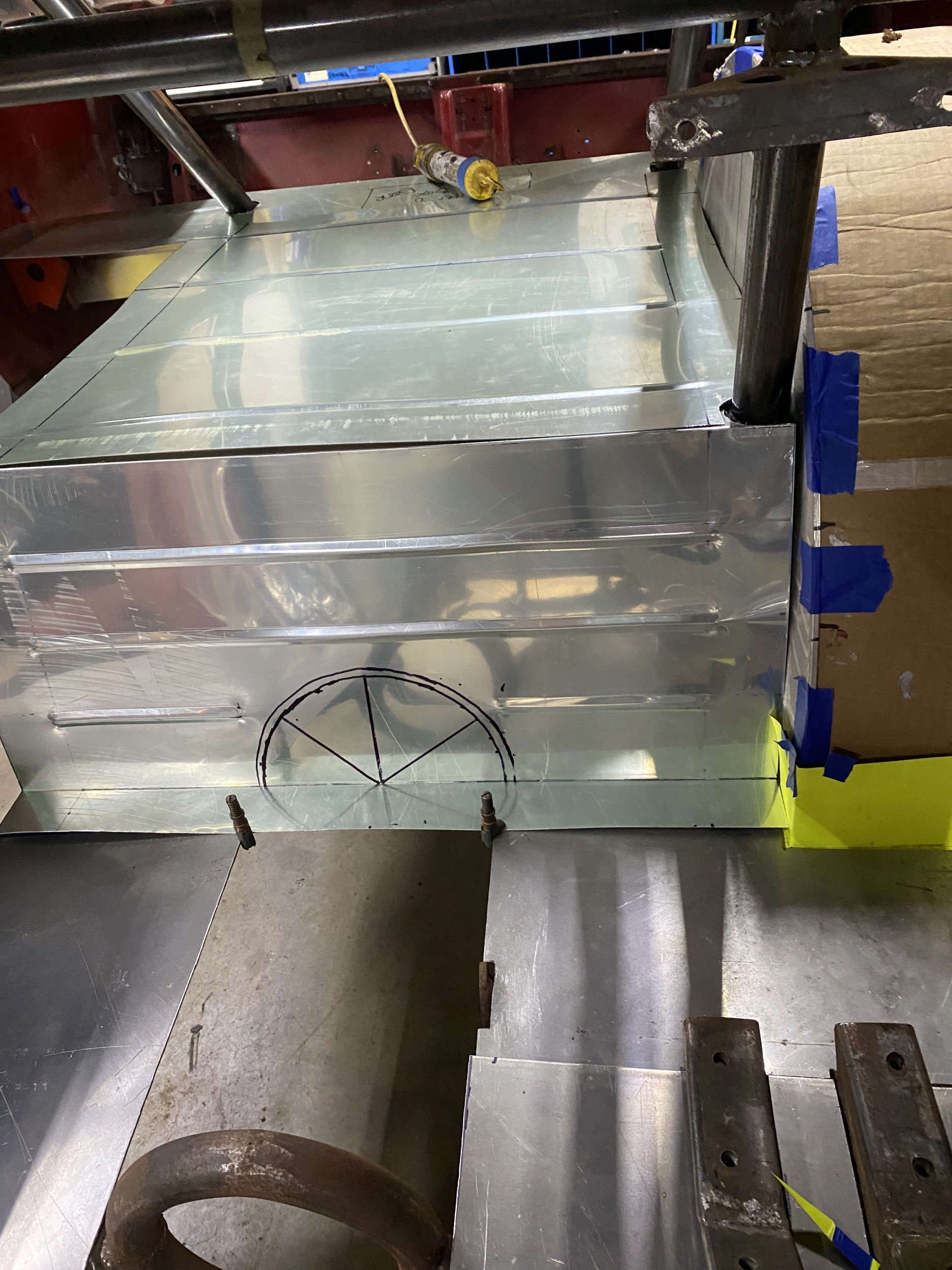

    Last rear interior panel finished. Wheel tub pattern is perfected. So that’s as good as done also only need to make outboard supports and use body skin adhesive to attach. Battery box and trap door will be it.
    Will then turn to MC mount /and hand controls. And for the record I haven’t peeled the plastic off yet So yes the scratches will disappear . IMG_4711.jpeg IMG_4712.jpeg IMG_4713.jpeg IMG_4714.jpeg IMG_4715.jpeg IMG_4716.jpeg

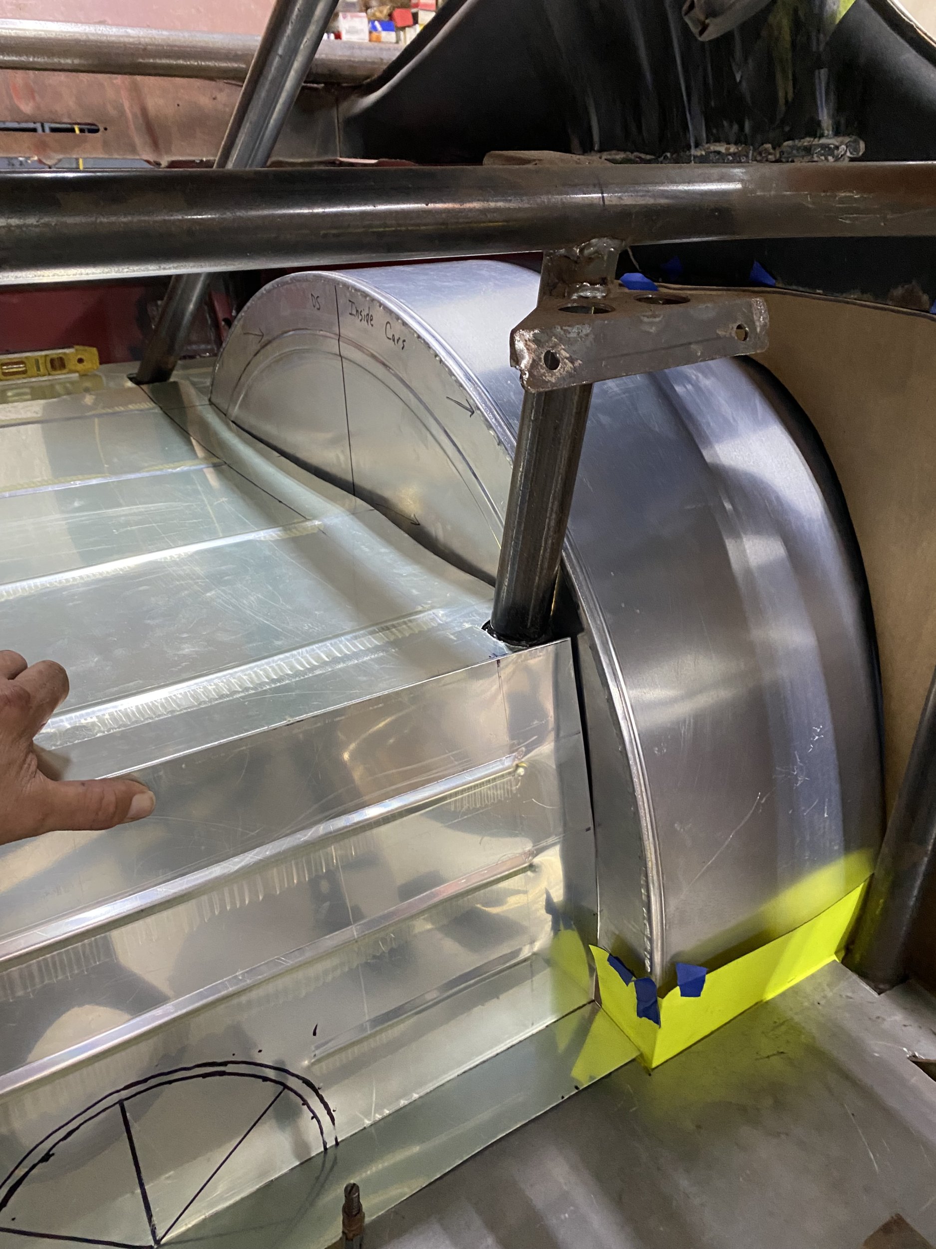

    Mitchell Rish

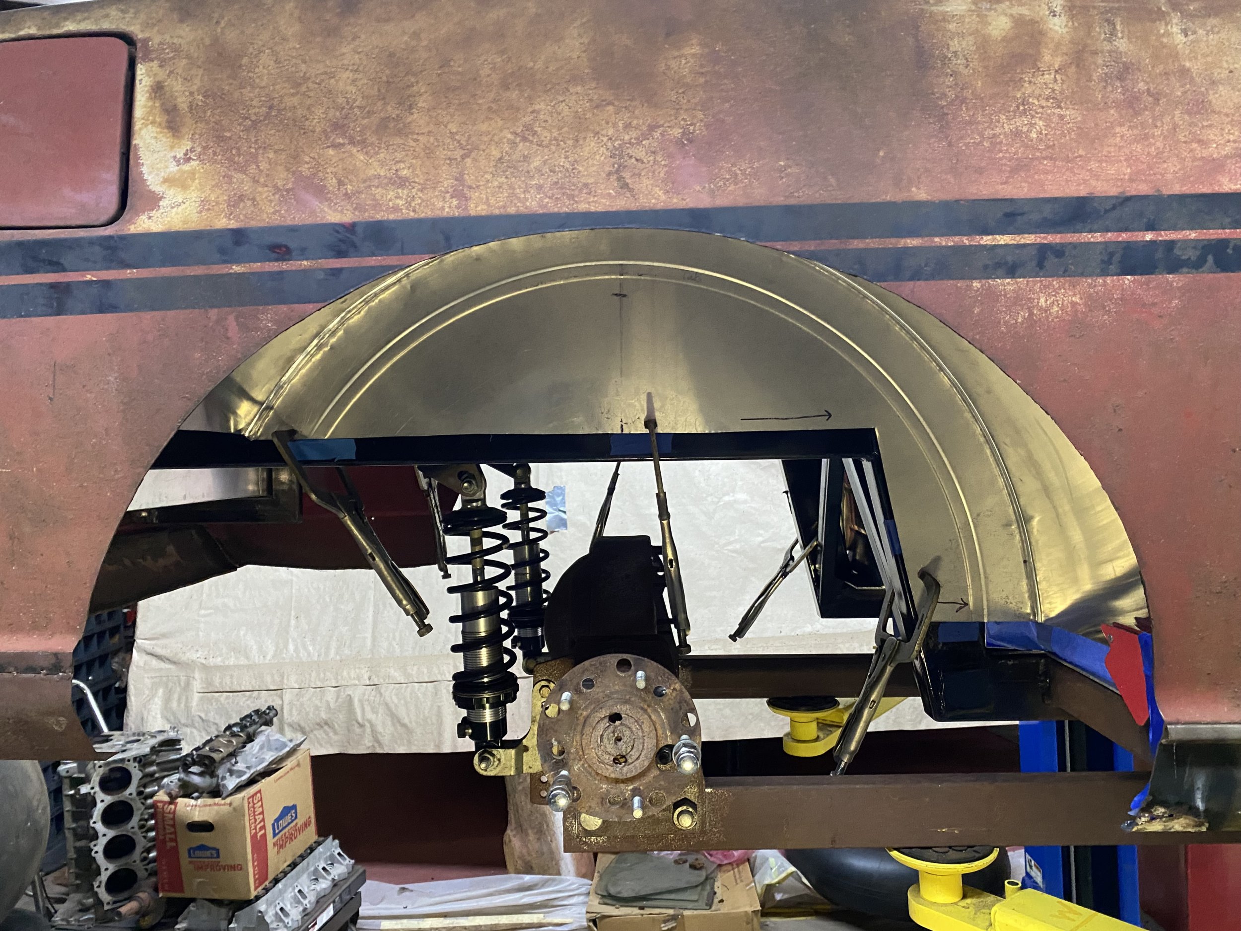

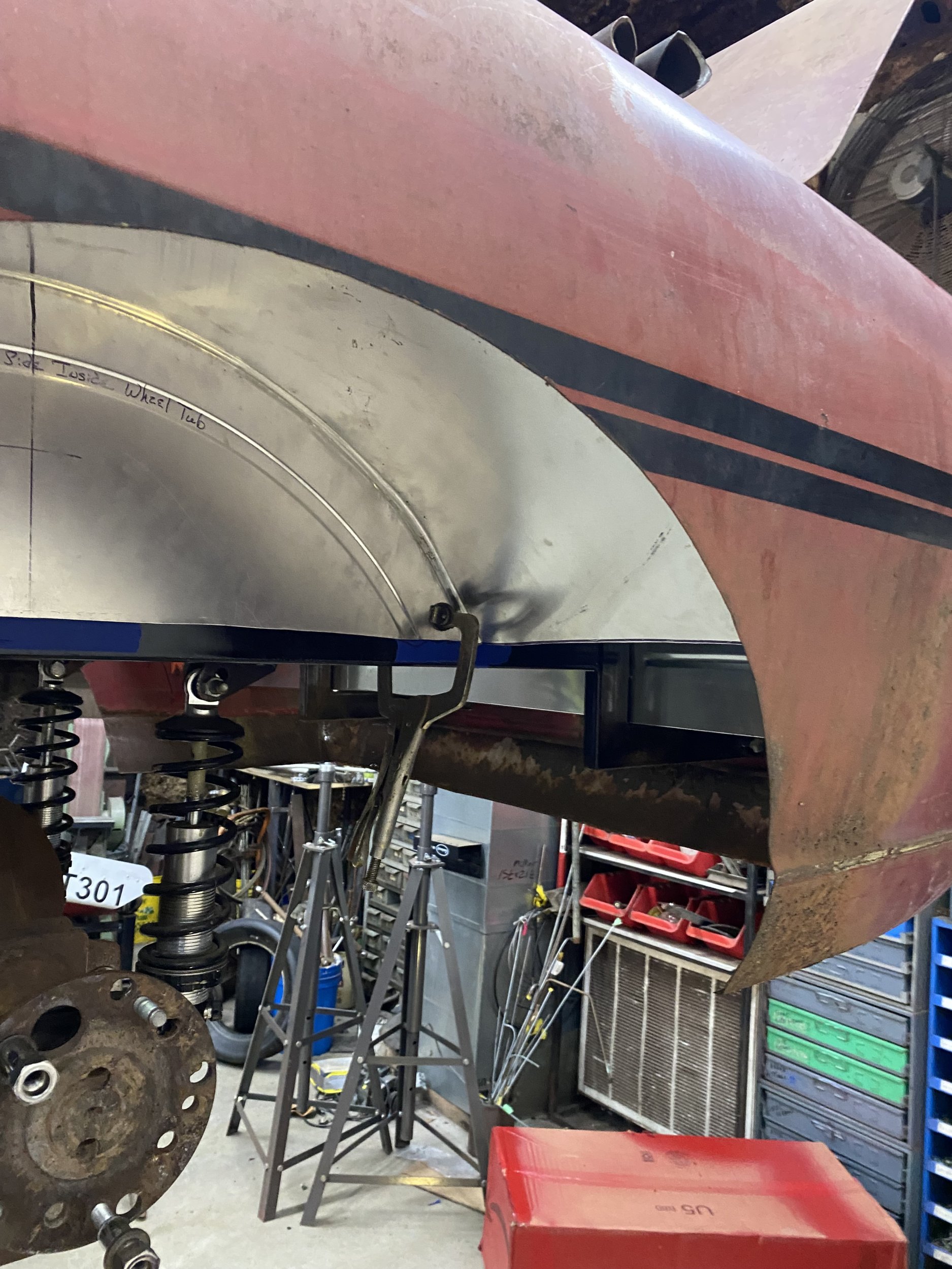

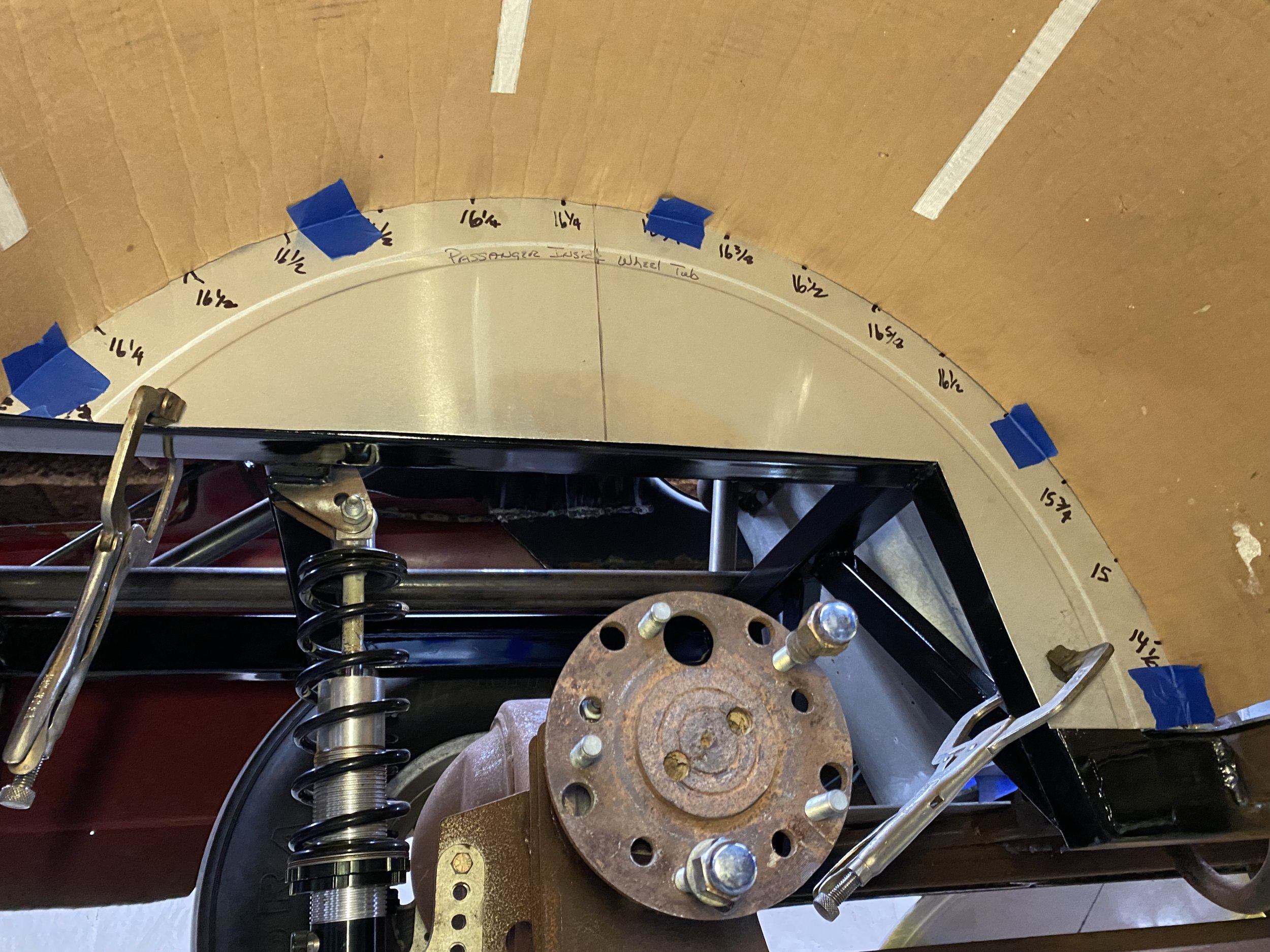

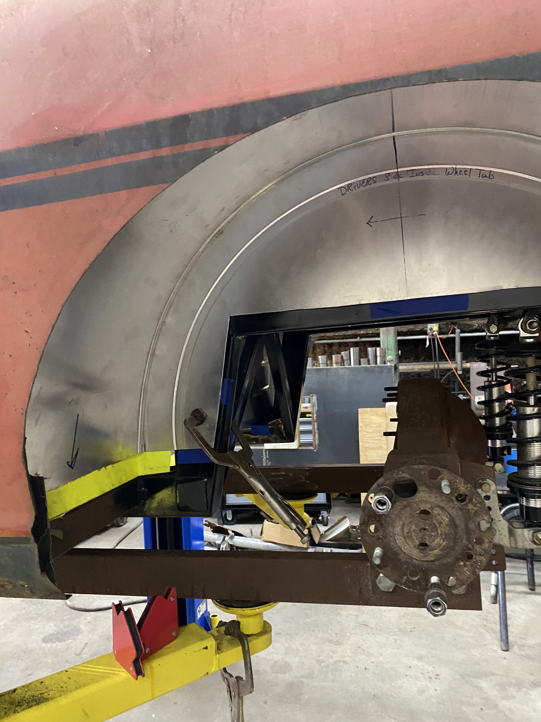

    from Houston MS

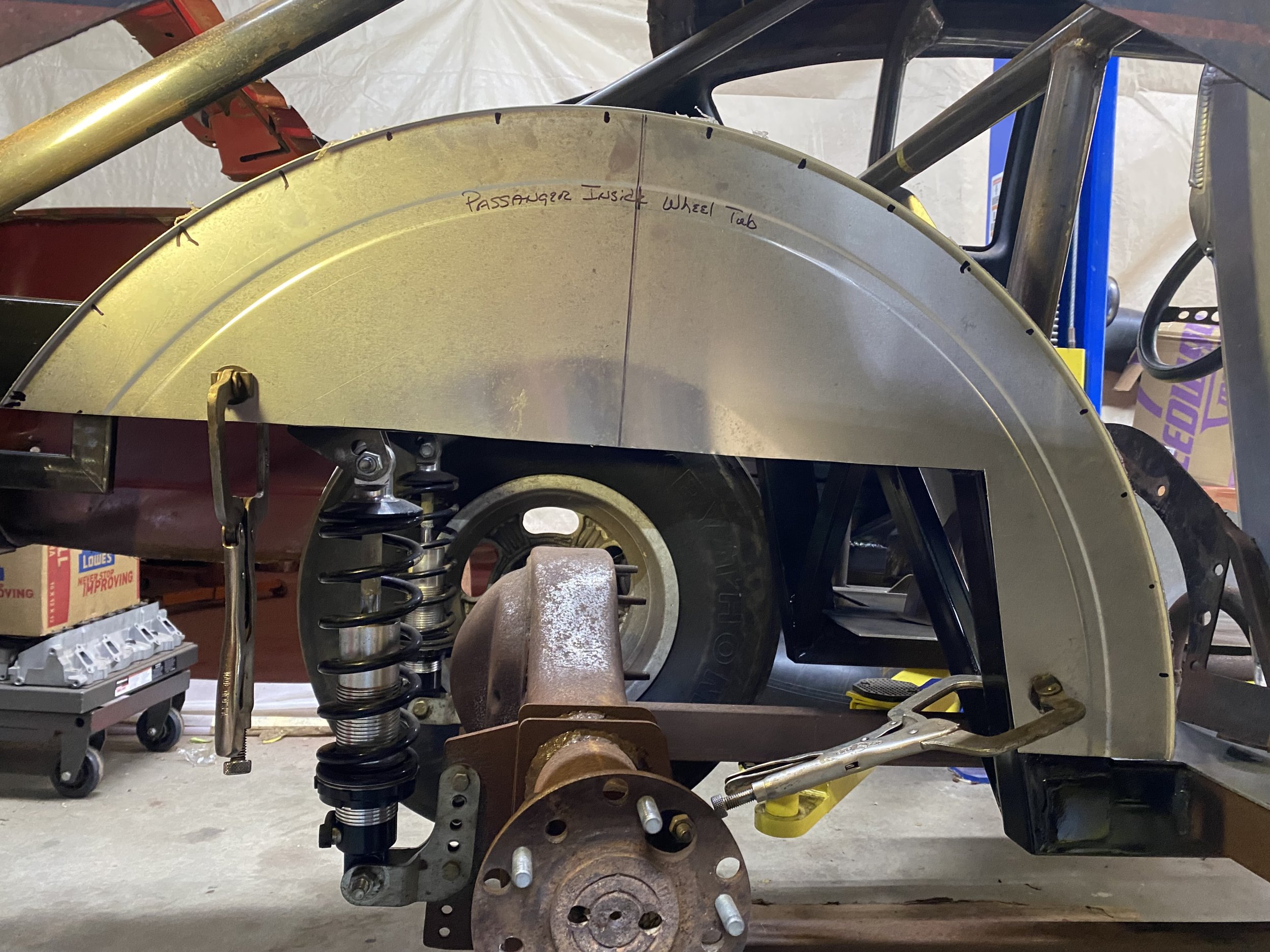

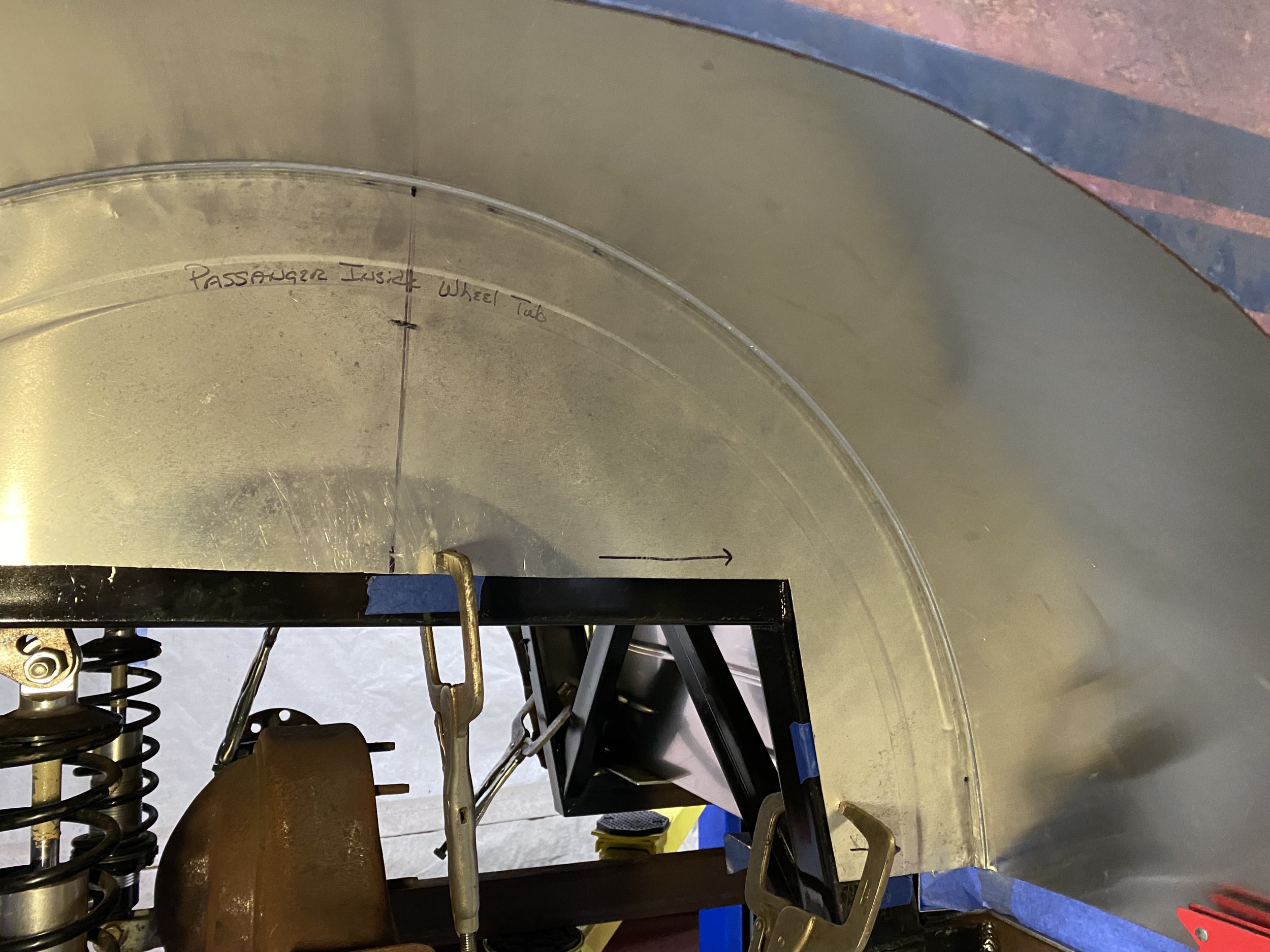

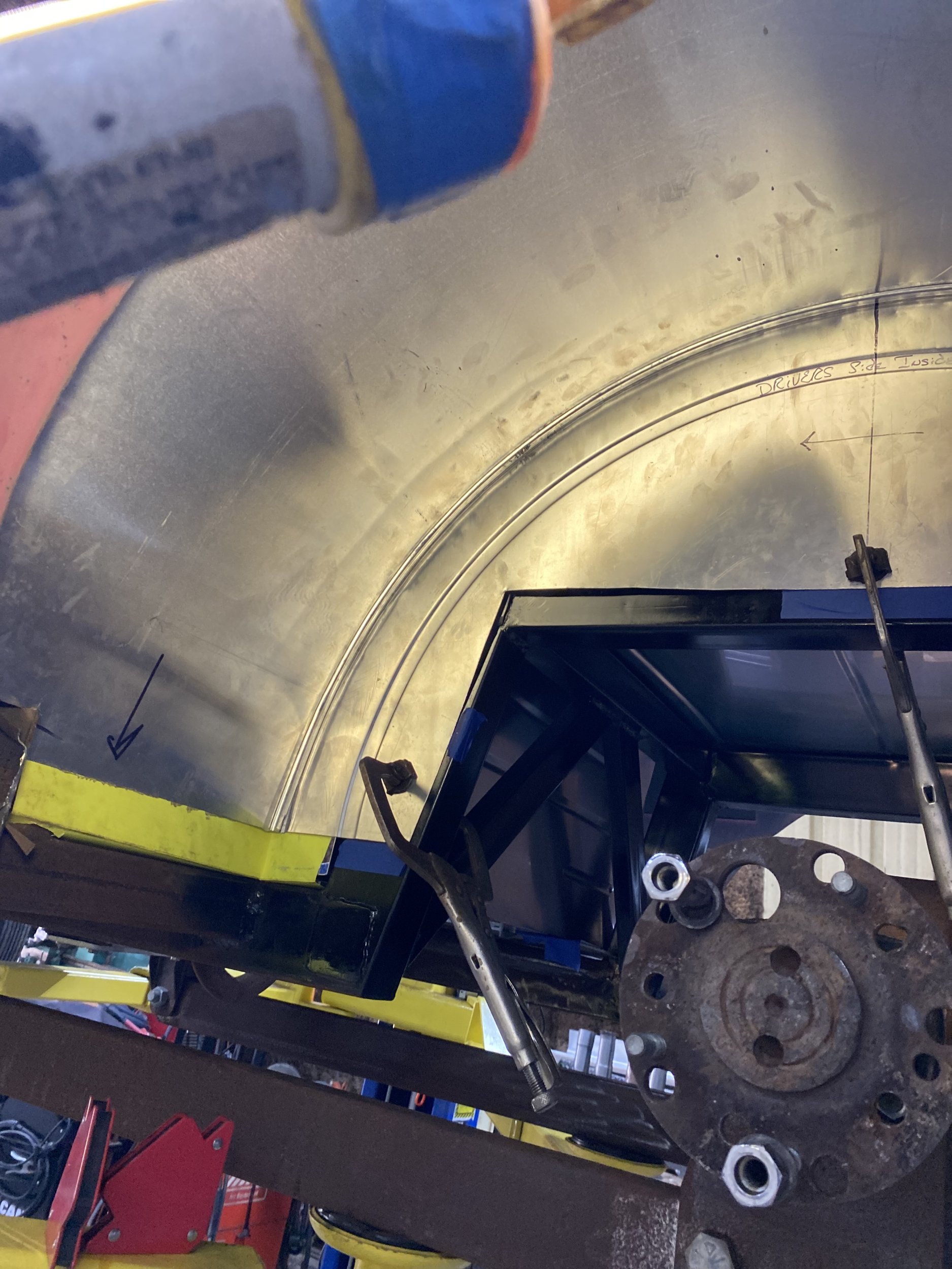

    Driver side wheel tub ***embled and fitted. Clamped into place to check fit. I am pretty pleased. I had considered a bead or two but decided to keep it simple. I have outboard lip to fit and attach. I will use body panel/skin adhesive. Then overlap and seal. The lower bulk head will be closed off as well to clean up the bottom seam. Will cleco and then use transition brace/plates. I am also going to consider using body panel/skin adhesive in place of so many rivets. I want a smooth flowing seam and flow and too many rivets complicate that.
    Wes said it p***ed inspection.
    Won’t be long and we will address hand controls ( for him). IMG_4759.jpeg IMG_4761.jpeg IMG_4762.jpeg IMG_4764.jpeg IMG_4765.jpeg IMG_4767.jpeg IMG_4769.jpeg IMG_4771.jpeg IMG_4772.jpeg IMG_4773.jpeg IMG_4774.jpeg

    P***enger side fitted as well. Now the outboard supports for both sides. After they are fitted and confirmed I’ll do battery bad and trap door. IMG_4788.jpeg IMG_4789.jpeg IMG_4790.jpeg IMG_4791.jpeg IMG_4792.jpeg IMG_4793.jpeg IMG_4794.jpeg IMG_4798.png

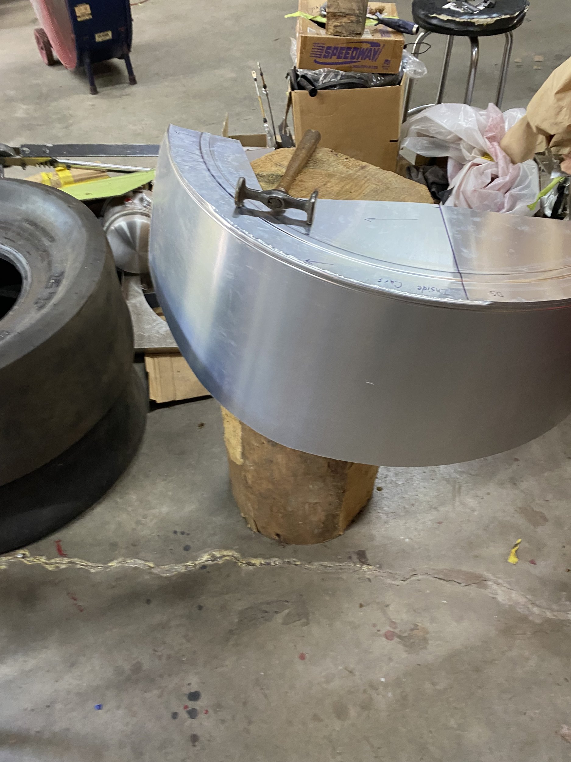

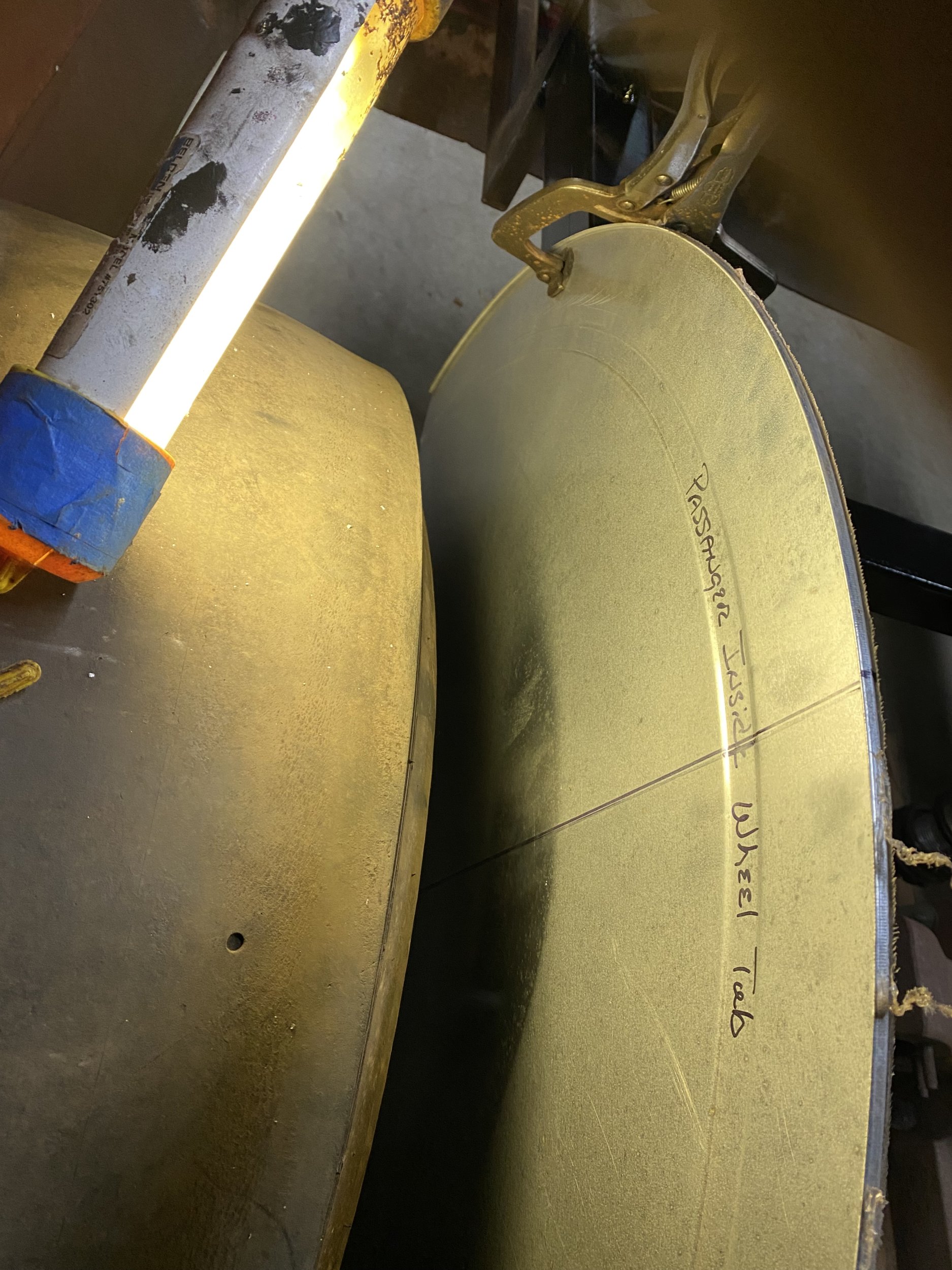

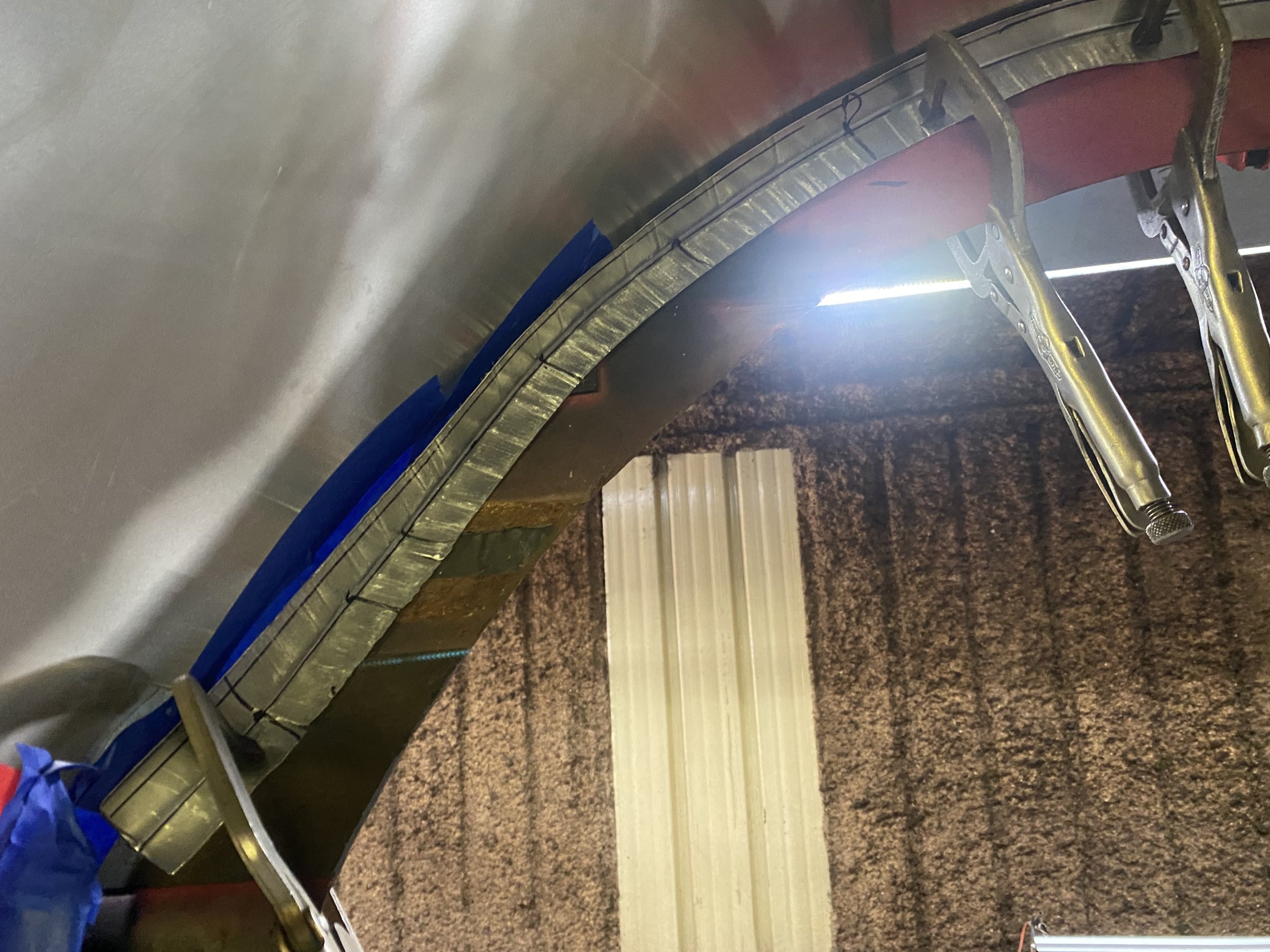

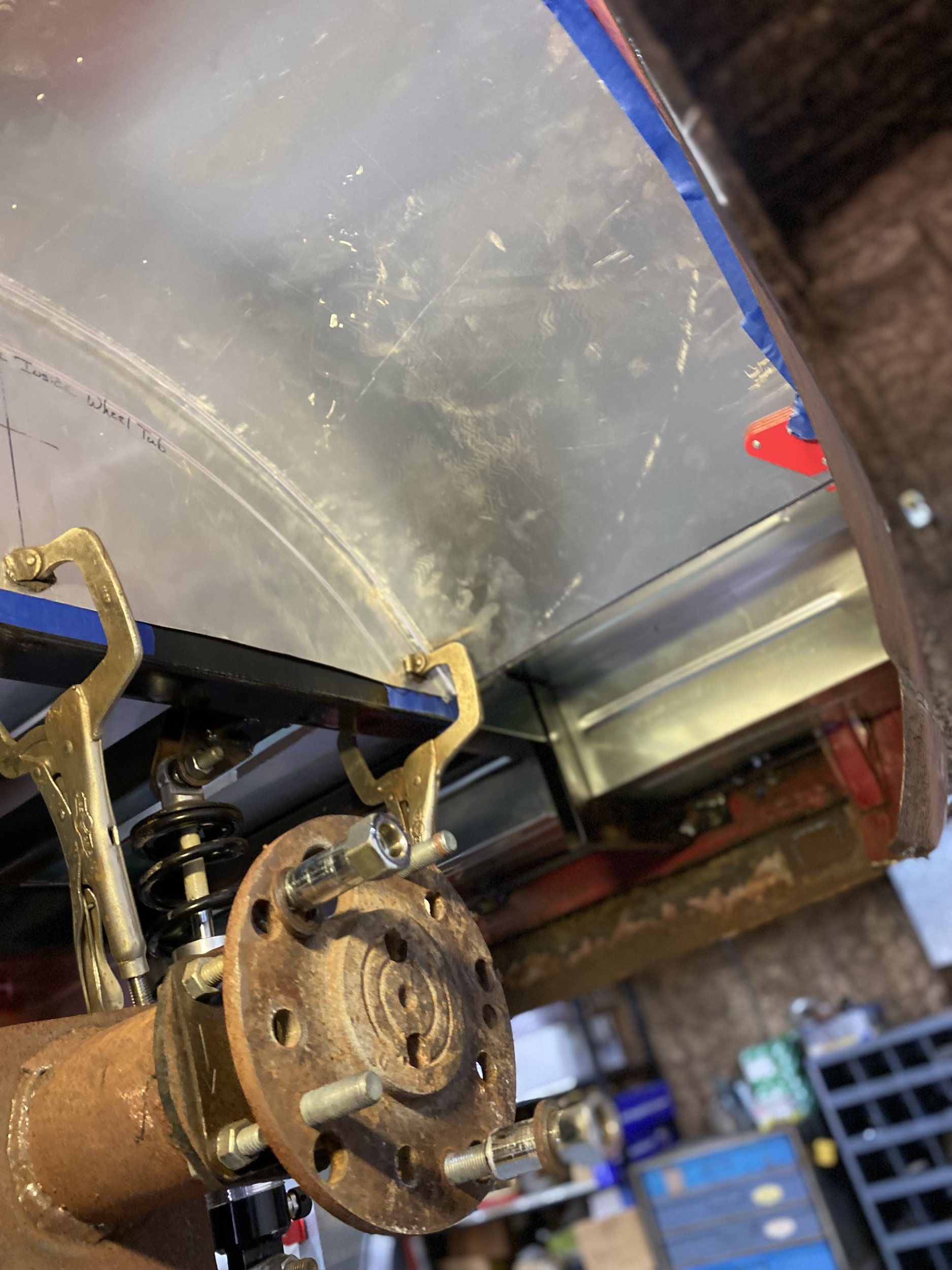

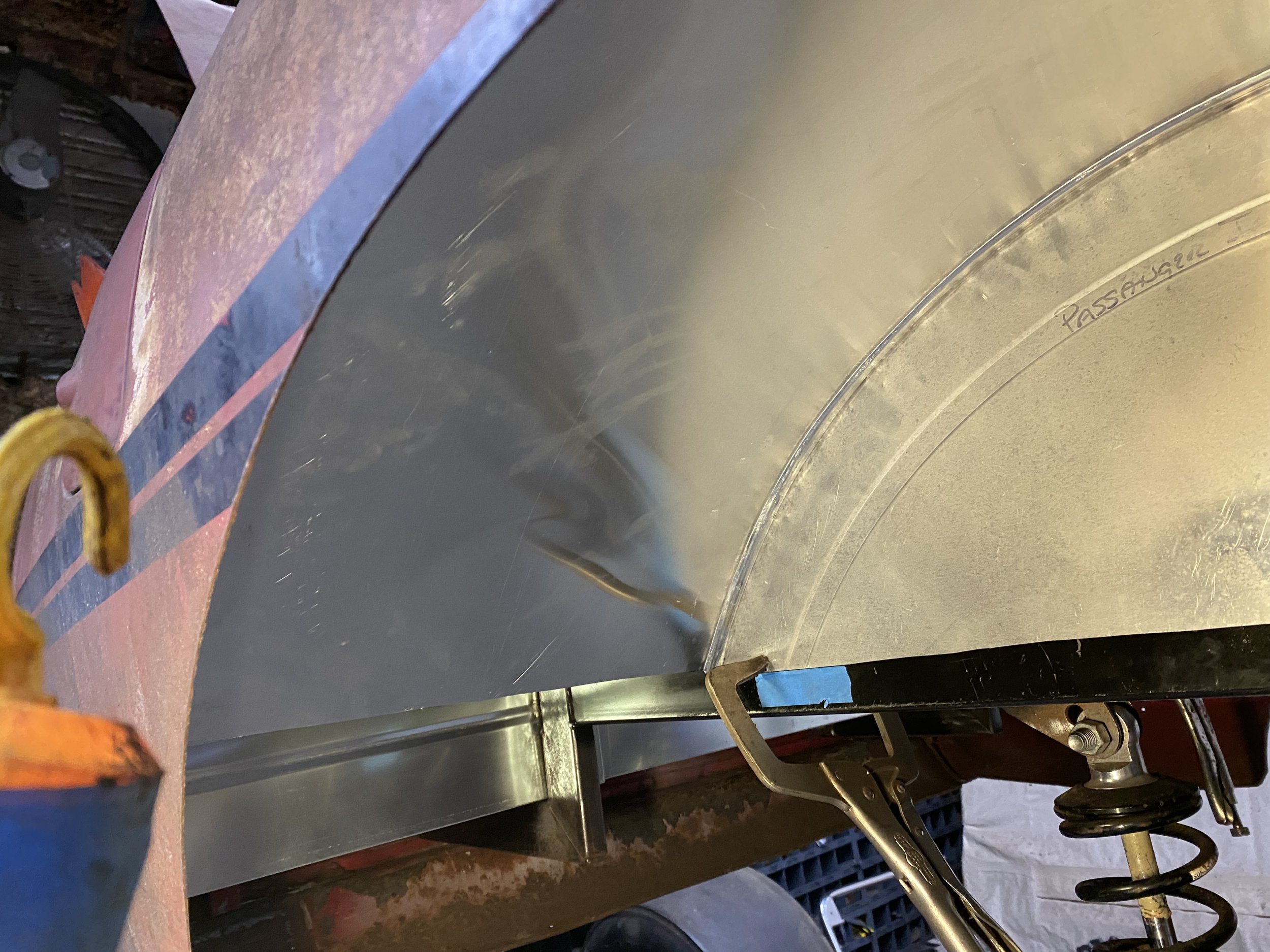

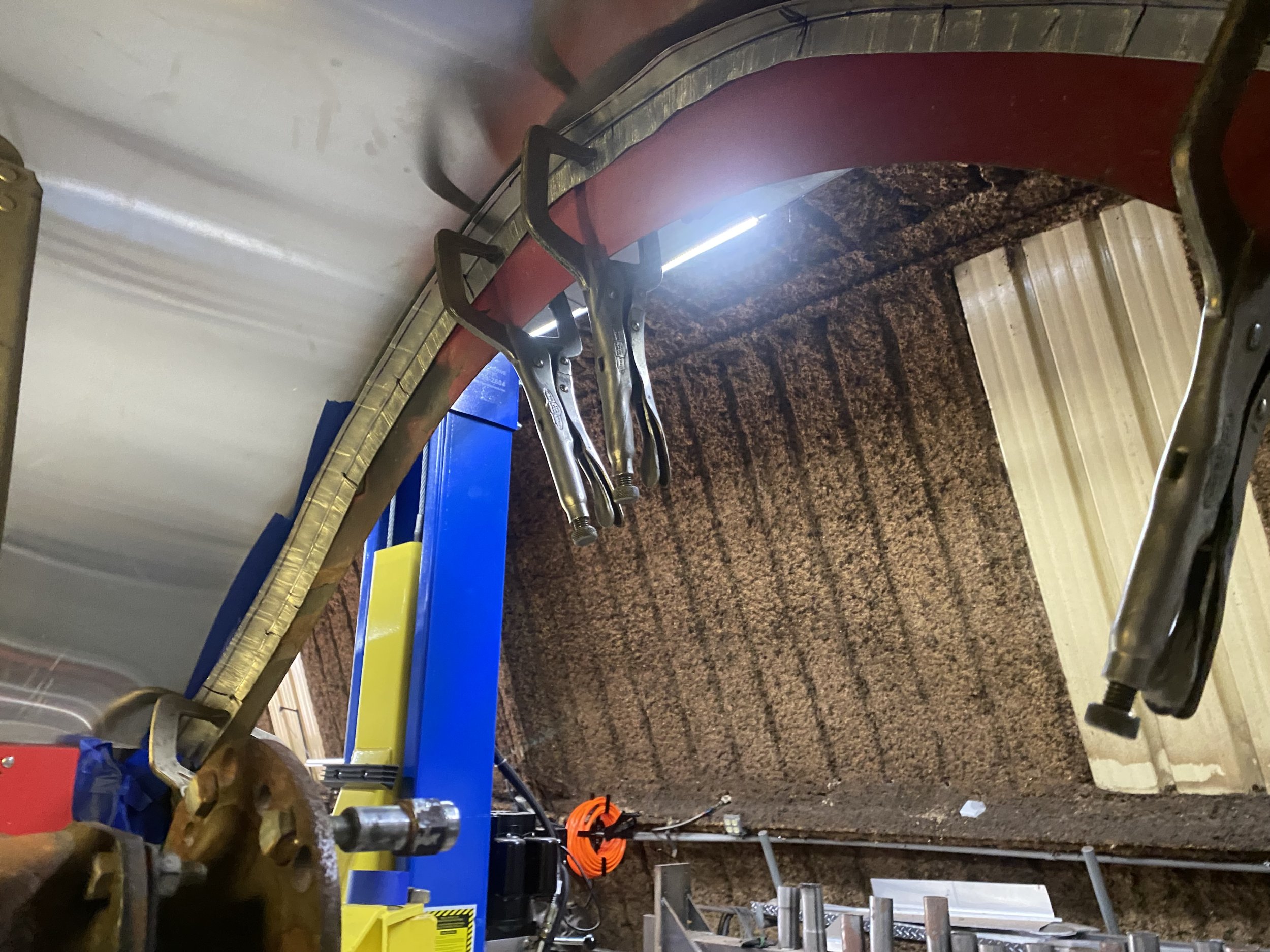

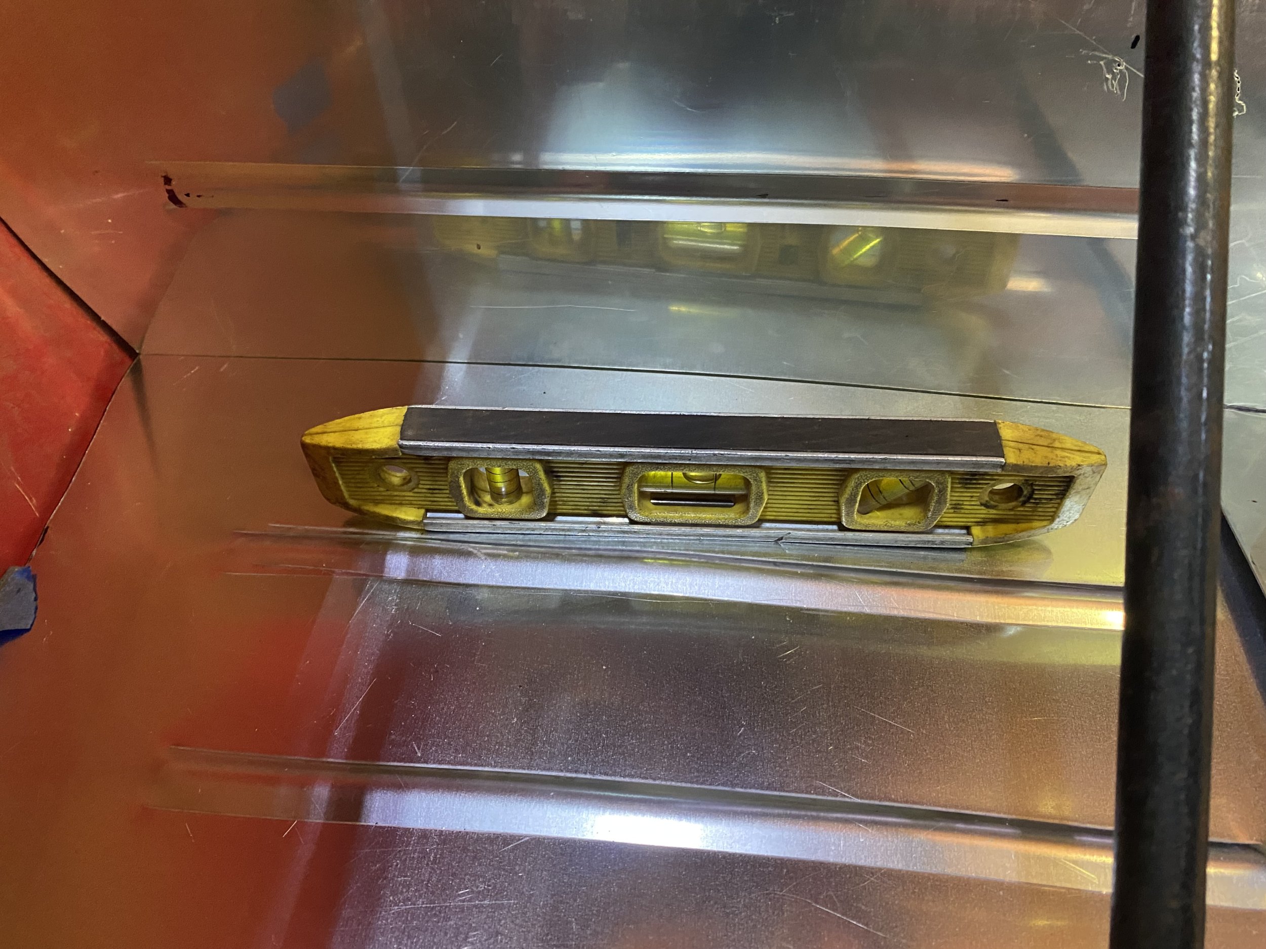

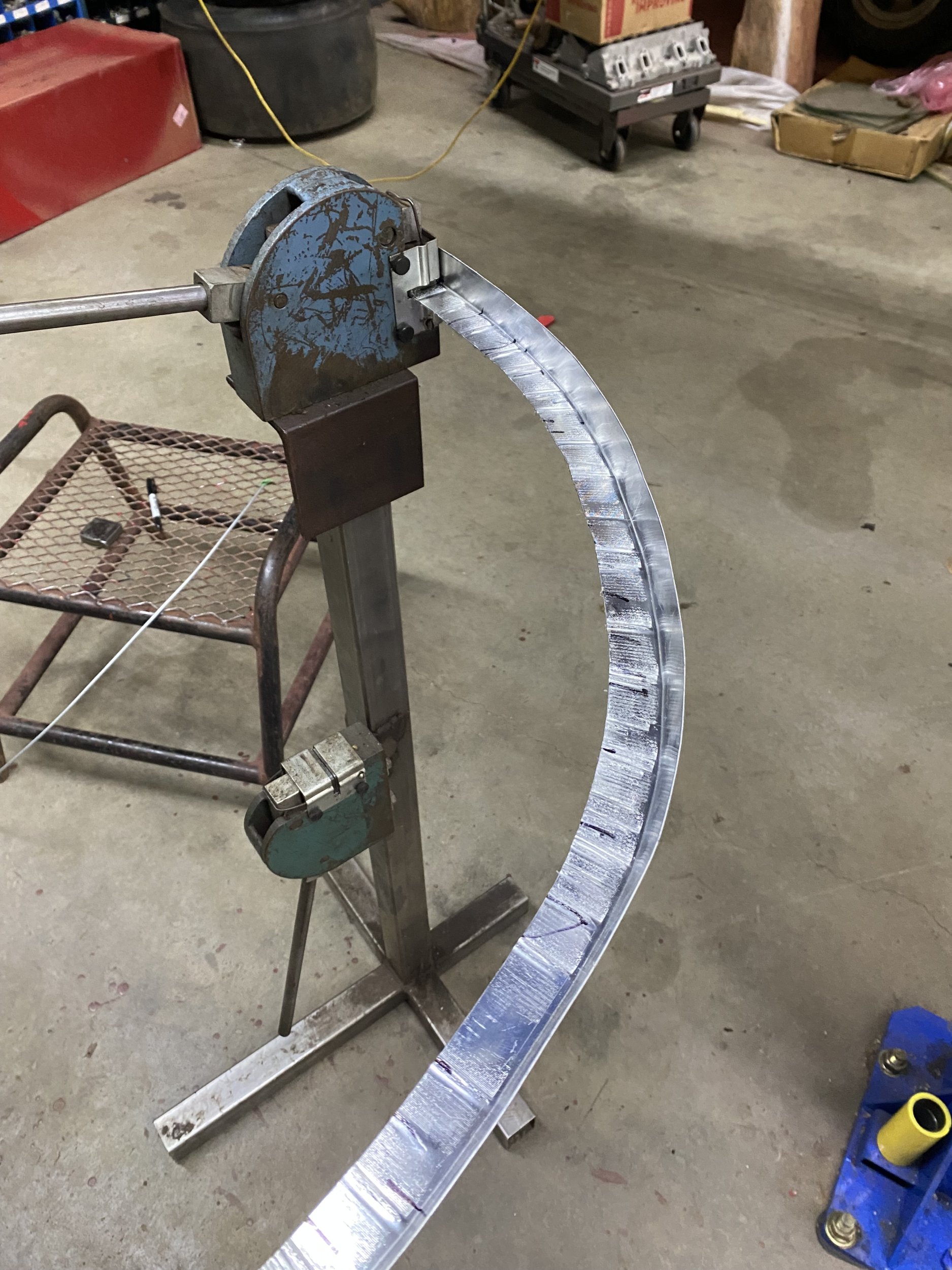

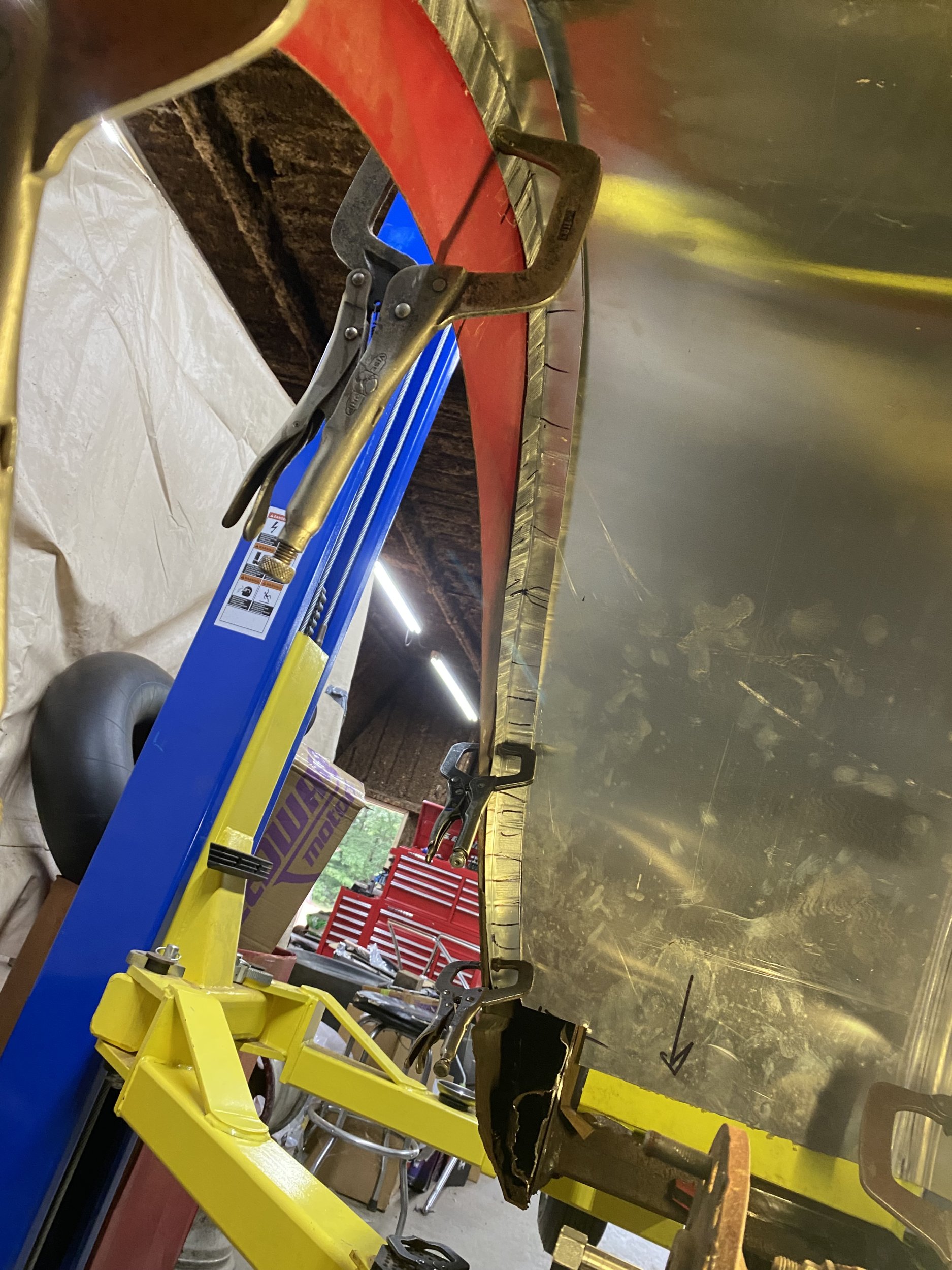

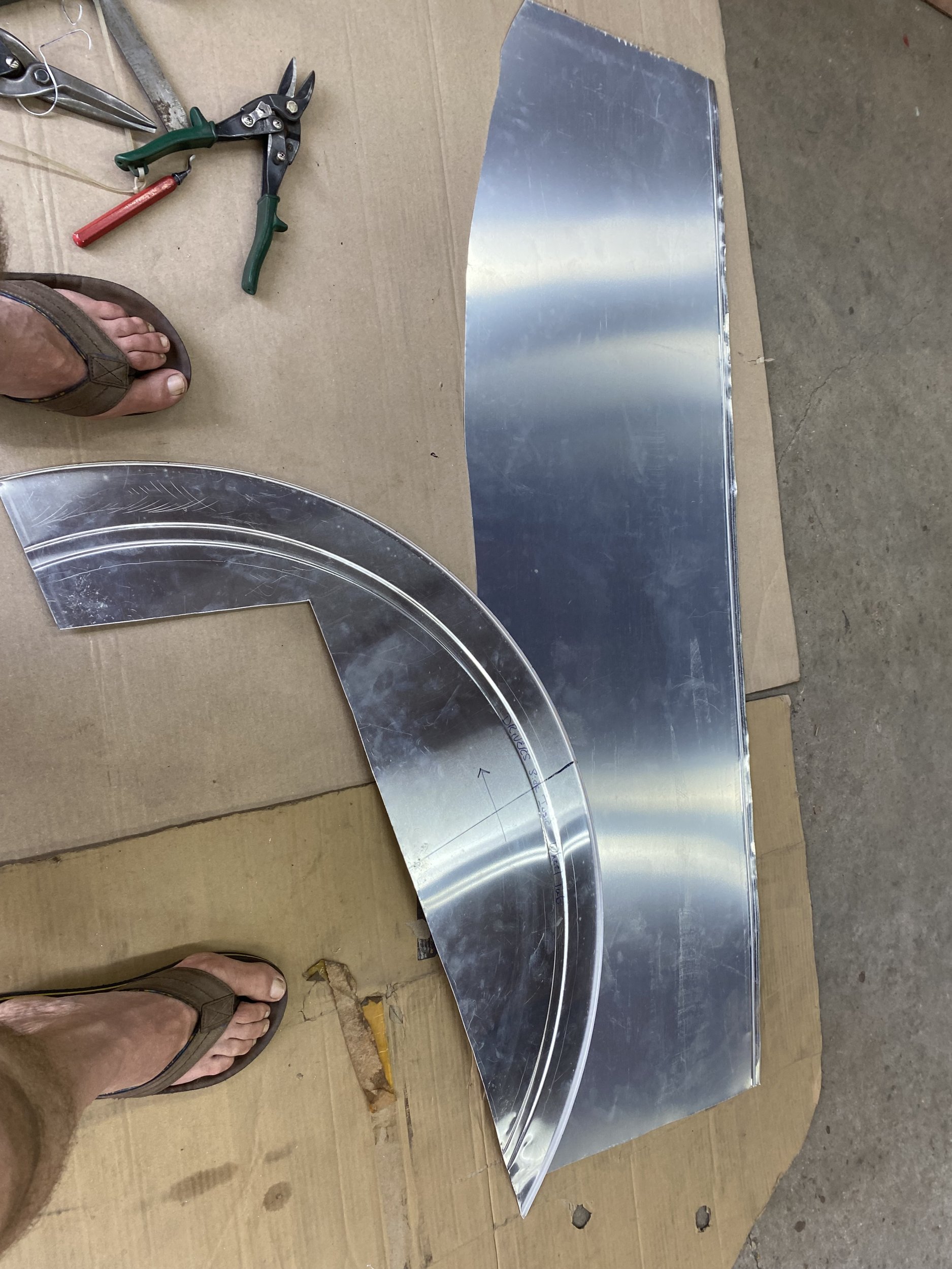

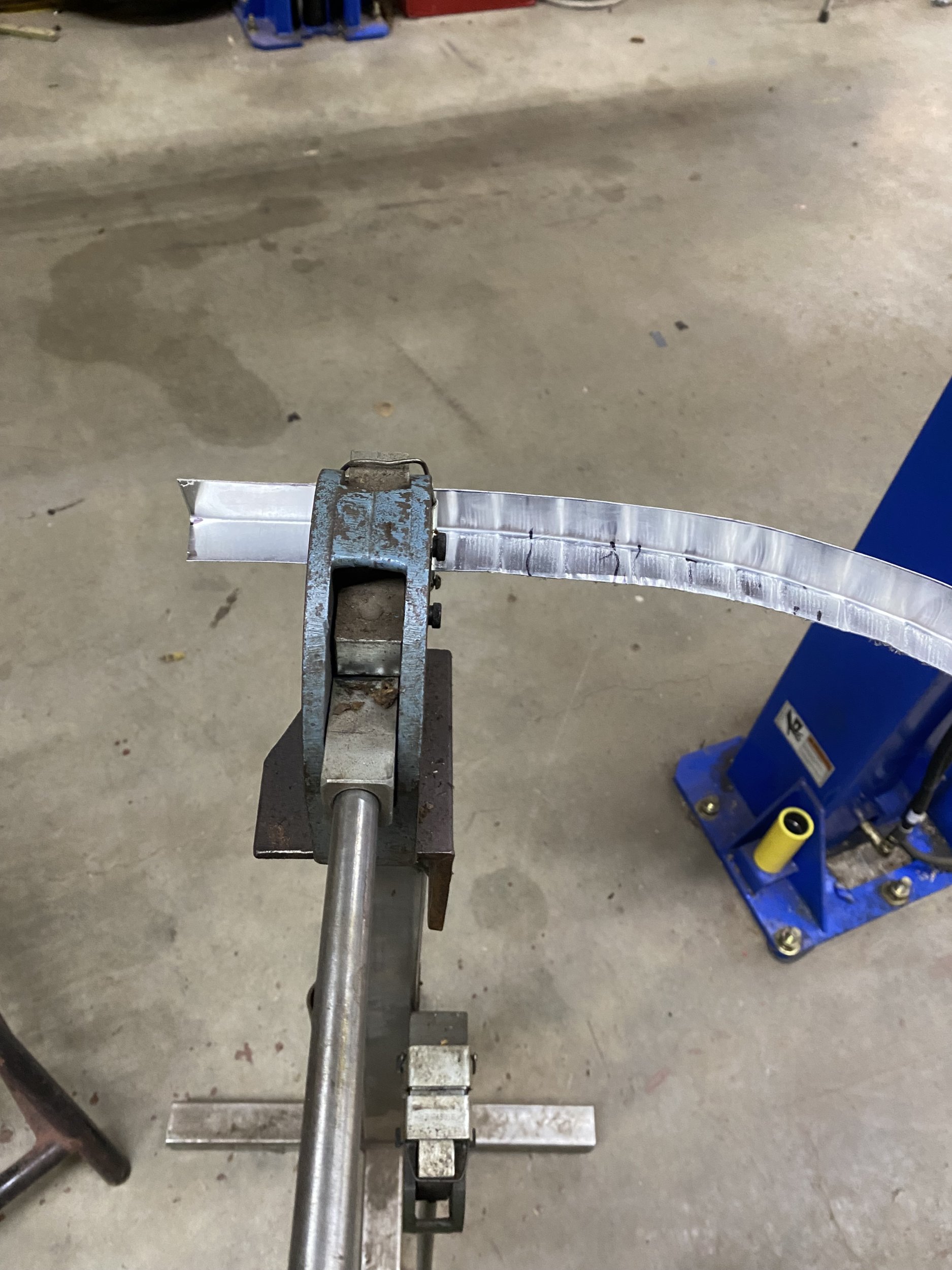

    Worked on outboard wheel tub supports. Shrinker stretcher got a work out. Got a few more tweaks and then I’ll use the panel adhesive. Also have to copy an exact opposite for driver side. IMG_4851.jpeg IMG_4852.jpeg IMG_4854.jpeg
  30. Mitchell Rish
    Posts: 2,375
    Mitchell Rish
    from Houston MS

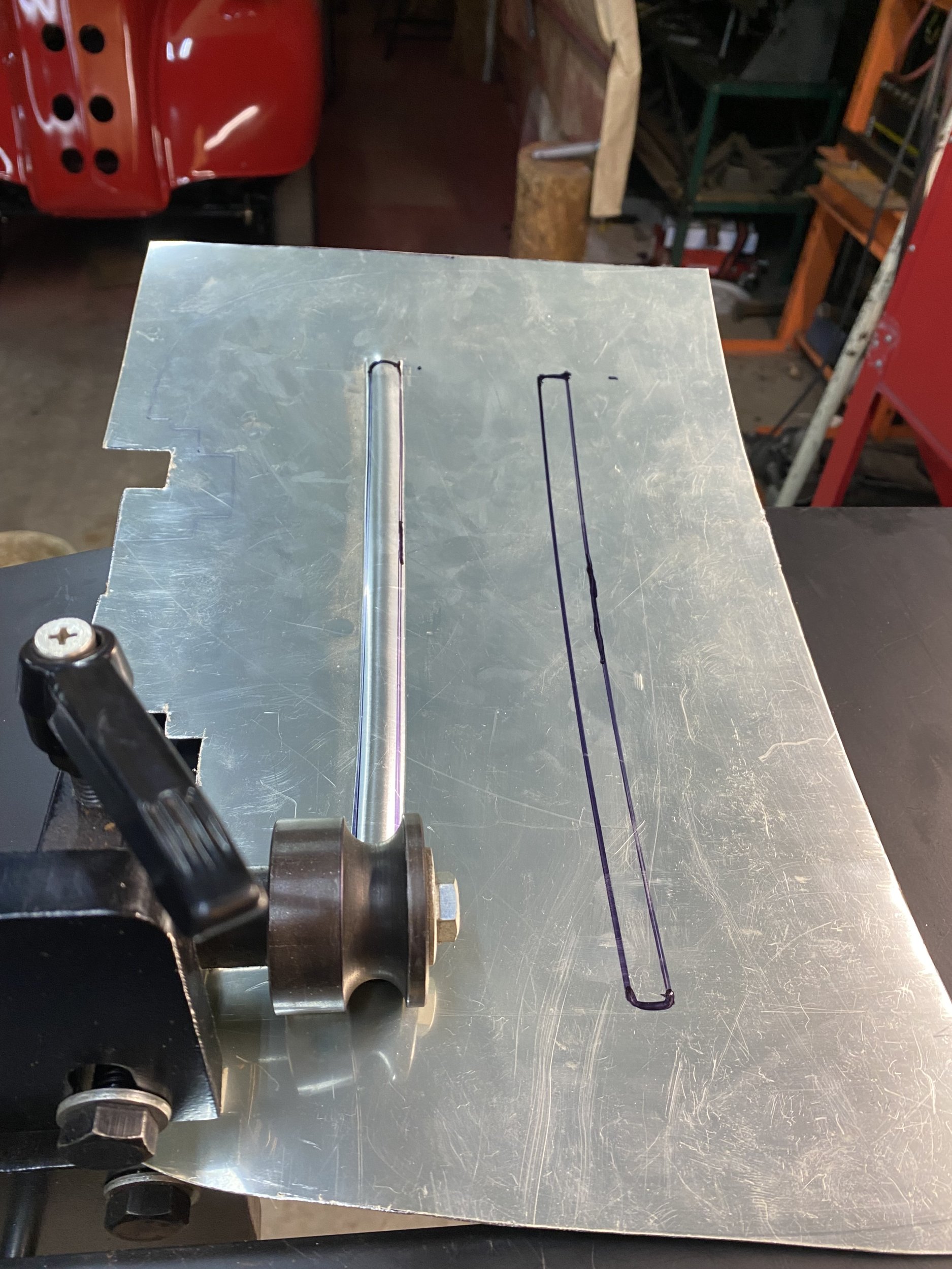

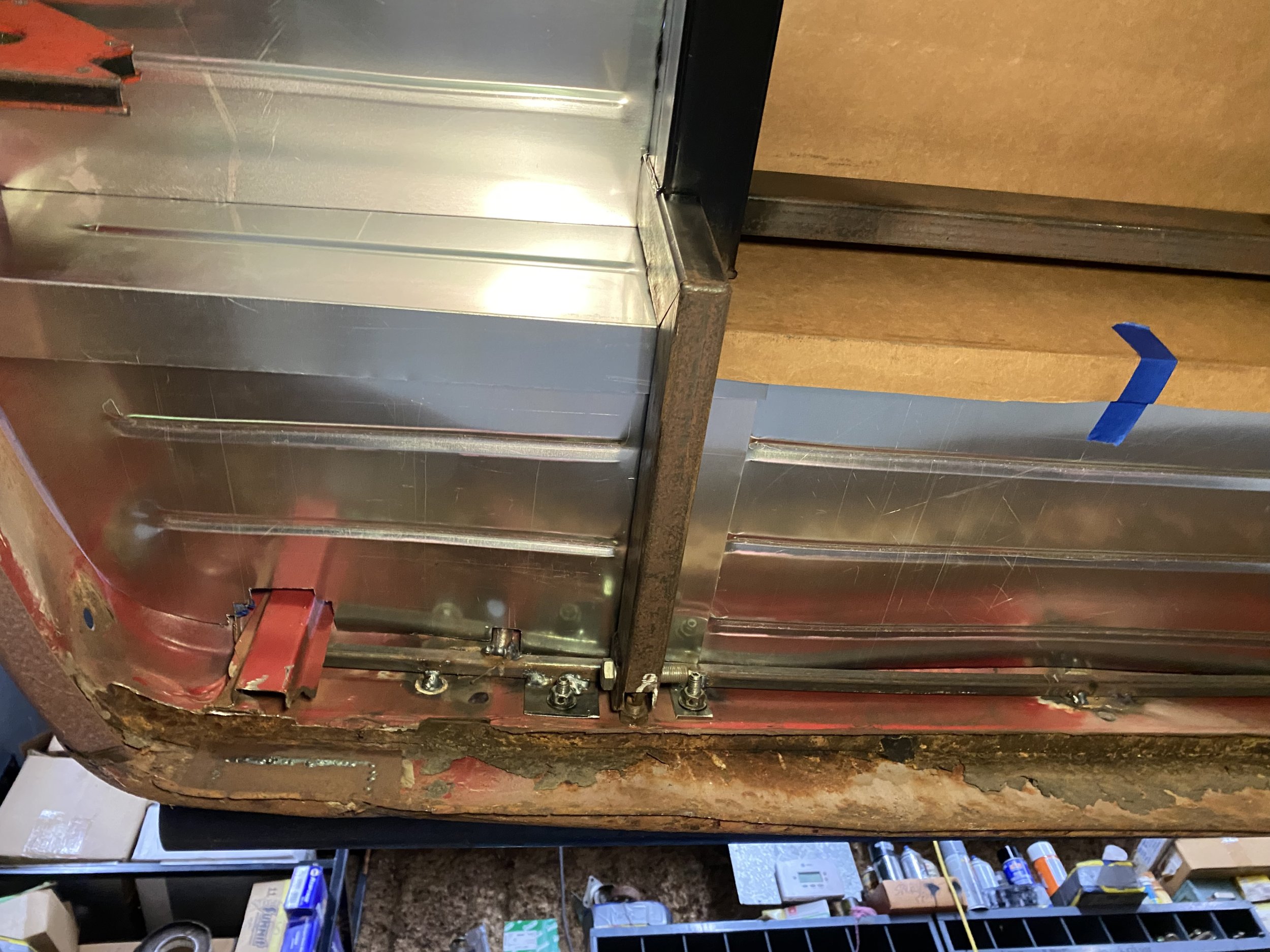

    IMG_4911.jpeg IMG_4909.jpeg IMG_4910.jpeg IMG_4912.jpeg IMG_4914.jpeg IMG_4915.jpeg IMG_4916.jpeg IMG_4917.jpeg IMG_4918.jpeg IMG_4919.jpeg Driver side wheel tub /out board support finished. I must admit it fits better than the first one on p***enger side. I used a small brake line to form a guide. And let the shrinker stretcher do the rest. Also got the vertical panel behind the seat done.
    Need to bead roll lines at 3/6/ and 9 to match the rest of the interior.
