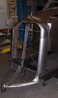

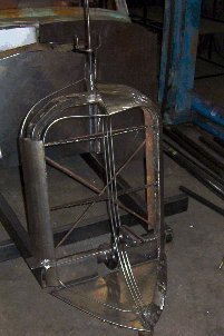

    Aighty....this is premature, but it's Tech Week, so I had to post something....
    The truck I am building is a '50 Chevy...lets call it a '47, so I can get into the gold-chainer haps....anyway, I am doing this thing hi-boy style, so of course it needs a different front end treatment.
    So, my bright idea was to create a grille shell that looks late 30's-ish, but that includes the styling elements I want...including the ability to mount the '48 Ford axle in front of the shell...
    Anyway....I started with a 50 Chevy radiator support, turned upside down, created a 1/4" round stock wire form, and have started to fill in the rest with 22ga.
    Eventually, there will be 27 grille bars, and my hood ornament will be chromed.
  2. Very nice work! Has a nice "flow" to it.....

    Aren't '47's the earlier body style? I thought the style of the '50 you have began in '48? If it is indeed a '50 chevy truck, a hiboy???? Interesting idea, hope your execution goes well. Got any more pics of the truck itself?

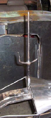

    Hood ornament
  7. Is that the spring perch sticking through the grill bars?
    Cooooooooool!! [​IMG]
    Clark

    Typo....my bad [​IMG]
    And I'll get some profile pics up in a week or so....gotta get the frame rails farther along, and semi-hang the front end

    Yep...that would be the spring perch! I call it "Kevorkian" style...

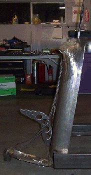

    Side view

    The rear of this truck will be suspended by leaf springs, but I am gonna fabricate the frame rails to provide the proper amount of sweep, as well as the provide for an upper link.
    The upper link is for axle control, and the associated crossmember adds rigidity to the chassis....
    This pic is an example of the frame rails I am building for the '50, although these are on a '98 Dodge Durango.

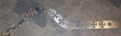

    The next pic shows the laser cut frame rails plates (sides) that I am using for the '50...

    This is a poor shot of the frame rail sides I am using on the '50....the idea is to have the outside face of the frame rails be flush with the outside face of the bed side, and the bedside will be profiled, on the bottom edge, to correspond to the sweep of the rails.
    And don't worry....the thing will have bias plys and drum brakes. [​IMG]

  16. What did you use, to cut those iron cross's out...? dremel?

    he had em laser cut. can't you read?? [​IMG]

    Hood ornament
    [/ QUOTE ]
    Ahhh, the Teenage Mutant Ninja Turtles truck [​IMG] grill looks great, can't wait to see it together.
