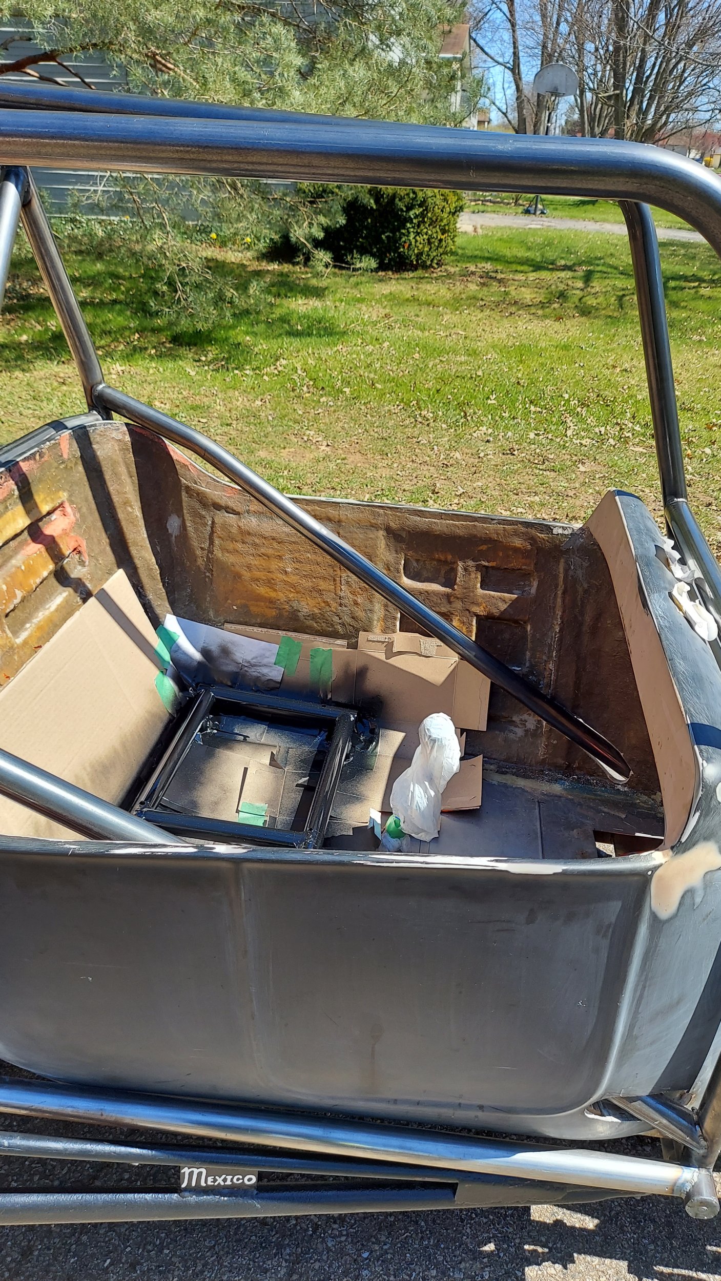

    This Pic will give you an Idea of how CRAMPED the Interior of the Racer was... After several hours of Racing it was a TORTURE CHAMBER! No room to stretch my legs or move whatsoever! When not going Full Speed, I would reach above to the Safety Cage and try to lift myself up to renew Blood circulation to the Seat of my Pants! See that the Shift Lever is bent at a Strange Angle? This alteration was necessary so I could change gears. The Shifter Ball was between my legs and very close to Mister Happy/Senior Feliz.
    The Interior was not complete at the time of this Photo... The Fire Suppression System and Windshield still needs installation.
    Look closely at the Dashboard please... Just like everything else in the Tiny Interior there was NO ROOM for necessary Gauges. Towards the right side two small Screens are in view. The First (Most Center) is the Digital Display for the F.A.S.T. System. This served as my Tachometer and my Engine Temperature Gauge. Far Right is a Garmin GPS - This filled the Role of Speedometer.
    The only "Real" Gauges it had were the Oil Pressure and Fuel Tank Level put into a Sheet Metal Dash Extension with the Ignition Switch and Buttons and Switches.

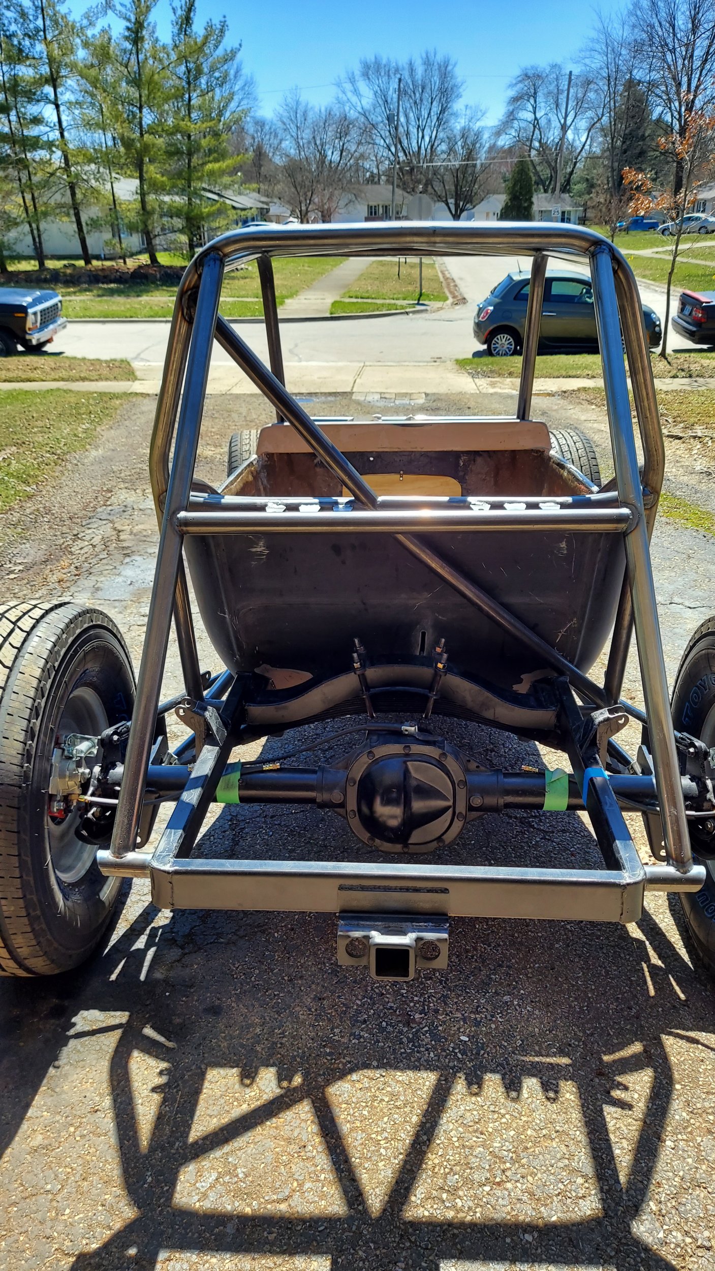

    The Diagonal Cage Supports at the rear help to enclose and protect the eventual Fuel Cell and Turtledeck.
    WHAT!?! A Trailer Hitch! That's DUMB! Why a Trailer Hitch??? you ask... Carrera Regulations require a Spare Tire and Jack & Tire Change Tools to be carried with the Racer. The Trailer Hitch provided a good Mounting Point for Two Spares Tires.

    That was certainly thinking outside of the box, er, the bucket! I wish I had seen this before starting on the whatever project. No one ever mentioned just how small a t-bucket is…

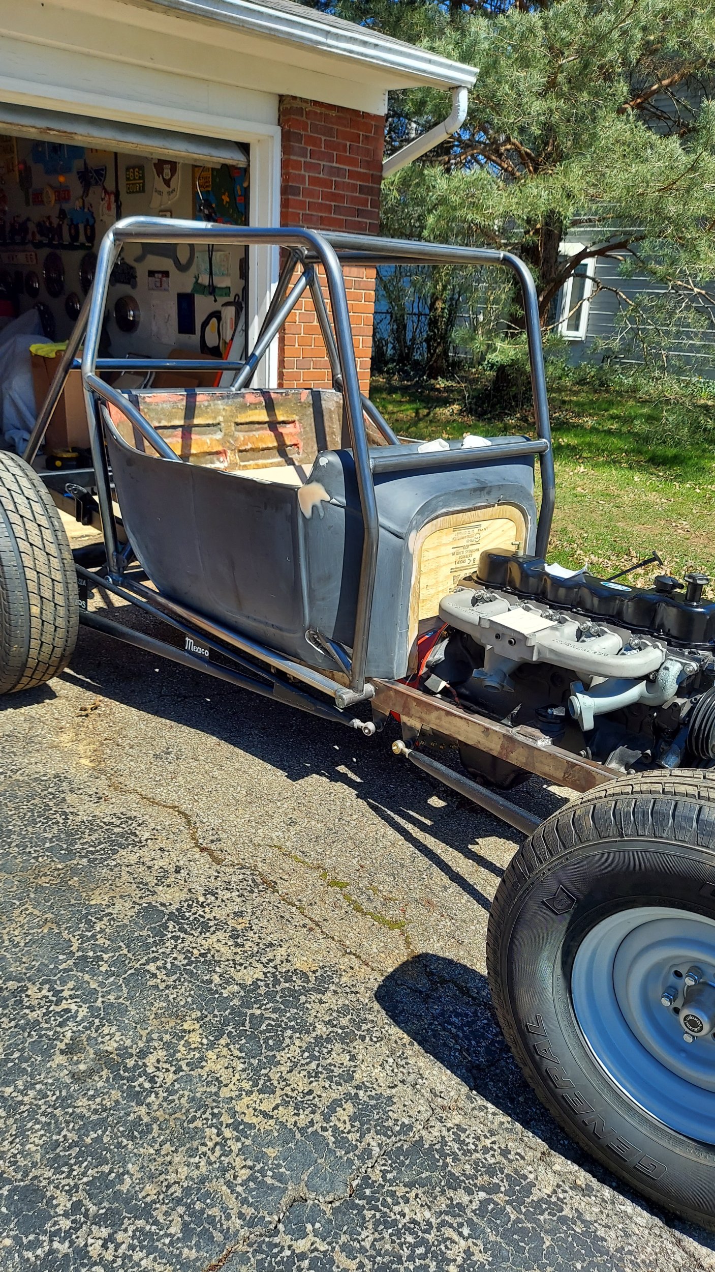

    Soooo... This is how things turned out... I really like the Cartoon Appearance of the Big Tires! It makes me recall the Hot Rods Ed "Big Daddy" Roth drew back in the 60's & 70's...
    I found 16" Steelies that matched the Ford Bolt Pattern I was using... Too my Shock, Carrera Regs did NOT require Speed Rated Tires! This allowed me to use Tall-Profile TRUCK TIRES.
    Once again, time was running out... I had to get to Southern Mexico in Vera Cruz for the Start of the Race... Driving the "T" Racer around my Home was the only bit of "Test Driving" I had... NO High Speed Testing whatsoever...
    It Handled SUPERBLY! No Shakes or Shimmies... Arced thru Curves with Precision... By all appearance from the Driving I had done, I thought the "T" Ready and potentially Competitive!
