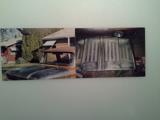

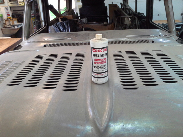

    I've been part of it too Bill and I'll say it again; My 66 Suburban was completely stripped to bare metal and prepped with Rust Mort, it has been inside of an unheated shop for many years in this condition, and this thing has a lot of sheet metal.
    Other than dust and a few spots where the "Looky Lews" have touched it, it remains as it was left.
    You dont want to be messing with a bunch of these every six months untill painted.

  10. Rust Mort works well as does all the acid based products. Just make sure to rinse well

    Rust Mort treated metal will rust if not primed. It is not a rust preventive product. It converts rust but does not prevent new rust from forming on the panel. I've used many gallons of it.

    I've used it and I know it works because I brushed that stuff onto some bare metal (the stuff I used looked like green water) and those metal pieces sat for months before I actually spray painted them and they did not develop any rust at all. Not even light surface rust.
