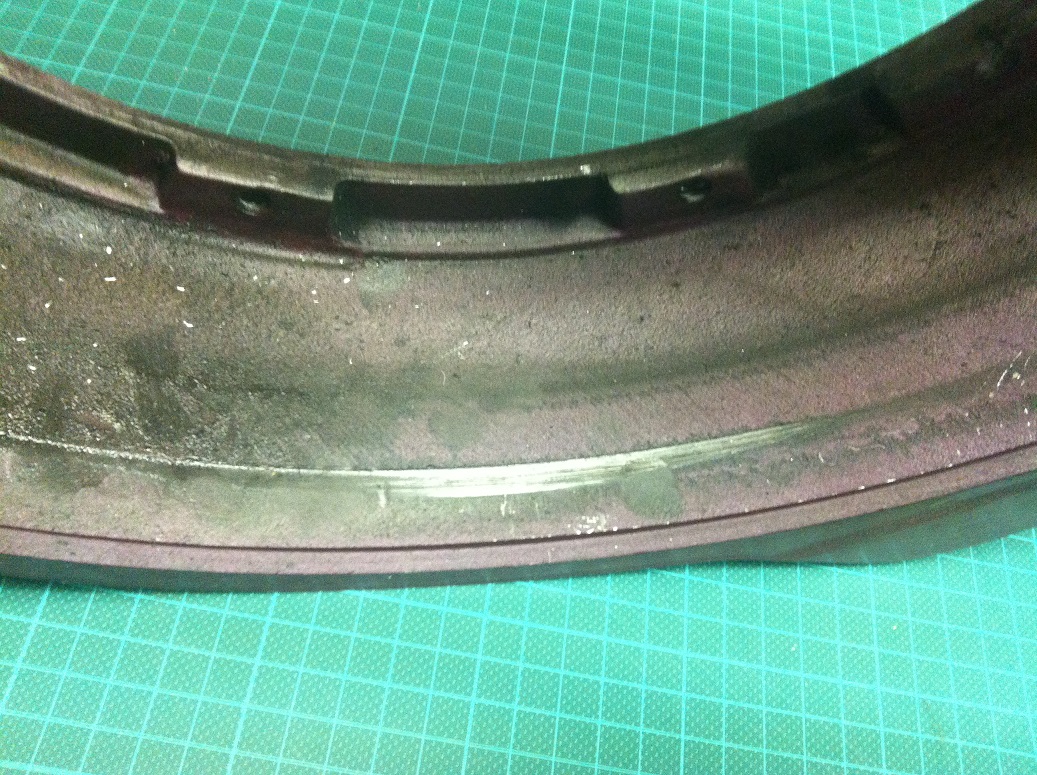

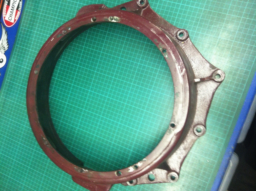

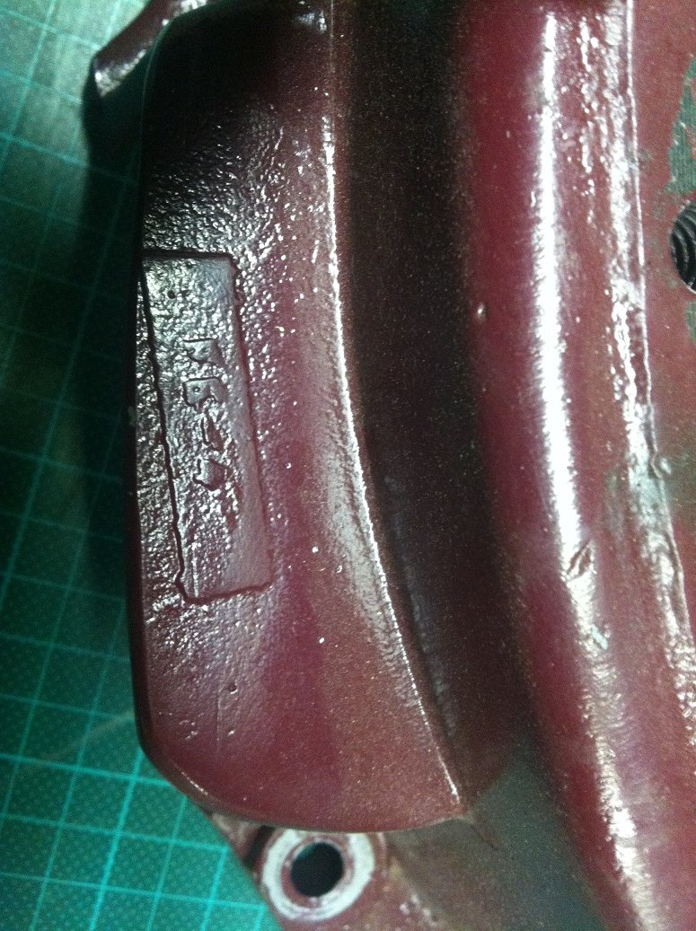

  16. Hi Guys,
    I managed to get 10 minutes spare so I could take some photos of what I have. I have an adapter, 168 tooth flywheel, clutch and pressure plate but I'm not certain they are the right type. The clutch is an 11" unit and from what I am reading it should actually be 10' or 10.5"? Also, I can not tell what adapter I have but it would seem as though the flywheel has been rubbing on it which makes me think it may not be the right application. Any help would be great as I am expecting to get a new 39 three speed gearbox which is being rebuilt by fellow Hamber HellsHotRods any day now and I want to make sure I have all the necessary bits before I put it all together. I had issues with my last gearbox which I was told was a 38 single synchro and I want to avoid any issues this time around.
    Adapter
    The only ID I could find was this which looks like P6-4 ??
    Where the flywheel has been rubbing

    My trans adapter SBC to '39 Ford 3-spd is an Offenhauser, but it more closely resembles a bell housing rather than an adapter ring. The one in my '40 Ford is about 1 1/2" thick. It apparently is used with the '49-'53 flathead to '39 down trans.
