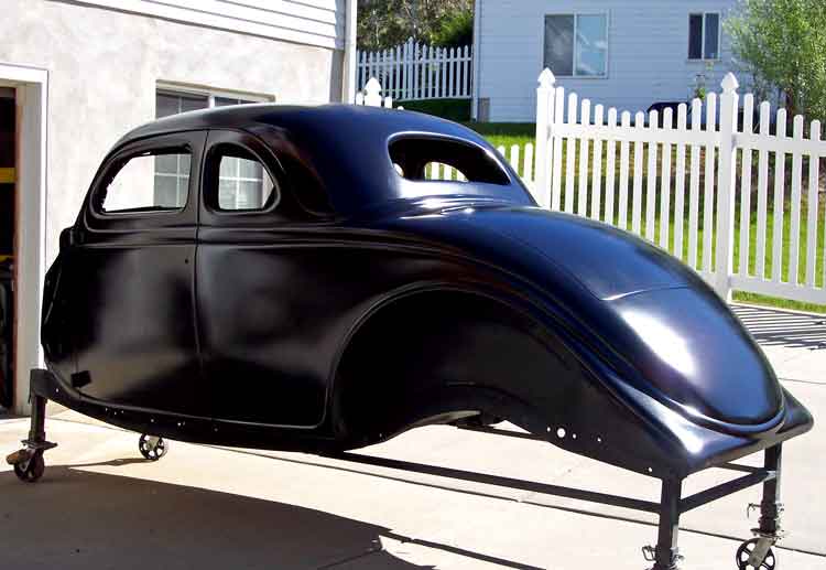

Well, I finished my Chop& Fill (2" Chop), and fitted my Wescott's Fiberglass Deck Lid (don't let them kid you, they DO NOT fit properly out of the Box but are made well)-just thought I'd show it to you-it has had the Door Bottoms replaced, the 1/4's, 2 front Valvances, new 5" Firewall, the rear Pan, the Doors cut horizontally to fit the curvature of the Body, a 3rd brake light, Bear claw latches used with original outside Handles, the Bumper mounts are smoothed, Cowl delete as well as a bunch of other small stuff Next is to paint the undeside and put it on the Frame-sorry, I can't get the pictures to go any bigger on Photobucket-

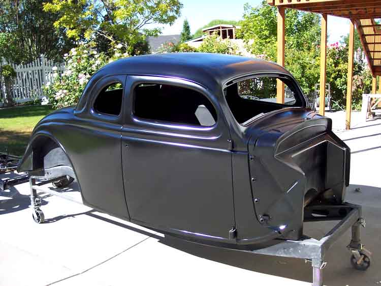

Thank you all very much for the replies-it makes you feel good when somebody likes what you have done-I know the pictures came out small, and a friend helped me to make them bigger-here they are (if you want to see)-
