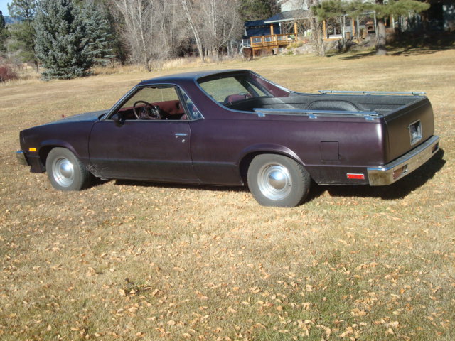

    I know this is not a HAMB friendly car, but it is an example of how I went the opposite route and had an '85 GM stock color flattened so it appeared to be primer.
