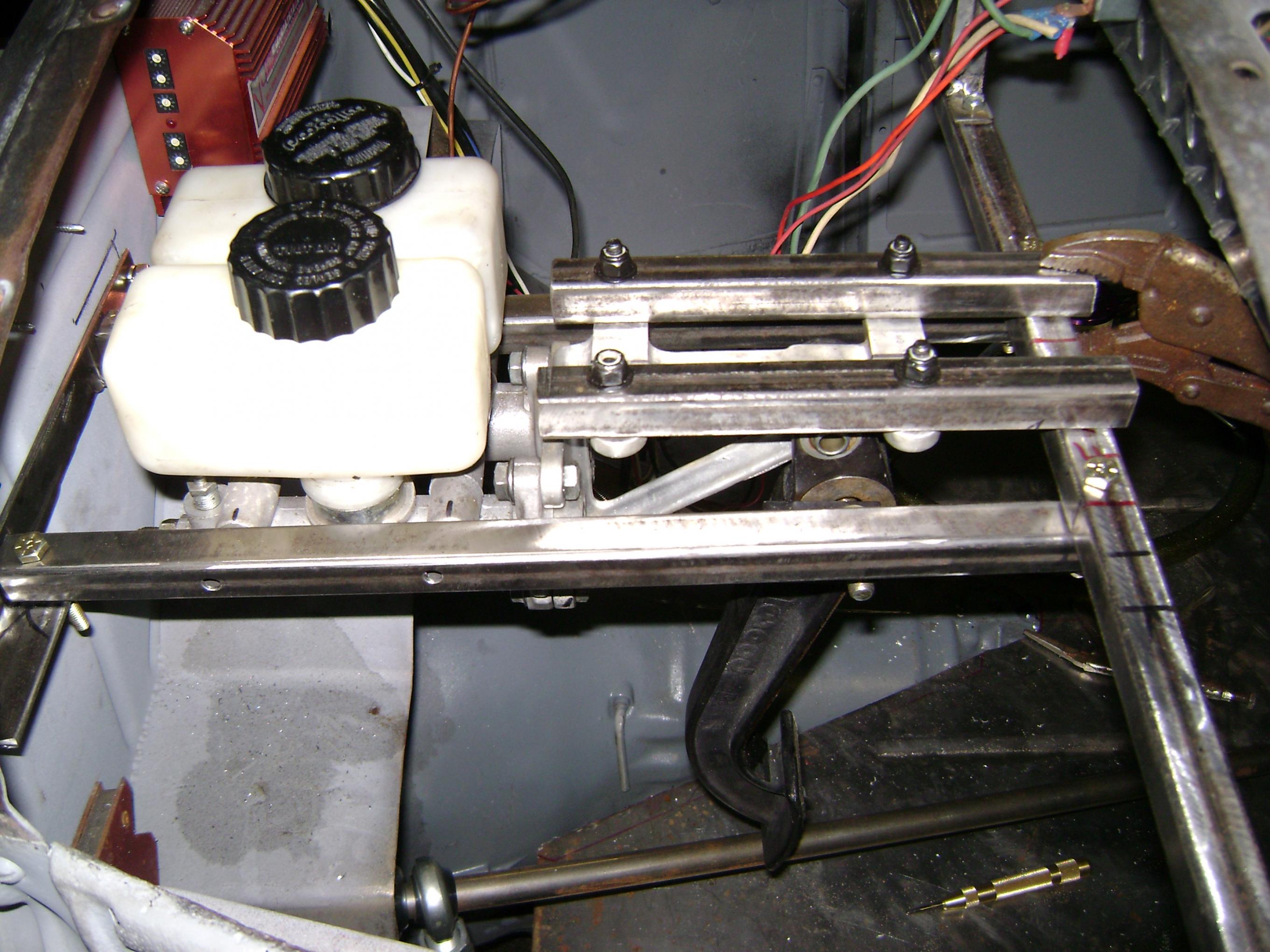

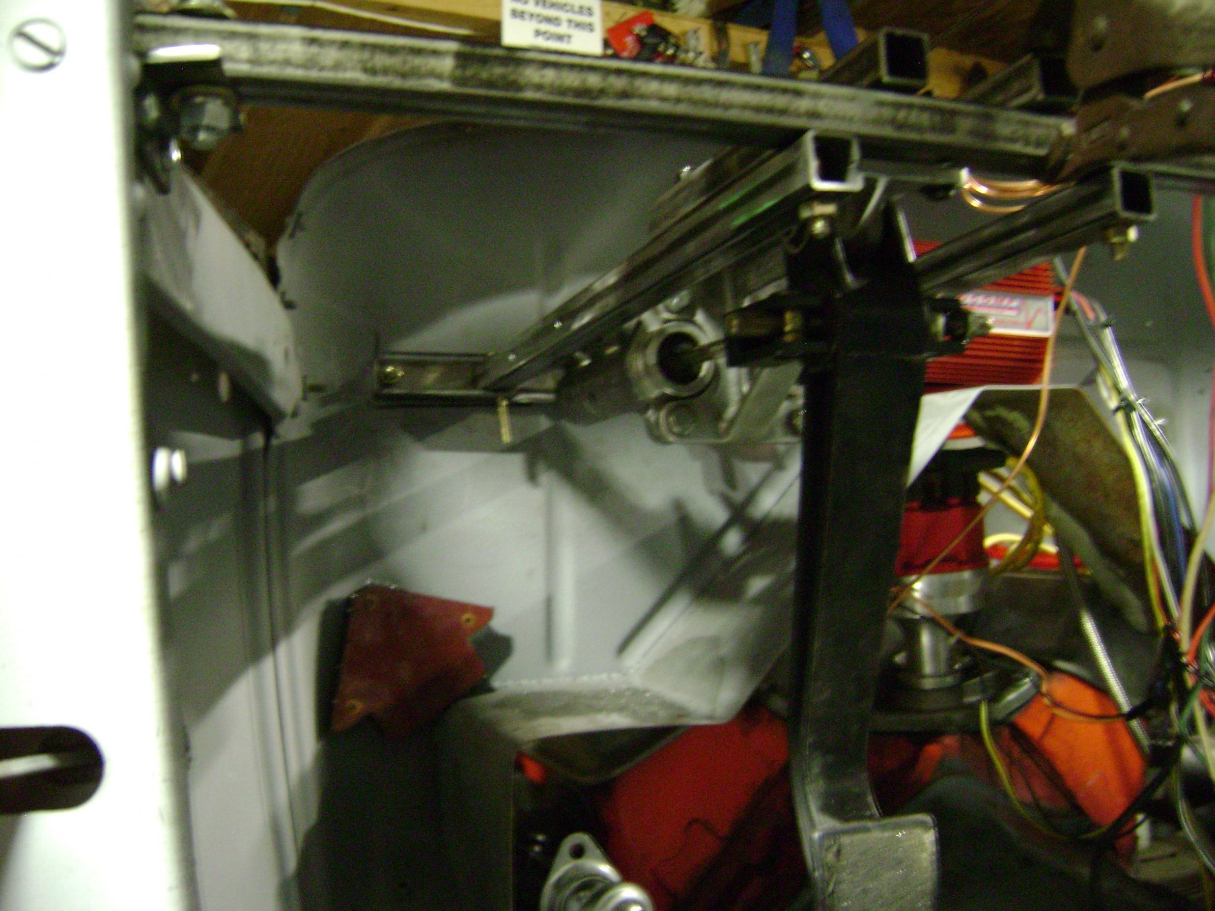

    OK, tinkering with the '37 again, I was intending to utilise the factory brake/clutch pedal and assembly hooked to a hydraulic clutch and brake system, however a question:
    In a factory '37 do the brake and clutch pedal fit each side of the steering column?:confused:
    If so - I'm screwed! the 460 bell-housing is in the way of the clutch -pedal.
    However if the pedals are further back I might be OK.
    Answers and opinons please!

  30. LOL I was about to say you had that backward until I looked at your location!
    In this LHD example, the column is between the pedals. Cant see why the RHD would have been different. If yours is the mirror image, it looks like there is some room to move the pedal away from the bellhousing.
