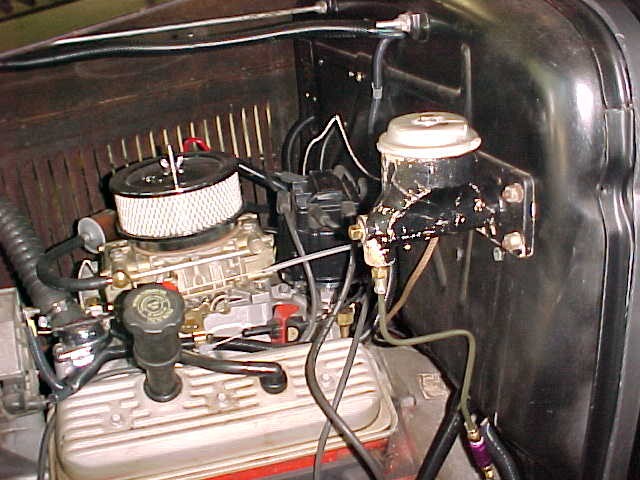

    They also make remote boosters that can be mounted anywhere. You could leave the master on the firewall and mount the booster under the floor or wherever you have room. Bad part is I think they are expensive. Some motorhomes came with them if your lookig for used.
      7.1 KB
      155
