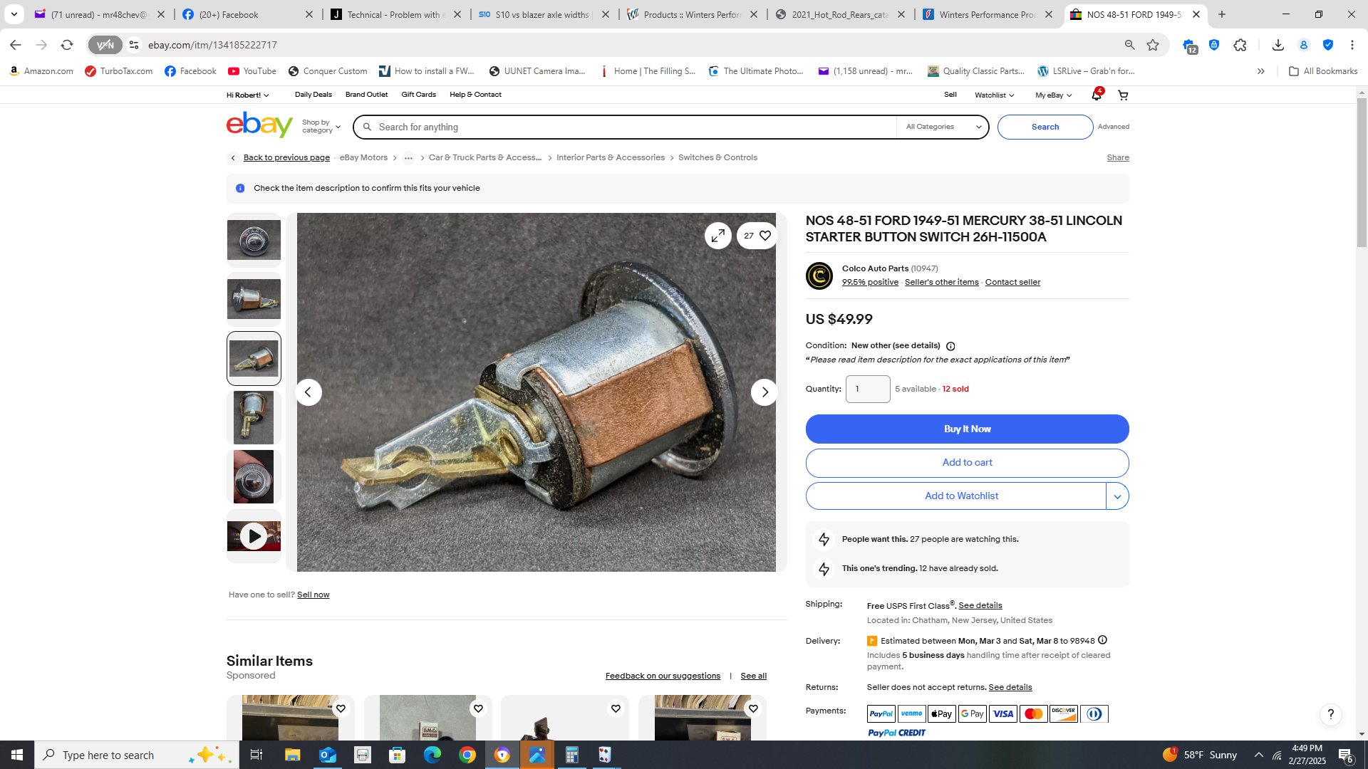

    Second, Stock Ford 6 volt solenoids that work with a push ****on go to ground they do not make a hot wire connection to activate the starter.
    This image being a 5o's Ford or Mercury push ****on starter ****on that clearly goes to ground. Screenshot (202).png
