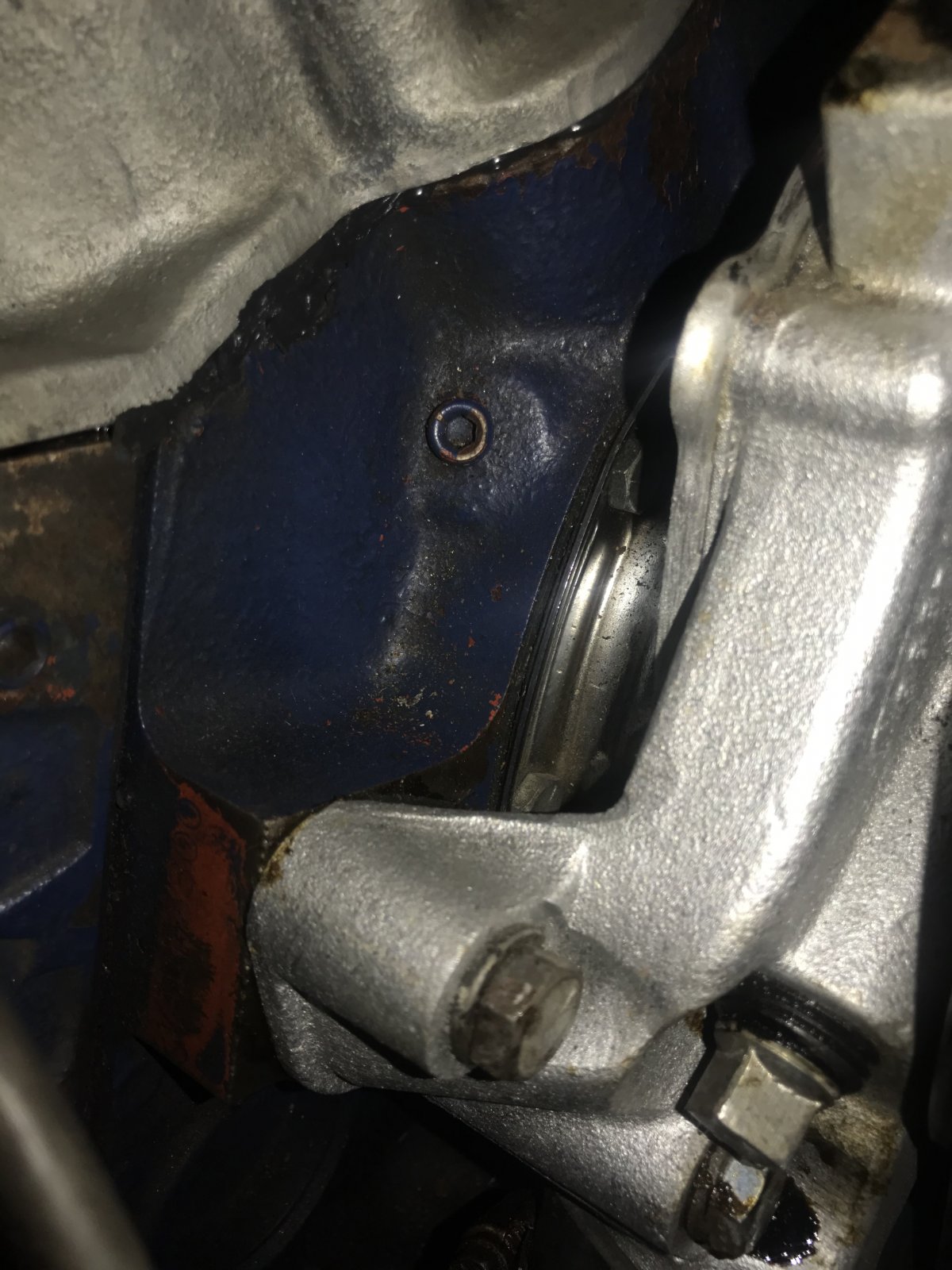

    Does the block have an oil port up top near the timing cover? If so check oil pressure there, it's the lifter oil galley.
    justpassinthru likes this.

    Checked. Only plug I have in the front by the timing cover is this one. Its located on p***enger side.
    Would that be the one you mention?
  12. scrappybunch
    Joined: Nov 16, 2011
    Posts: 441
    scrappybunch
    from nj
    Yes, That is the one.
    Budget36 and Pipewrench_Dale like this.

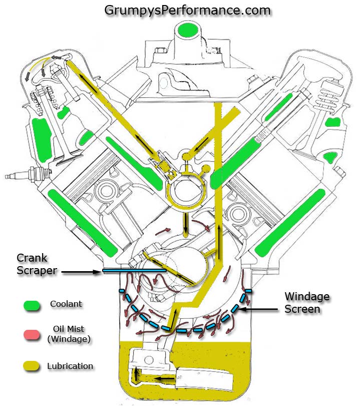

    Is this the correct oil flow path? Doesn't make sense one side would oil faster then the other unless the lifter bores are worn out. Where does the distributor get it's oil?
