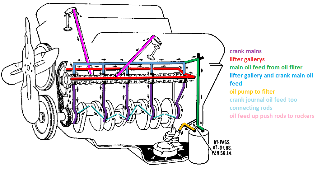

    The more I think about this there is only two possible avenues that sound reasonable.
    Something off with the new lifters and/or cam. Dont really know what. Perhaps the cam has just started to give up or there is a problem with the lifters.
    A blockage in the rear oil p***age. Somewhere between the oil pressure sender unit and the junction between left and right lifter galley.
    So what I need to do first is to get me an mechanical oil pressure gauge so I can verify the oil pressure. Also measure the pressure at the front galley plug. Let say for instance that there is acceptable pressure in the front on cold start. Then the lifters/cam will be suspecious.
    Now if there is a partial blockage that will be a real .... My best bet for blockage is the blue area on the picture. Does anyone know if the green area is a removable plug? If so perhaps its possible to remove the head and go down that way.
    Im also having an idea of trying to use vac***. Plug the filter outlet in the block and put a ****** and hose to the sender hole and use vac*** to try and **** what ever **** is stuck inside. Long shot, but I dont have the space to pull the engine.

    I know this is frustrating and you are trying to think thru every option. Sometimes when you finally isolate the problem its something amazingly simple or something you never would have thought of. SOMETIMES we concentrate all our thoughts on one thing, and the cause turns out to be something we never looked at.
    First, I would examine the oil p***age you have circled in the diagram. Remove the guage and fitting and the intersecting plug too. Shine a light and see if you see anything. Take a vacuum and use some duct tape to get it down to a small tube you can insert in the p***age. It would be nice if you could remove the oil galley plugs at the front of the engine and run the vacuum tube into that as well. Maybe run gun brushes thru it and vacuum again.
    The oil galleys make a turn at the back of the block, so that is very difficult to work. If you pull the front plugs and vacuum, I would also try air pressure with a long tube blow gun....then va***m again in case you loosened some debris.
    One question........do the lifters that stick all occur on one side of the engine, or is it on both sides?
    One other thing I'm thinking is that maybe a valve is sticking, or a couple of valves and creating the slaping noise.
    The thing is that you seem to have good oil pressure and smooth running when it warms up. Look for what is different when its cold.

    Took a break from the garage and gave it a good thought. Was back yesterday and was able the probe most of the oil channels in the back of the motor. Even made it in through the side channel towards the back cam bearing and reached the junction just above it. Nothing. No blockage or even old oil residues or other crud. This engine is very clean inside. Even put some vac*** on the channels using fittings and hoses connected to my vac*** cleaner. The bag in it was new and my idea was if there is something it might show up in some way in the bag. For example small pieces of silicone or tape. Nothing. Ran the vac*** for periods of time and nothing came out.
    So I would say that blockage is still possible but not probable.
    I also read about spinning the rear cam bearing. But as far as I know that would surely cause problems but the oil would most likely still p*** due to how the bearing and oil channels are constructed.
    So I have now moved the oil pressure sender to the front of the motor. Havent started it up yet as it was very late last night and I dont think my neighbors like a V8 without mufflers as much as i do. So tonight Ill check the pressure after the lifter galleries. But best bet right now are poor lifter quality and a camshaft thats near to give up. Depending on what results the oil pressure gives Ill know more tonight.

    The p***ages would indeed need a significant blockage to restrict flow to the lifters. And I doubt it would ever get better after running awhile as yours does. Taking a full minute to begin to oil at the rockers is extremely puzzling. I would think any restriction would not change as engine run time goes along.
