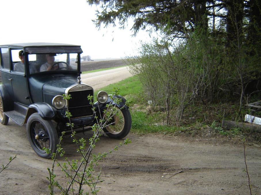

    I'm having trouble starting my stock 27 T tudor also. The teeth on the ring gear are shot, especially at the four spots where the engine stops. The bendix kicks out at each of the wornout spots. If I doesn't start right up, I hit the starter and it just whirles; I then get out of the car and give the hand crank a little kick to get it out of the worn spot. One time I had to jack up the rear wheel and put it in gear while using the starter; that really helped. A note of WARNING.... when using the hand crank..... put your thumb on the same side as your fingers (example.... grab a wrench, now flip your thumb over and put it on the other side). If it backfires it will pull the crank out of your grip and not break your thumb. Also only pull UP on it, this will save you from breaking your arm if it should backfire.
    Oh ya I had mine up to 42 mph with four people in it, used a GPS. :D
