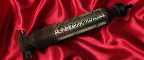

    You should get you some of these.
    -Abone.
