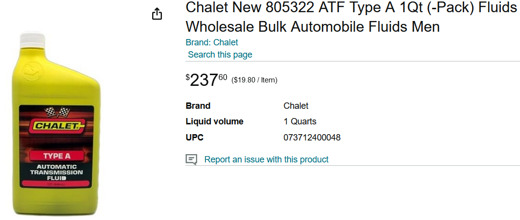

    I did use Type A in my wife's 56 Pontiac's hydro, the modern "backwards compatible" stuff made it shift like ****. I just did a drain and fill so I do not remember how it went years ago and forgot about that when I replied before. We bought this stuff. https://www.amazon.com/Wholesale-Chalet-ATF-Type-1qt/dp/B076DN7BST huge difference in drivability and trans shifting smoothness. I got a second case for my Olds hydro that I have yet to fill.

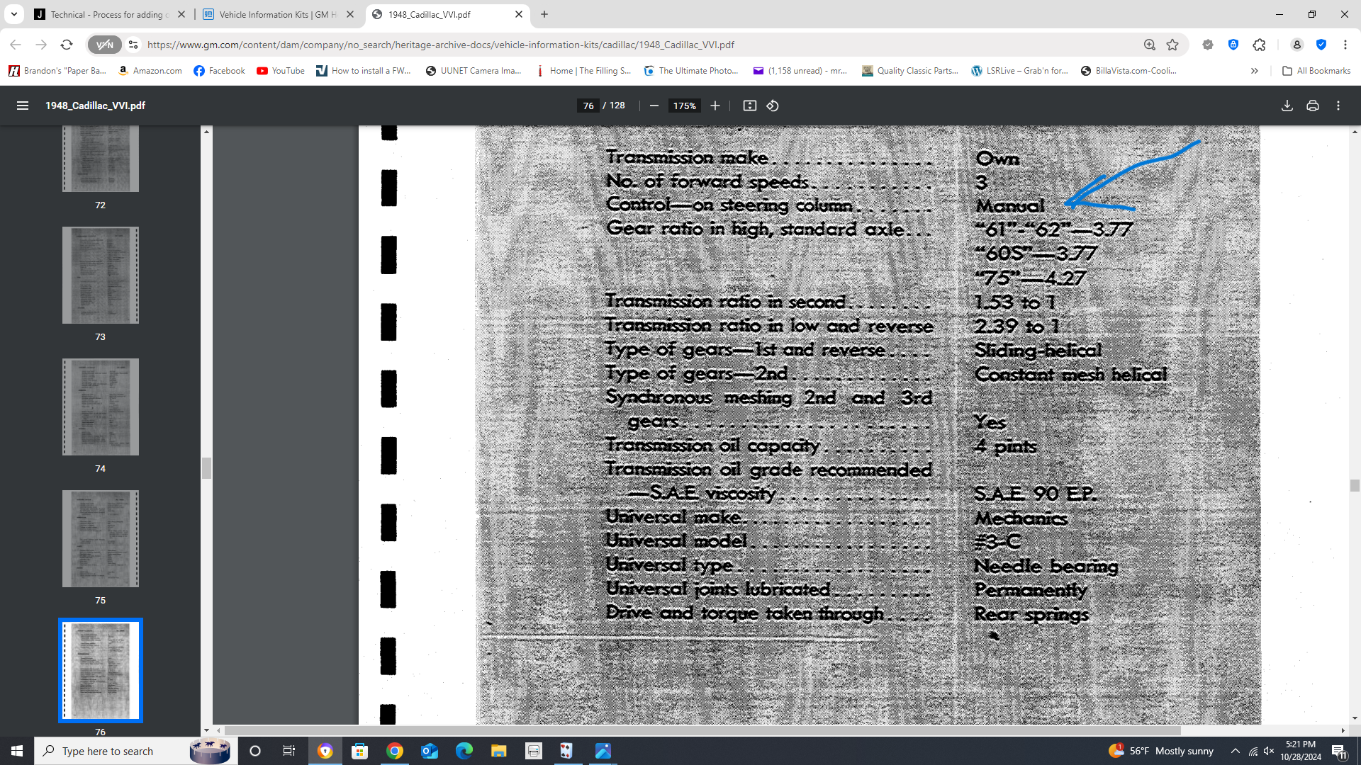

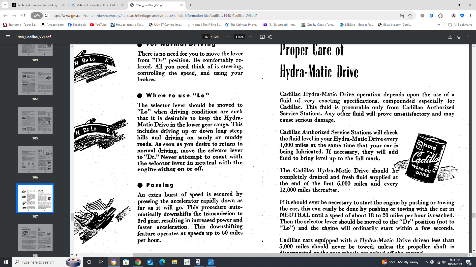

    SAE 90 is for a MANUAL TRANSMISSION AKA STICK SHIFT. Not for an automatic. Back in 1948 the only place you could buy the correct ATF was at the Cadillac dealer.
    Now you will have to drain and flush and possibly have the transmission rebuilt if the 90 wt got into the clutches. The two pages here from the GM heritage center vehicle information kit for 1948 Cadillac. https://www.gm.com/content/dam/comp...formation-kits/cadillac/1948_Cadillac_VVI.pdf Save that to the favorites on your computer. Screenshot (1455).png Screenshot (1456).png

    Who produces Chalet Type A ATF. Would sure like to see a TDS on the product.
    Internet search comes up empty, since as far as I know real type A has been discontinued for eons. Had whale oil.

    The stuff in the link is $20 a quart, must have real whale oil in it at that price.

    Yes, I should've made sure I had my gl***es on as I read the shop manual. I must've seen the SAE 90 under the column for the manual transmission. Let's hope I can fully drain what's in there and start over. Luckily I hadn't started the car so hopefully it didn't circulate much.

    I believe that it is simply straight mineral oil with red die and no friction modifiers but I could be totally wrong. @PhilA was doing testing using tractor oil (which I also believe is straight mineral oil and very cheap) on his hydromatic a while ago but I do not know his final results as he got a NORS valve body and that seemed to have fixed his issues. Whatever it is, it fixed all the shifting issues in my wife's wagon. I was so happy that I am the only review on Amazon, and I never leave reviews.

    Walliemart sells the Type A ATF online. Chalet has a FaceBook page, that leads you here: Download Safety Data Sheets (SDS) | Welcome to AOCUSA. I;m guessing Chalet is a brand for AOCUSA. That SDS service link is out of action, and asks you to call them for SDS's.
    Seems weird to have to work that hard to find an SDS for something that is so common.
