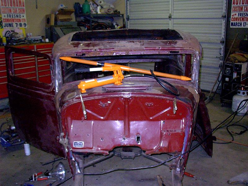

    When the car was rolled the p***enger door opened while rolling and bent the A post and twisted it in two directions. Best way to fix, Stip the skins, repair and install the skins back..

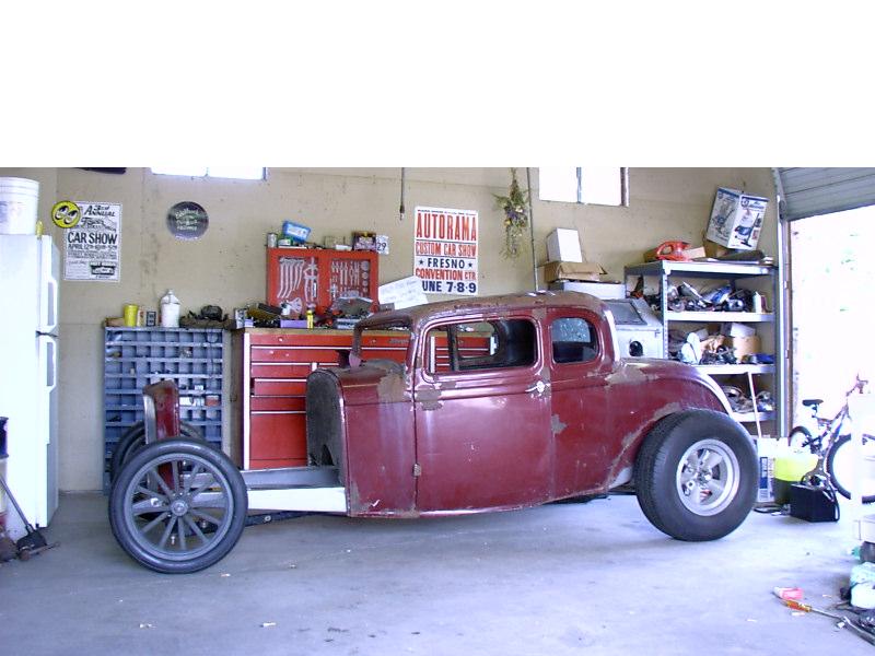

    Just a few notes the car is beimg rebuilt with brookville subrails, And a sectioned firewall that I found on ebay. The color is close but it is from a differant car. If you look at the early pics you see a wood firewall that was skin in stainless.. Also here is a pic in eary mock up to show the look Im going For
