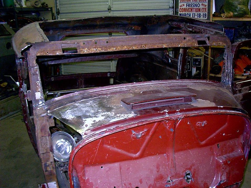

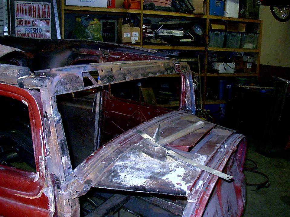

    He spent most of the day welding inner A posts that werent welded completly when it was chopped back in the day,And finishing up some stress cracks on drivers rear quarter. Then the haeder area above windshield was removed for inner structure repair. And to repair the skin. Also note that he has repaired The A piller skin..More on monday JOHN

    Inner header structure is straight and about 100% welded. He found the original chop was cut about a quarter inch out and they simply pust back a piece of A piller skin to correct it. Pretty amazing its lasted since the fiftys. And would have gone unnoticed had the car never been wrecked...Here some pics of the progress. If you study them you can see the change....JOHN
    kidcampbell71 likes this.

    Great save , fixing the RIGHT way , from the INSIDE OUT .That's going to look killer & last a lifetime. Gotta love them 5 window coupes .
