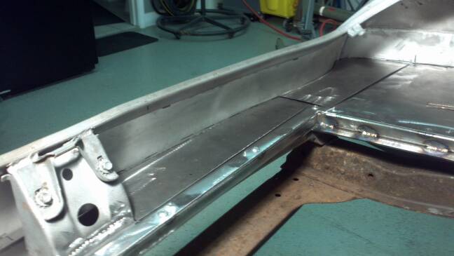

  11. 31-5window
    Joined: Aug 19, 2007
    Posts: 226
    31-5window
    from Michigan
    Got some time in on the car things are shaping up. It's hard to see but i raised trunk floor an inch wanted to get fuel tank up a little. I don't want fuel tank exposed to inside of trunk - car gonna keep fuel door. Tank is going to drop in from trunk then have a panel screw down. Made some filler panels at the tail pan to keep trunk floor smooth.
    Sent from my DROID device using the TJJ mobile ap

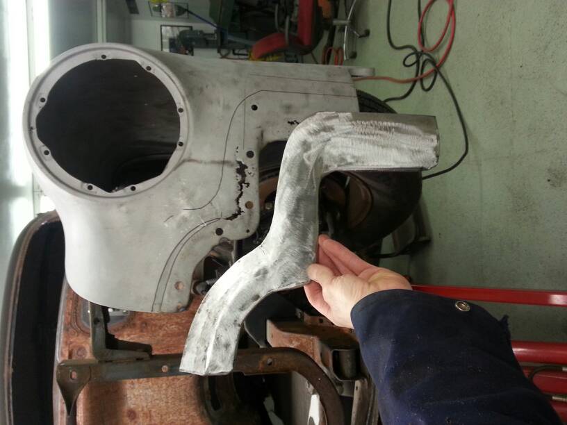

    started on the fenders repaired lower and a few other problems. now for the front area where the grill bolts haven't decided how I am do that.
    Sent from my DROID device using the TJJ mobile app
  14. Checkerwagon
    Joined: Jul 30, 2007
    Posts: 449
    Checkerwagon
    You're coming along nicely. Fine job. What is your concern about "now for the front area where the grill bolts haven't decided how I am do that." ? What are you thinking about ?

  15. 31-5window
    Posts: 226
    31-5window
    from Michigan
    This area is rusted bad and is has some curves that not sure how to make.

  18. Checkerwagon
    Posts: 449
    Checkerwagon
    "This area is rusted bad and is has some curves that not sure how to make."
    OK, I see what you are saying. Find a fender that has a good front section. Cut and splice.
    Best of luck
    Dale
    Cleveland OH

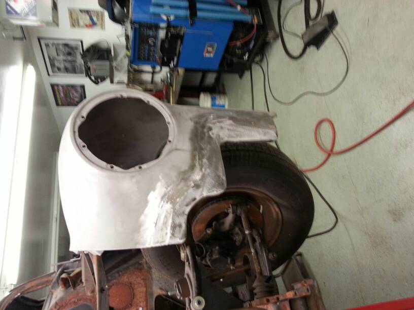

  19. 31-5window
    Posts: 226
    31-5window
    from Michigan
    Spent some time in the shop the past few nights got the fender repaired.

  21. impala631
    Joined: Oct 26, 2012
    Posts: 78
    impala631
    from INDIANA
  22. Nice work, weld done! How much did you chop it?
    -Shiny

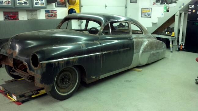

  24. 31-5window
    Posts: 226
    31-5window
    from Michigan
    Chopped it 4 inches thanks guys
