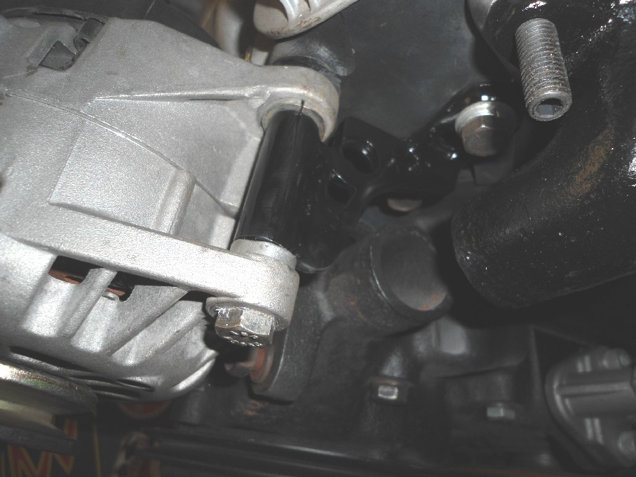

    Stayed home and worked in my home garage on the Pontiac engine/trans.
    In fact, I worked most of the afternoon and into the night on alternator brackets, using a mid 90s chevy pickup 105 amp alternator on the 57 POntiac engine. I made up the brackets from tubing taken from an old 40 Buick column shifter tube and a roundy-round racer gusset.
    The adjuster bracket is a 59 Pontiac 389 generator bracket and I welded a reinforcement into it to keep it from cracking from vibration.
    Yeah, yeah, I know...real hotrods run generators but I'm trying to make up a charging system that will transfer over to my dual quad setup when I install it...after I break-in the motor and get the bugs worked out. The little short alternator clears the front carb where a generator probably wouldn't.

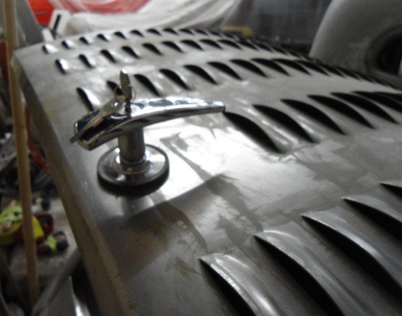

    Got a little more done Friday night. Boxed in the trunk latch striker mount. Needs detailed out. I used the original 34 decklid latch and a curved 37 ford trunk handle..Drilled holes for trunk water drains and cut down some 3/8ths brake line for drain pipes out the bottom of the body.

    Tuesday.....we installed the trunk striker and I installed the 37 decklid handle--filed a notch in it's mounting hole to engage the lock tab and mounted it all with a thick rubber gasket. It works fine. ..locks up just like a new car! The striker mount isn't welded to the back panel because I wanted the latch panel to be removable. It unbolts and comes out so I can paint and clean under it.
