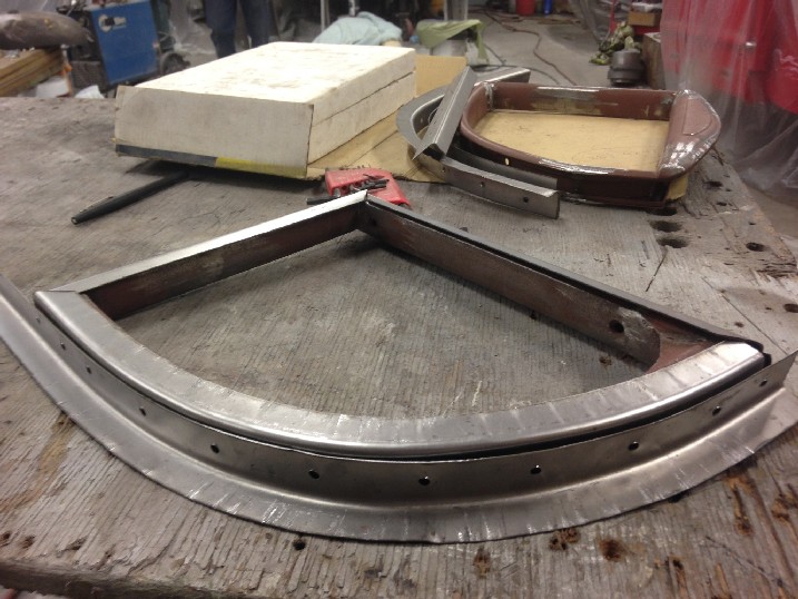

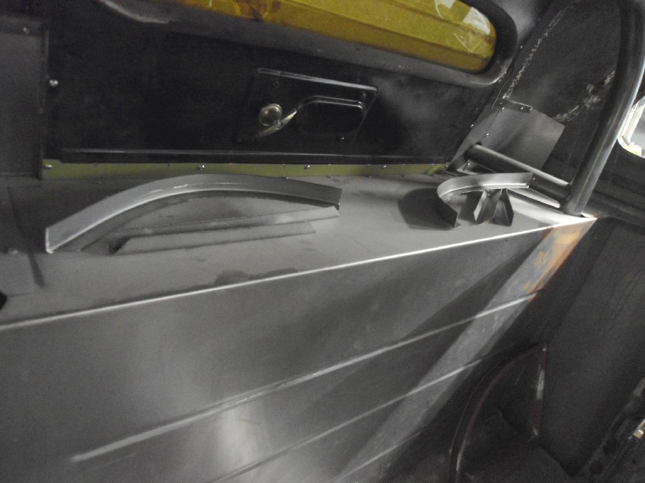

    Wheels still at the powder coaters. Tonight we made up new flanges for the quarter windows. The racers who "built" this body for racing simply torched out most of the old window mounting flange. Jimmy and I whipped up a pair of new flanges with the brake and shrinker/stretcher to accommodate glue-in glass from behind..Also gives me a base to screw my garnish moldings to. Before we can install them, we need to remove the last vestiges of the old, torched-out old flanges....hopefully this Friday night.
    An added flange will give a place for the headliner and it's bows to mount..

    Each side has 7 different pieces, counting the garnish molding...what a pain in the ass! Thanks a lot, stock-car racers, for torching my car apart.
    I still need to make a mock-up window from 1/4" plywood and include the butyl and gasket between the glass and garnish to set the offset between the two halves of the new flange. Then, well weld the halves together. 34windowflange1.jpg 34windowflange2.jpg 34windowflange3.jpg

    Al.....the added flange at top and bottom of "outside" flange is for the garnish screws to screw in to, the upholstery to attach to and the top flange will be drilled to accept the top bows for the headliner. Yeah, I know, it's hard to visualize but when it's all in place, it'll be apparent. Hell, I may even mount one of my chromed coat hooks to that flange too.
    The outside piece will be welded to the inside piece which will in turn be welded to the body at the inside of the window hole...see? Simple!

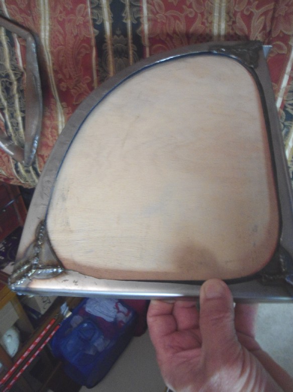

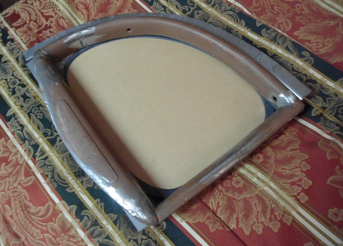

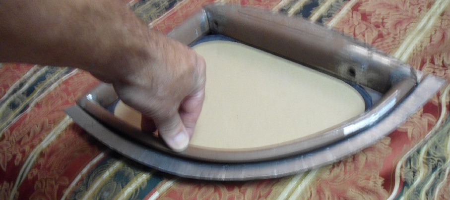

    Got one side done on the quarter window flanges. The bare metal part welds into the lip on the inside of the quarter window. The glass, represented by a piece of 1/4 inch plywood in the photos, lays in the bare metal flange after it's welded in to the body. The glass has a piece of black rubber mounted around the outside edge to protect it against the bare metal flange on one side and the surface of the garnish molding on the other. The garnish snuggles up against the glass's rubber gasket and holds the glass in the car...simple, no?
    I brought the flange home to grind the welds so it fits up flat against the inside of the window hole and the glass rubber will fit flat against the flange after grinding. We still haven't welded the corners into the garnish moldings yet...coming next Tuesday night when we'll also weld the new flange into the window hole...then we'll make the other side and weld it in.
    When that's done, we'll go on to the other 4 items on my list which are a lot less complicated and less time consuming. When we check off all the 5 34quarterwindows8_14.jpg 34quarterwindows1_8_14.jpg 34quarterwindows2_8_14.jpg items, it's time to bring my baby home to my garage where I'll build the chassis. I'll be able to go out to my own garage to work on my 34 any damned time I please. I won't have to drive 15 miles to Jimmy's body shop to work on it.

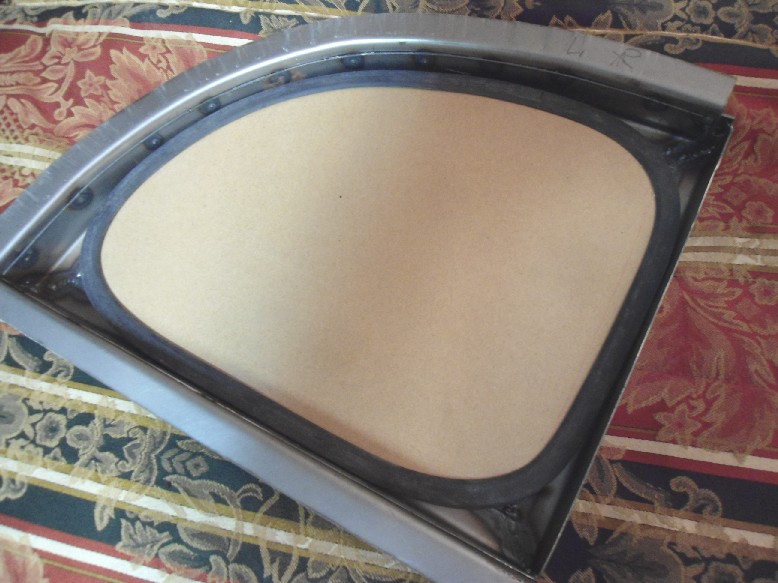

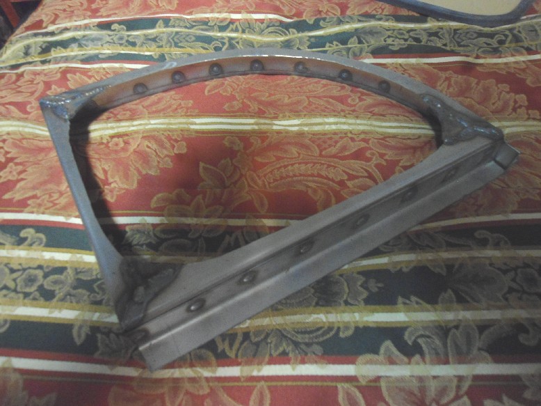

    The plywood "window" has a rubber gasket all the way around the outer edge of it...doesn't show very well in the photos
    34quarterwindows4_8_14.jpg 34quarterwindows3_8_14.jpg 34quarterwindows4_8_14.jpg 34quarterwindows5_8_14.jpg
    The last photo [fuzzy] shows the gap between the garnish and the flange for the door panels and the headliner to fit. They'll be pinched under the garnish moldings.

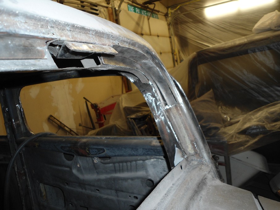

    It's been a long time since I've posted but I've been busy workin' on the car. Got the MoPar wire wheels back from the powder coaters a few days ago. Jimmy and I got the quarter window housings welded in place,got my quarter glass cut and checked that off my list BUT! While standing around shooting the shit, I happened to peek up under the windshield frame to see a giant void under it at the top of the car.... We forgot to finish out that area before installing the windshield frame! Got one side done and still need to finish out the other side.
    Scored a master cylinder adapter to bolt a modern M/C to my old 39 ford pedal assembly. 34quarterwindowfinished.jpg 34wheelsdone.jpg 34windshieldpost2.jpg
