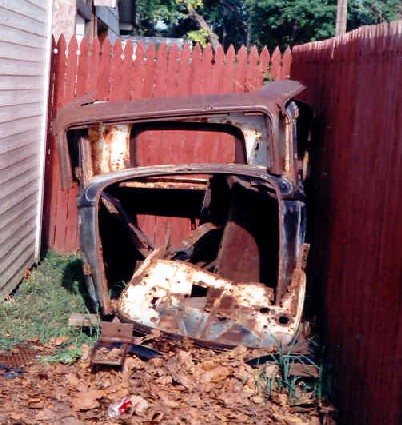

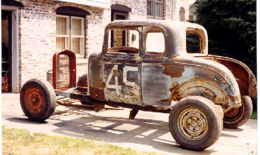

  4. all it takes is time, work and money, not necessarily in that order....but 32 quarter panels are even more $$ than 34 quarters I'm told.
    My 32 needed quarters really bad but it was before they were available repop...I eventually sold the body because of it.

    I saw that '32 up close and personal - it was a real cob! Rocky cleaned it up pretty good though...
  6. yeah, it started as a pile of sheetmetal lying next to a fence.

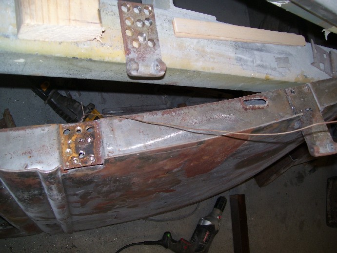

  9. Last night we did some finish welding inside the rear quarters. finished welding the rear panels below the trunk to the trunk floor and tied it all together. Plug welded the firewall in place and cut-out and installed new lower right side cowl patch panel...popped the windsheild and windshield frame in place too.photos later

  12. a photo
