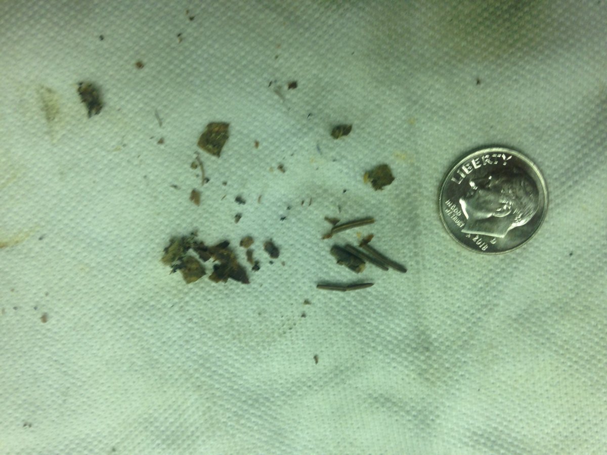

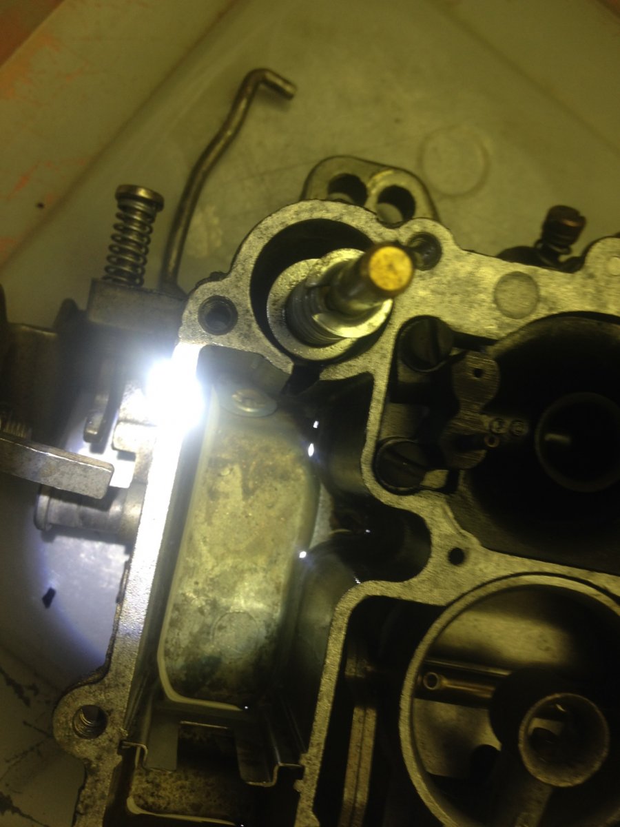

    When I parked the car after the last ride in it the engine was running really rich. I popped the carb off and took the top off.....removed the needles and seats to find some weird **** in the carb. The little mini-logs had somehow gotten around the carb inlet filter and lodged between one of the needle and seats. The other **** was in the inlet screen. I cleaned everything up and re***embled. Didn't try it but I'm sure I got all the **** out. 34afb2.jpg 34afb1.jpg There...all nice and clean again....I'd forgotten how much I enjoy working on this car!

    Rocky,
    I can't tell what those bits are. Are they rubber?
    I ask because a friend had a similar problem. Not that it matters, but this was in a 460 in a '56 F-100. It kept flooding. Turns out that the insides of the rubber fuel line was disintegrating and causing tiny rubber chunks to get lodged in the needle seats. This was many years ago when ethanol was first being added to gasoline. He changed out all the rubber hoses to the kind that ethanol doesn't affect and all became well.

    Mike...this junk was not rubber. It was like cardboard and bondo dust. I'm not too worried as this is after about 3000 miles on a new build. All parts in the fuel system were new and the crud in the photos is probably an ac***ulation of dust and dirt of parts sitting in the body shop for several years before getting used.
    All rubber pars are new and the only time any ethanol was used was the first 700-800 miles to Joplin, Mo and back home for the HAMB drags.

    Those "mini-logs" look like the pine needles I found once; but mine were in the filter.

    Pine needles is more like they find in the great white north. Around here we're more likely to find corn kernels.

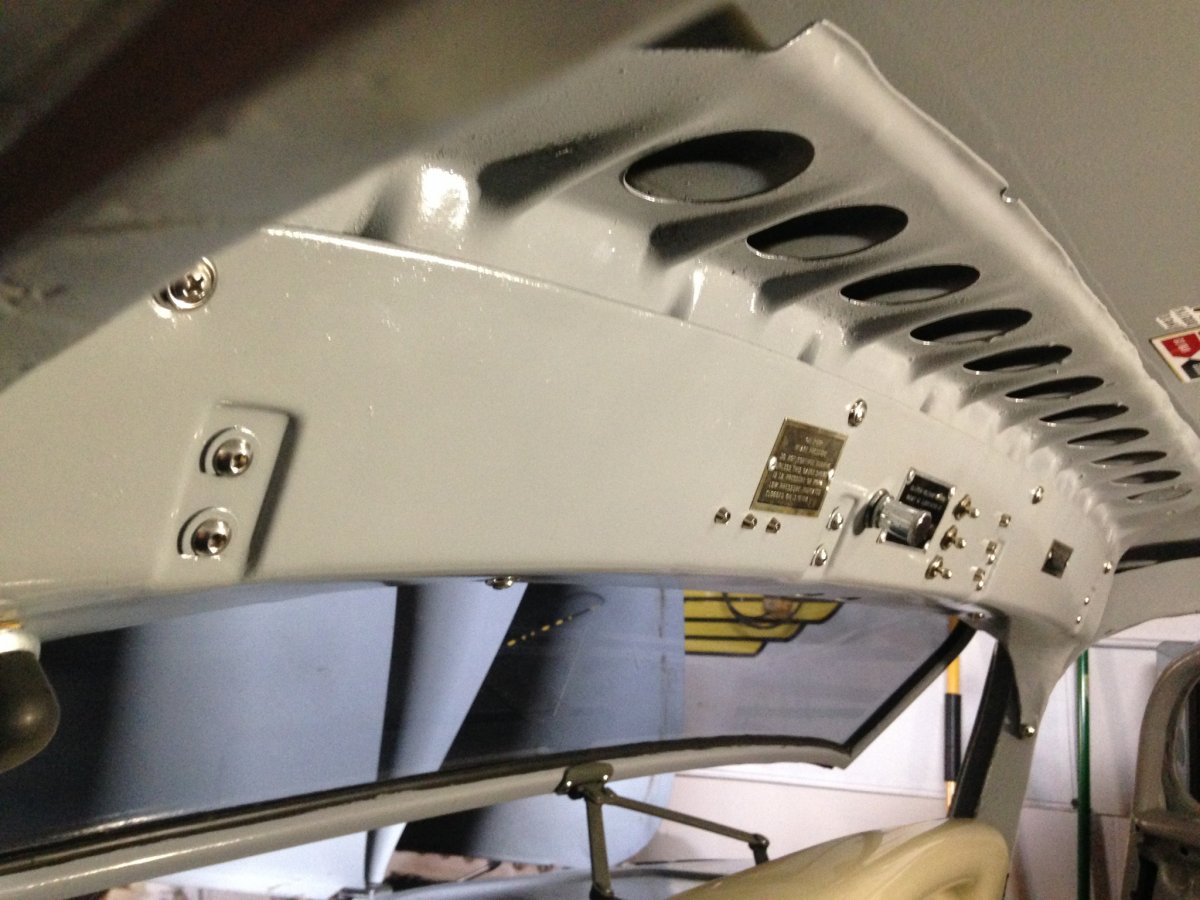

    Header panel paint dried and I re***embled it with it's switches, indicator lights and a few ancillary warning tags from back in my truck mechanic days. This is a 33 panel in a 34 cowl so it has some extra holes that weren't needed. I could have welded them up but this piece was only 20 gauge and it had 84 years of rust pits on the back side making the metal even thinner...was easier to cover the holes. I felt these were cooler than old rod run dash plaques anyway. 34headerdone.jpg 34headerplaquehamb.jpg 34headerplaqueoilpump.jpg 34headerplaquet.o.bearing.jpg

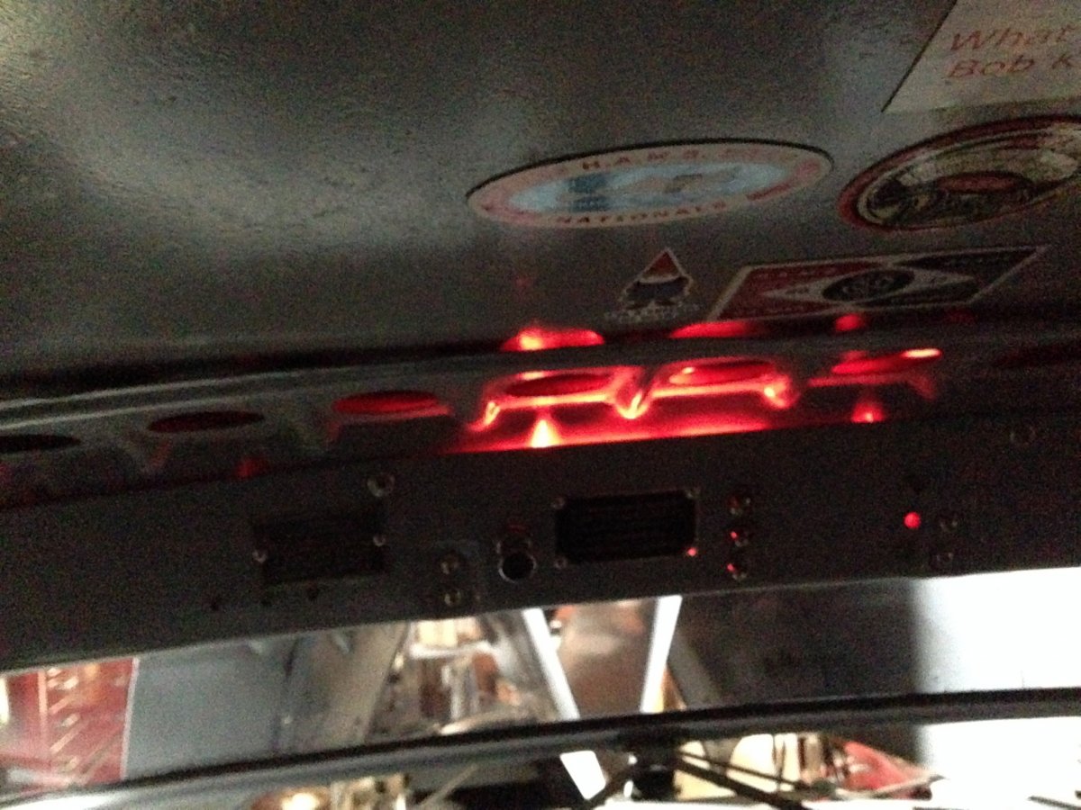

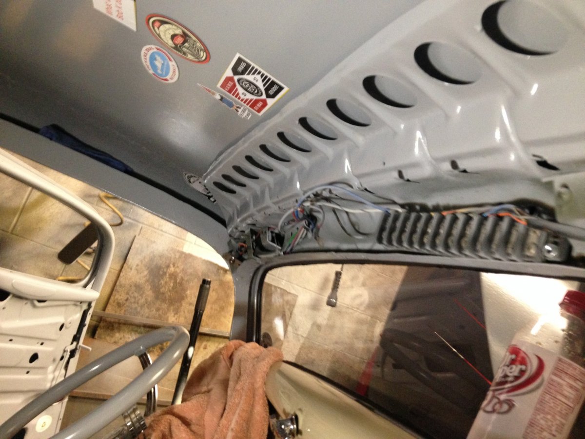

    Ok, I finally got the re-wire done on my new header panel and finally got it installed. I like it a lot better than the hokey *** hunk of wood that was there before. And I also got my interior light rewired correctly and working. It's supposedly from a 48 Plymouth. 34headerp2.jpg 34headerp3.jpg
    Stogy, brEad, loudbang and 4 others like this.
  28. Rocky
    Posts: 17,625
    Rocky
    Classified Editor
    As always I incorporated an indicator light that goes on when the brake lights are actuated..lets me know my brake lights are working. It's a super bright led and shines all over the place! 34headerplighted.jpg
