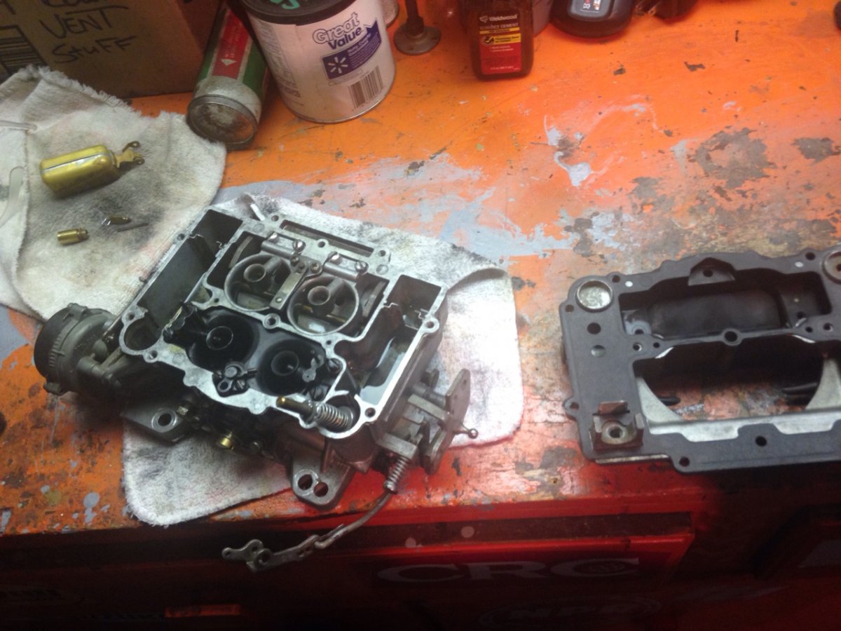

    34carb.jpg 34carbinletfilter.jpg Didn't find much **** in the carb so I put it all back together with a new mounting gasket that clears the secondary ****erflies. Still seemed "fat" but I busted it through the gears and it pulled like a freight train then began running rough....popping back through the carb at full throttle/low RPM.... Drove it home and parked it. Gotta work at 0'dark thirty in the AM. Maybe I'll have a little time to work on it after work..
    I forgot and left the key on this afternoon for about 1/2 hour...dual point Mallory with a Pertronix conversion. Maybe I hurt the coil/resister/module. I dunno but I have another distributor I can try. All new parts in it. Damn!
