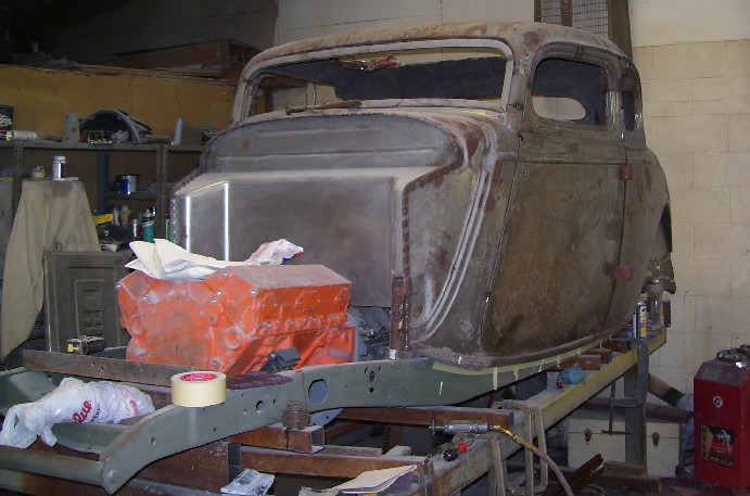

    I'm setting it up with chevy mounts..made an offer yesterday on an old 57 Pontiac 347, short block..bored .125 over with Jahns pop-ups...was machined and ***embled in the 70s and never started..we'll see.

    It's been a few weeks since I've updated the build. Jimmy's been working around the driver's back corner of the car and the left 1/4 window..plus we chopped the windshield frame and began m***aging the header panel to get it right before attaching it to the a-pillars. It's finally beginning to look racy.

    Oh, don't worry about a little snow on the '41....take a look. I usta drive it in the snow when I could get it to start. Anything below 5 degrees and even with the 12 volt conversion it doesn't wanna start..

    Got a little more done on the chop last night....got the driver's door top tacked-on and did some work on the other side. Man, he cuts it apart and pieces it back together like a jig saw puzzle...
    Got a new/used header panel coming for above the windshield. The car was a race car and all the front support pieces were torched out. We'll fix that as soon as the piece gets here UPS

    ..........oh, and I almost forgot. I picked up that old Pontiac 347. It's punched out .125" to 370 cu in. Also scored a stick setup for it so I can run my T-5 behind it.
