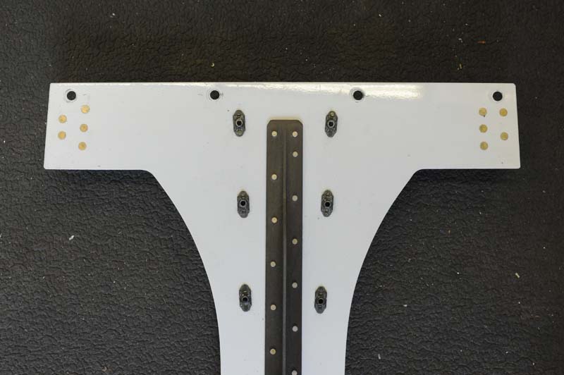

    Target 550 Update 190: Here are some shots of the liner's instrument panel and some of the unusual materials used in finishing it, mainly ivory. This isn't yer normal elephant ivory (which us illegal to possess, buy or sell) but that which comes from a prehistoric mammoth.
    And just to top it off, there are a couple of areas that are inlaid with mother-of-pearl. Pretty fancy stuff!
    http://www.target550.com/gallery/190_instrument_panel_bling/index.html

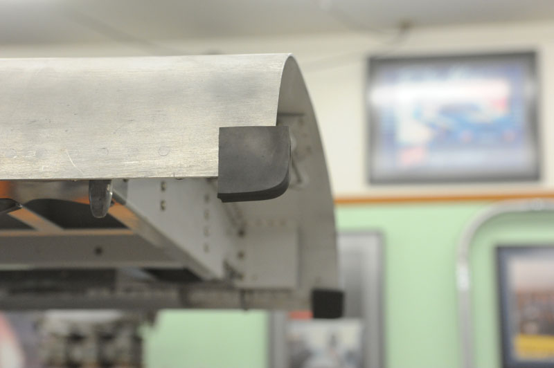

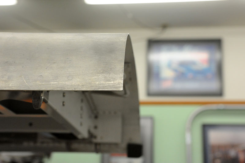

    Target 550 Update 195: Rear wheel fairings from the start to "almost" the end.
    This is a big post. It shows how the rear wheel fairings were made in aluminum (formed over a wooden buck) and shaped to be used as molds for the carbon fiber fairings that are being made by Frank Martinez. The amount of work that went into these fairings is unbelievable.
    Freud has put a lotta photos together that tells the story from the beginning up to the point where they were sent off to Frank. Enjoy the craftsmanship that went into this part of the project.
    http://www.target550.com/gallery/195_rear_wheel_fairings/index.html

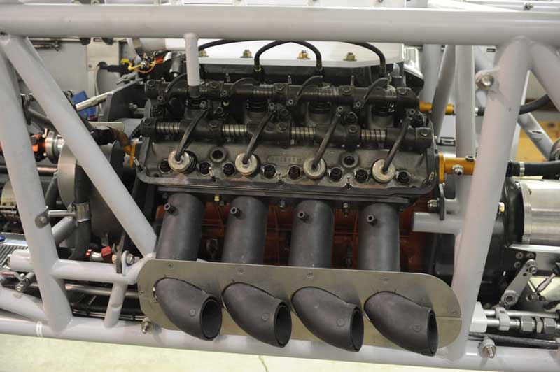

    Target 550 Update 198: I should have posted this earlier today, but life got in the way. One of the things that had to be done as part of getting the T-550 streamliner ready to run was fabricating mounting plates for the blowers. Huge blowers. Les Davenport is shown making all of this work.
    Since the blowers are rotated 90 degrees from the "normal" orientation, some method of draining any fuel left in 'em had to be created. A part of this post shows the fittings for the drains.
    I keep saying this, but it's getting ever so close...I'm chewing on my fingernails, waiting to hear that they're ready to fire the motors and make a test run on a paved surface somewhere. As soon as I hear that, I'm on my way!
    Here's a shot of the gears on the ends of the rotary vanes. Did I mention that these blowers are huge?
    Here's the link to the first of 3 update pages:
    http://www.target550.com/gallery/198_fabrication_blower_mounting/index.html

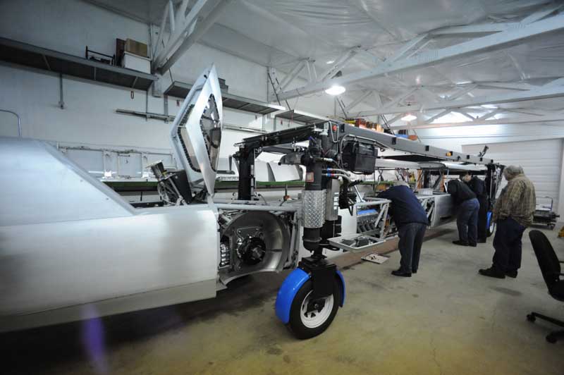

    Target 550 Post 205: Final fit and finish of the last tail section.
    That darned tail skin piece is finally getting re-riveted with measures taken to prevent dimpling in the skin's surface. I'm sure that Hume will be overjoyed to put that one on the "finished" list.
    http://www.target550.com/gallery/205_final_fit_finish_last_tail_section/index.html
    The shop looks deserted without the whole liner in it:
    Testing will begin this spring. Stay tuned.
