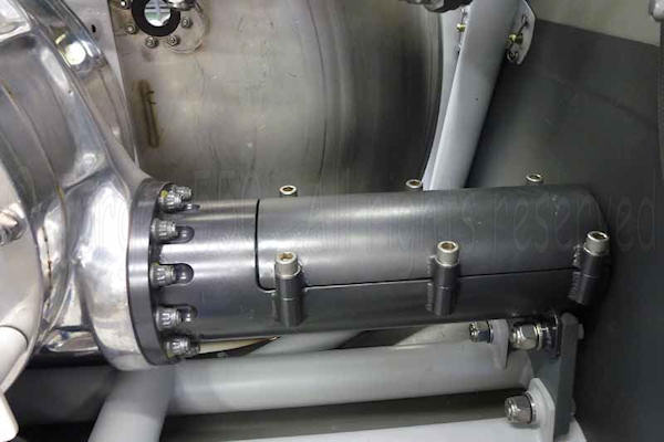

    Update 169: This is the description that Freud gave for the post:
    "The complex fitting of the panels in the air brake area is underway. It's sorta like extracting the bottom stick in
    a game of Pickup Stix. The torque tubes are in place in both the front and rear drives. Hume also had a visitor from the past."
    The lady is almost fully clothed. She's gorgeous. Just a little more and all the body panels will be finished.
    Here are a coupla images, not from the post, but some samples Freud sent me:

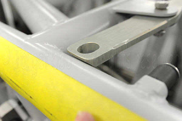

    You can see that the tape is doing its job of protecting the ch***is tubes, even though that paint is supposed to be real tough.
    I think the torque tubes are pretty much done. The removable section is there to allow the Greek coupler inside to be lubricated.

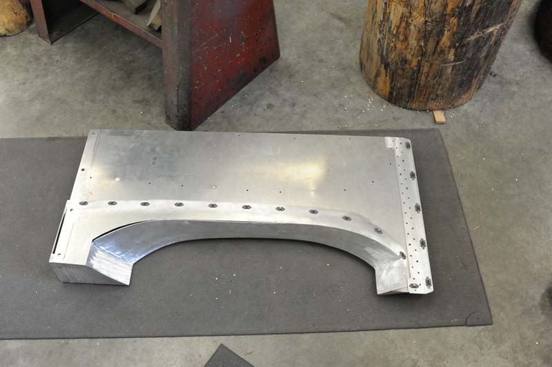

    Update 170: Skin, Cherry rivets, dual purpose drain/vent and painted panels.
    Jim Hume: "Man! One hell of a lotta work has gone into this race car!" Well, that's what he looks like he's thinking. Maybe he's wondering where my 7/8" deep impact socket went. If that's the case, he can stop wondering. I found it as soon as I got back home with the new one. :)
    Here's the link:
    http://www.target550.com/gallery/170_skin_rivets_drain-vent/index.html

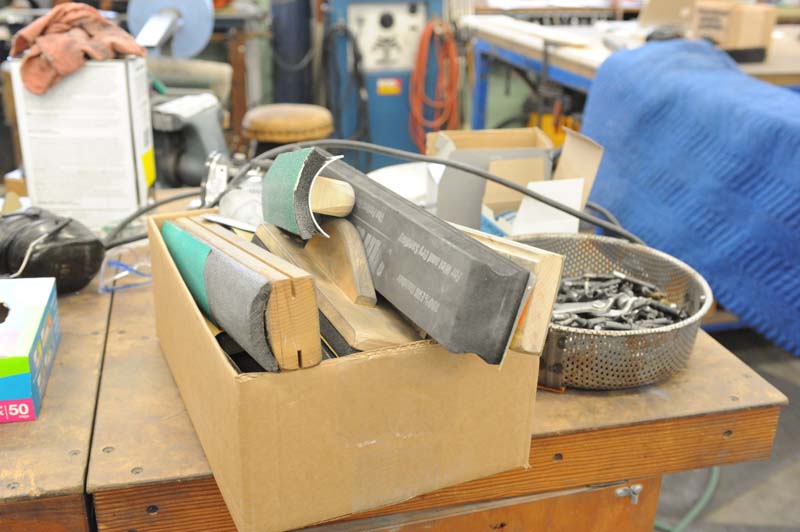

    Here's a bonus shot of the box of tools that Jason Hosking has used to form the aluminum skin panels:
    They won't get too much more use as that portion of the project is just about done. Only the rear wheel fairings need to be completed so they can be used as a form to make the carbon fiber pieces that will be used when the liner is run on the salt.

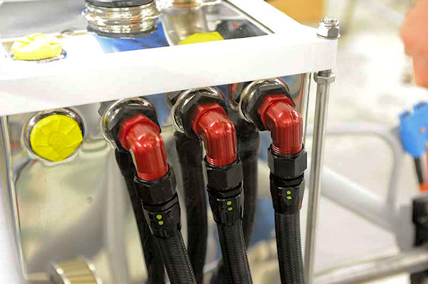

    Update 173: The Re***embly continues. The dry sump return oil lines for both engines are back in place and connected to the oil tanks.
    It's getting to that point where all the little things...plumbing, connections, tanks are getting done. Every week we get closer. We may have an interesting announcement soon. Not a record attempt date, but something very interesting, nonetheless. I'll tell ya about it as soon as I can.

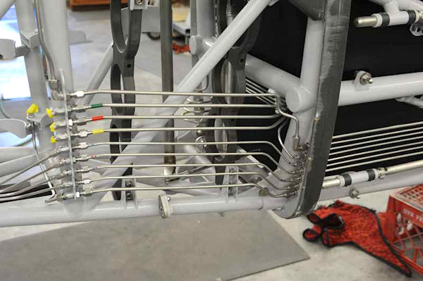

    Update 175: EVERYTHING has to be re***embled. I hadn't thought about the degree of dis***embly and re***embly required. On the salt flats, salt is your enemy. Ironic, but it's true. Just ask my old 64 Chevy rat truck that rusted out from under me and my current Suburban that's reached the point where it has to be replaced.
    So every part of the streamliner has been addressed with this in mind. Parts made from aluminum, stainless steel, Delrin and Teflon and then the parts that were made of iron or steel have been painted, plated, anodized or powdercoated. That means that everything was taken apart for this rustproofing and now has to be re***embled. You'll see a lot of that in this post, mainly what's involved in the ***embly of the skin panels. They aren't just pieces of aluminum formed over a frame. They're works of art in their own right.
    When you look at the photos in this post, check the contrast between the different finishes and see what had to be taken apart and is now going back together.
    Here's a photo of all the pneumatic lines that are made of stainless steel tubing and are now being reinstalled:
    And here's the link to the full post. Check it out!
