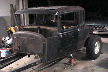

    Been working this week on channelling the A. I beleive when done it will have about a 5 inch channel. Nothing is welded solid yet.
    I tacked everthing up and dropped the body down today to check the fit.I will be running about a 1 inch bigger tire in the rear and the car will probably get a mild chop.

    How about some photos of the rails near the firewall area?

    From my perspective, the car would look better with just the channel. I like the top highth in relation to your channel job just fine as it is.
    I agree, it has that sinister look as it sets.
    Looks like an "Old School" car.
    Jim

    More channel, no chop, then you can look like my truck.
    Looking good.
    I don't think you are going to make the Roundup in it though.

    looks bitch/n. i vote for the no chop too! looks like you started with a very nice body!

    Don't listen to these guys...if you don't chop it 3-4" I'm going to come over and cut it for you.
    Well, at least cut it to where you can't turn back...I shave door handles the same way...ask Mark X. [​IMG]

    badass keep 'em going.chop it.use being a little guy to your advantage.bass can shave them handles...he a young gun dont ya know?

    Looks cool,did you use the stock sub rails and just raise em up or did you remove them completely??Pics?? [​IMG]

    Levi, only pic. I have of the front rails is already posted. Nothing on the inside done yet to see.
    34Fordtk,The original siderails are there. I welded some angled steel to them that sits on the frame. I have those tacked together with some 1X1 sqare tube on top of them.
    In these pictures there is a piece of 1X1 under the angle iron as a spacer because I planned on running the square tubing there and not on top as it is tacked right now.
    If I go with the 1X1 on top the car will be channelled down another inch. I may go this way if I dont chop it.
    I've set in it and I'm already worried about head room, and that was sitting on a flat piece of wood.
    If it gets chopped it will be subtle. 2 maybe 3 inches at the most.I don't like them too hammered down unless they are sitting really low.
    At the height mine will ride it's gonna look better with a small chop or no chop.Decisions decisions. What fun.
