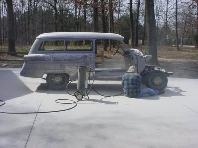

    Been workin' on the wagon a lot and we have made a lotta progress,,,,,most of the floors are in and both rear wheel wells and quarters have been fabed-up and installed,,,,,jumped on the body Saturday and stripped most of the paint,,,,Sunday is a day of rest......soooo,we sat on our butt as much as we could while sandblasting...
    [​IMG]HRP
