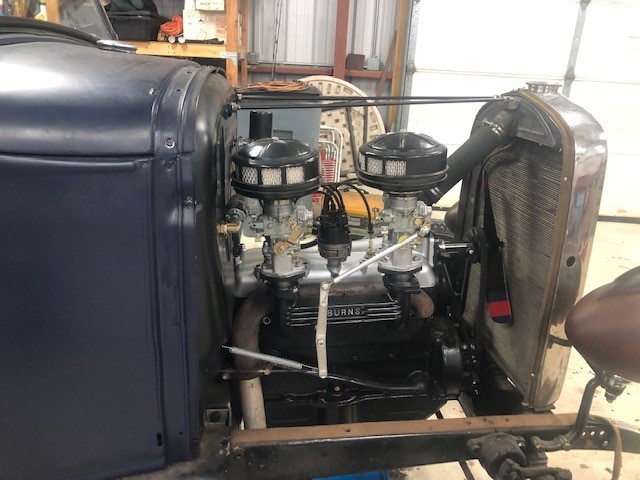

    Put these Solex Carbs on and had some stumbling on the blast off. Took one off and bingo works
    like a champ. Never messed with progressive linkage but I under stand the concept. Any thoughts? Solex progresive linkage.jpg

    Can you take a picture that shows the carbs and linkage, and not the rest of the car and background? I can't see any detail in the photo you posted.

  11. barrnone50
    Joined: Oct 24, 2010
    Posts: 573
    barrnone50
    from texas

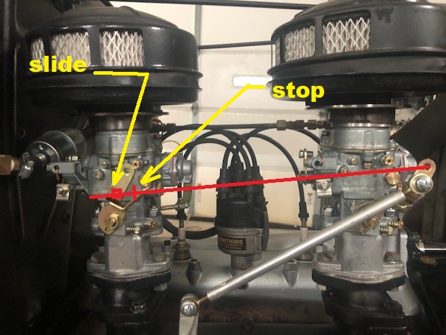

    Thanks for the picture, it helps a lot!
    Add a rod here, so that the end on the rear carb can slide in the fitting, until it hits the stop. You'll have to adjust the travel so they both open all the way at the same time. One end of the linkage is mounted further from the throttle shaft, so the travel of the rod, is longer than the travel of the slide fitting. Hard to explain, but that's how progressive linkage works.
