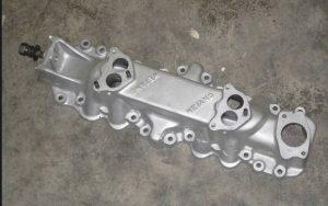

    Someone please help me understand the benefits of using a progressive carb linkage vs. a straight pull linkage?
    I'm installing a vintage Weiand intake with dual Stromberg 97's on a 59AB with a stock cam, standard bore, Edelbrock heads and tube headers.
    The Weiand intake manifold design places the carbs directly above the intake ports on the block, does this design require the use of a straight linkage pull on both carbs?
    Would a progressive linkage starve the front cylinders until everything is opened up?
    Is there any advantage to using a progressive linkage vs. straight pull on this configuration?
    Does anyone have experience with this particular intake manifold and are you running straight or progressive linkage?
    Any thoughts or suggestions are appreciated.
    Thank you, Jeff

    That intake would work best with straight linkage.
  4. clem
    Joined: Dec 20, 2006
    Posts: 4,865
    clem
    Can’t see quite how the runners go, and not familiar with that particular one, but straight linkage is the only way to go, looking at top view .
    Due to each carb (probably)over each set of runners.
    Progressive linkage would starve one set or half your engine.

    With a manifold configured like this one (called a "Super" dual), progressive linkage WILL NOT WORK not matter what size carbs you run on it. You may be able to get it started, and it may run, but that's about all. If you live in an area where there is cooler weather, I would also worry about the lack of carburetor heating on that. Those manifolds were made mainly for racing.

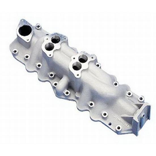

    If you're dead set on running progressive dual carbs on a flathead, you need one of these with the front carb as the primary. You may be able to get it to run decent. You will have exhaust heat on the primary, and almost normal fuel distribution when running on one carb. When you kick in the secondary, fuel distribution goes from "almost normal" to "pretty bad".
    See the difference? (Also, you don't have to worry about generator brackets, non-standard belts, and, in the case of early engines, the fan. These last are the only good reasons to run one of these)

  18. tubman
    Joined: May 16, 2007
    Posts: 8,679
    tubman
    I can't make any judgement about what you're saying without seeing an actual picture of the set up that you are running. If the manifold is "rear-biased" like the one I showed, I am surprised at your statements. If it worked that well for you, congratulations.:)
    BTW, I was not recommending a progressive setup on this kind of manifold; I was just saying that if you want to run progressive, this type of manifold is your best bet. I would personally never try to use one of these.
