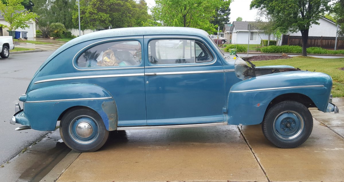

    I started in on the paint with some cleaners and polishes. The paint isn't the best quality but it's going to be on this car for a long time still. I can't afford to paint it for at least 10 years.
    It's shining up enough I'm happy with it at this point. I'm doing it all by hand so it's a time consuming process. But I'm learning her stories through all the bumps and bruises on her old hips.
    That's the hood under the trim. Just a comparison.

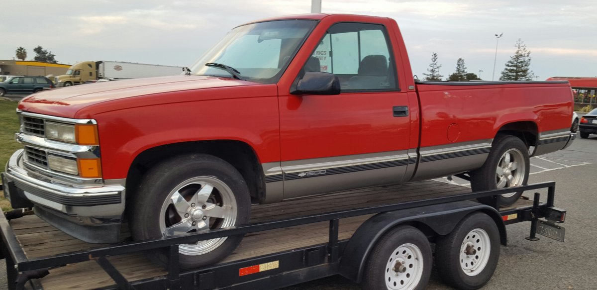

    I found a donor vehicle with a bad ***le and DMV back fees valued at twice it's asking price. Another road trip to Sacramento to bring home more parts. Keep in mind, CHEAP parts.
    For the traditional folks, I won't go into the nitty gritty of the new drive train. For everyone else I now have a reliable small block Chevrolet power, overdrive transmission, and air-conditioning. It gets hot in the Valley and I like to drive. I'm old enough now, I deserve AC.
    Cover one eye and scroll down to see the donor. And to the whiners I'll make you a deal,..... when you pay for my build I'll take your advice on what parts to use. 20160912_000322.jpg

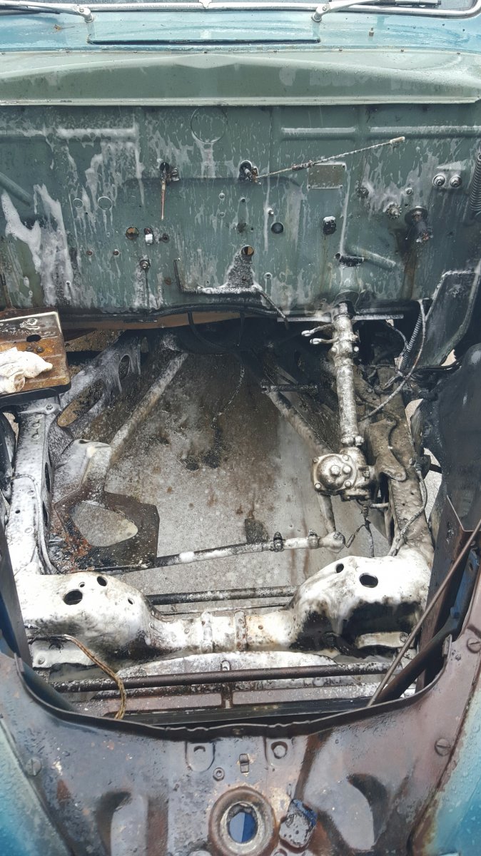

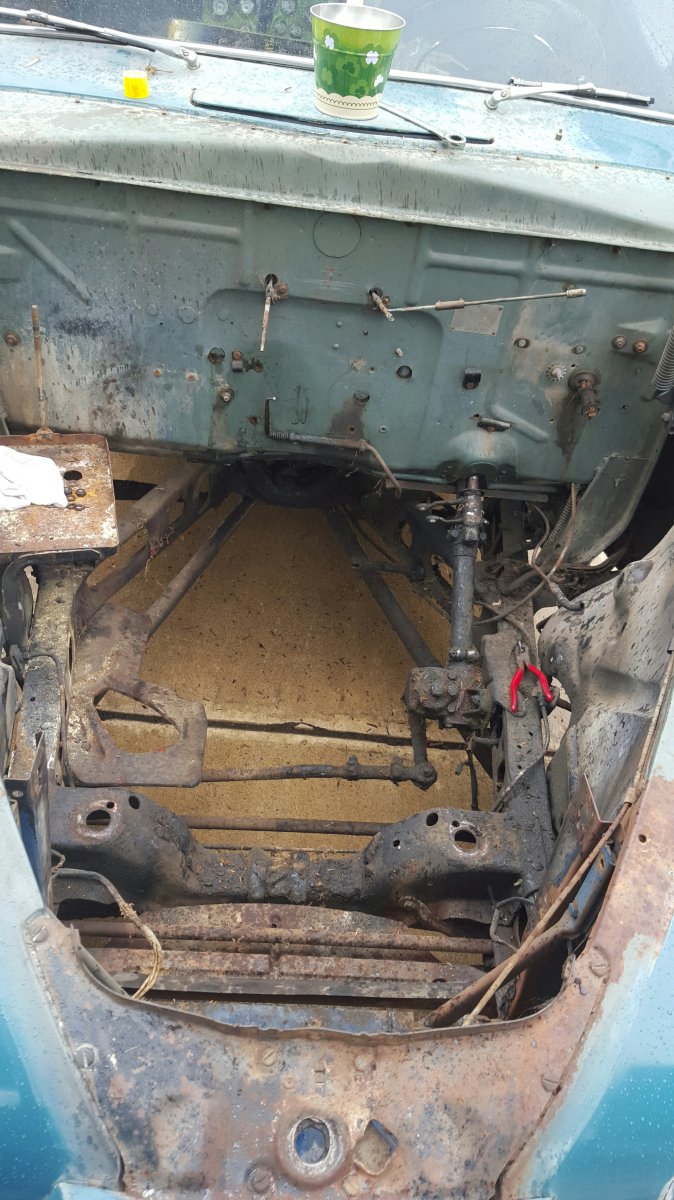

    Flatty out, sitting a little high in the nose. Paints looking better, though. Flatty and trans came out a lot quicker than we were expecting. I had already pulled the radiator and had most of the bolts out or loose.
    One more from the side.

    Degrease, pressure wash, repeat.

    Back into the garage, wedged between all the really important stuff I keep around. Same day as the motor came out we decided to keep on trucking since it's rare I have a full day of hot rod. Time for the banjo and torque to drop out and make way for the leaf kit and 9 inch.
    Thanks again to Rog, out she comes.

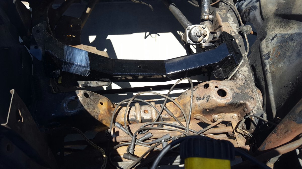

    I had ordered and powder coated the Ch***is Engineering parallel rear leaf kit for the 46. I ordered the "lowrider" kit Everything was/is very high quality and instructions were easy to understand.
    Cleaned up the frame surfaces a bit
    Drilled a few holes
    And she's in.
