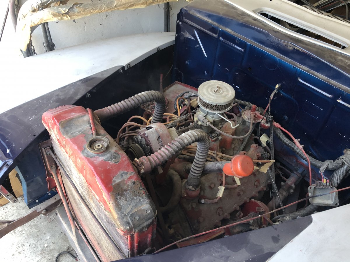

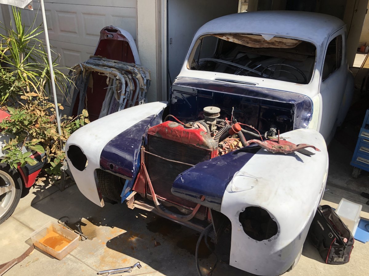

    63324B1F-E832-4199-89AB-9052B4AF60B4.jpeg F826D17E-0D8B-4273-BE99-D90A564E3E95.jpeg Thank you for sharing your project in such great detail! I just read through the entire thread and I love the progress. I have a ‘46 Tudor Sedan as well, but I’m barely getting ready to pull the flatty out. I will be following along for guidance, yours is looking so CLEAN!
    My dad bought this car as a project when I was 8. Long story for why it never got restored. Thanks again!!
