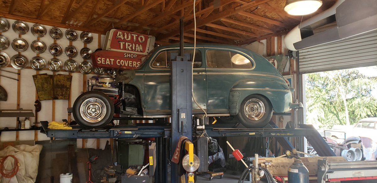

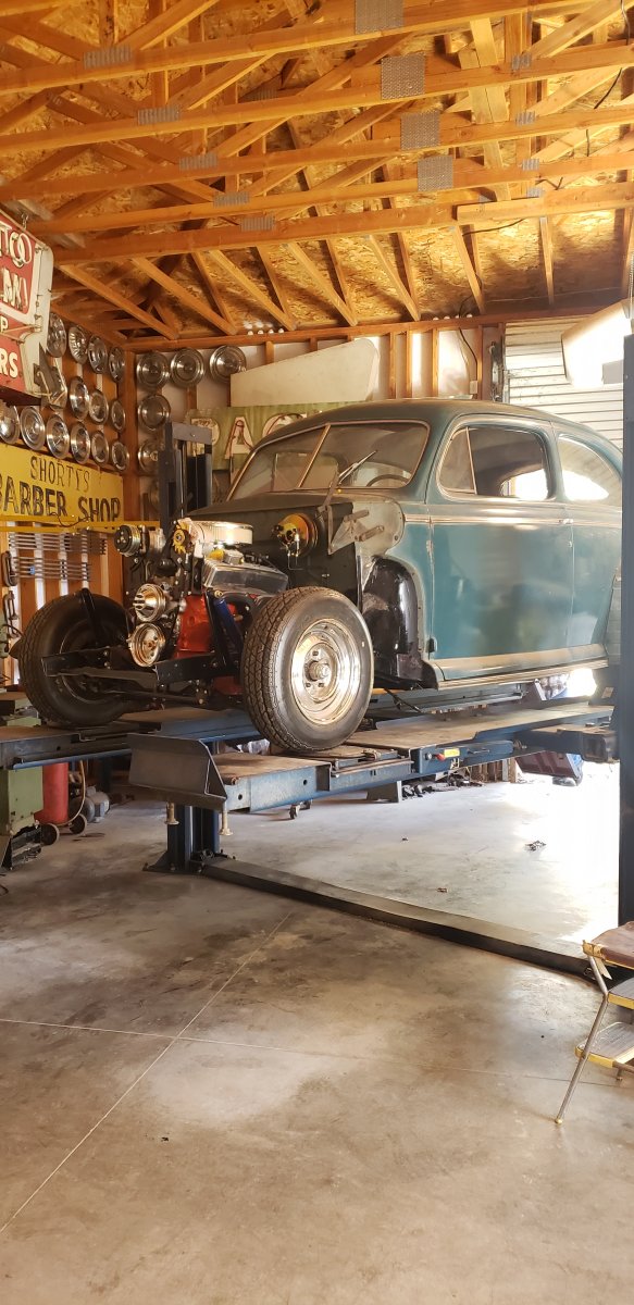

  6. DRUGASM
    Joined: Dec 16, 2008
    Posts: 2,817
    DRUGASM
    Got the 46 up in the air today. Gonna finish up a few things on the exhaust, drill some holes in the front crossmember for the brake line brackets, and run some electrical.
    chryslerfan55 and Thor1 like this.

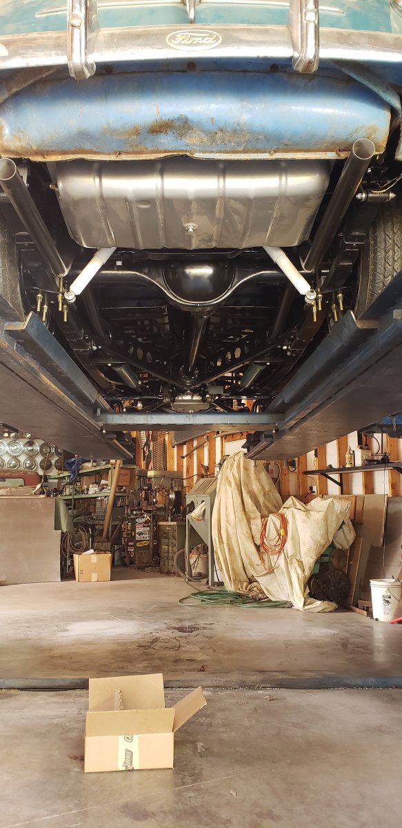

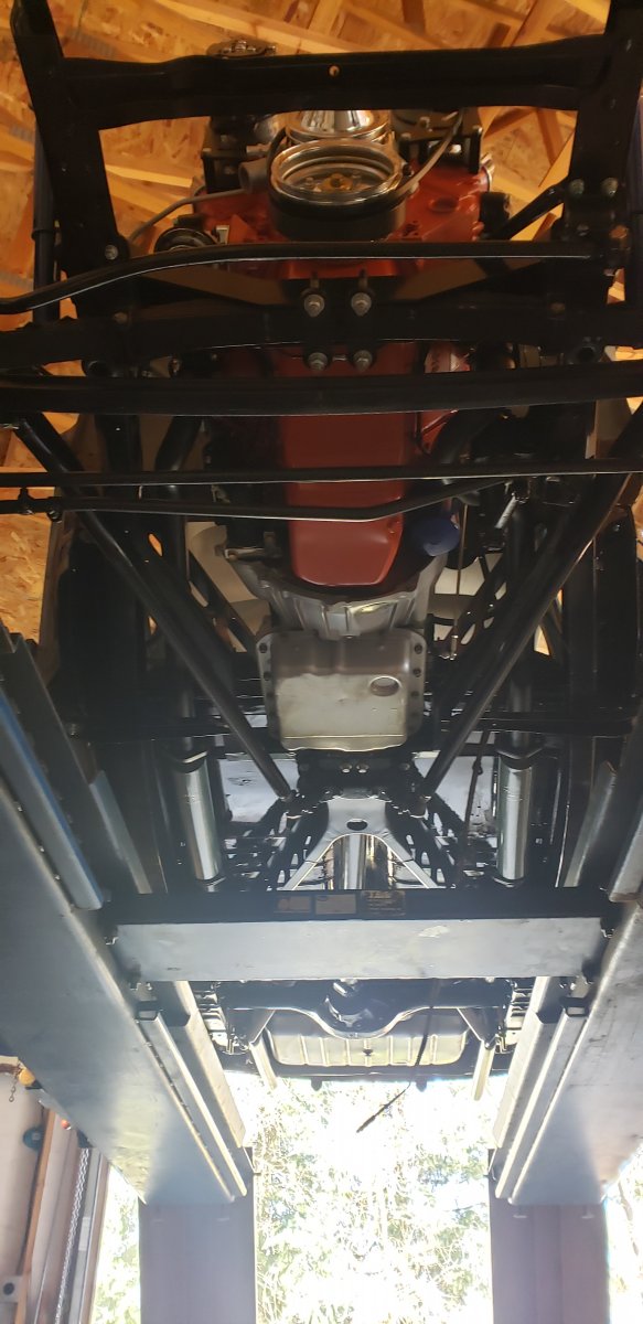

  7. DRUGASM
    Posts: 2,817
    DRUGASM
    Couple of shots up her skirt while she was in the air.
