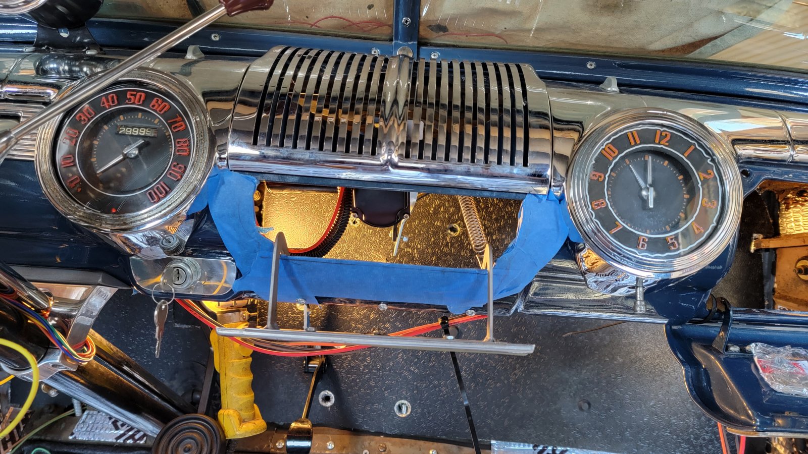

    Tracy finished the radio delete project while i pulled and wrapped more wires.
    Tracy copied the shape of the govebox door hinges and fabbed a bracket to hold the arms.

    20220109_123445.jpg It would be a nice spot to put a head unit but I think after eye balling it that the electric wiper motor is going to interfere.
    Exploring some options for a simple Bluetooth type receiver or a small boat/UTV type receiver. I'm not a huge stereo guy... don't need all the bells and whistle.
