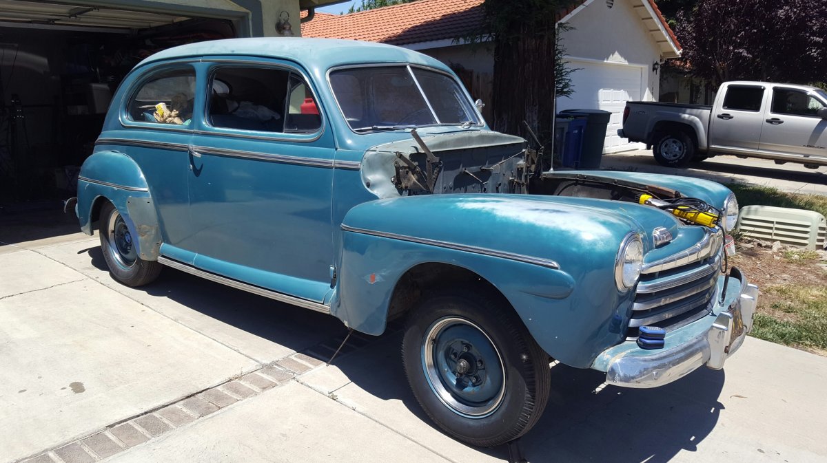

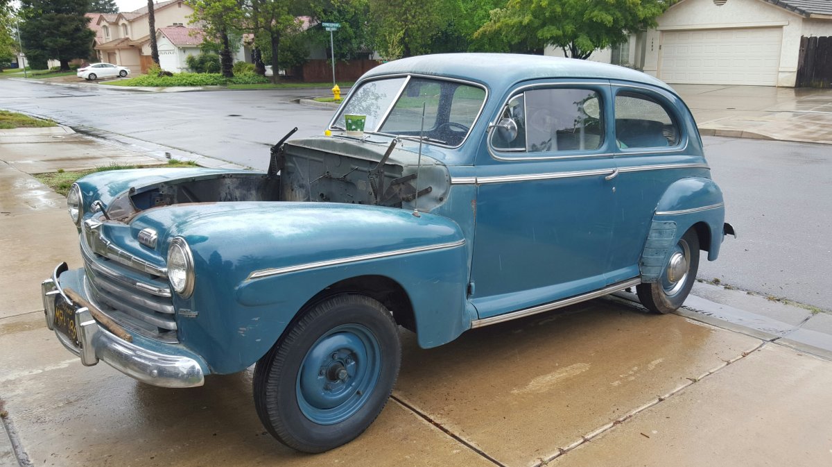

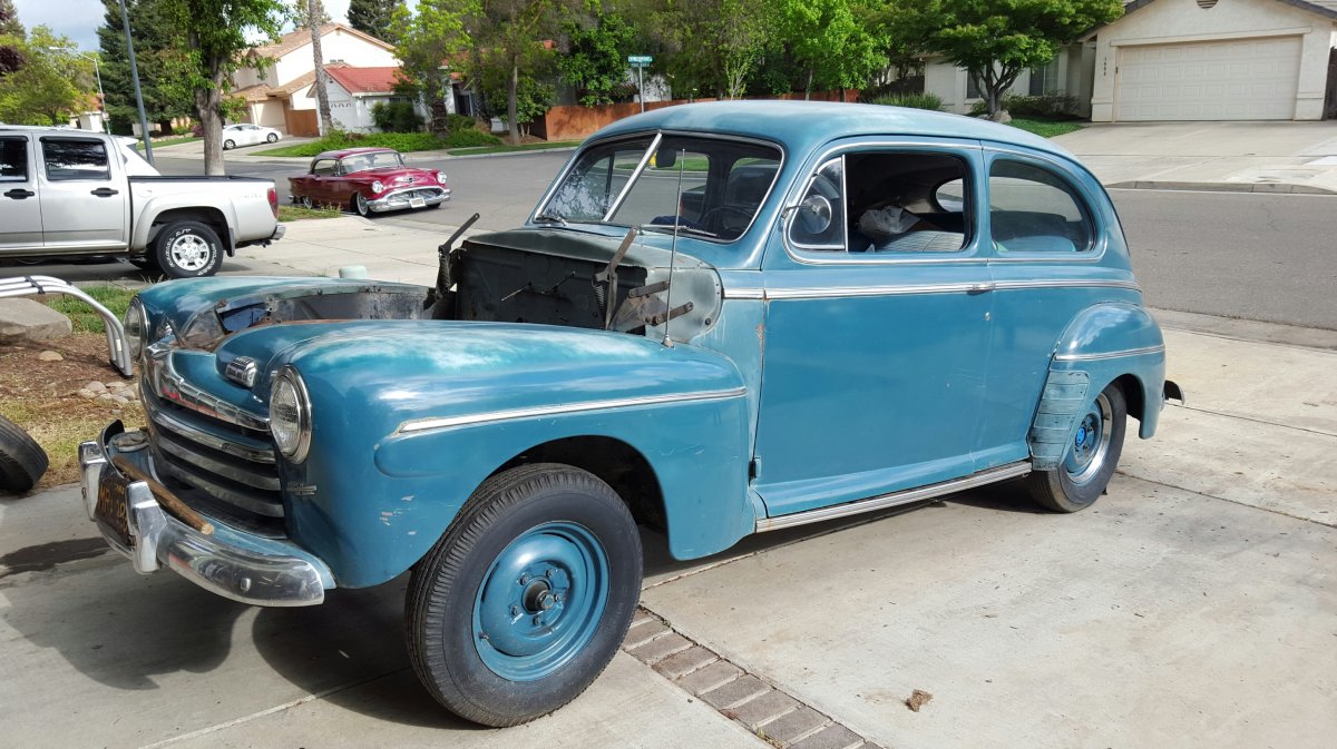

    The first year went from this....
    To this .....
    I should roll it out and take another picture with all the kids to see how big they have gotten. When it rolls that is.
    chryslerfan55 and Sum54ford like this.

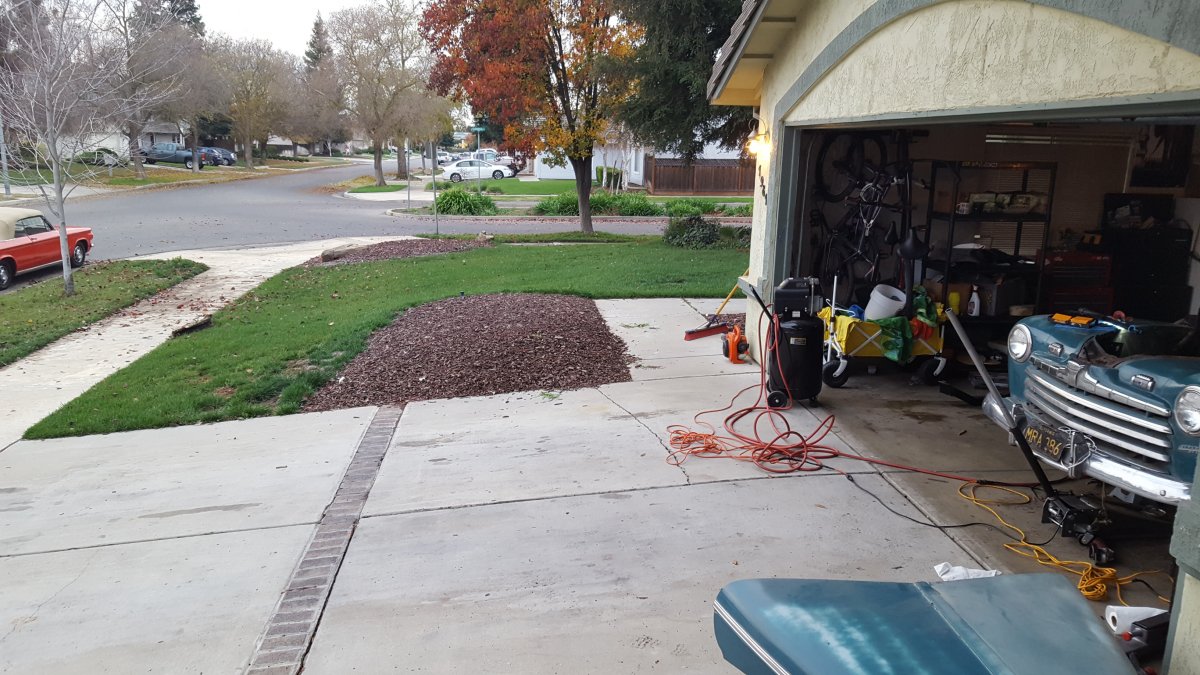

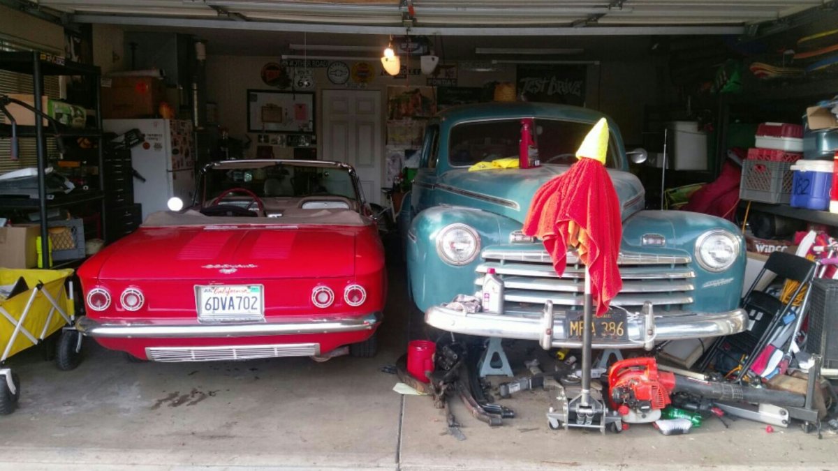

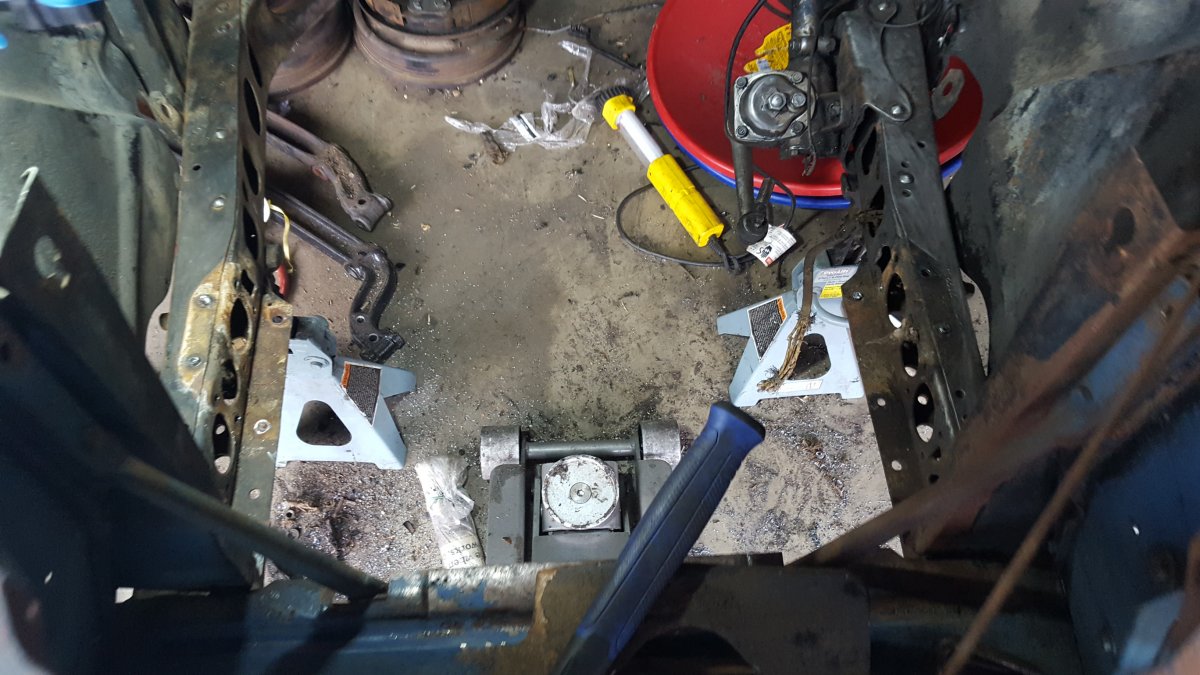

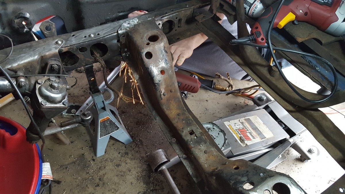

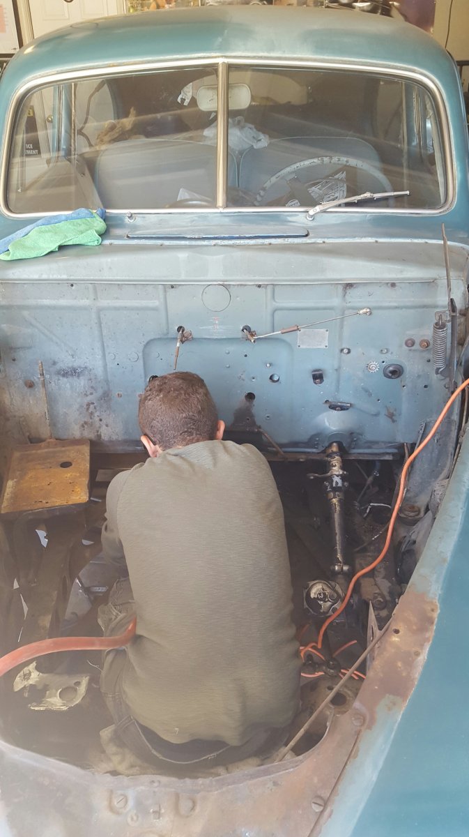

    Finally! Got about 3 or 4 hours in a row to work on the 46. Rog was available again and came over to help.
    My goal today was just to get the old crossmember out and make room for the new raised/dropped member.
    It wasn't raining so we were able to roll the Corvair out and give us some room to work. After straightening up all the stuff that seems to get stacked on the car it was time to get to work.
    Everything almost fits in a "two car garage".

    I had ground out a rivet or two when I had a few moments. Of course I went after all the easy ones on the nice wide, flat surfaces. The ones that were left were those bad MFers that were tucked in corners or just far enough away a grinding wheel wouldn't hit them.
  29. DRUGASM
    Joined: Dec 16, 2008
    Posts: 2,817
    DRUGASM

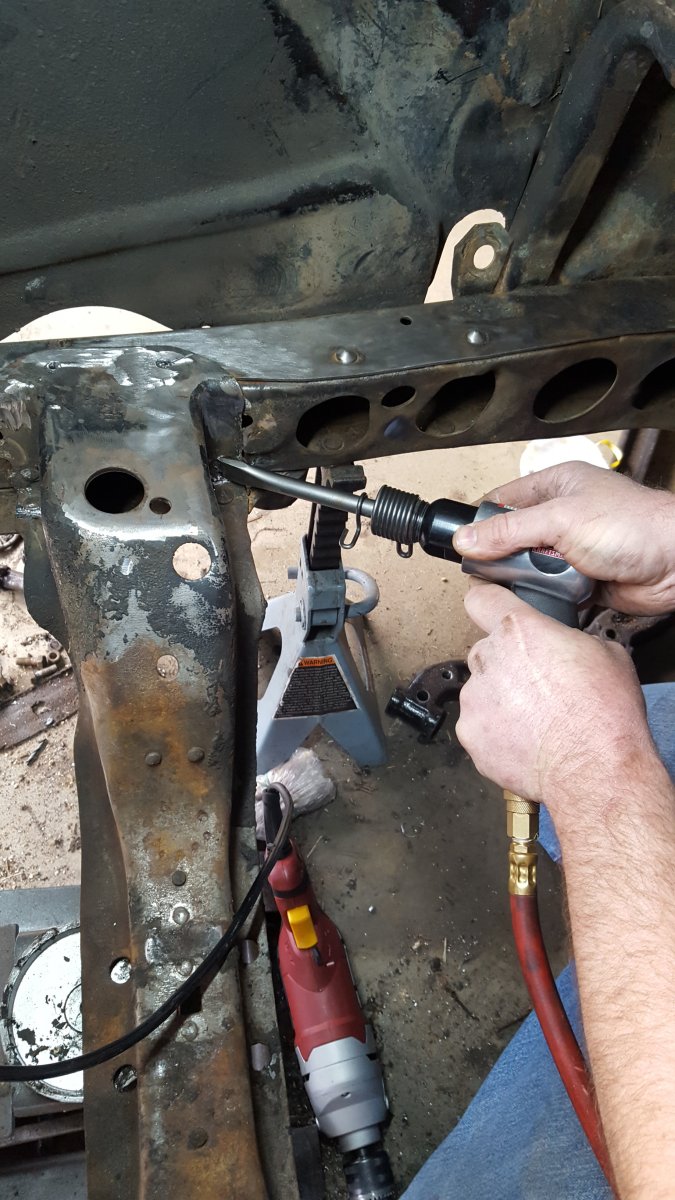

    Rog brought an air chisel and we broke out the big drill. A hammer and a punch got us lined up and we went to work. Between the grinder and the chisel we were able to knock the heads off. Next, we drilled out the centers and pushed them through gently with the BFH.
    The air chisel made the job a bit easier. Between the chisel and the compressor running to feed the chisel both our heads were throbbing by the time the cross member finally gave up the good fight and broke free.

    Oh hell yeah! It's out. Once all the rivets were gone a few good whacks with the BF hammer freed it. At this point it was cross member shotput for distance.....
    With a huge throw that giant piece of steel was out of my way. Almost made the sidewalk. I did get a little nervous as it soared through the air and took a bounce towards the Corvair.
