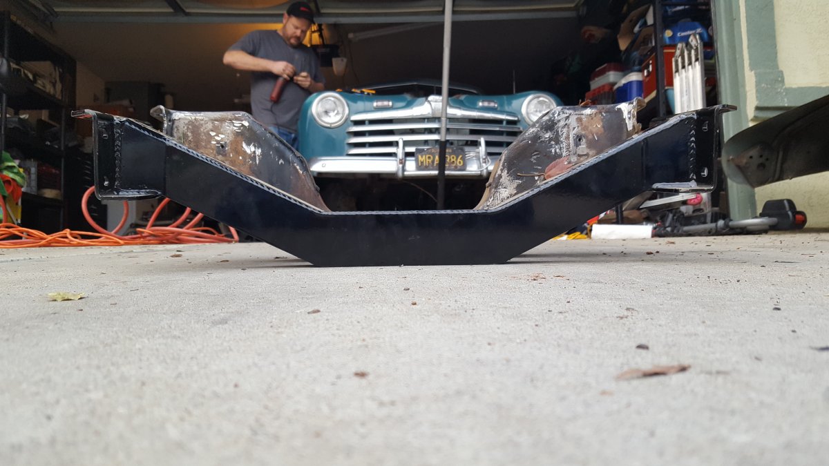

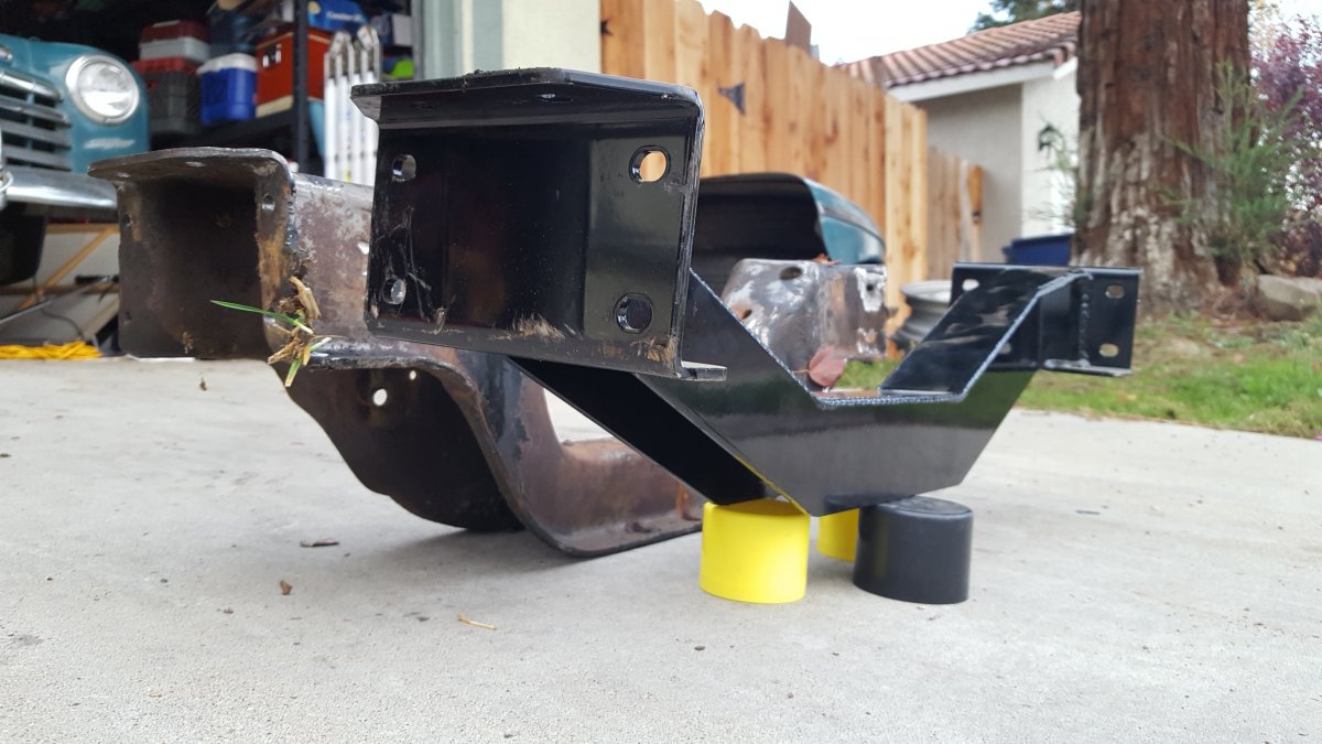

    After getting that outburst out of my system, I was curious how much of a difference this would make.
    I lined them up next to each other to see what kind of drop it will provide. The driveway is sloped so I did the best I could just to show the difference.

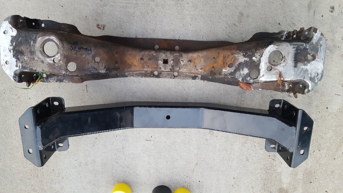

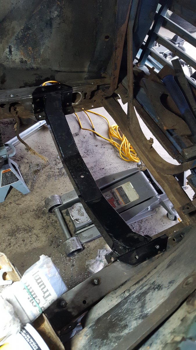

    The quality of the new member looks pretty good. It's a Speedway part. The powder coating on it is so so. I'm glad that it seems to line up okay in the car, though.
  3. DRUGASM
    Joined: Dec 16, 2008
    Posts: 2,817
    DRUGASM

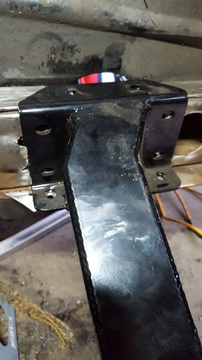

    Here it is in the car. Looks like it will line up well.
    I need to buy some nuts, bolts, and washers to get it finished up. That's all I got done today but I feel pretty good about it. I'm not sure why anyone wouldn't take the extra few hours to swap it out for the difference in lowering if they had the engine out anyway.
    After that's bolted in its on to re***embling the front axle and wishbone. Then off to get motor mounts, the wishbone split, and a lot of work to the center brace to clear a 4L60E.
    Hopefully it will happen before April. I need more than a biannual work day on the car.

    Check out my nut sack. There's bolts and washers in there, too. Got all the hardware I'll need to bolt in crossmember. Took the old one with me to size up the hardware.
    Inch and a half long 5/16 bolts and I bought grade 8 stainless and grade 5. Seemed to fit the old holes okay.
  8. DRUGASM
    Posts: 2,817
    DRUGASM
    I'm not thrilled with the way the 5/16 are fitting the holes. Little too much slop. I'm gonna trade them for some 3/8 tomorrow. And I think I'm gonna go a bit shorter, too.
    Yes, I realize that's not the correct order for the bolt washer washer lock washers nut combo. I just did that to see the fatness of the stack. I wished the guage the thickness of the hardware.

    Got an hour or so this afternoon to play around. Cleaned out all the holes on the frame and knocked the burrs off them with a 3/8 bit and got to work.
    Laid everything out and started matching up bolts, washers, and nuts.
  15. DRUGASM
    Posts: 2,817
    DRUGASM
    Most of the holes seemed to match up pretty well. I sunk the easy ones in first. 20170101_200154.jpg
    Then I used a long pry bar and wiggled it around to get a few more of the stubborn ones in.
    Even after all that, a few stubborn holes didn't want to match up. I hit them real quick with the drill again to cheat the holes a bit and it seems to be fitting well.
  16. DRUGASM
    Posts: 2,817
    DRUGASM
    It's a bit tight in the corners but once I tightened down the bottom one, the top one had room to spin.
  17. DRUGASM
    Posts: 2,817
    DRUGASM
    All in. I will go back, one by one and add lock***e for the final final. 20170101_202950.jpg
    Lots of patient, blind work. Good thing I have long fingers. One step closer to getting it back on the ground.
