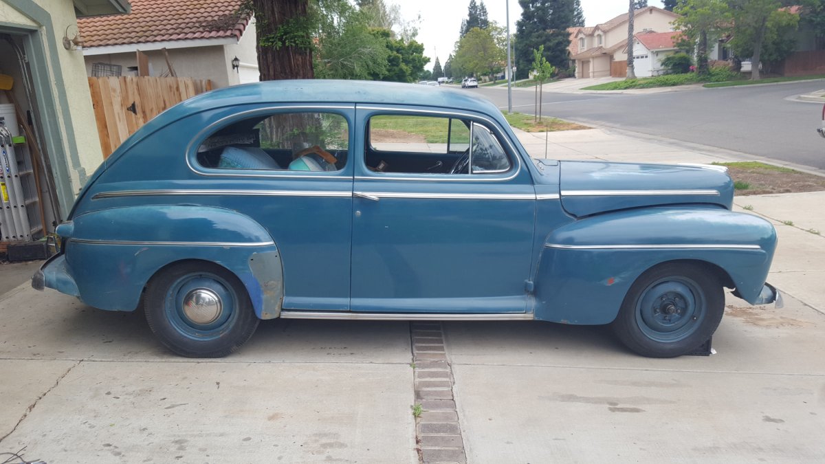

    It's sitting with a slightly forward rake which is what I had hoped for. I still want it lower..... but DAMN! What a difference.
    I'm playing the tire size game in my mind right now. It's on 6.00x16s. I may go 6.50 in the rear and keep a 6.00 up front. Or I may go 7.60 rear and 5.60 front. Or.... I may go whitewall or I may go black wall.... or or or.
    I'm pretty content for tonight. My mind will certainly be busy as I try to sleep.

    It's gone from this......
    To this......
    And now to this....
    I'm still giggling when I see it this low now. I'm glad it's tucking tire.
    The last two pics.... both are without engine or trans but with the 9 inch. I'm amazed at how much lower it is. That's legit.
    Now all that's left is everything. Stay tuned.

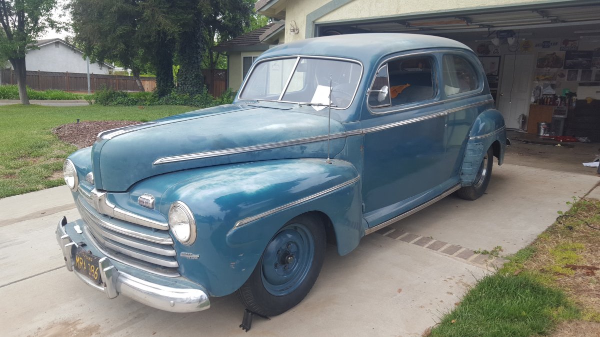

    One more in the daylight coz I am not tired of looking at it yet. Power-parked it for all you secret GoodGuys out there.

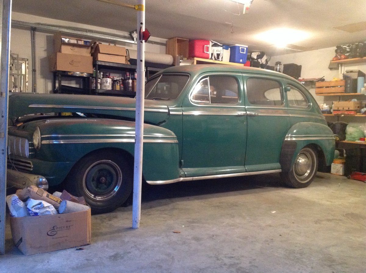

  16. M4RT1N
    Joined: Oct 11, 2008
    Posts: 4
    M4RT1N
    image.jpeg image.jpeg Great build and a great thread. Seems you're doing everything I've been doing to mine except you've gone about it much quicker than I have.
    Had mine (46 Mercury 4 door) 7 years but it's always been a back burner car that got bits done between other (4) projects. I'm in BC Canada, it's March 23rd and there's still snow on the ground meaning I can't do the bodywork on my 58 Suburban in this weather (no heat in the shop) so the 46 gets a little more attention. Same stuff really, TCI rear spring kit, Ch***is Engineering front end kit, Chev drive train & Ford axle with drums all round. I imagine you will have a good few thousand miles on your ride before mine hits the Tarmac.
    Keep adding to your thread, it's great inspiration to those that do, those that don't do and those that do do once in a while. That's a lot of do do?

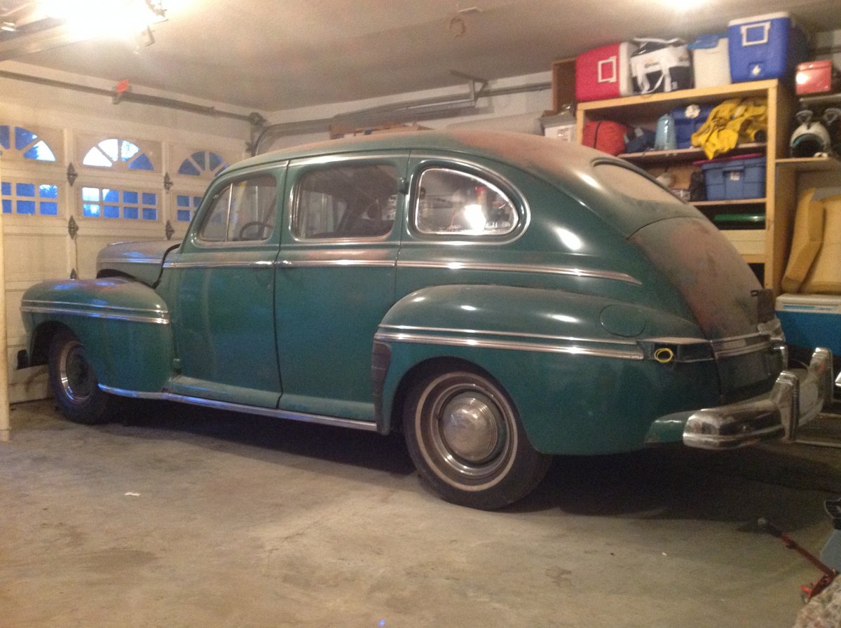

  17. hotrob32
    Joined: Oct 2, 2009
    Posts: 323
    hotrob32
    from Bend
    looks sweet. I'm running 16's
    DRUGASM likes this.

  19. DRUGASM
    Joined: Dec 16, 2008
    Posts: 2,817
    DRUGASM
    Couple of good looking Sedans there fellas. Thanks for the pics. I still really like the way the 16s look. Haven't fully decided.... haven't really had time to think about it.

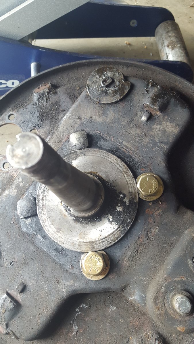

    Got a few hours today to play with old cars. I got the new dropped steering arms bolted on, clearanced a few tight spots, and did some other clean up. Now at least the steering wheel controls the steering axle again. Much easier to move around and ready to go to the welder for some work.
  21. DRUGASM
    Posts: 2,817
    DRUGASM
    Here's the p***enger side steering arms bolted to the backing plate and spindle. I tried bolting it just to the spindles with no backing plates but the bolt heads hit and wouldn't tighten down. They needed that added width of the backing plate to help mount the arm. The arm is really tight against the axle. I ended up blowing it all apart again and grinding down the axle to clear. There goes my powder coating. Oh well. I have a bunch of stuff that needs to go. Good reminder to fit and refit parts before committing to a finish. Even after grinding it's still a really close fit but it can go through the full range of motion without interference.

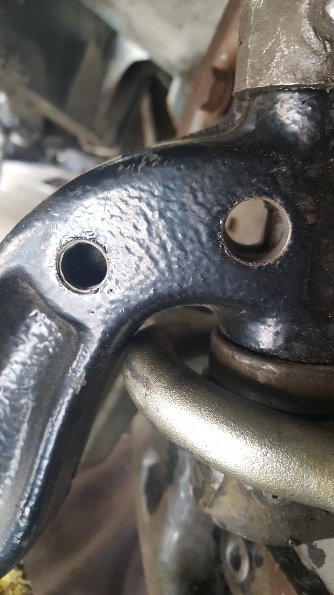

  22. DRUGASM
    Posts: 2,817
    DRUGASM
    Still the p***enger side. You can see the big dark rub mark on the new steering arm from where it was hitting the axle. Yes, I know I'm missing pieces on the king pin. This is just slopped together to make it steerable. I have a brand new king pin kit from Sids that will go in with all new parts when the time comes.

    20170424_142944.jpg The washers I bought didn't want to fit against the spindles. A few minutes with a grinder and they slipped right in.
  25. DRUGASM
    Posts: 2,817
    DRUGASM
    Driver side went about the same. I took a bunch of meat out of the axle before I put it together anticipating the arms would rub. 20170424_145131.jpg
    Still was not quite enough. The arm rubbed and I did some more grinding. There was a pretty good ridge of slag left over from the casting. 20170424_145313.jpg
