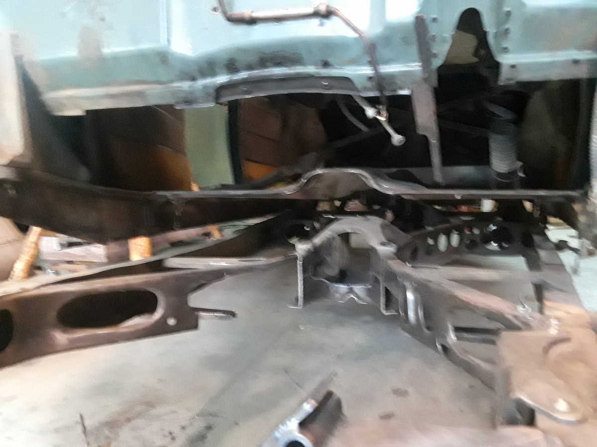

    I've spoken with the Morfab guys and they make a good product. They said it's designed for an IFS car though and wont work with wishbones. Tracy showed me where everything is gonna land and it looks like it is working out well this way.
    How ever, I think it has reached the "if you give a mouse a cookie" point where I need to make a decision.
    He mentioned casually that it would be easier to finish weld and fab if the body was off. Tomorrow I need to price out body bushings and talk to the sand blast/powder coat guys.

    I won't be able to keep my master under the floor anymore. I didn't want to hang it off the firewall but I am running out of space. The ****** lives where everything else wants to. Also, driver side exhaust is going to be an excercise in tube bending....

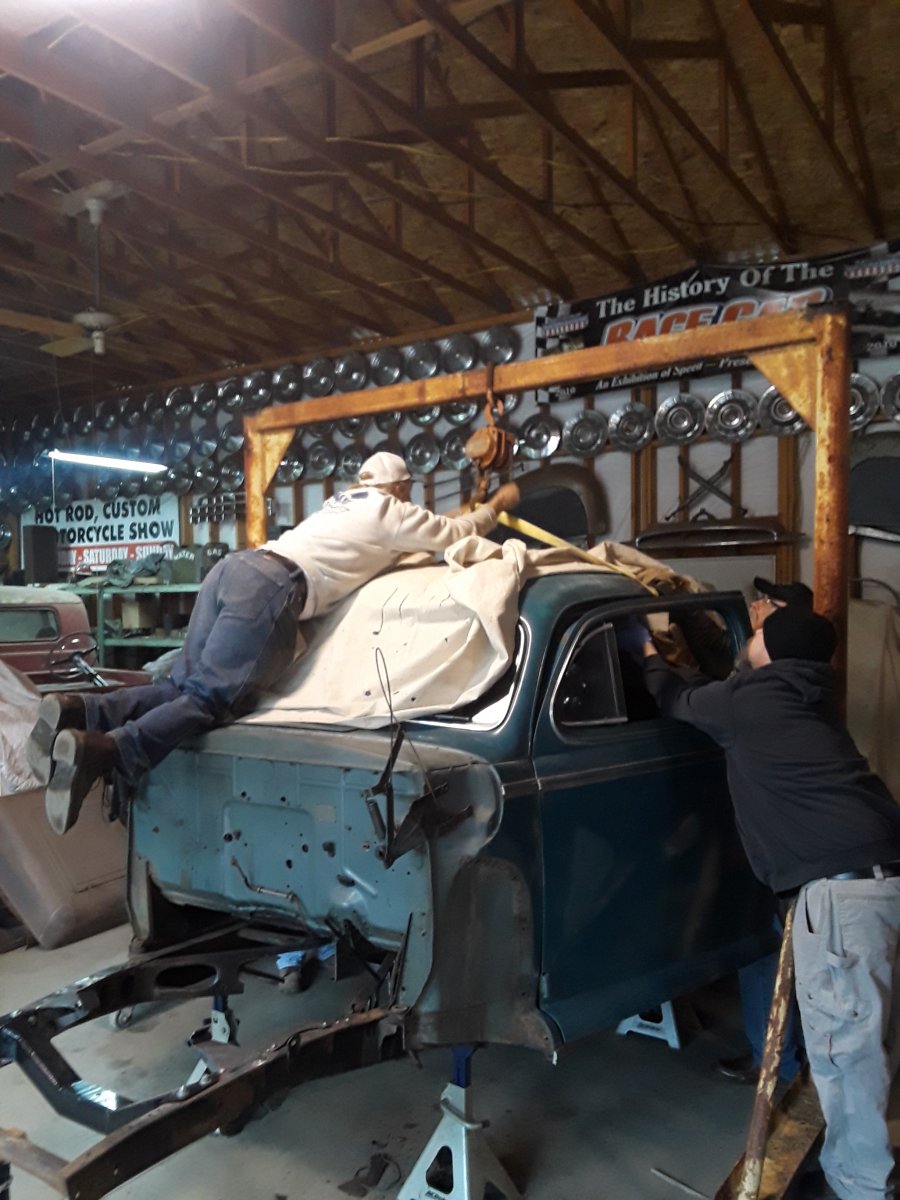

    Today is the day. Gathered up a few good friends and set to pulling the body off the frame.
  11. DRUGASM
    Joined: Dec 16, 2008
    Posts: 2,817
    DRUGASM
    We put a large board through the open doors and had a big strap going to the hoist. We maxed out the chain but it held the body high enough we were able to slide the frame out from under her.

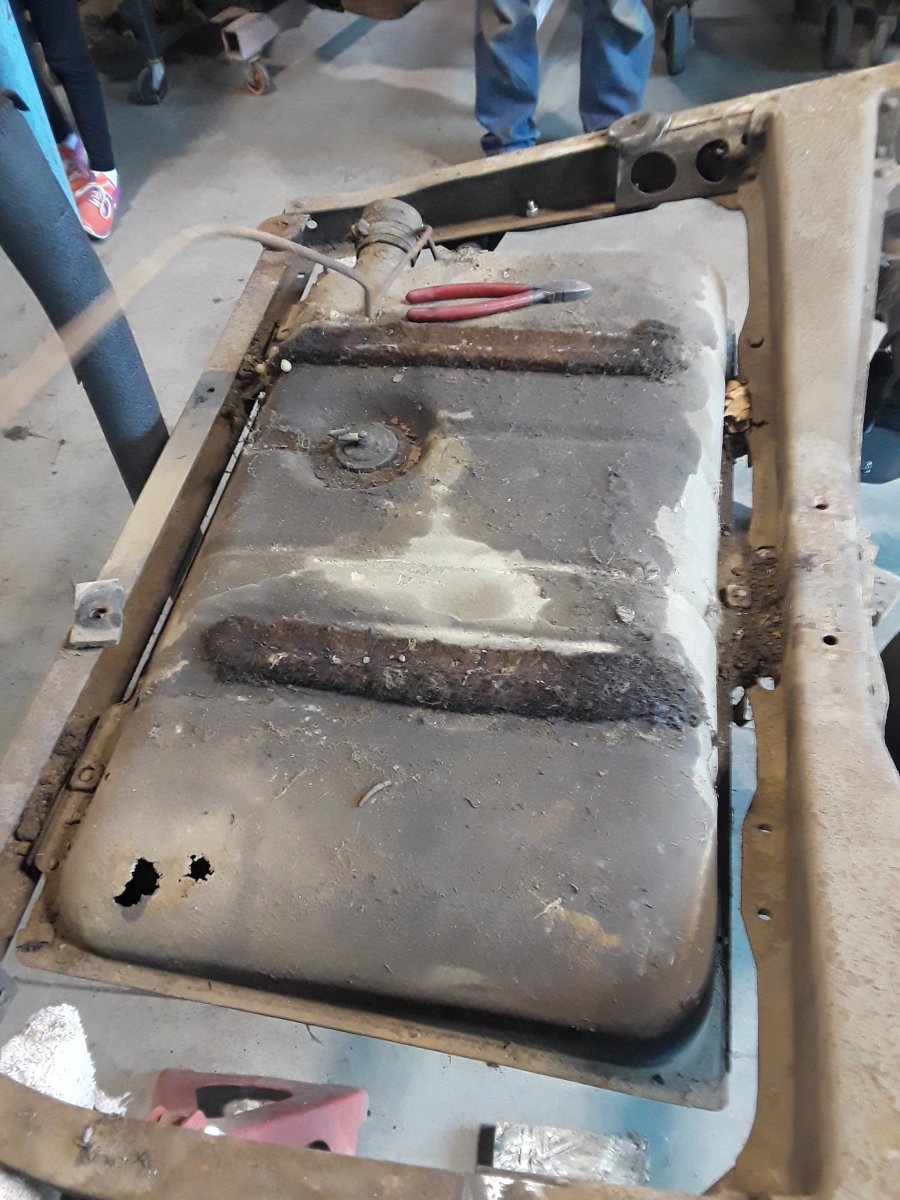

    Gonna need a new tank. Guess that' where the old fuel smell was coming from.

    All in all, a pretty good day for just a few hours of work. I was nervous the whole time, worrying the body may sway into the hoist, or the whole thing would come off balance and fall.
    At the end of the day the only damage was a little fold in one drip rail that should come right out.
    Big thanks to everyone who helped out today.
    A little finish welding and it's off to the powder coaters.

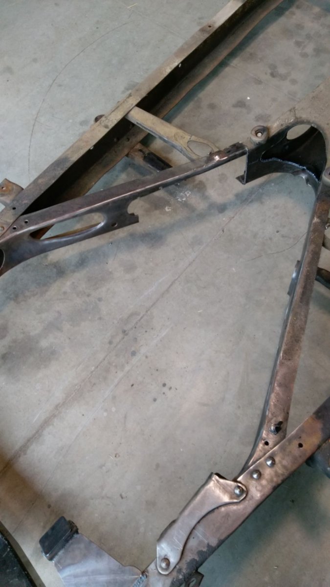

    What's the plan for replacing the section of the X member that was sacrificed to the transmission Gods?
    chryslerfan55 and DRUGASM like this.
  25. DRUGASM
    Posts: 2,817
    DRUGASM
    That's a good question. Tracy had a few patterns drawn up. I don't know that I have the vocabulary to describe them very well, I will definitely be posting more pics.
    He showed me one pattern for the center X. Basically it's a half circle that will fit the bottom of that X about where the wishbone mounted. He also has a few boxing pieces drawn up.
    Pics to follow.

    Drugasm, If you need a tank and body mounts, I have a new Bob Drake tank and filler neck hose, with hardware. Also have Drakes body mounts (new), no bolts. Let me know. don 208-659-9950.
  27. DRUGASM
    Posts: 2,817
    DRUGASM
    Thanks Don, I'm interested. I'll give you a call in the next few weeks.
