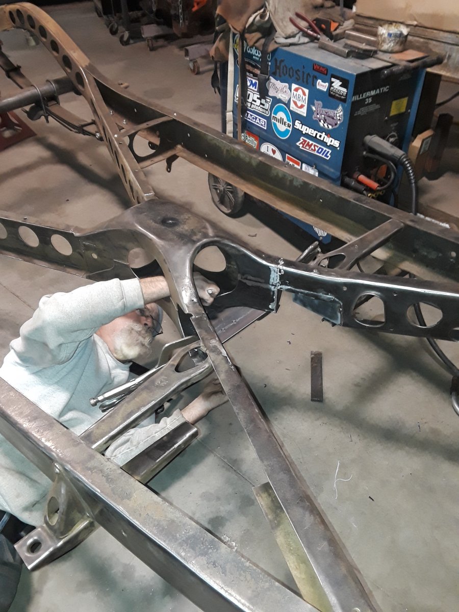

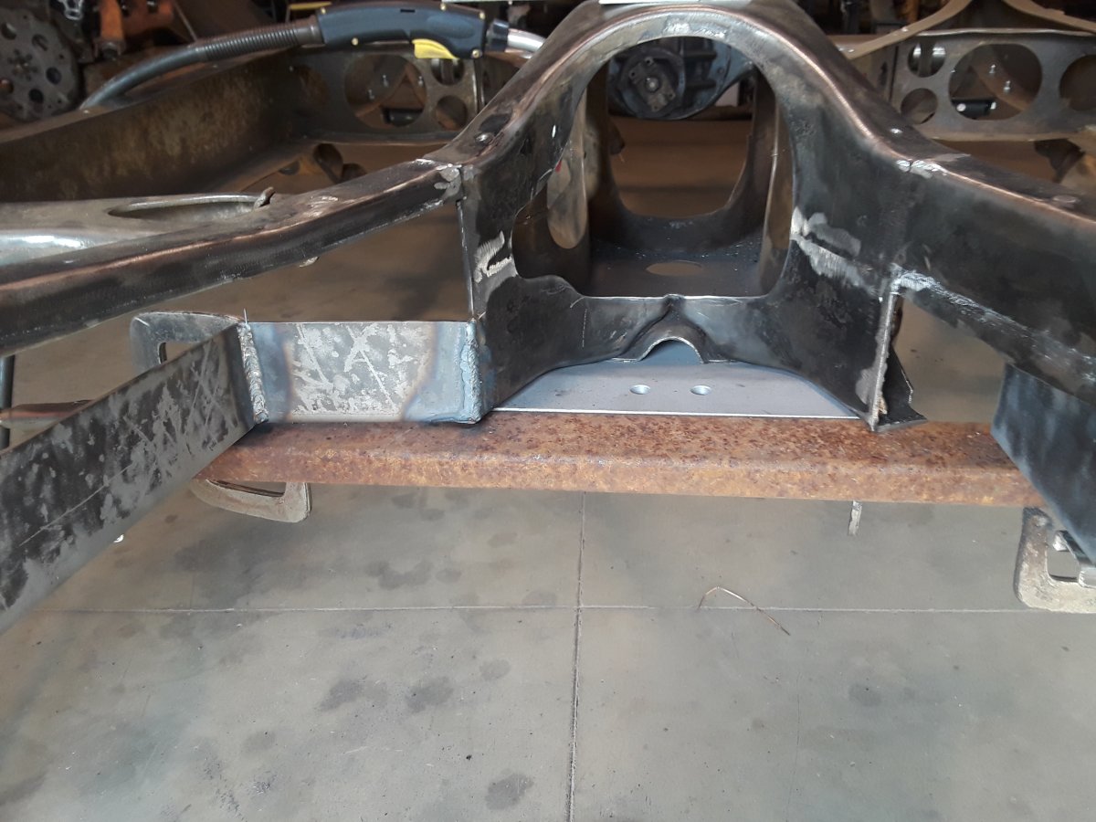

    Got to see Tracy in action tonight while I finished up the floors. He was working on the transmission mount. Measure, Mark, bend...... Measure, Mark, bend. 1/4 inch plate for the bottom part.

    Into the press to follow the contour of the X member.

    Add a couple mounting holes and back under the car. Measure, Mark, bend....

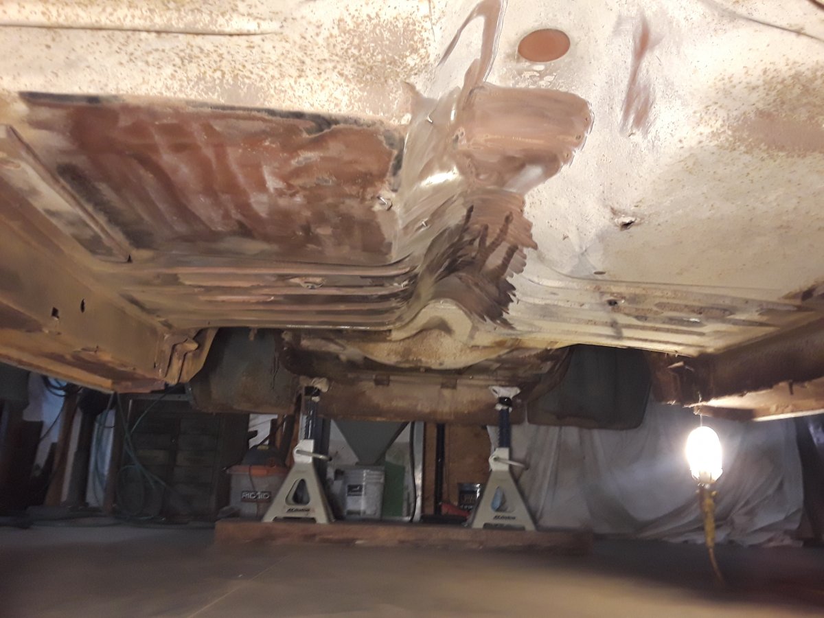

    Back under the car Thursday night to start painting the floors. Hopefully there's more on the car than on me when it's all done.

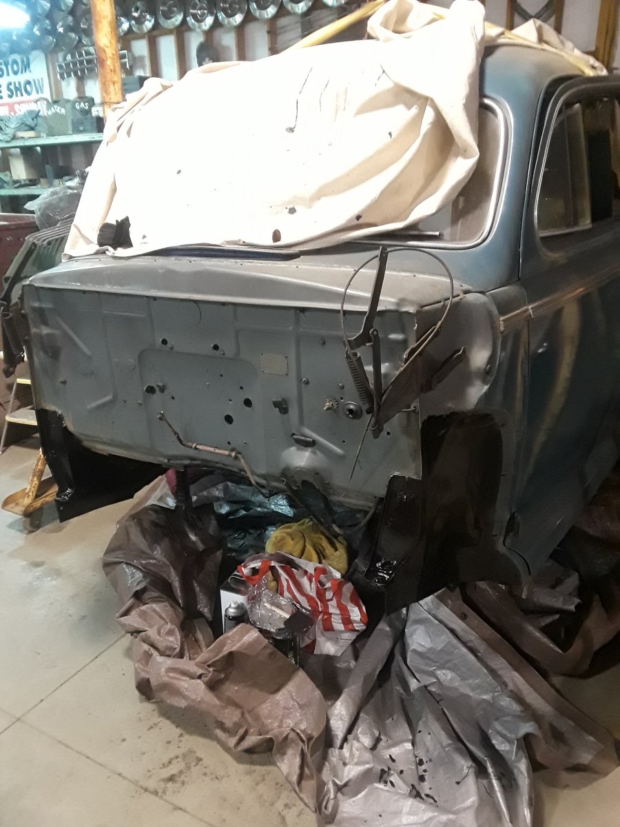

    It's got a couple bumps in the back fenders and down into the black rubber rock guard area but nothing major. I'm just grateful there a very minor rust in just one little spot.

    Couple of hours on my back again tonight trying to lay where the paint wasn't dripping. It looks like it' going to flow out reasonably well. Couple of small spots to touch up in the next few days but I like how it looks so far. Gonna let it cure or set up and see what's what.

    Few more pics of process on trans mount.

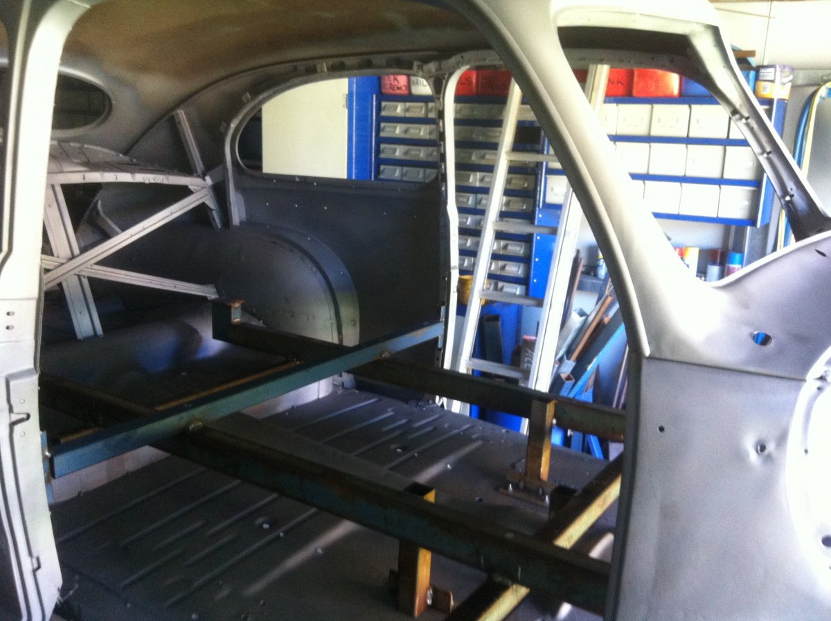

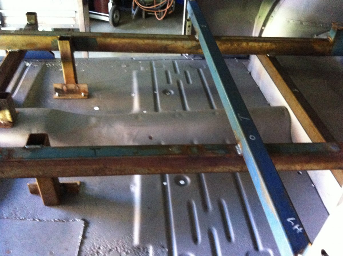

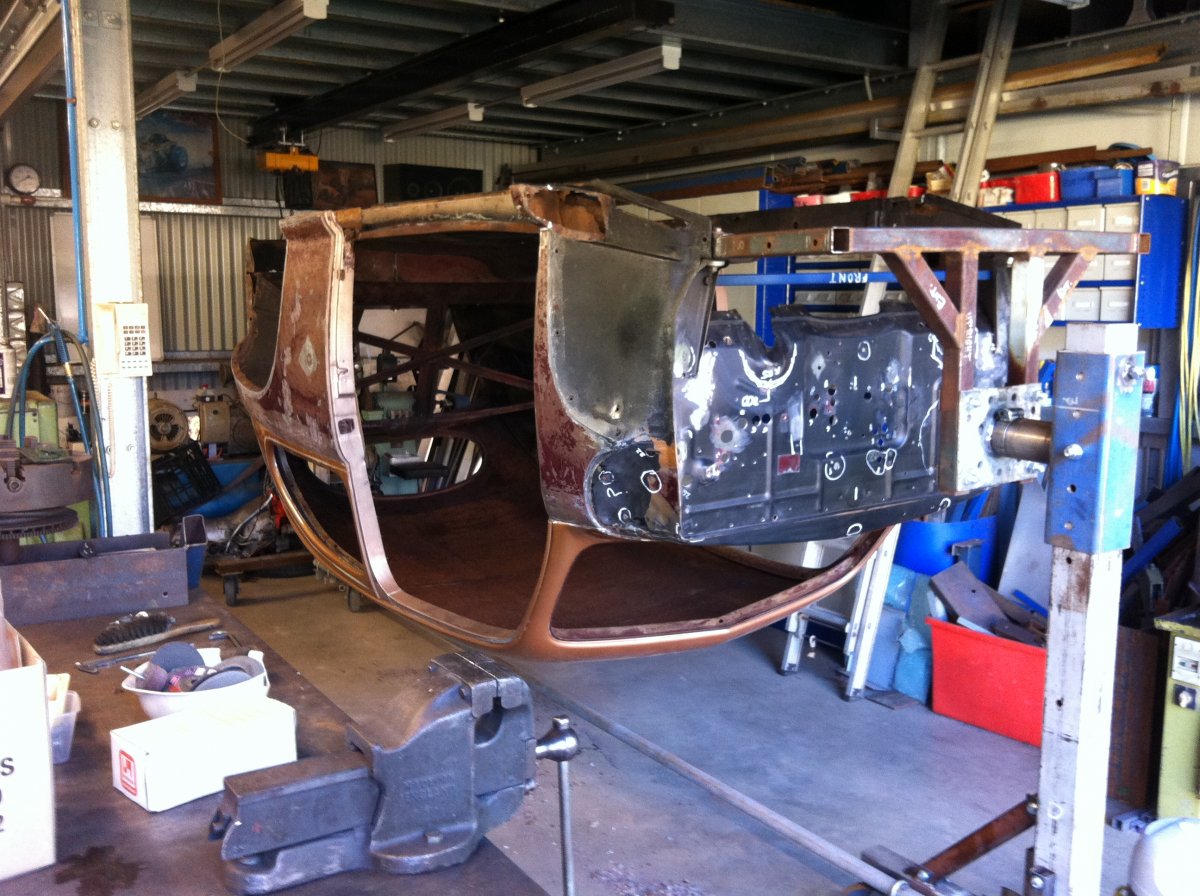

    I'm working on an identical project at the moment and because I'm getting too old to roll around on my back I spent a couple of weekends to build a rotisserie. It's the best thing I could have done, it makes every job a breeze. I built a small basic one for the ch***is too, both will be used for repairs, mods, sandblasting and painting jobs.

  22. DRUGASM
    Joined: Dec 16, 2008
    Posts: 2,817
    DRUGASM
    That would have been really nice. I had to play dodge the dripping paint under the car. And then had to remember not to sit up and put my head into the floor with the wet paint on it.

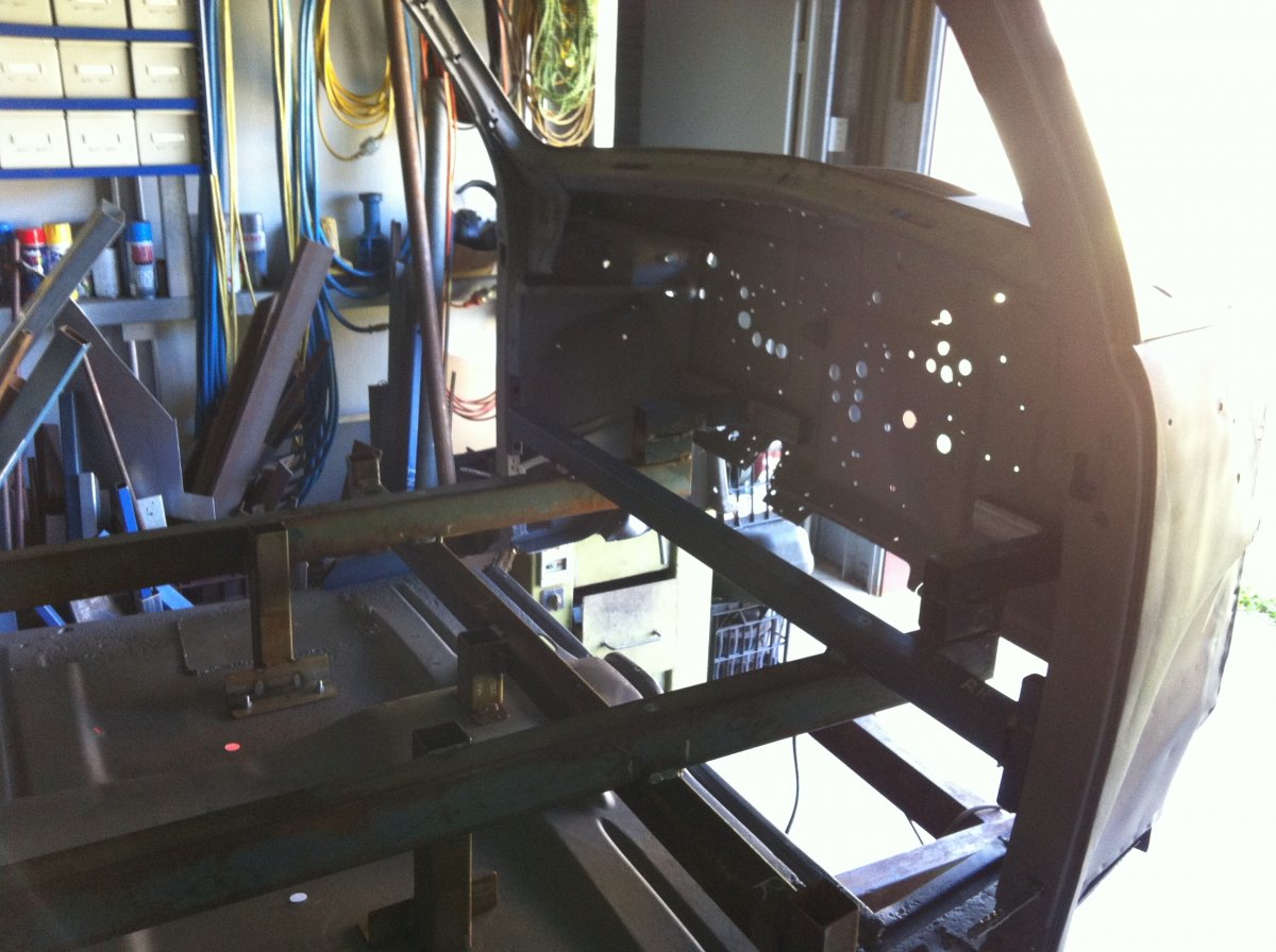

    Before the body was sandblasted I built an internal frame to hold the firewall, floor, A & B pillars, front body mounts etc in alignment. This was done because I had to remove/replace the complete front rockers, lower cowl pieces, and front floor ***embly. The rotisserie was then connected to this frame while these parts were being replaced.
    I know that it looks like a lot of extra work but it's worth it when it's only you there to do the repair work.
