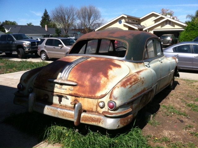

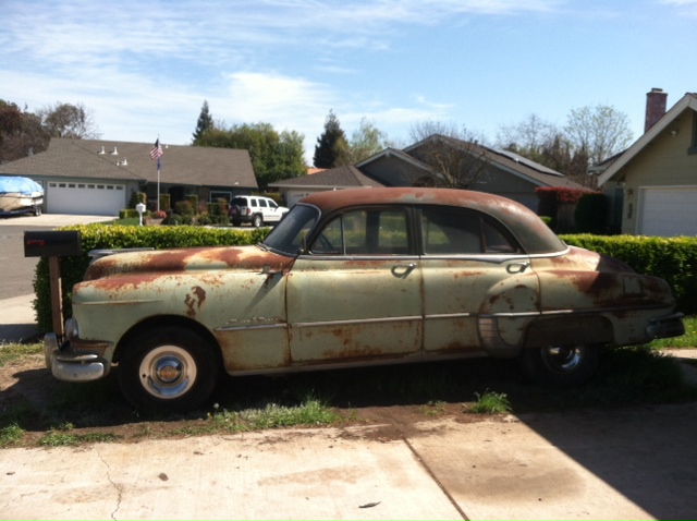

    50_Poncho

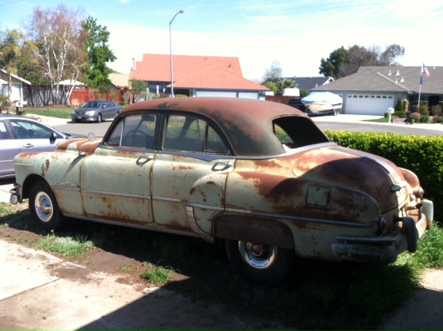

    Hey guys! Heres the start of my newest project. Picked up an all original and complete 1950 Pontiac Silverstreak with the flathead inline 8. Pick it up for $600 and it even came with the skirts, tissue box holder & under seat heater! The plan is to hopefully get the flathead running, clean it all up, clear coat the patina & bag it so it lays frame. Heres a couple pictures.

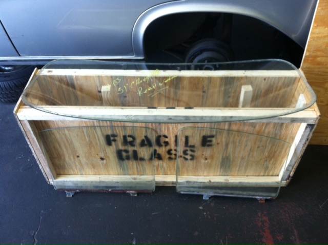

    Someone had shot out both p***enger door windows, right windwhield & rear window. So it was time to find some used gl***. Man it wasnt cheap!! I'm located in California and could only find a few pieces back east. The gl*** I got was from a Chevy which are the same. I'm still looking for the right windshield so please let me know if you know of any for sale.

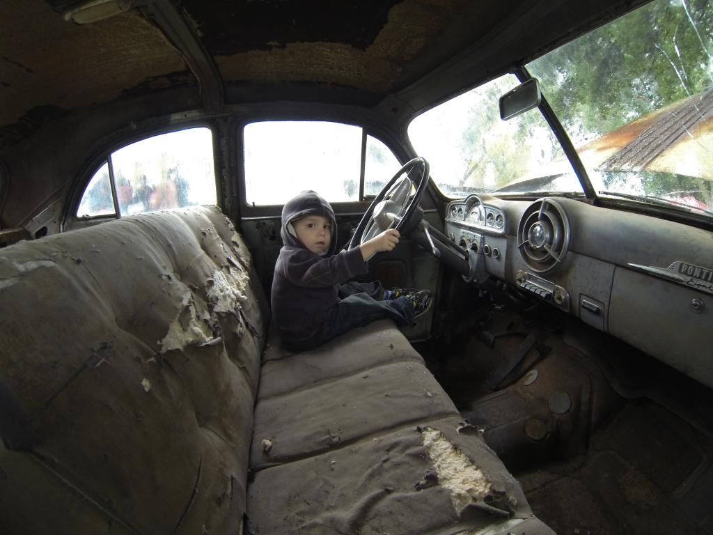

    50_Poncho

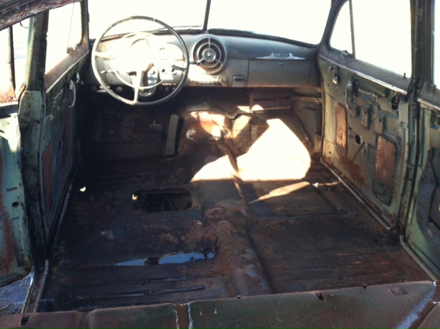

    It was time to tear into the interior and gut it. Found a tissue box from the 60's which was pretty cool. Also found a rat nest which wasnt cool.

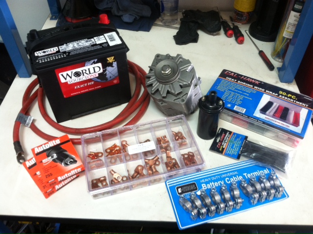

    50_Poncho

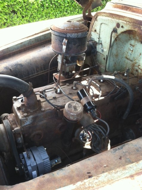

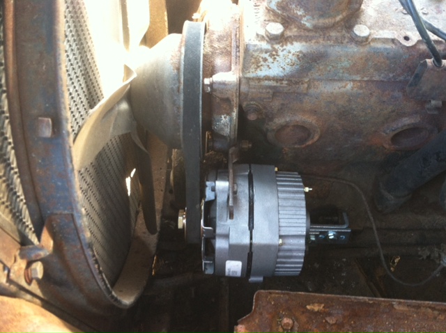

    I removed all the wiring so I could start fresh. I also charged up the 6v battery and tried to crank it over. It turns over great! I checked for spark and no spark :(. I planned on converting to 12v anyway so I wasnt too worried. I started on the 12v conversion. I also removed the old points system and installed an electronic pertronixs pickup. I'm not sure if I installed it correctly. Anyone have pictures of theirs installed? It wouldnt have mounted right if I had followed the instructions. So I mounted it the only way it seemed to work. I also tried to turn the engine over with the starter on 12v. I guess the starter decided to take a **** on me. The drive system pops out but the starter doesnt turn over. Tried hitting with a hammer and still nothing. Do you think the 12v was too much for the 6v starter? It turned over great last week on 6v. Where can I pickup a rebuilt starter for it? Or maybe I'll just have this one rebuilt.

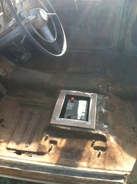

    I decided to rip out the heater system under the front seat since it was leaking anyways when I filled up the cooling system with water. After removing the heater core it left a huge square hole in the floor. I decided that was a perfect spot to hide the 12v battery. I fabbed up a battery box for its new location.

  8. How's the new battery location going to work when you "lay frame"?
  9. 50_Poncho
    Joined: Mar 7, 2013
    Posts: 14
    50_Poncho
    The frame is still lower then the bottom of the battery box.

    ...how you gonna service/remove the battery without takin the seat out?
    ...does it drop out from the bottom?

    I'll have to remove the seat which isn't too bad. Most New Mercedes have the battery hidden under the p***enger front seat. I own a Mercedes shop and thats where I got the idea from. You shouldn't have to service the battery for a couple years so it wont be too bad. I just like how it frees up room under the hood and also hides it. It would look funny to have a brand new 12v battery sitting right next to an old rusty flathead.
  19. Hinge the seat.

    6 volt starter will be fine with 12 volt system

    A 6 volt starter will be fine with 12 volt system, as long as you hit the starter only in short bursts. Sustained cranking the engine will (eventually) kill the starter.

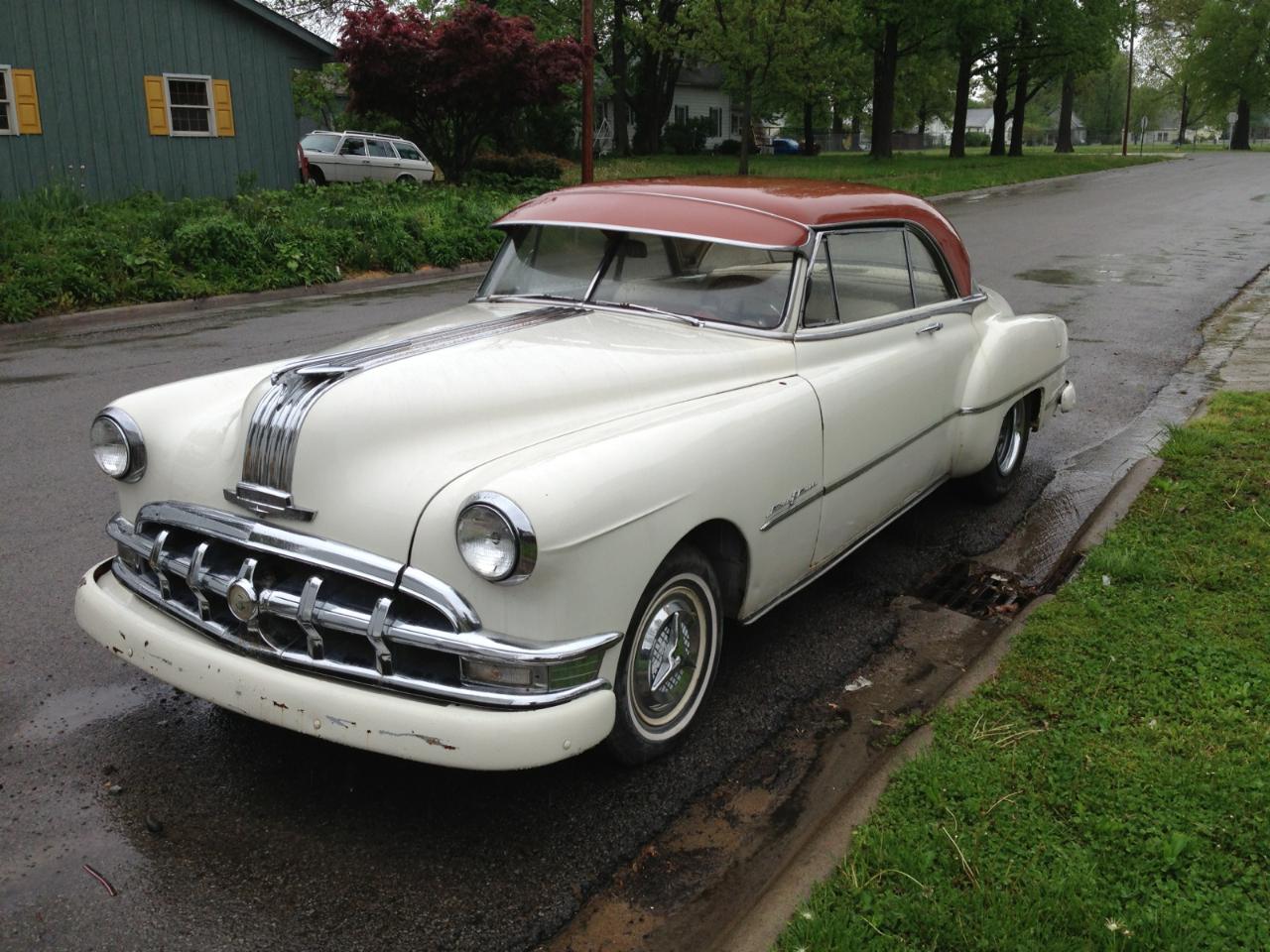

    Hello from a fellow '50 Poncho owner!
    Here's a pic of my '50 Catalina

    I like the project you've got going. I;d hinge that seat to make it easy, won't take much as long as you will probably be recovering it anyway. It'll pay off the first time the battery dies and needs a simple jump.

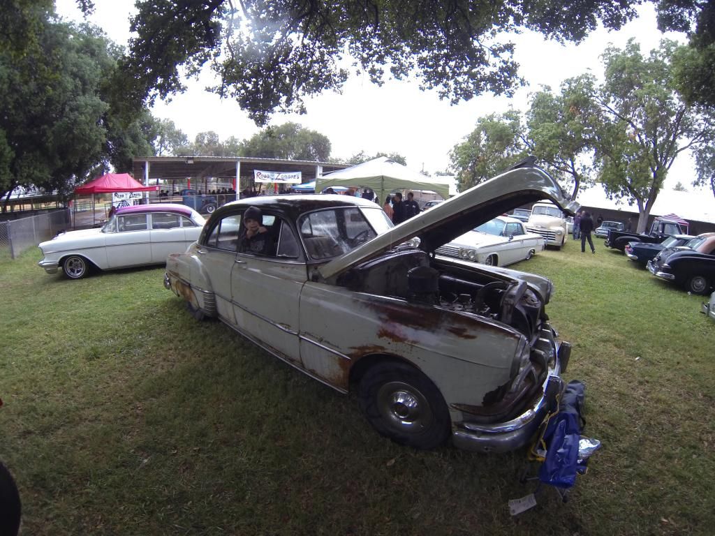

    50_Poncho
    Well I haven't posted in a while but the poncho made it to its first car show (Billetproof). It was its first time hitting the road. Roundtrip of 60 miles. Here are a few pictures.
