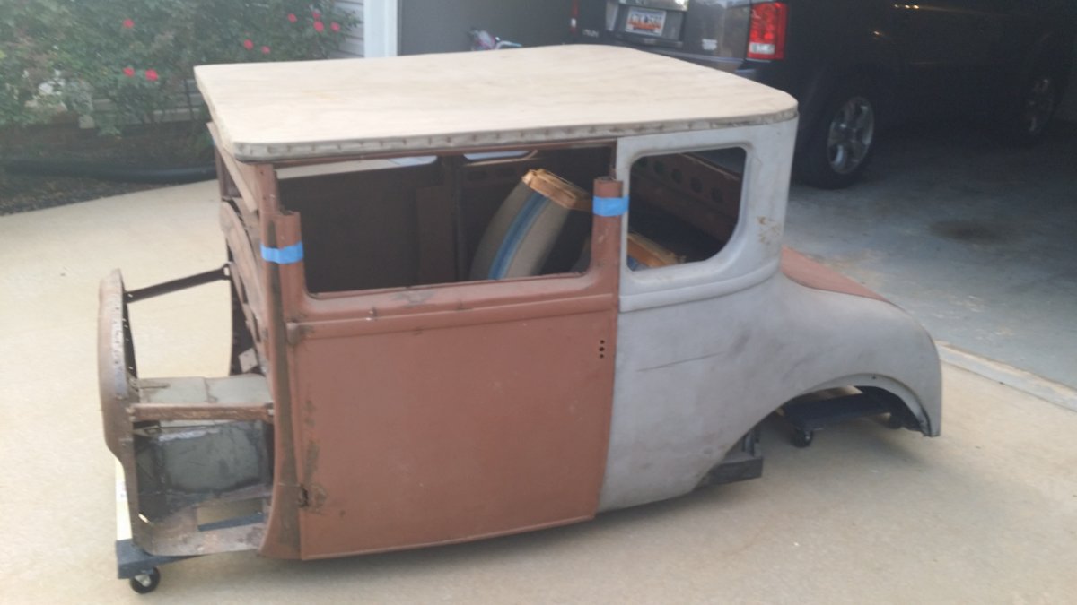

    Picked this little fella up yesterday and will be sharing the details of the build as it progresses. It is solid as a rock with an ok chop that I will need to tweek a bit. It is going on an model A frame with a Z in the back. More pics to come.

    Nice find! With the cowl cut up you may want to look for a 28-29 cowl and mess with everyone. Bob

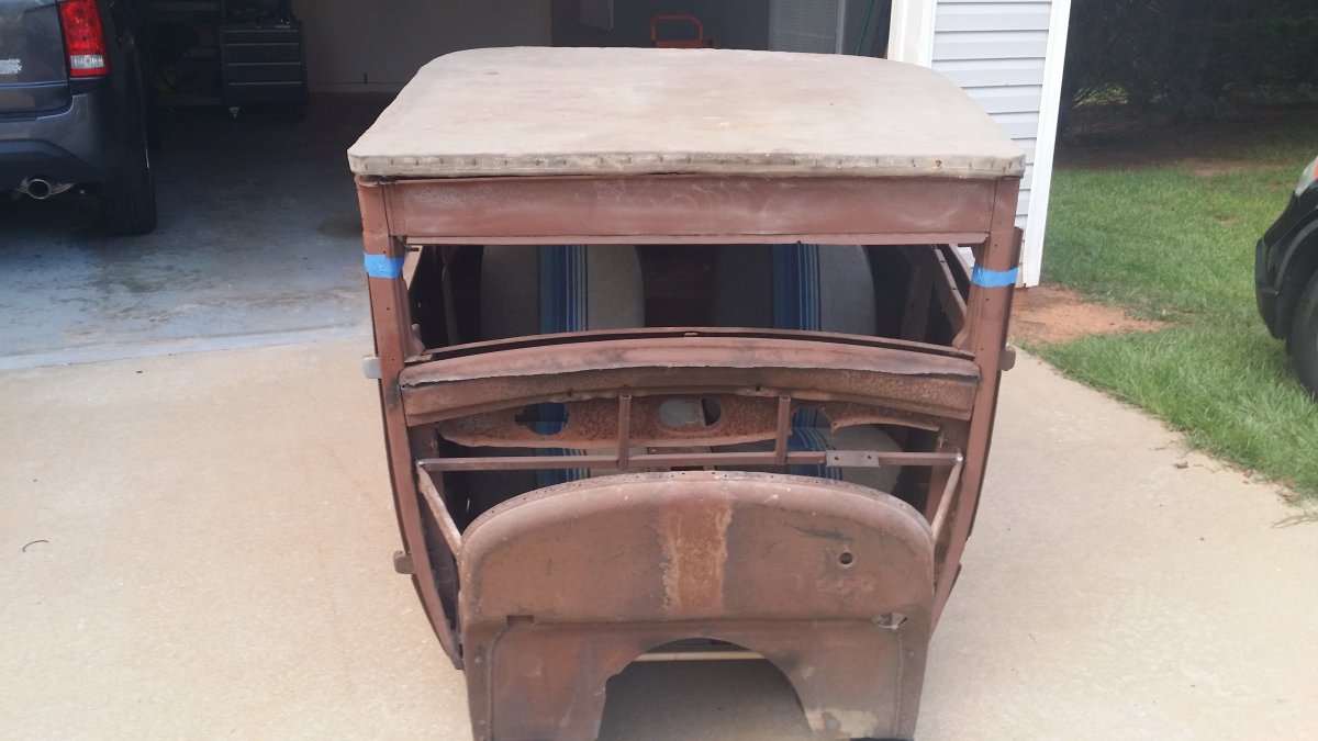

    Well been collecting parts and have a pair of split bones and I beam axle.My buddy Dave at Hot rods 101 in Woodruff SC has been cool and is letting me use his frame table to build a frame. Got the new cowl cut up and ready to go on and she will look like a 27 again.Not a ton of progress up till now but it takes time.The door tops will be next. I have a mint drivers side top but the p***enger side will need to be made from nothing.More pics to come unless you want to see a pile of parts.

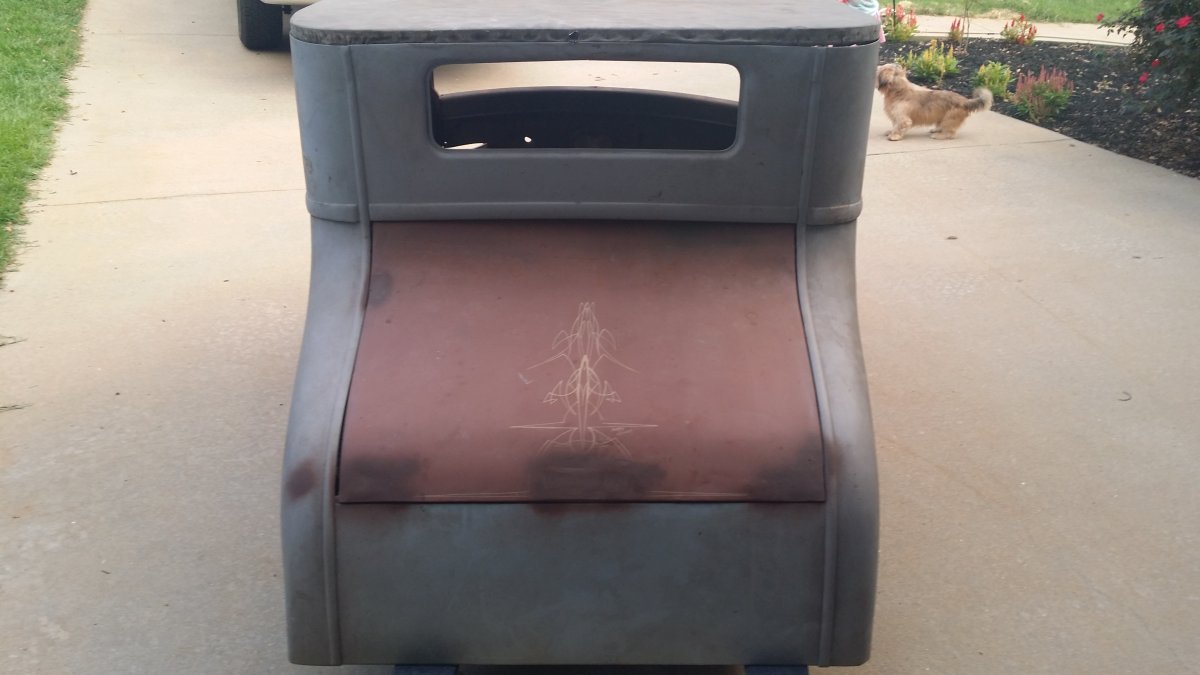

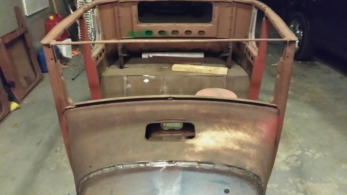

    Been a slow run but I got the cowl welded on today.Cut the belt line off the top to give it a cleaner look.Got access to a frame table in 2 weeks so more progress to come.

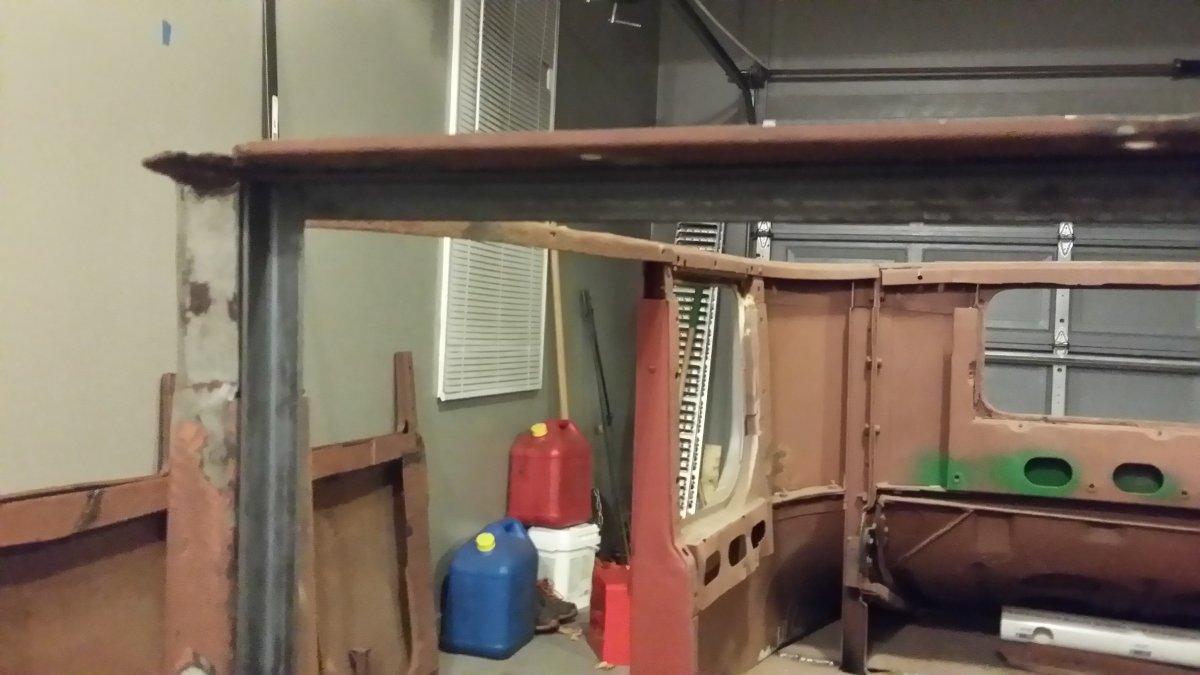

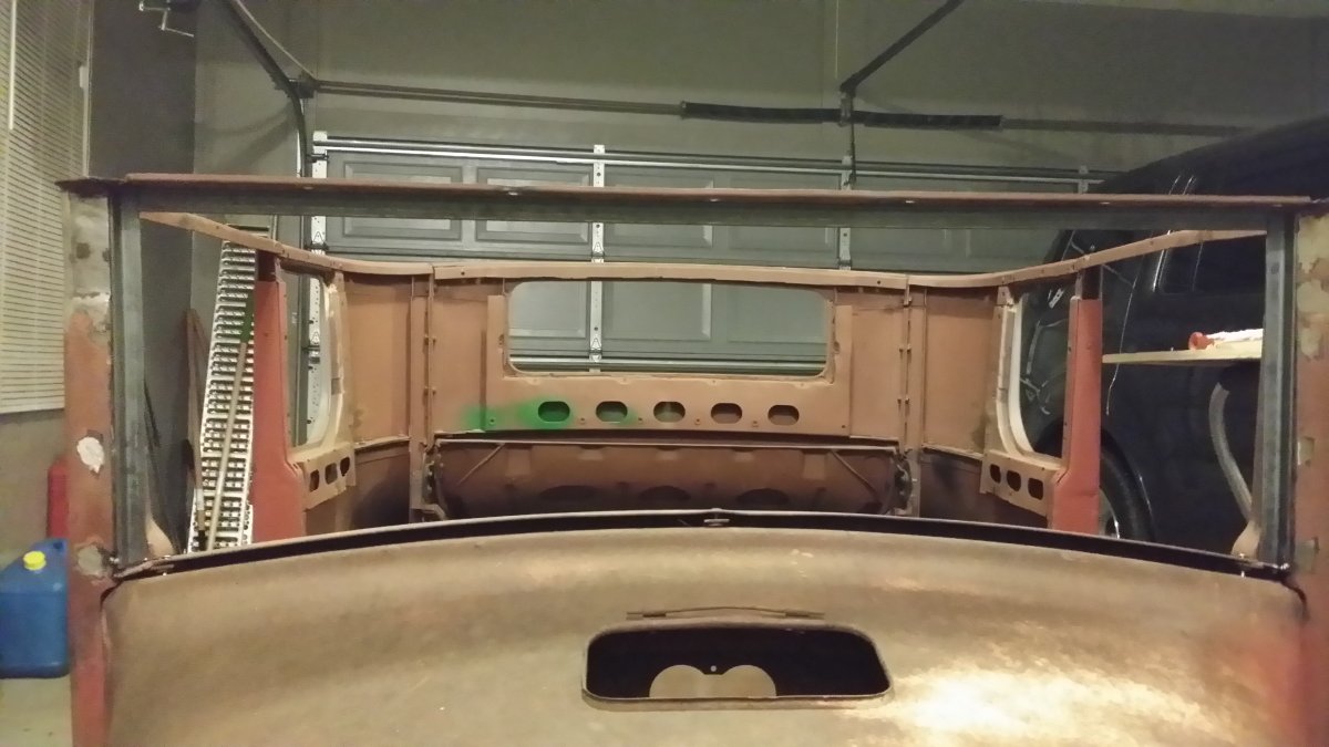

    Cut the header panel out tonight.It works well with a 3 foot tall roof but not so good with a 1 foot tall roof. Need to brace it up but overall a huge impact as far as vision out of the cabin.

    Got the windsheild frame tacked up. Going to have to use the shrinker/strecher for the curve on the bottom.I used 1/2 angle for the frame top and sides.The angle gives the header stability for the top.Once it's all fitted I am going to tack it in permanent.It will be a fixed window and installed with window strip calk adhesive.It is kind of a strange way to do it but hey it works

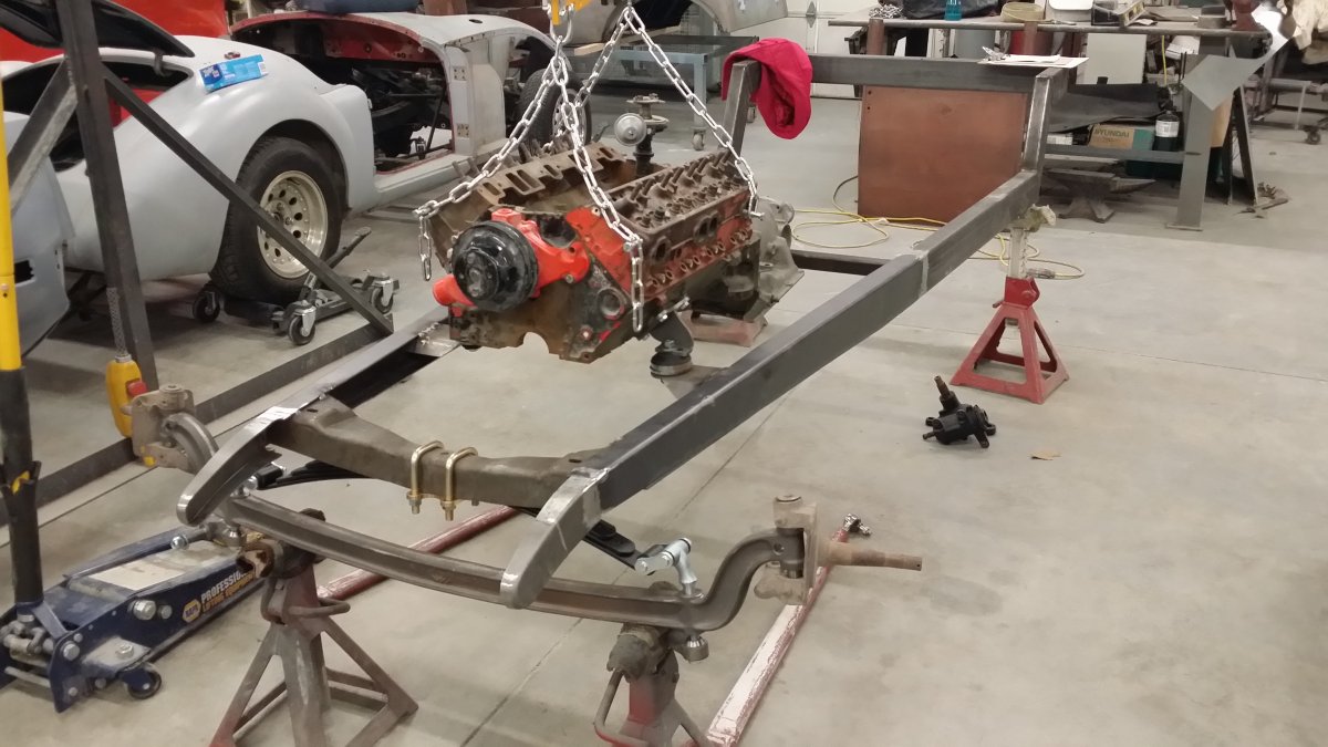

    Been a while progress has been a little slow. Got the back half of the frame mocked up and tacked up.Going to pinch the front from the firewall forward.Motor and trans mocked up for ****s and giggles.I will also be taking out that trans tunnel 20161215_190554.jpg 20161215_192535.jpg
    Ron Funkhouser and AndersF like this.

    Got a lot done over the long weekend. The frame is about complete and motor mounts in place.Put some Brookville frame horns on for looks.Scored a 9" cheap and will be cutting it down and respline the axles when I get the lenth dialed in on them.Going to locate the wishbone bracket next.
