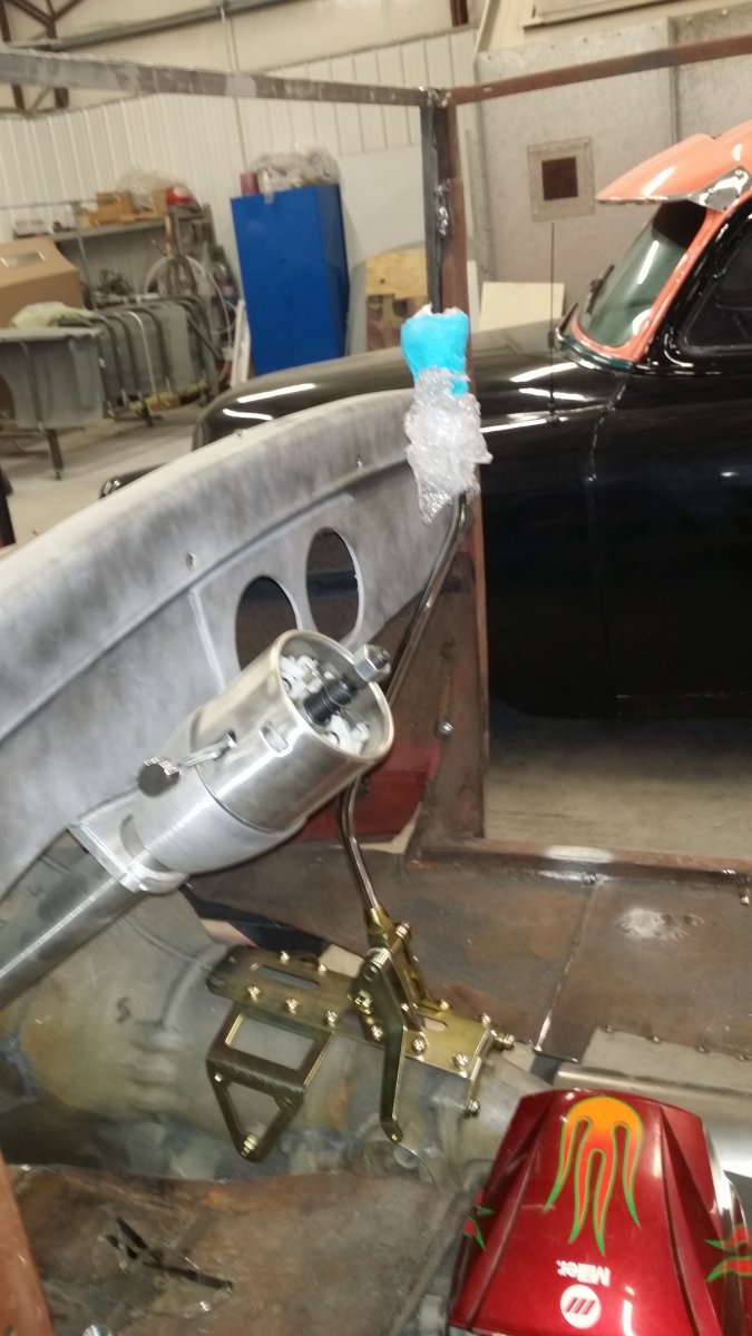

    Finishing up the trans and driveshaft tunnel now. I will take some pics of the progress next time i'm over at my shop.Thanks for the intrest I kinda let this thread die because there was not a lot of feedback on anything. Now that I see you guys like the project I will keep it alive

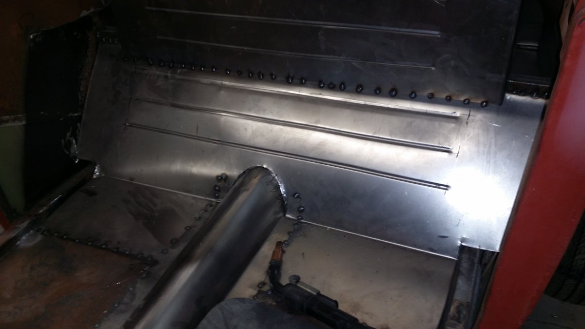

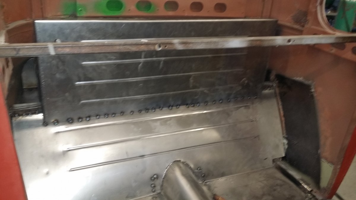

    Here are the pics of the floor so far.You can see by moving the z back as far as the diff gained me the leg room.I set my bench seat in the other day and pushed all the way back I couldn't reach the pedals and i'm 6ft. The yolk for the diff sets in the tunnel under the seat. May be hard to see in the pics. Still have some work to do on the sides of the rear bulkhead.The trunk is done and I will be building a fuel tank soon.

    Wow piedmont you are doing some great work. I see where you got the extra leg room, that's a good idea. May I suggest when it comes to the windshield consider the top of it the same as the top of the door windows if possible. My leg room was limited due to the firewall being moved back 4 inches. After altering the seat this 6ft. body fits in it fairly well. Thanks for the posting and keep on keeping on.........

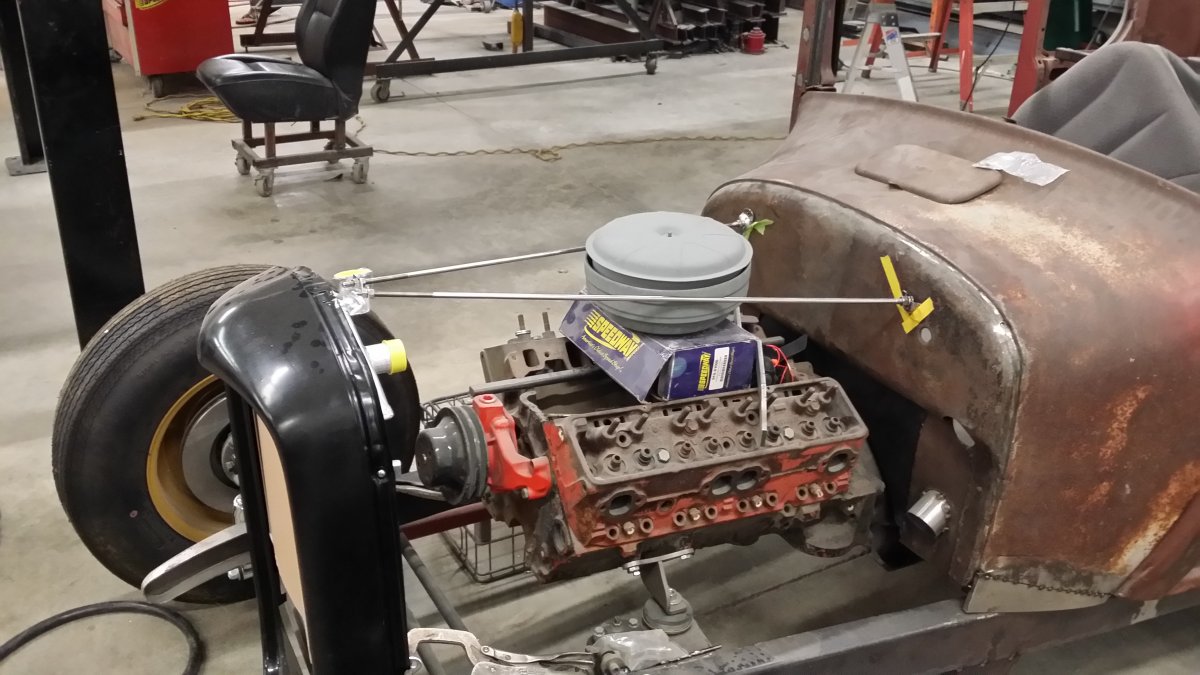

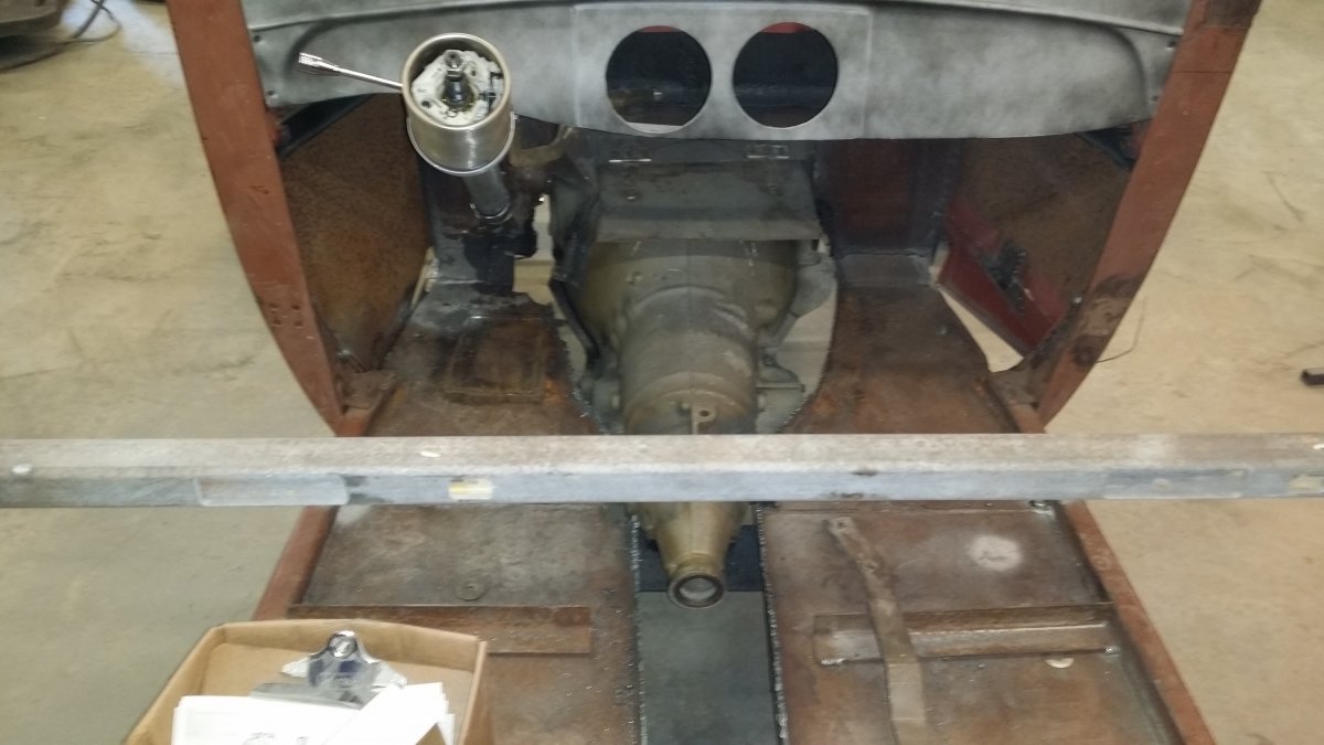

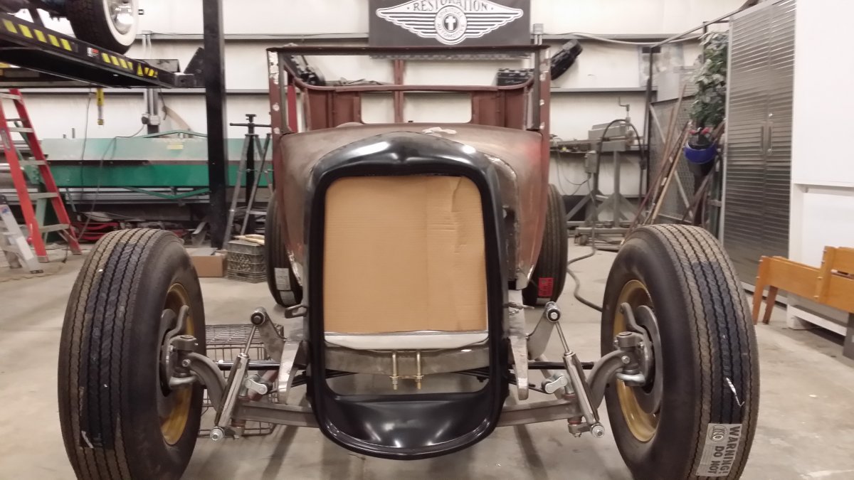

    For you guys following and wanting to see some progress here you go. Trans tunnel built and tacked in. Fitted the body and got the radiator and grill shell in loose fit. Brake pedal coming together but still needs to be cut up and tweeked.I took the body off the frame this week for final weld ,clean up and paint and ***emble.
  17. 26hotrod
    Joined: Nov 28, 2009
    Posts: 1,141
    26hotrod
    from landis n c
    Man your progress is so choice!! Thanks for the updates. May I suggest when setting the grille shell, try setting the top of the grille shell 1/4 to 1/2 inch lower than the cowl. You won't regret it. Just my 2 cents worth. Again thanks for the updates...........

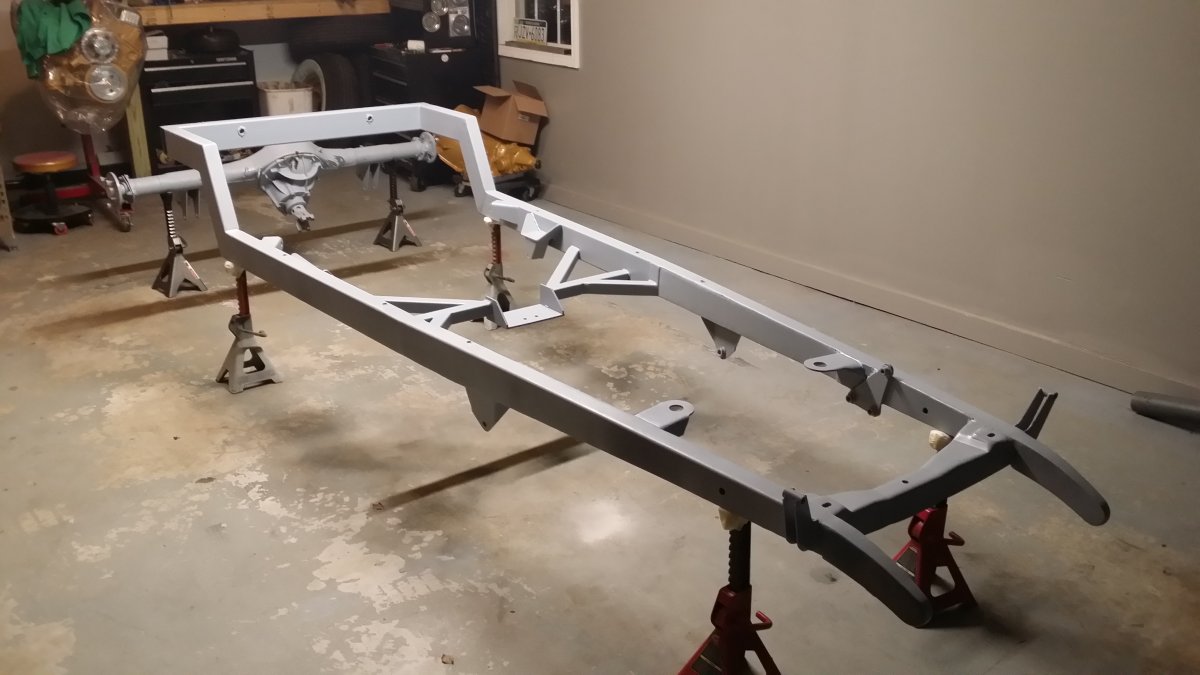

    Back from blast and sealed up in epoxy.Ready for final body and paint,

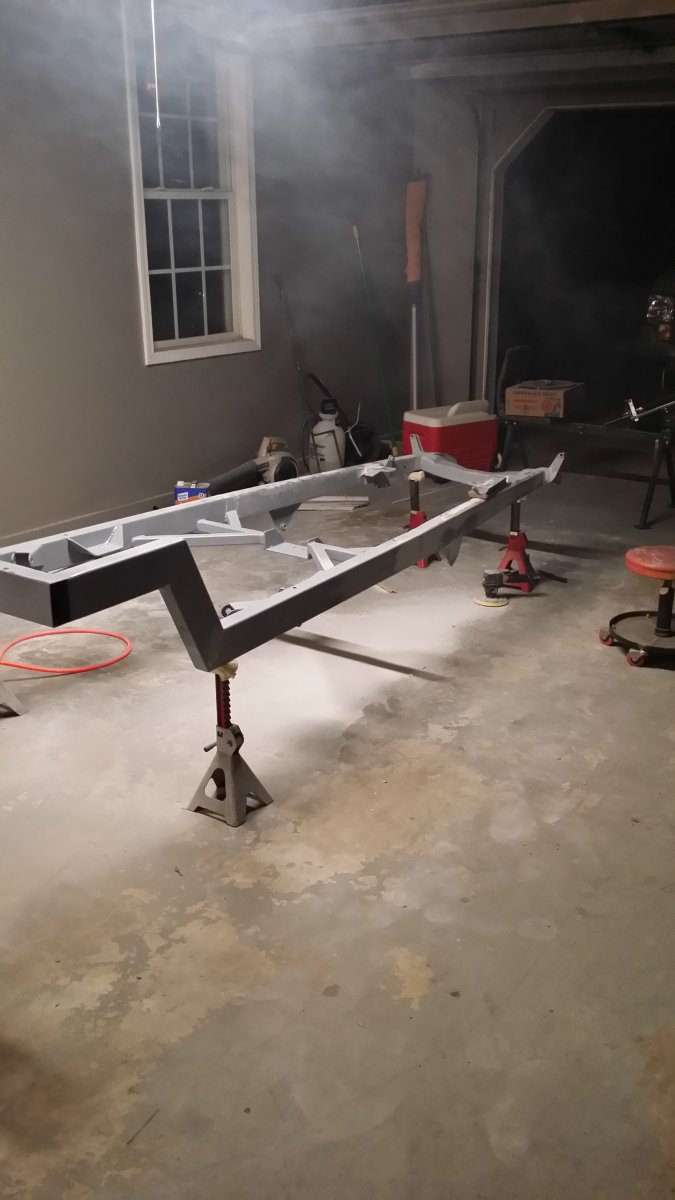

  25. Piedmont
    Joined: Aug 28, 2016
    Posts: 47
    Piedmont
    Floors welded in and frame prepped for paint.Had a color change so had to scuff and reshoot the motor in the morning.Going to shoot the frame and ***emble in the next couple weeks.

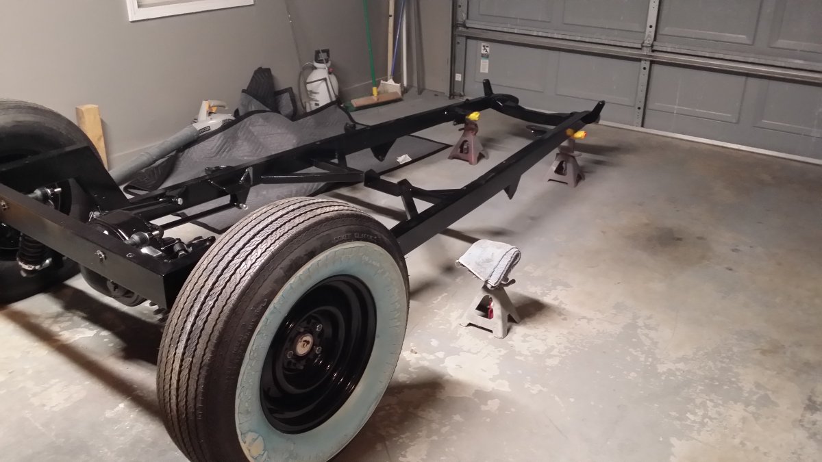

  26. Piedmont
    Posts: 47
    Piedmont

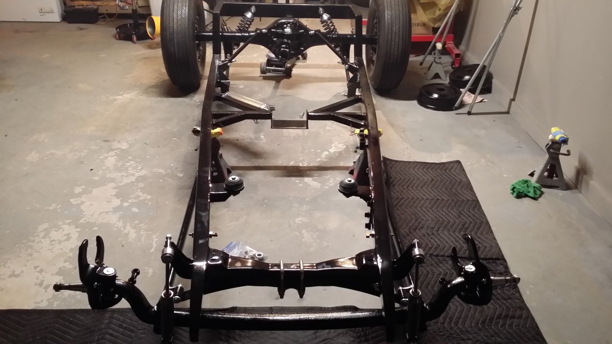

    Been a while for an update. All the bodywork and paint done on the frame.Got the brake lines bent and everything painted.I hung the rear end last night and plan on getting the front done over the long weekend.Been a little side tracked with my buddys project 50 Mack "rat rod"

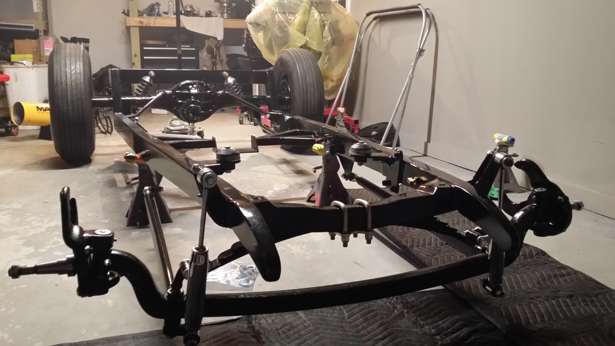

  27. Piedmont
    Posts: 47
    Piedmont
    Spent some time this weekend and got the front axle in.****oned up the rear 4 link up tonight,Need to pack some bearings and mount the rotors and front wheels and she will be a roller for the last time.Motor and transmission going in soon!!
