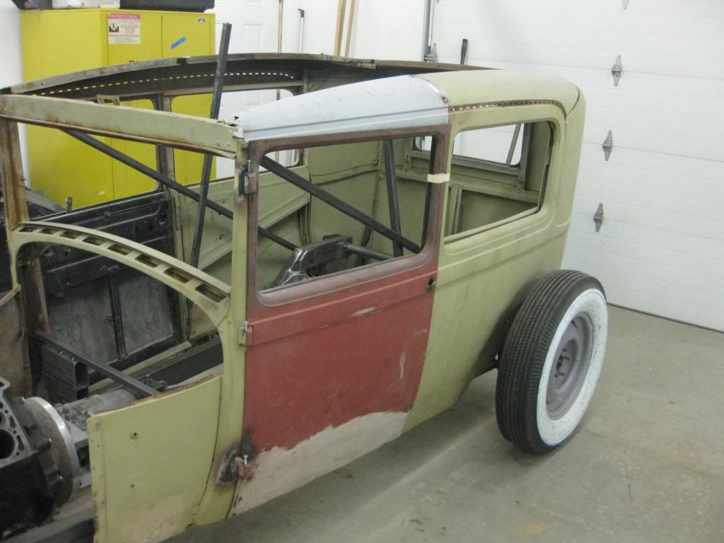

    finally got the doors fit and the body braced. now on to making the sub floor and mounting the body.

  23. Looking good man, where did you get the new sheetmetal section for the roof from? Ive just ordered a couple from Snyders, did they fit good?
    I will be watching this build with interest, keep up the good work.
  24. chevy12
    Joined: Apr 27, 2008
    Posts: 100
    chevy12
    I got it from http://www.brattons.com. it fit almost perfect, thick sheet metal too.
