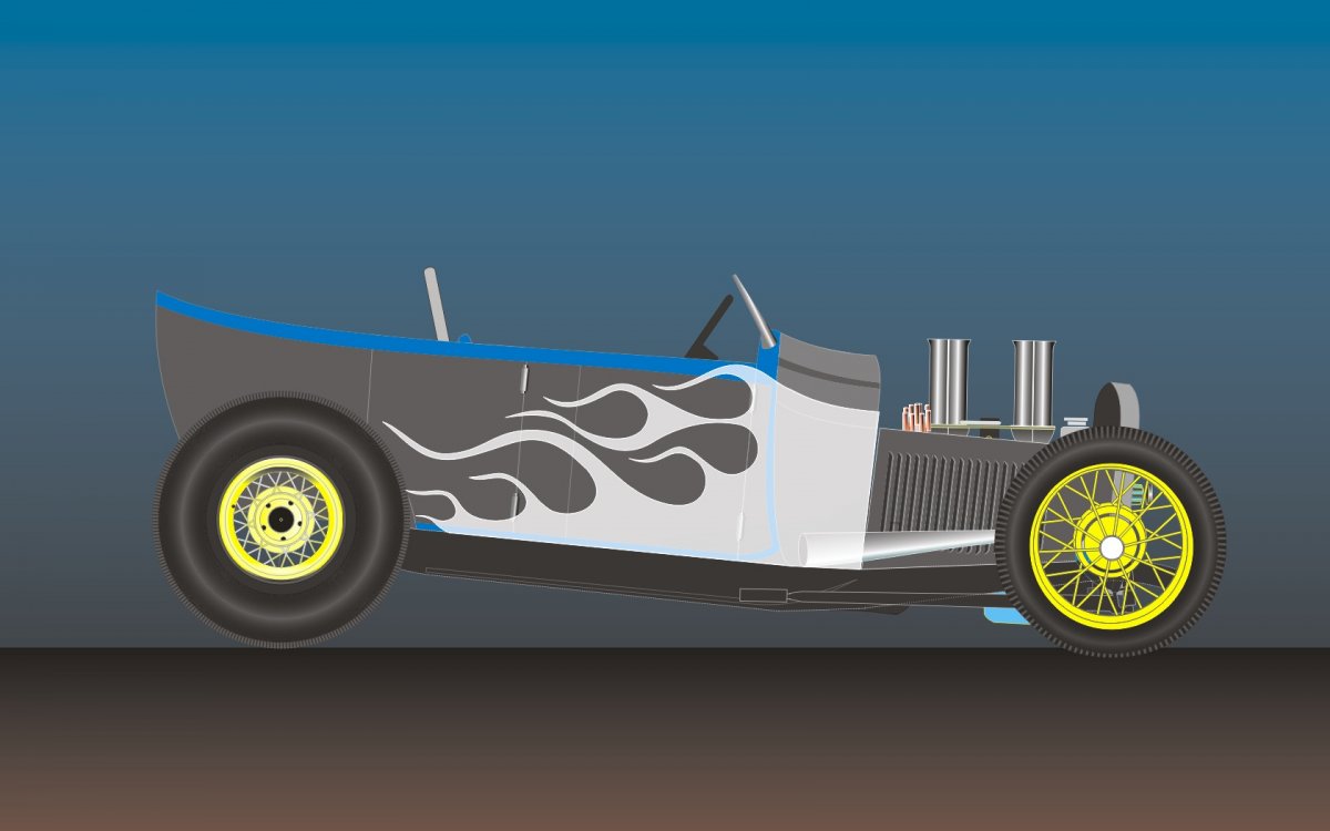

    been thinking of the 16inch - 19 inch wheels for a long time.
    never really saw it on a car...untill the Midnight Special Model A....I think this is it...?
    AndersF and patmanta like this.
